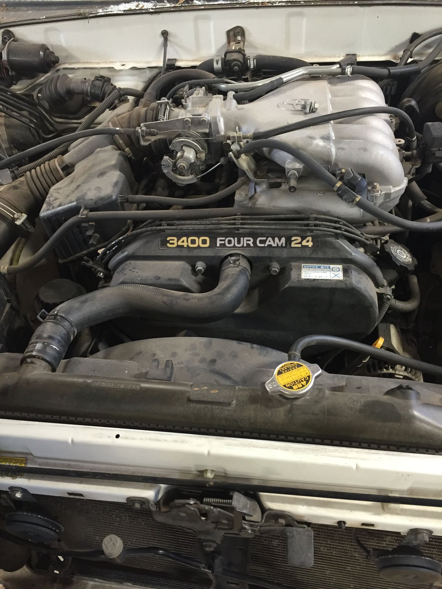

My no good vehicle (donor)
2002 Limited 4Runner
Automatic 4x2
3.4 with 130,xxx mi
**BTW this is a full truck and I am selling off everything but the engine. If you need something please let me know. I have everything but the steering wheel (i broke it off), front bumper, and headlights/foglights.
Now to get the show on the road
My friend Matt and I are working this project together as he was kind enough to lend his time. This will not be a quick swap as I have a job, 3 kids, do woodworking on the side, and I am in no rush. We already started, having the engine in the donor ready to be pulled out. We are now waiting on our cherry picker to get here tomorrow.
Here are the start pictures. Beautiful (Matt not so much)
Getting the engine ready to be pulled was not too bad. A lot of zip lock bags for labeling/containing hardware and duct tape to keep it with its corresponding part. We started driver side top and worked down and across. I would say the only part that took some time was removing the dash to get the ECU and wiring harness out and free. Overall we spent 8hrs and 2 pizzas getting to this point. It can be done much quicker, however I like to move slow and just enjoy the work. Like I said I am not in a hurry. I did not take many pictures through this part as it is pretty self explanatory and simple.
We are removing the front end and going to attempt to remove the engine with the tranny attached. Any thoughts on that?? We disconnected the drive shaft (4 bolts and pull out) and it seems like it will be easy enough.
