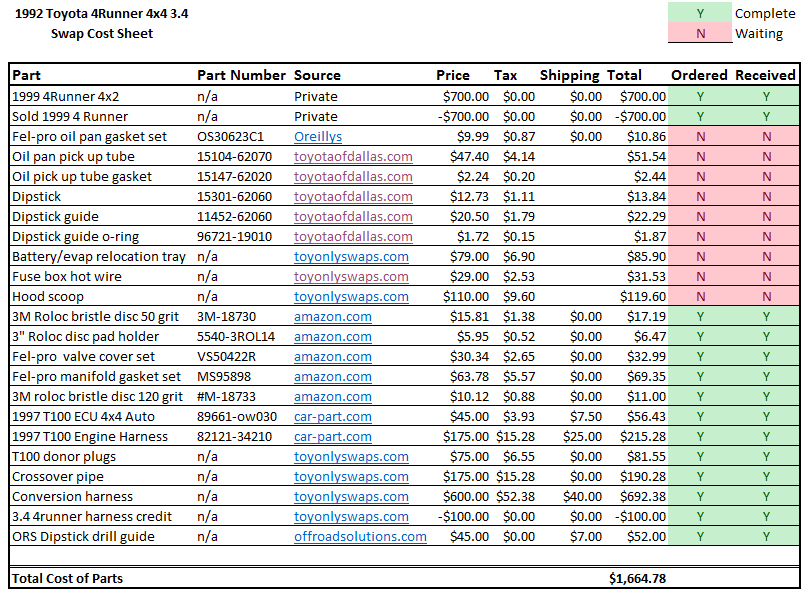

I just got my conversion harness and crossover pipe back from toyonly so I will be back at it FINALLY. I wanted to share my costs so far so anyone looking to do this can get an idea of the cost of the swap.
Attached Thumbnails 1992 4Runner 3.4 Swap Running Thread-swap-costs-snapshot.png
Nice job on getting the 'free' engine
I got very fortunate. I found the 99' on craigslist here in OKC, pulled the engine and then re-listed. A guy needed it for the axles and the rear ABS. He didnt even attempt to bargain and I gladly obliged.
