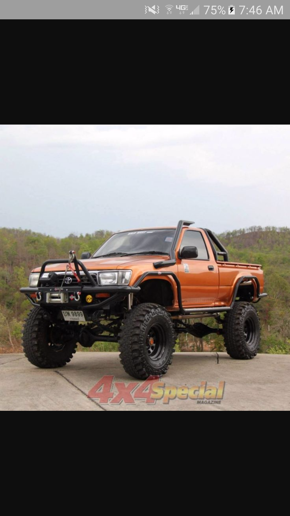

no updates as of yet.. although I do have a question....I'm contemplating SAS. I know there are tons of posts on this subject. I want to know how I can achieve this with minimal amount of lift, I don't want my truck to be huge I would like to stay within 2- inches total. AND. which swap kit should I use, or have you all used? this is what im going for

That truck in the pic looks pretty sweet, but I can guarantee you that it has more than 2" of lift. All the SAS kits out there say you need at least 3" of lift in order for the high steer (crossover steering) to clear the leafsprings. Even with the 3" lift springs after you factor in the added height of the front spring hanger and longer shackles you end up with even more lift. I've been looking into possibly doing a spring under axel sas on my 87' but then you're looking at a custom crossover steering setup. Still doing some research on that. I'm not trying to discourage you, just saying it's a little more challenging to do a SAS and keep it low.

Well I'm trying to keep the center of gravity Low. this truck is just a toy / part time driver. I've got 3 inches now and I don't want much more. I think the bars across the fender bumper to bumper on that truck is pretty sweet dont you?
