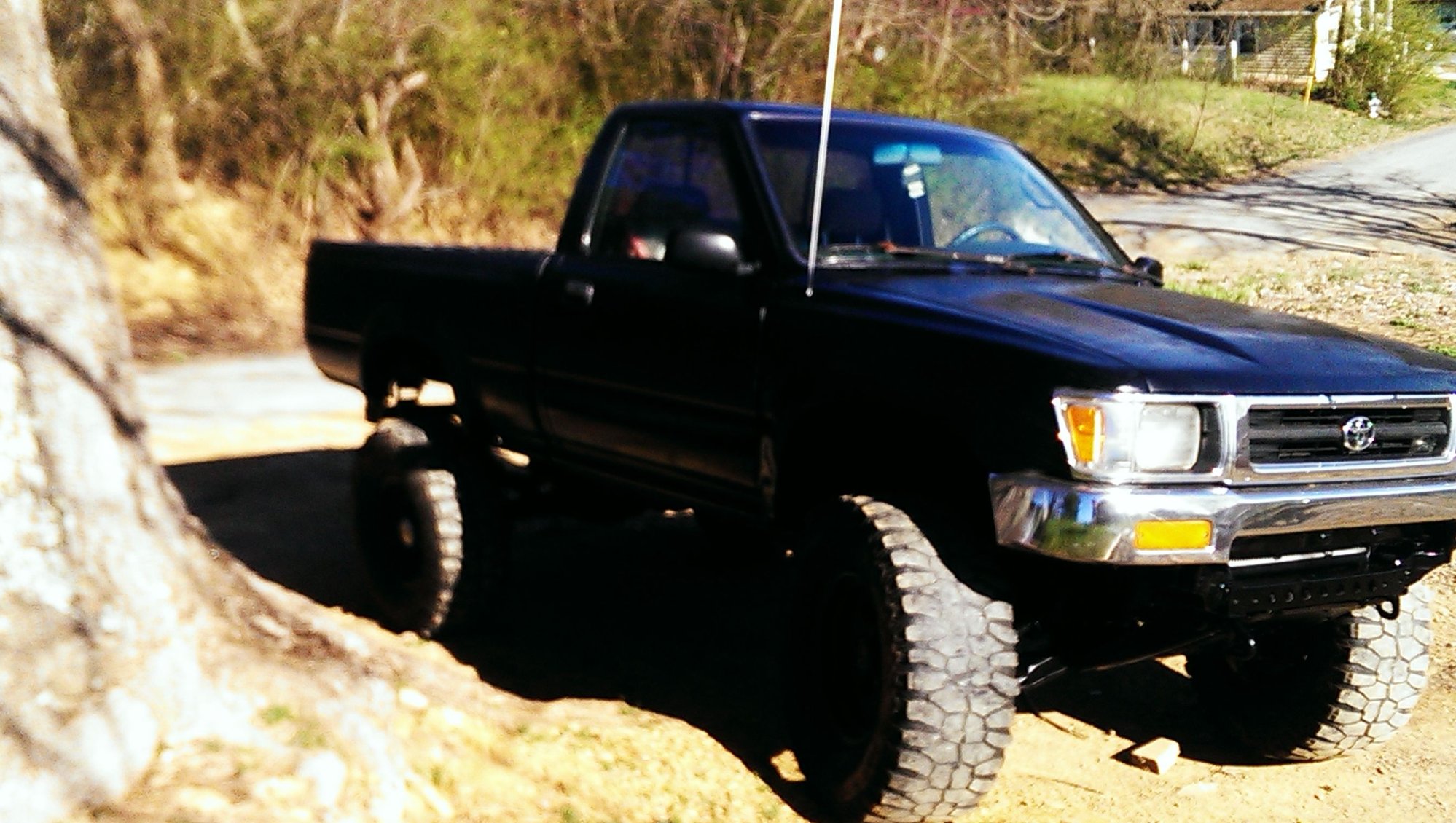

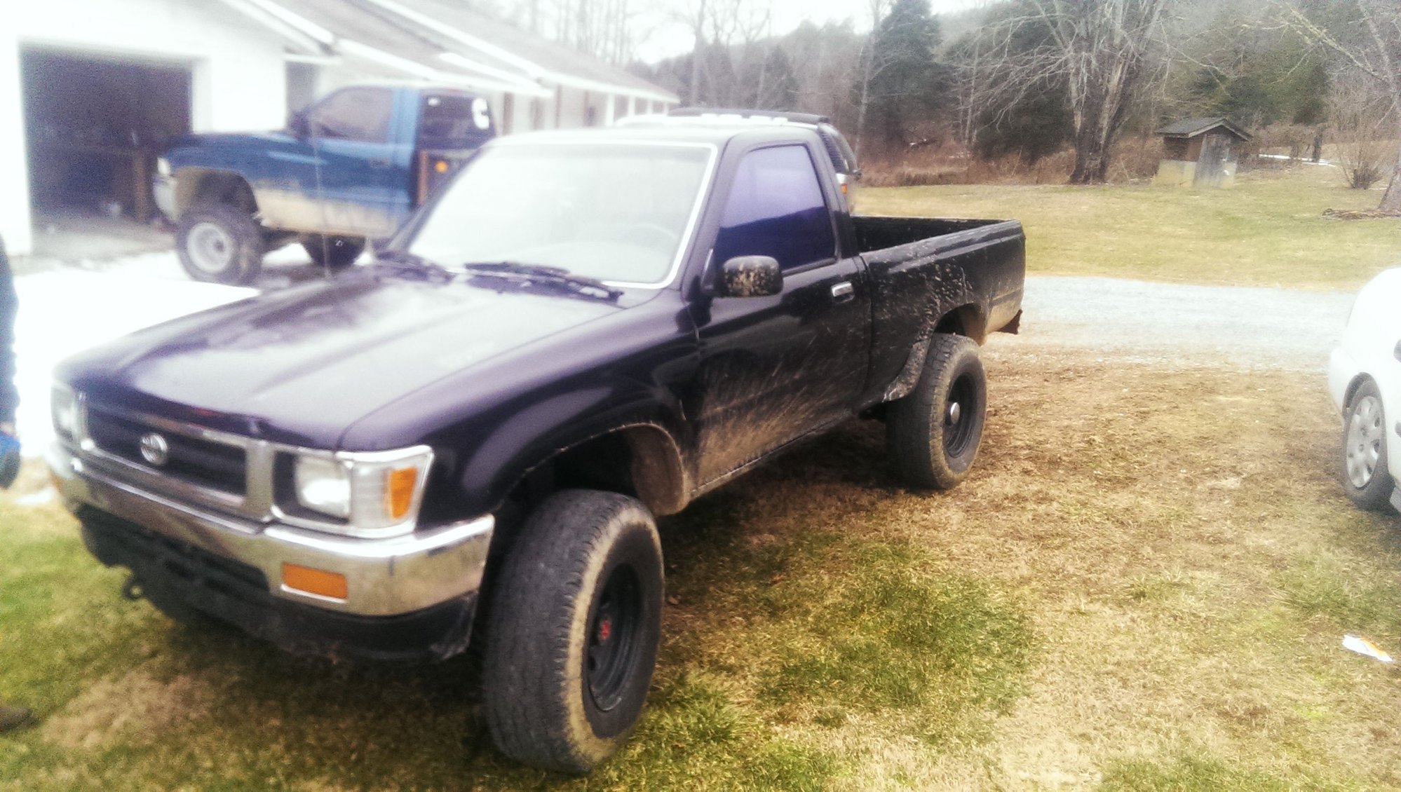

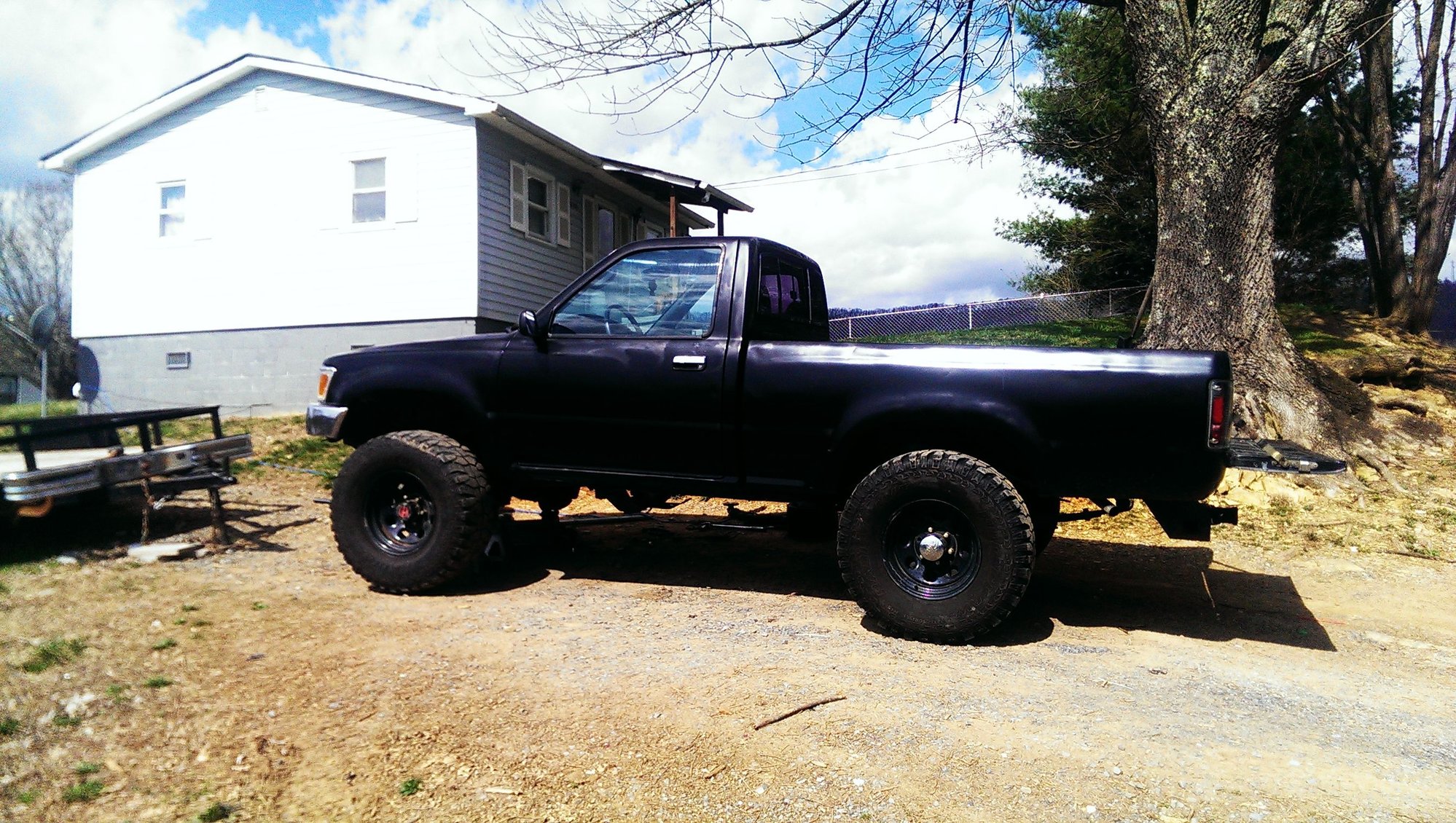

here is how she started 1992 22re Bald 31x10.50 tires and a previously bondoed door that rusted out.. although I did sand the truck and paint it with rustoleum rattle can and got a new door. I have no photos to prove it.

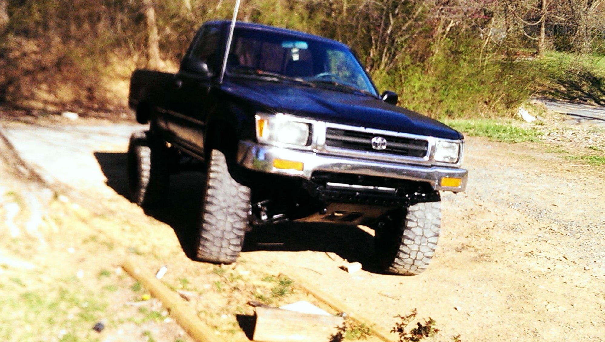

Here it is with the 33 12.50 mud claws I got used a week ago. with the front 2.5 inch bj spacers installed.

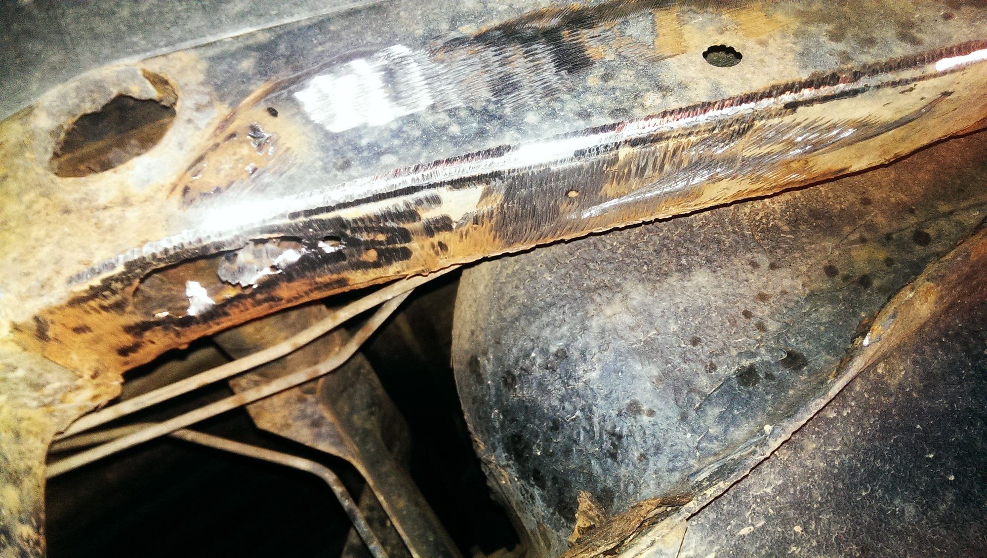

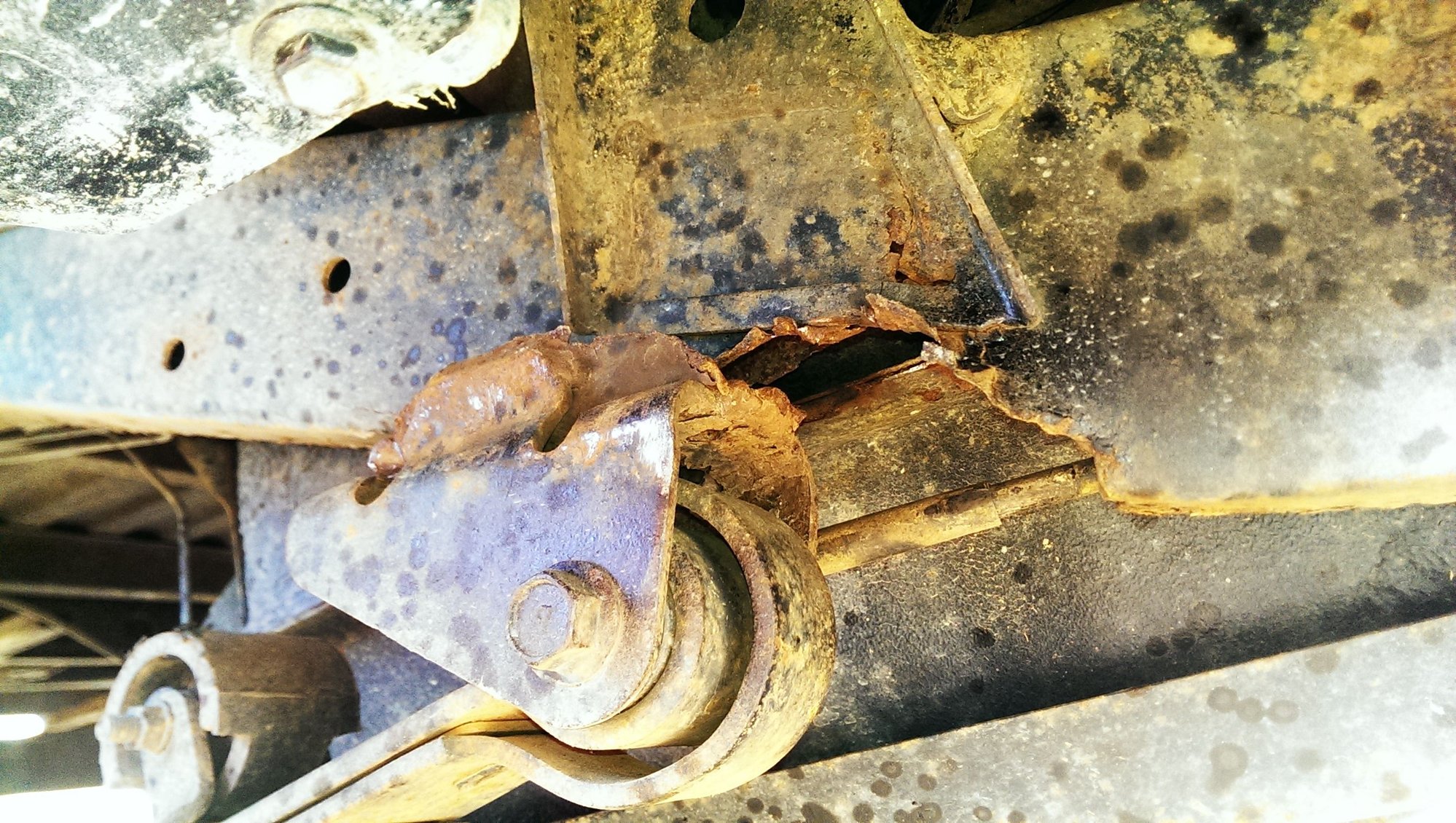

so I've got a little frame rust.. as I set up my Jack to raise the rear end to install the 3 inch blocks I busted the spring perch off the frame.

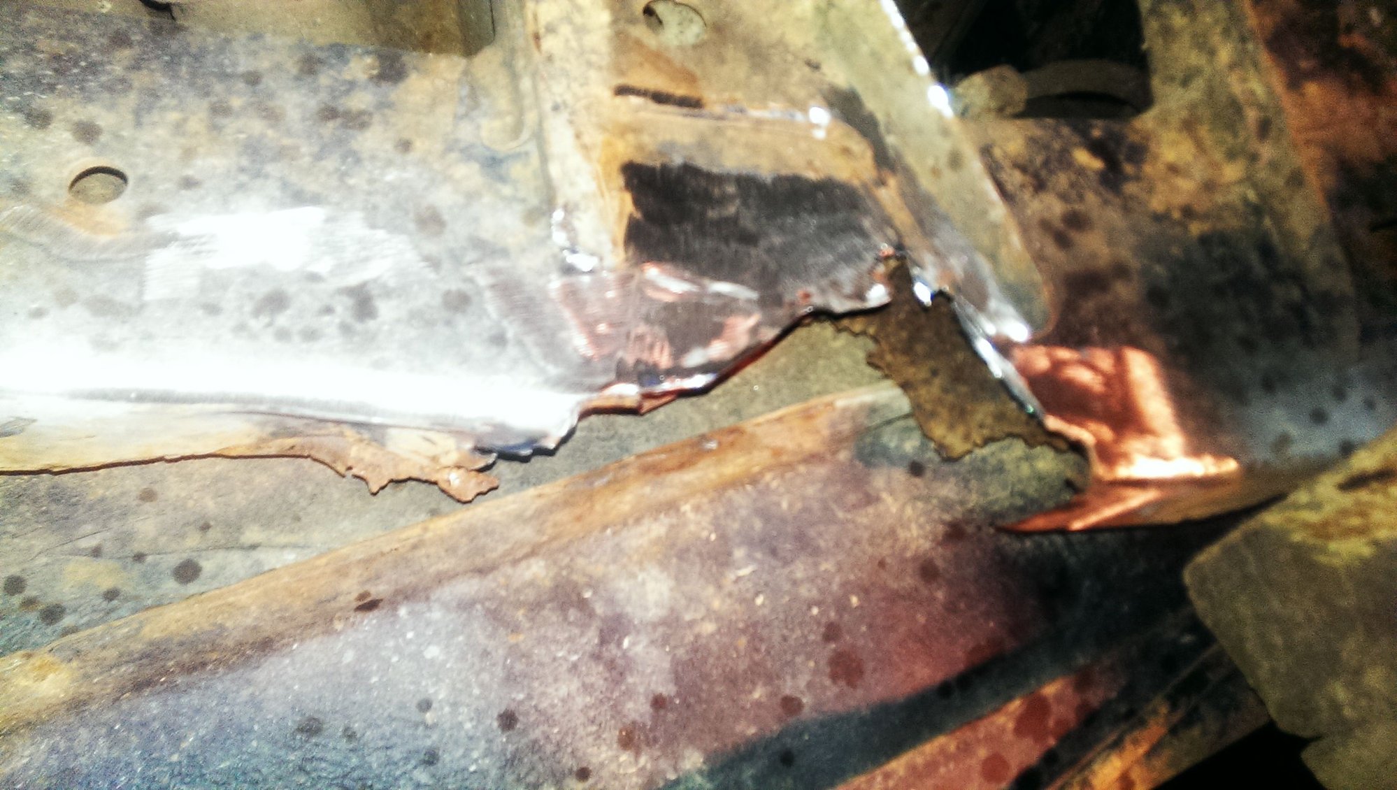

Here's a little preparation I got done tonight. small fix fo
r now. tackle the bigger issue later

Finished the frame rust repair.. also got the lift kit installed

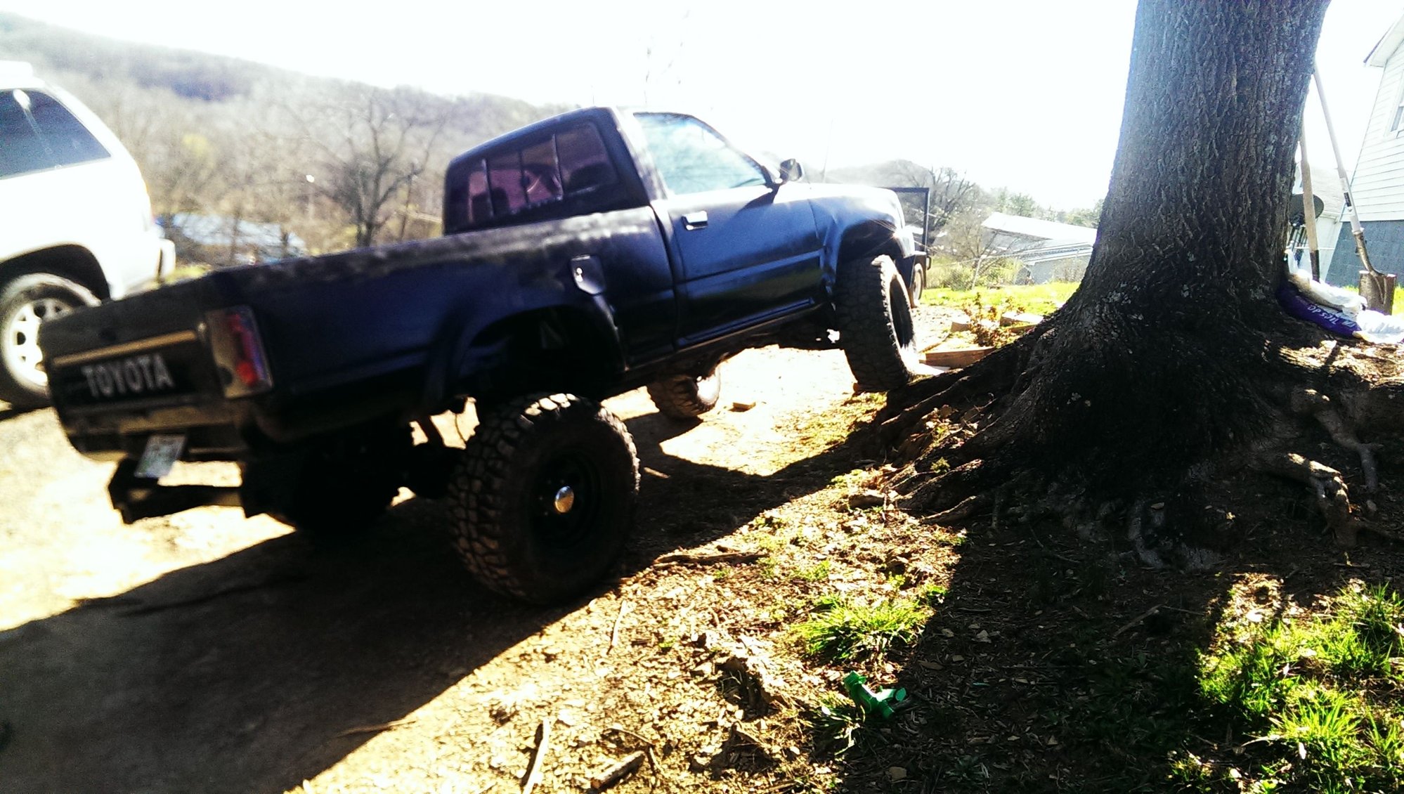

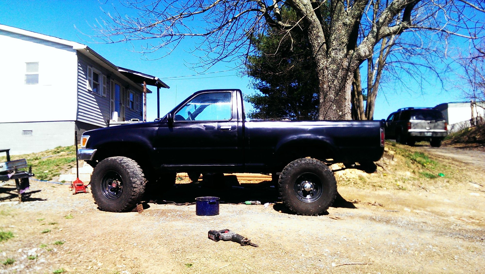

Playing around a little today

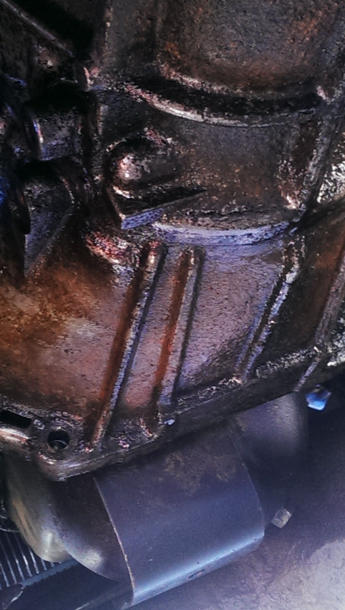

And I think I have a transmission leaking

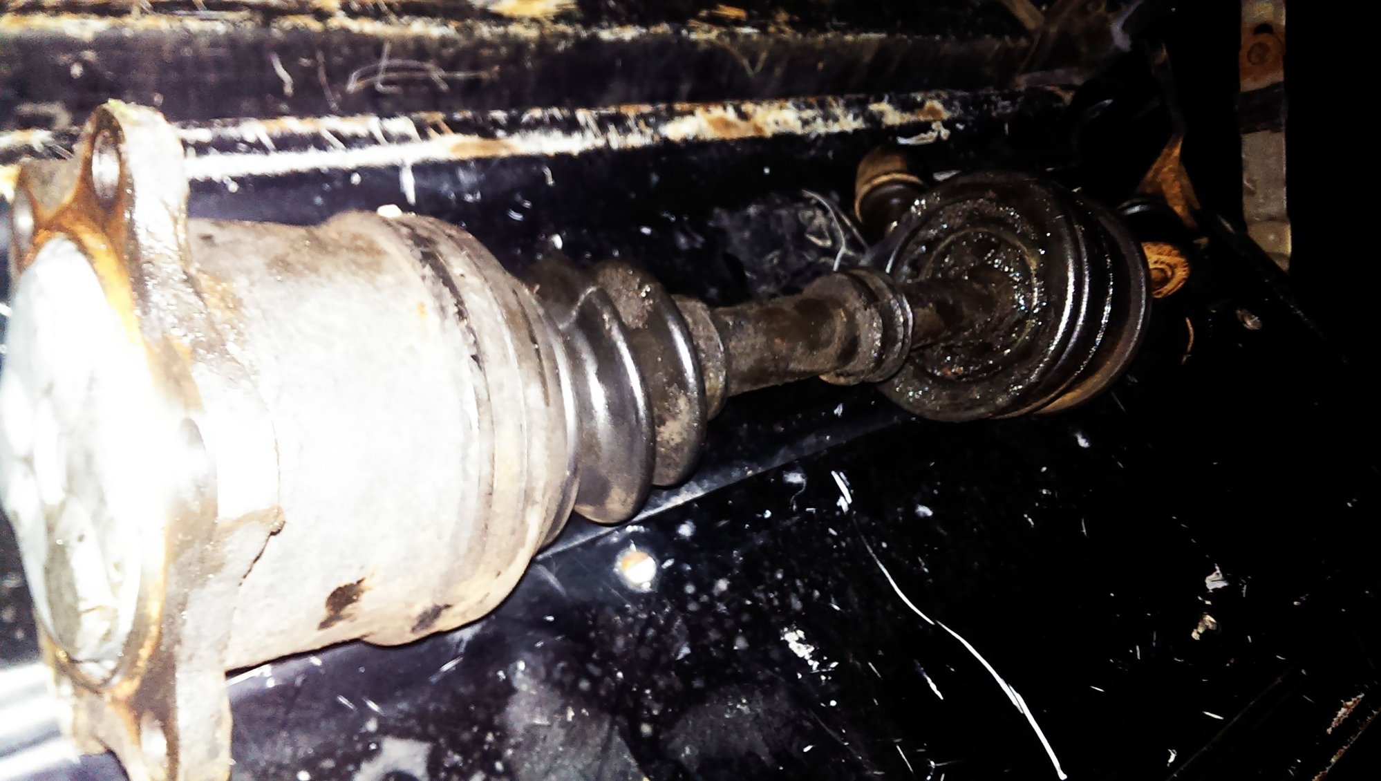

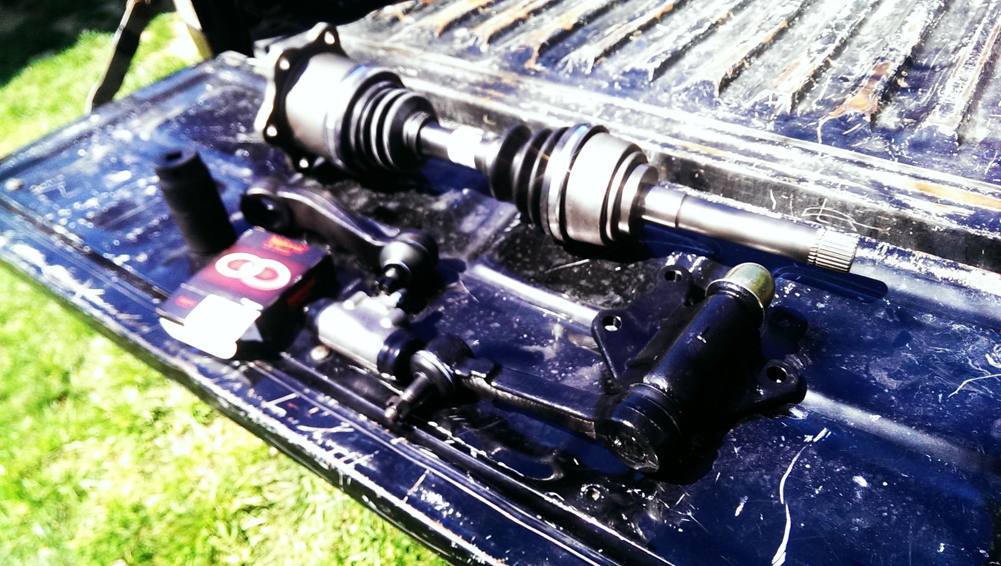

installed New idler arm. pitman arm and a new rear wheel cylinder that was leaking. Also got this baby out of there...y'all reckon this axle was a little warm?
