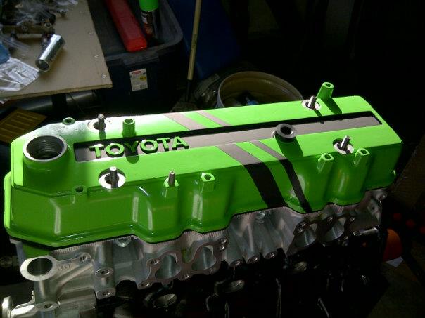

Because of the urgency I couldn't risk waiting for you guys... hehe sorry, but if you guys have any input please shoot it my way. Anyhow I haven't taken any pics in a while so here is a teaser of my valve cover, just needs some touch up.

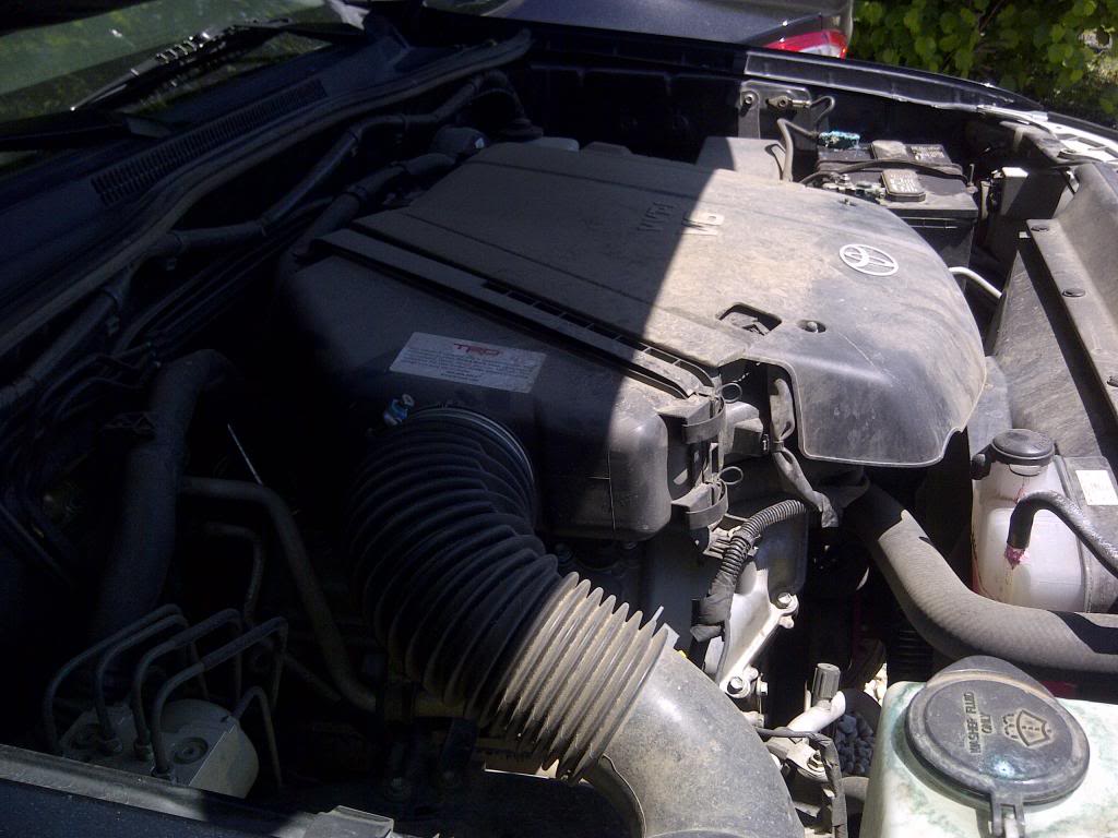

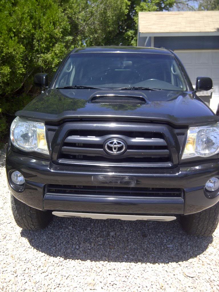

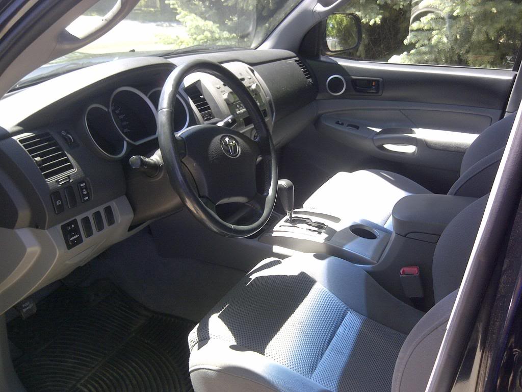

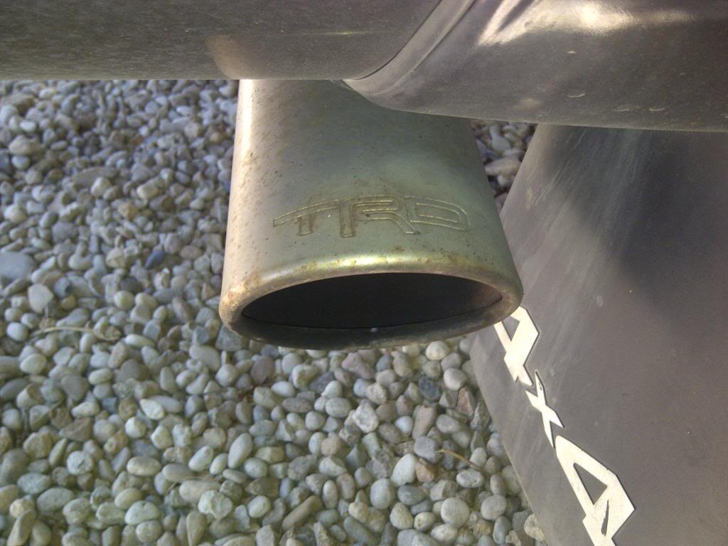

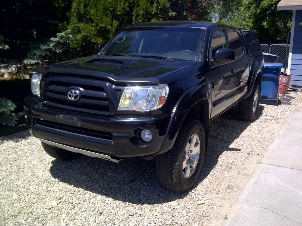

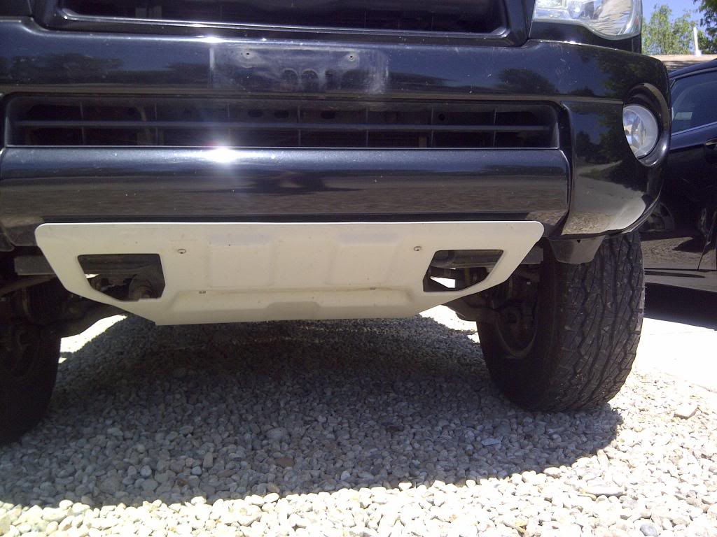

Well it's been a while since I worked on the Wookie Slayer. Things have been going pretty good with her although she is running a little too rich and I have that tracked down to a "moded" MAF that the idiot before me attempted. I do have some news though as my family has gotten a little bigger!
I would like to introduce the Wookie Slayer II. She is a 2007 Tacoma TRD Sport auto trans with a leveling kit, skid plate and TRD exhaust tip... Its extremely awesome...
