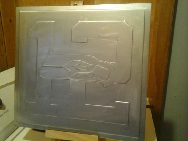

Thanks! I did a couple more, the first one is another cargo door, the second one is just a practice piece.

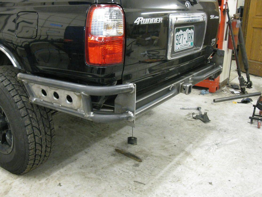

TAKE MY MONEY!!! That looks great. Would you ever consider building weld in panels for a TG bumper that has speed holes in it?
Thanks Jake! How thick would the panels need to be? My make shift dimple dies (aka: repurposed sockets) are probably not going to work well on anything thicker than 16 gauge...I want to get some "real dimple dies in a variety of sizes eventually.

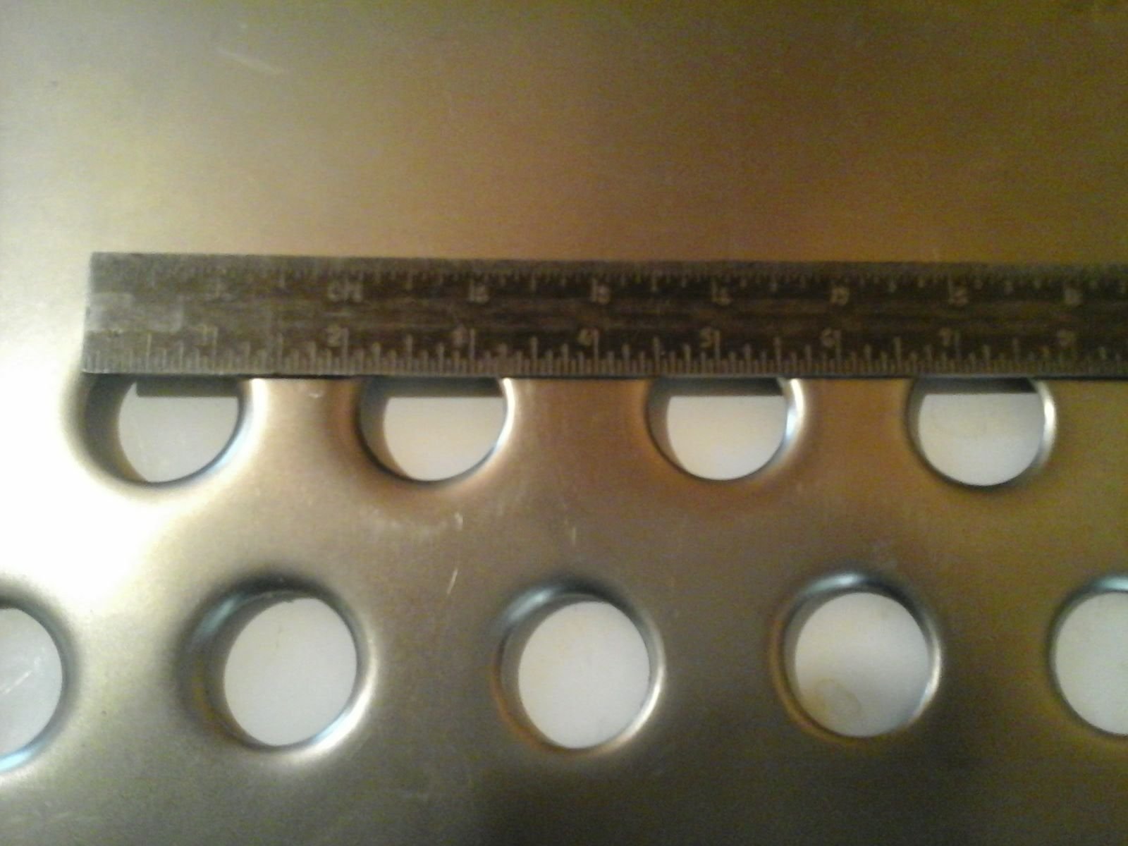

Honestly they'd just be for looks.
Something like this
Something like this
I could do something like that. My speed holes are approximately 1-1/8" across, if that would work. Maybe you could pm me the dimensions, or possibly a drawing with the layout and measurements and spacing of the holes. I have a few projects to finish first, some rear cargo doors and a set of door panels.

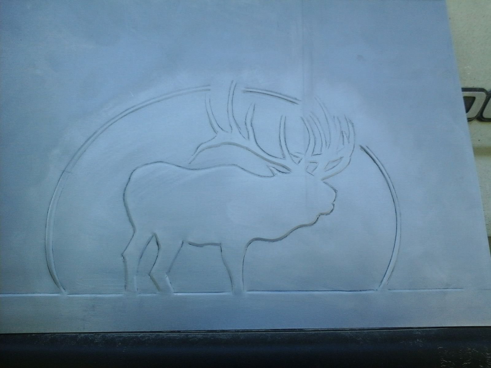

Not vehicle related, but I was practicing rolling some sheet metal did this one today:
the elk isnt finished yet, but its going to be an insert for some door panels Im makeing for a friends 86' toyota pickup

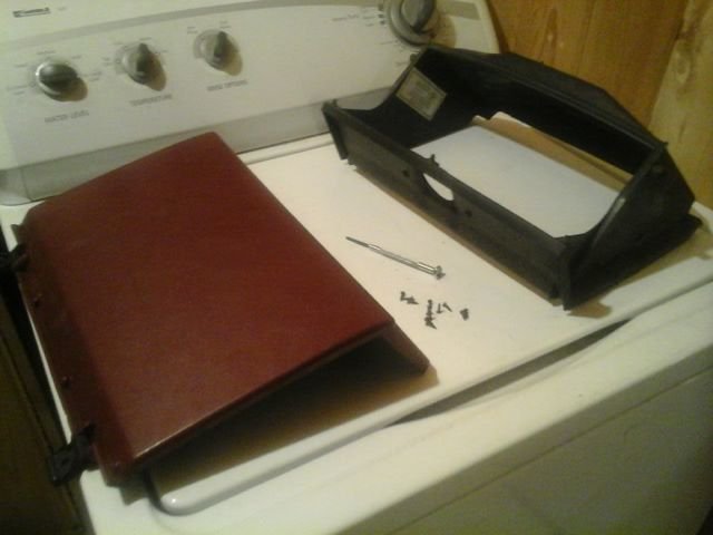

I'll take a look tomorrow. I have no problem using my glove box as a guinea pig, my interior is gutted already, one more part won't hurt anything, lol.
◆◆EDIT◆◆ Couldn't wait till tomorrow, lol...12 small screws and the glove box front panel can be removed. It looks like it would be easier to make the entire thing out of metal than trying to reattach the front plastic cover to a newer metal inner structure...

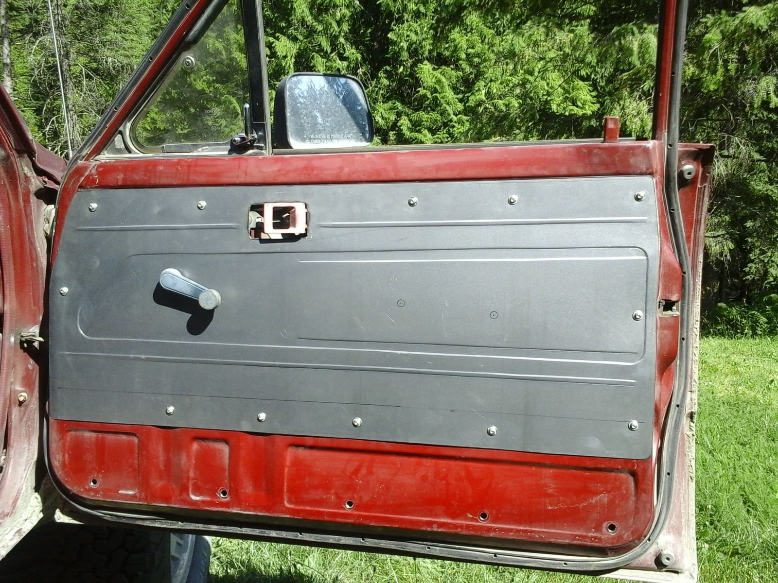

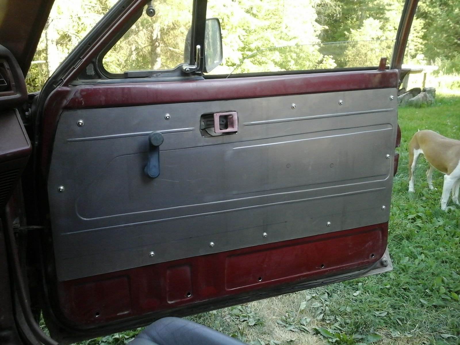

Here's a few pics of some door door panels I've been working on:
Factory door panel off an 86' pickup
Kind of copied the factory door panel's overall look, made a few changes but kept the basic design. I ran into a snag with the door handle plastic trim peice not fitting on my door panel because the sheet metal is so much thinner than the factory door panel, the plastic door handle trim sticks out way to far...have a couple ideas to make a new trim peice.
Im finding the limitations of my beadroller doing the door panels. I couldn't finish the center design because my beadroller doesnt have a large enough opening to make the turn in the middle off the door panel. I need to upgrade soon! I got a new toy! All the new panels will get the hardware plastic hardware replaced with nutcerts and stainless steel M6x1.00 button head allen bolts
