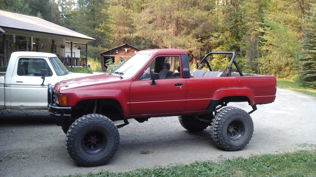

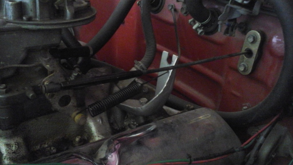

I'm not sure what the issue was with the fuel leaking into the oil, I figured it must be from trying to start it (when the distributor gear roll pin was broke and the gear was spinning free) and not having any spark. Now that I have the spark issue resolved, it fires right up, it doesn't seem like there is any issue with a leak.
Now I'm having a heating issue with my new radiator. I drove it to work the next day, and the temp gauge was running between 200 to 220° with the electric fan on and when I shut it off at work it heated up to 240°. It never boiled over, I left my electric fan running for about 30 min to cool it down. Like you mentioned, we'very been having some really hot weather the last few weeks. On the way home that night (11pm) it had cooled down outside a good 30° and my temp gauge stayed closer to 180° with the fan on. When I had my old toyota 3.0 V6 radiator in, the temp stayed around 190° at normal driving speeds without the electric fans on. I'm wondering g if maybe I have a air pocket trapped in the cooling system...?
The other problem I had was the throttle cable that I rigged up to replace the broken one. I just used a small gauge cable and some clamps I had laying around and replaced the old cable. I noticed right off that the throttle had a spongy feeling to it when pressed down, and it didn't feel like I had full use of the pedal. When I went to leave work, I only had about a 1/4 use of the throttle pedal. I checked the cable (the cable had a plastic clear coating over it) and the clamp was just slipping and stripping off the clear coating. I as able to pull out the slack and tighten it up again and made it home ok, but definately had to fix the issue. I ended up taking the throttle linkage off my old 76' Ford parts truck. It had the exact same carb as my 4runner. I just had to lengthen it about 6". Now the throttle response and feel of the pedal is 100% improved. I routed the throttle linkage through the same hole that the cable went through, just had to drill out a bigger hole in that bushing/cable grommet thing that bolts to the firewall with the 2 bolts in it. On the end of the linkage that goes to the pedal I just welded a 1/4 20 threaded bolt to the end, it goes through the hole in the gas pedal linkage where the cable used to attach, I put 2 nuts on there and I was done, works awesome. Here's a pic of the ford throttle linkage from the carb to the firewall, I didn't get a pic of the other end attaching the the gas pedal. I left the silver bracket there for the return spring for the carb. The upper part of the bracket used to be the cable stop for the throttle cable.
Had to take the top off!

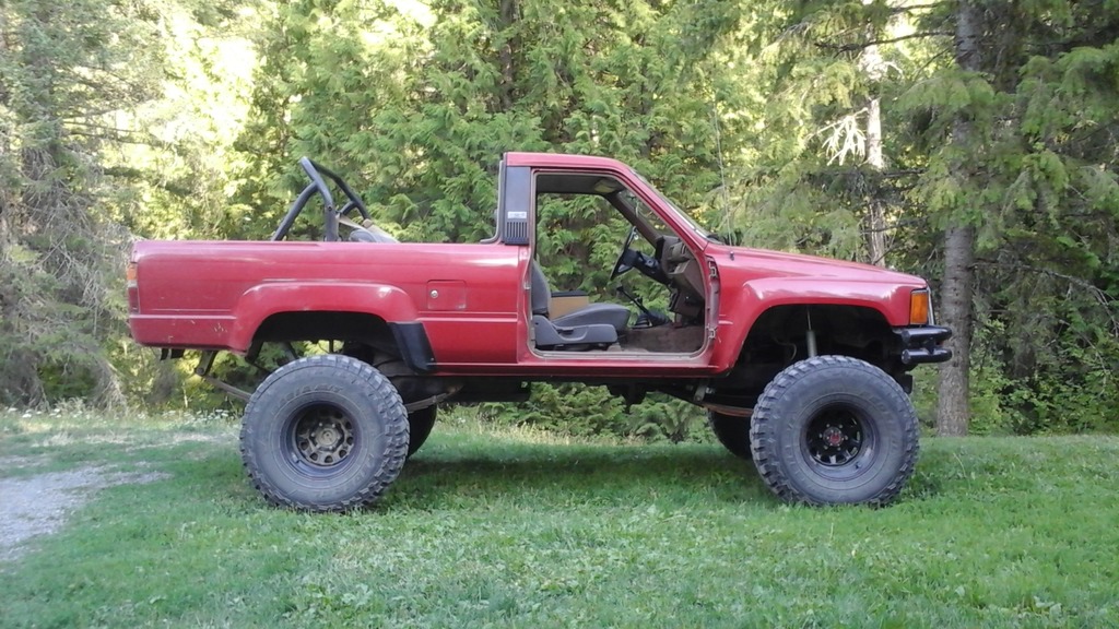

I took the doors off yesterday, trying to make some tube doors, I wish I had access to a tube bender like the one you ordered for your class, that would be sweet to be able to bend up some bumpers, sliders, roll cage etc! Look forward to see what you guys fab up in class this year!
