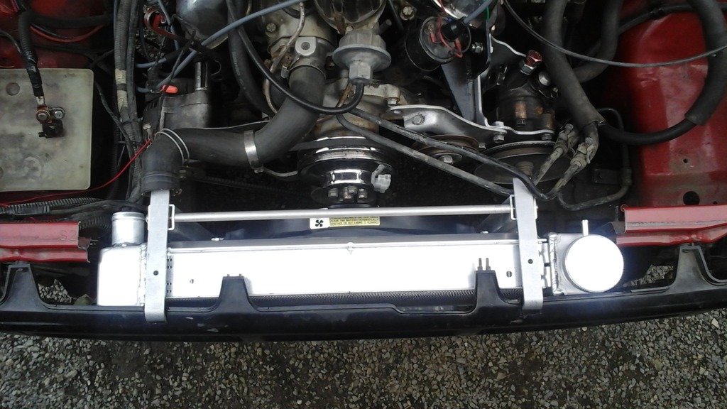

Yeah I ended up cutting alot, I kinda crossed the point of no return, got to make it work now, I think once I add the 1" tubing support to tie the two halves of the core support back together and get that bolted in and everything painted, I'll be happy with it. Glad your setup is working good for you, I never had very good results with pusher fans, but yours must be working good, especially in the Reno summers!

I'm also running an aftermarket Ford V8 radiator, I just went wider and shorter so I could push it forward and above the frame crossmember.

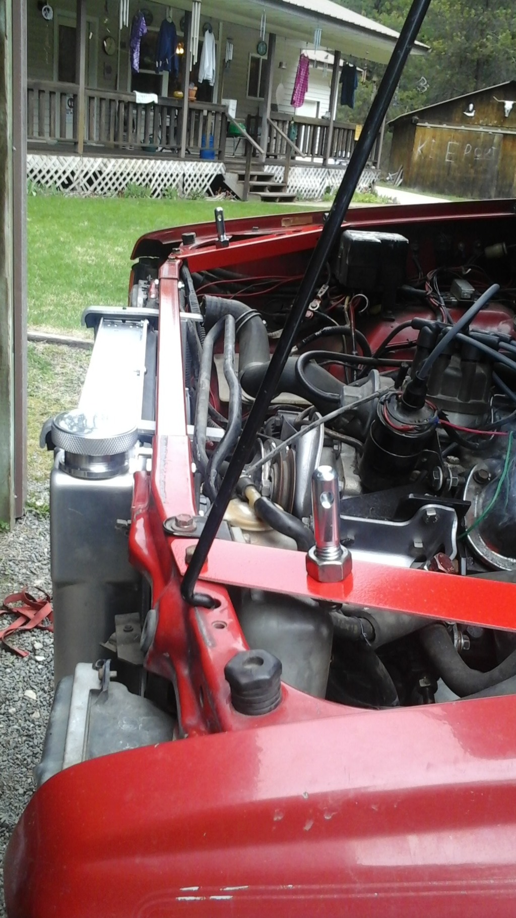

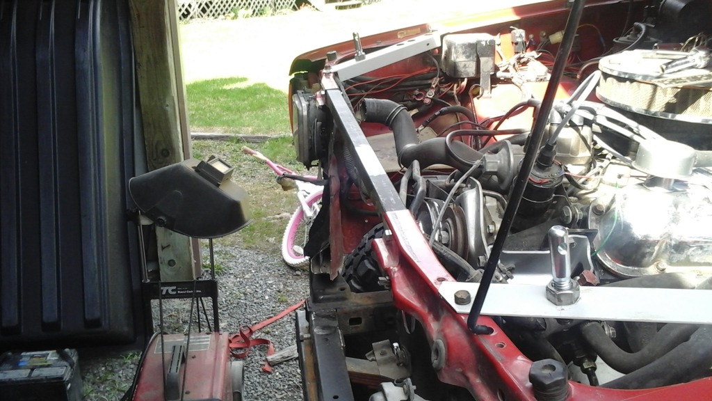

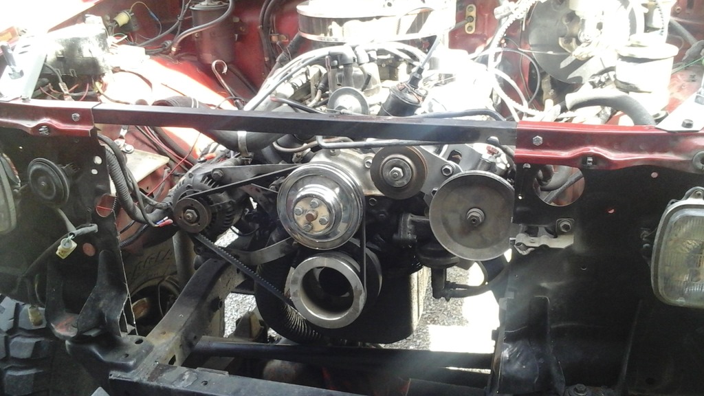

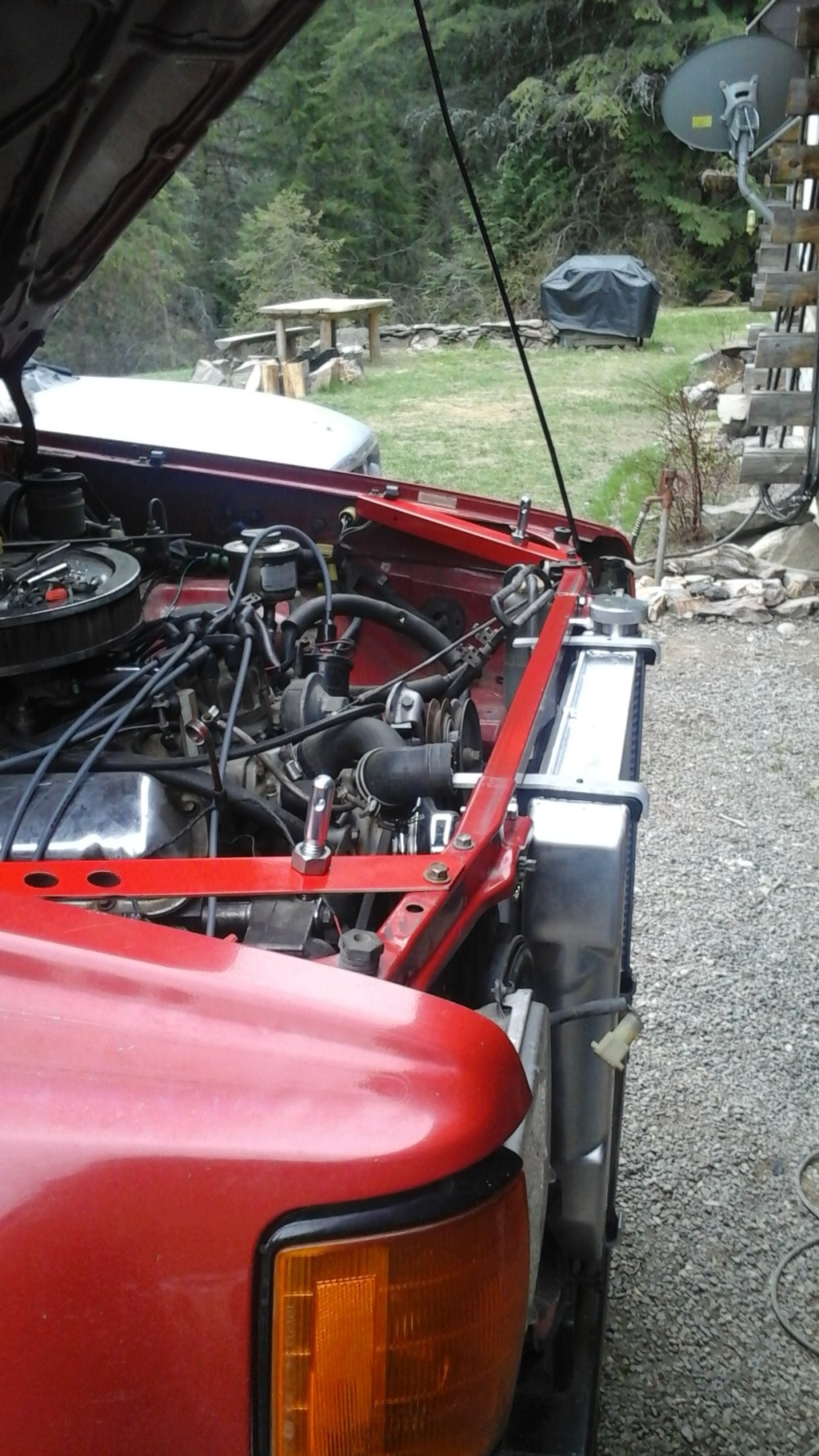

Got a peice of 1" square tubing for the core support.
Did a little painting, not an exact match, but I think it looks better. Painted the sports that the hood pins mount to.

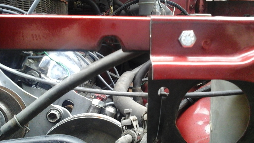

I had to cut a notch in the 1" square tubing so that it would clear the nipple on the radiator that goes to the overflow. Then I welded in a peice of round tubing cut in half to fill it in.
[/URL]058.photobucket.com/user/rustED71/media/4Runner/20150413_155932_zpsp3fn2a1i.jpg.html]Name:  20150413_155932_zpsp3fn2a1i.jpg

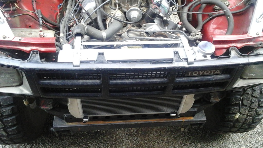

Is the grille going to clear it with some modification?
Old Apr 13, 2015 | 10:03 PM

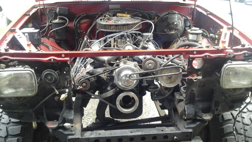

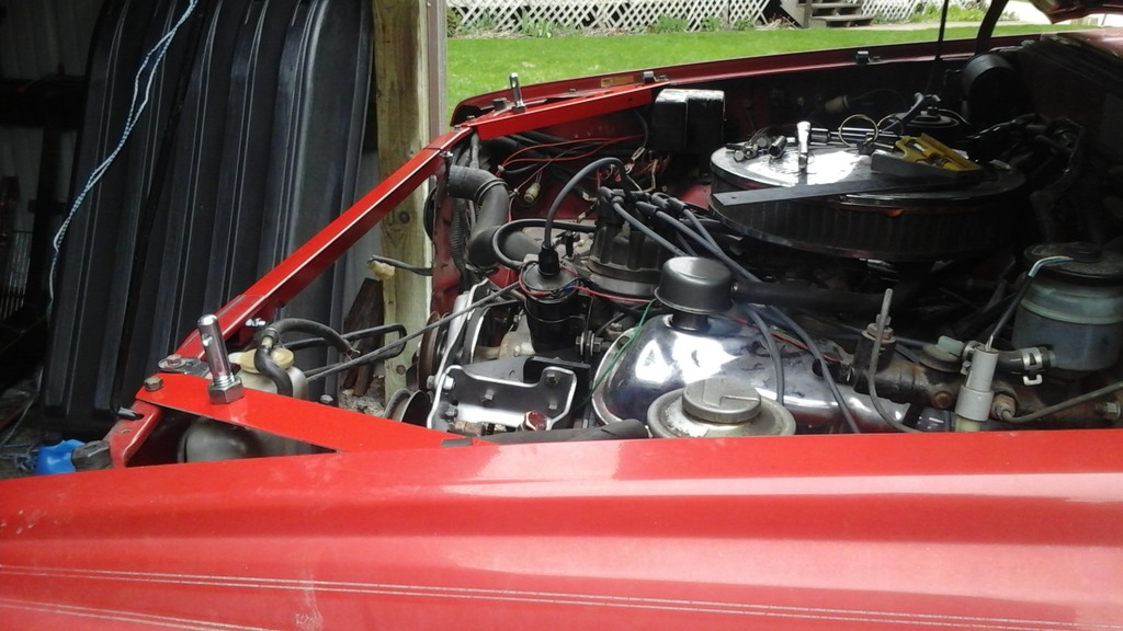

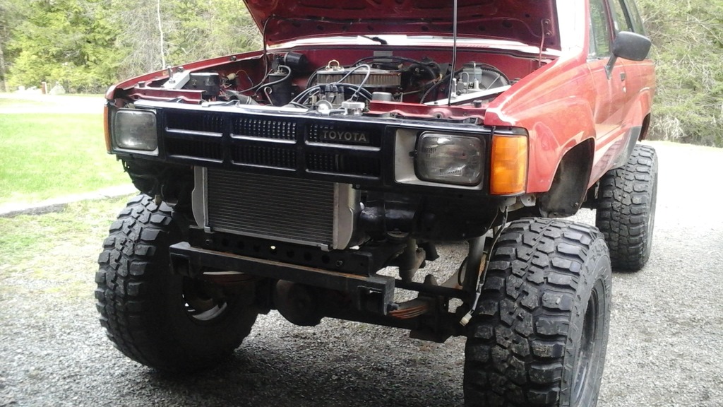

Yeah, it will clear, I had it installed last week and had to do some slight trimming on the inside, but nothing major, it doesn't show from the outside. Here's a couple pics: (I still need to replace my broken passenger side headlight bezel from when I hit that turkey, lol.)

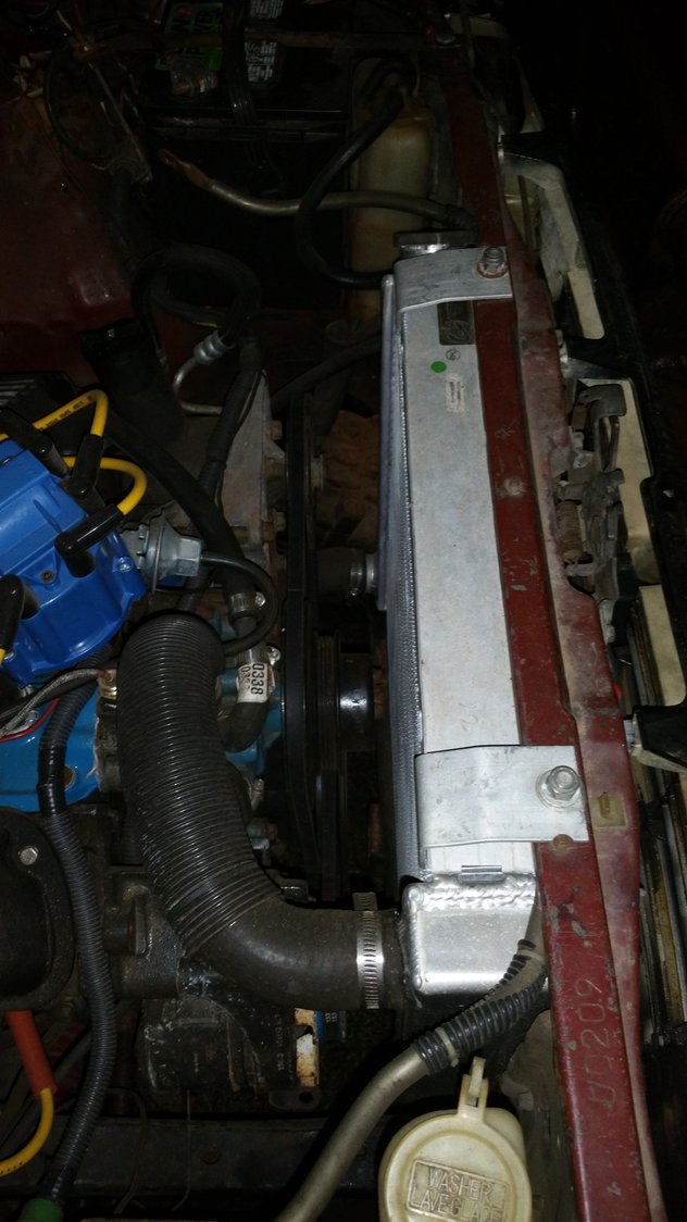

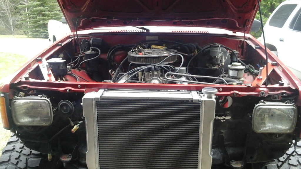

Well, I'm still not done, lol. I pretty much just have it mocked into place, made sure it clears everything and that the grille still fits. Now I need to fab some mounting brackets. I'm pretty sure the universal silicone radiator hose kit I bought is going to work, I still need to mock up the hoses and make sure. I'm off work tomorrow and Tuesday, so hope to finish the install over my weekend. Then I still need to replace the timing chain, its neverending, lol.

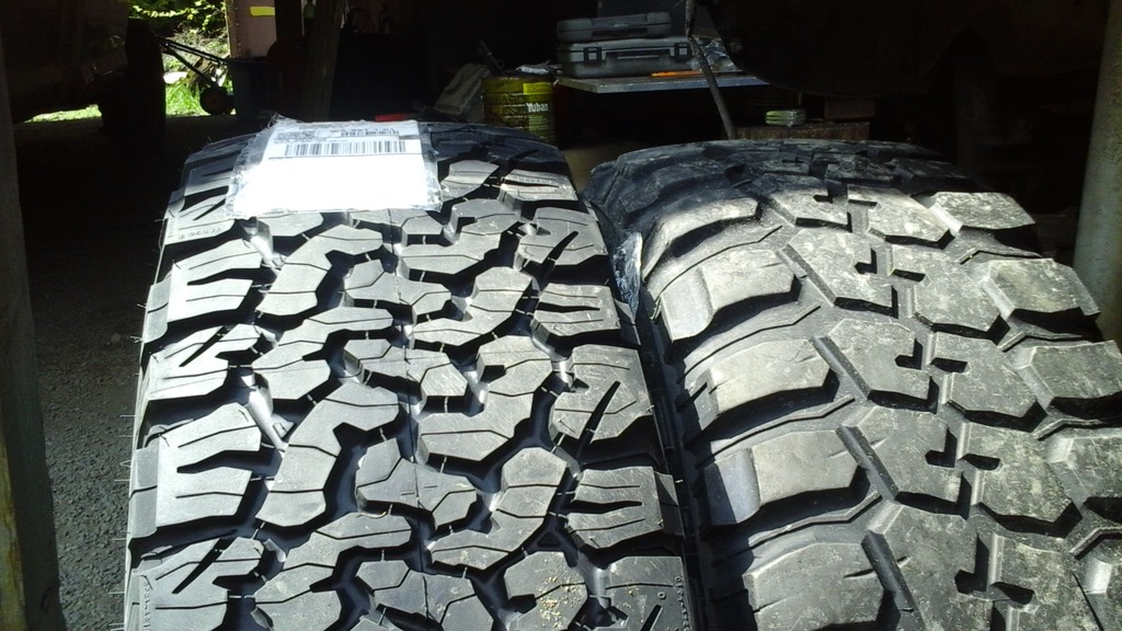

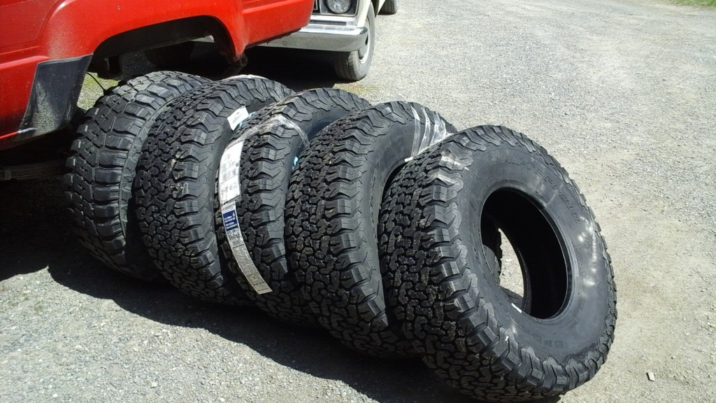

I GOT MY NEW KO2's!!!
Well I've been busy lately, and almost forgot about the tires I had won from BFG's Rocks to Riches contest! I sent them an email last week, they responded and told me that they wouldn't have a 35x12.50x15 tire size released until October, so I changed my size to 35x12.50x17's, and UPS delivered them yesterday!!!
^^^The BFG's are a little taller than my old tires
