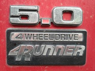

I just noticed the 5.0 on your tailgate and like that. I seen where you mentioned about just thinking of drilling a hole a little further behind. Been there myself and sometimes the answer is right in front of you and you miss it. I know how that goes. Great job.
Thanks Terry. Ha, ha yeah, the 5.0 above the 4wheel drive 4 runner emblem was what I had for my old avatar, lol.
Yeah , I think I was in such a rush because I dd the 4 runner, that I missed the easy solution the first time, lol.

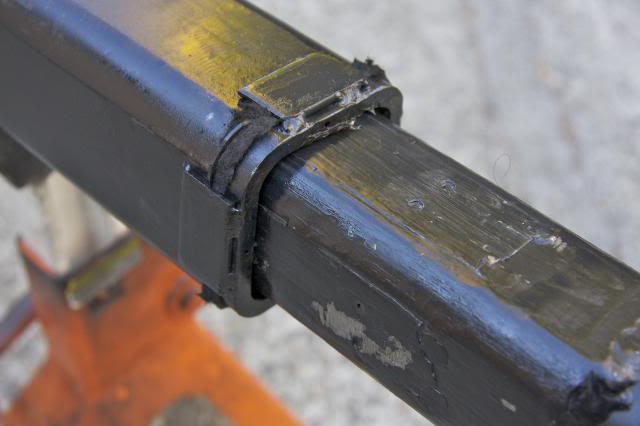

[IMG][/IMG]
Old Jun 19, 2014 | 05:10 PM
  #949
rustED's Avatar
Joined: Sep 2010
Posts: 2,716
From: Tri-Cities, Wa
Thanks Teuf for the pics, looks like once again I jumped the gun, should have done my research...maybe I'll canabilize my front driveline for the cardan joint, and find a replacement front driveline later...

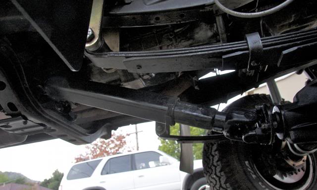

I did just that, took the cv from the front. I used UName:  IMG_2409_zpsdee824cf.jpg
Size:  36.6 KB joints on both ends of the front DS.
[IMG][/IMG]
[IMG][/IMG]

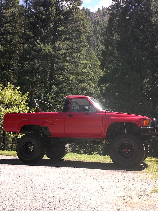

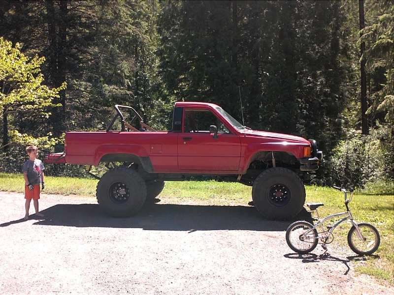

I finally got some use out of my offroad trailer project, lol. it worked out pretty good, next time I'll empty all the tools and junk out of the bed of the trailer first!
^^^I got my boys approval!
I got it all washed up, need to give it a wax job! Should be a nice drive to work today...
