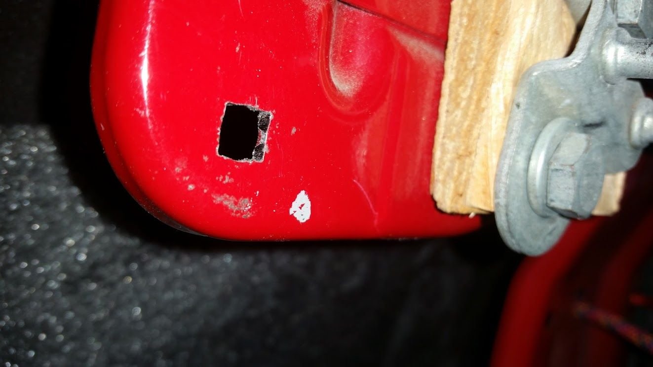

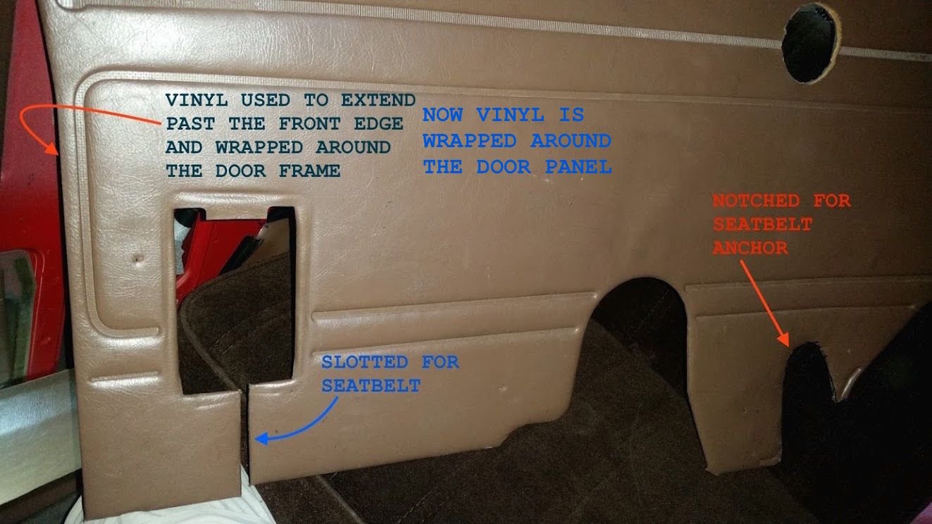

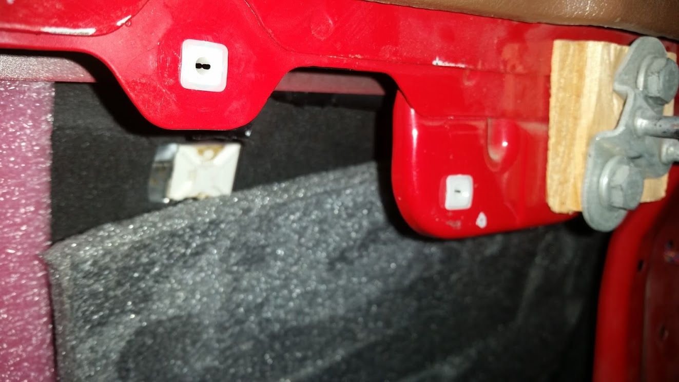

Deleted Hidden Fasteners and Streamlined Inner Side Body Panel
I detest hidden (pop-in) fasteners and
I hate having to remove other parts in order to remove / access another; in this case:
1) Having to remove the side window garnish just to remove the inner body panel, say to work on the speaker, etc.
2) Having to unmount the front seatbelt, and the rear passenger seatbelt anchor to completely remove the panel from the truck.
Solution:
I removed the pop-in fasteners, replaced then with nylon expansion nuts for 7mmx7mm hole and #8 finishing screws from ClipsAndFasteners.com.
I trimmed the top edge of body panel board by about 1/8 inch and glued the vlnyl cover back. Also trimmed the edge of the vinyl that wraps around the door frame and glued it back to the board.
I slotted where the seatbelt goes through the inner body panel board.
Notched where the rear passenger seatbelt anchor screws THROUGH the body panel board.
Original Mounting Holes - Round
Mounting Holes Squared
Expansion Nuts Installed
MODIFIED BODY PANEL
OK, OK... NoT only did I notch this - I BOTCHED IT- LOL!
BODY PANEL INSTALLED
Now I can easily remove or re-install for spares storage by using a screwdriver. No need to read the manual to figure out those stupid clips.

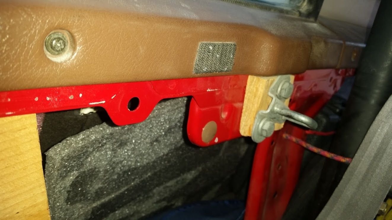

Cubby Hole in Side Body Panel
I disposed of the inner quarter panels to replace them with full door panels, and there's a nicely-placed opening between the front side panel and the roll-bar. Perfect for a cubbyhole (IIRC, the SR5 has a similar one but accessible by the passenger.) This one is accessible from the rear deck when camping in there. I think this would be perfect for pocket contents, phone, glasses, headlamp, etc. when camping in the back. I amy also put the rear window switch in there.
So, while I'm in there cleaning up the body compartment, I made an interim compartment out of foam. Should be functional now. Will make it pretty later...
