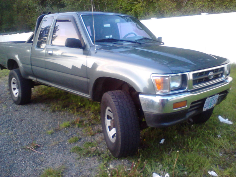

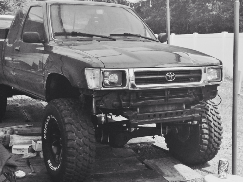

Hey guys, Im 20 years old heres my first toyota pickup. Ive had it for 2 years its a 1992 extended cab v6. Heres its transformation with some big plans
When i brought it home:

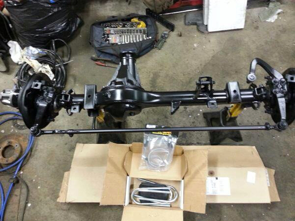

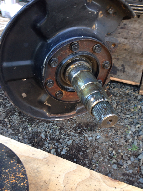

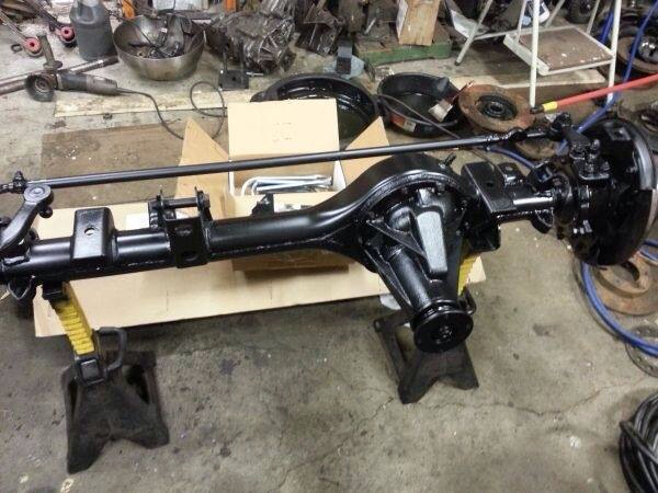

4wd didnt work for some reason. I wanted to ditch the limited stock travel and ADD hubs for a solid axle and manual locking hubs. So i picked up a 1982 completely rebuilt solid axle.

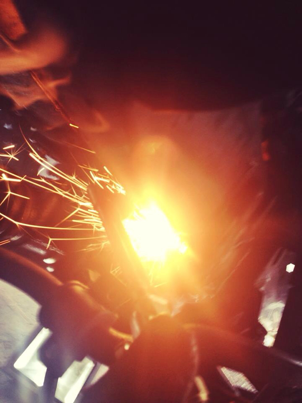

Then i welded some armor and reinforcement for the stock housing.

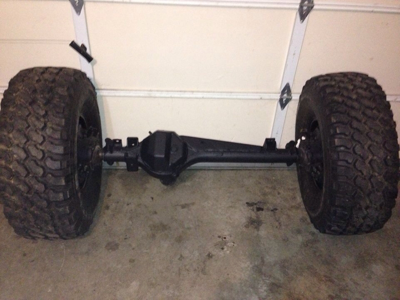

Once i got most of the parts I needed I began the SAS. Chopping off the IFS is probably the biggest pain in the ass part of the swap. Grinding the frame smooth took a good time.

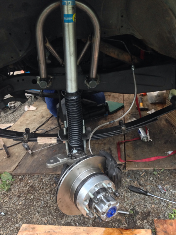

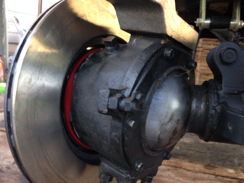

Then i welded up the front hanger and cut the frame tube holes. Mounted the leafs, got the axle under, got my shocks setup, brake lines extended, fj rotors, v6 calipers, steeeing, etc.

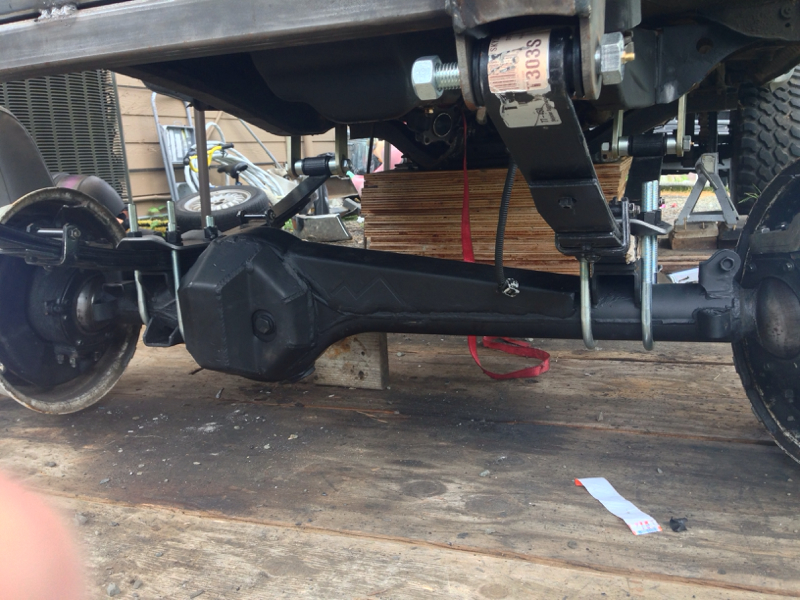

Was able to get it standing and tested the flex and everything lined up and was welded right the first time around. I took my sweet time double checking measurements, angles, etc.

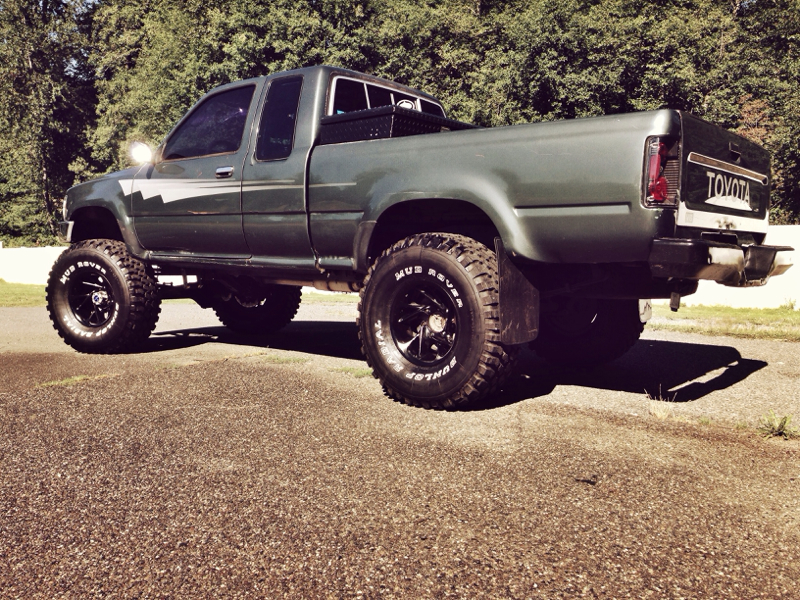

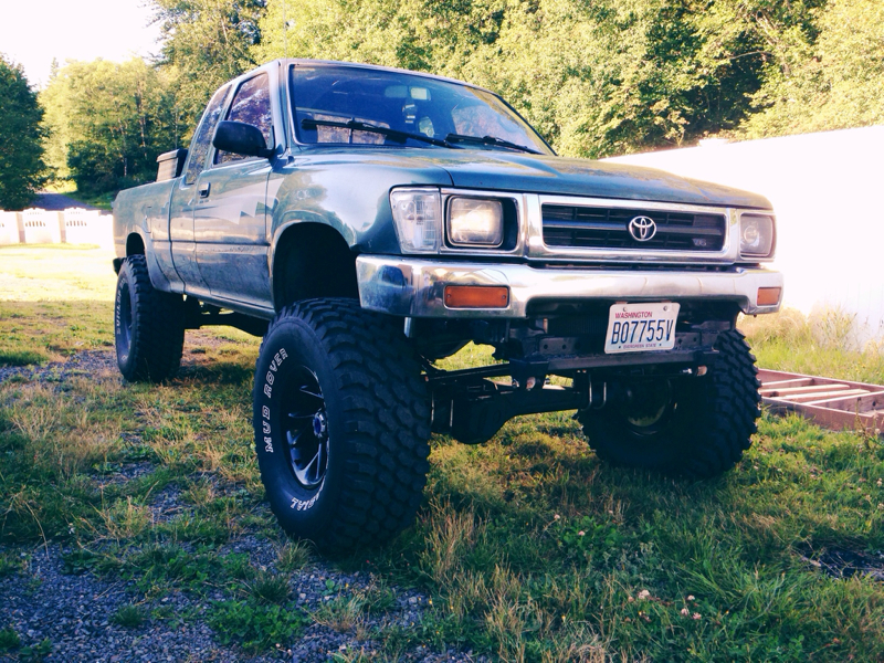

And how she stands now:

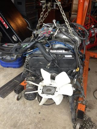

So update on the 3.4. I bought the motor for $900 with all accessories and was told it only has 40k original miles. I believe it cause the block is pretty clean from grime and oil. The guy i bought it from didn't do anything with the motor it was the guy before him that used it before me. So i wasn't able to get much accurate info about the motor from whom i bought it from, good deal nonetheless so no worries. I found a few things on the motor that raises some flags that this might have been part of a previous 3.0 to 3.4 swap. Here is why:
-Originally this motor was an automatic but it has a clutch on it. The ECU it came with is for an auto 4x4.

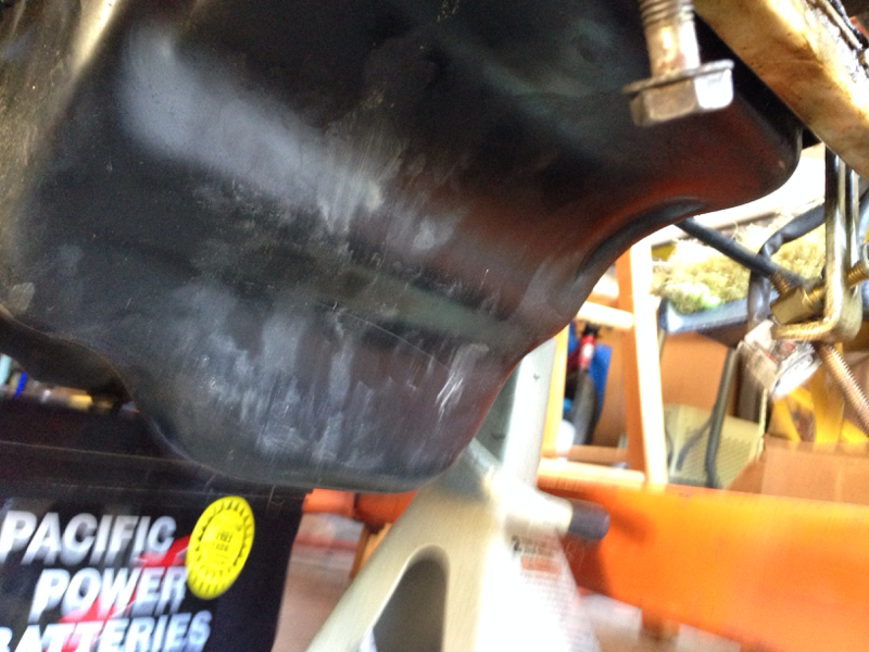

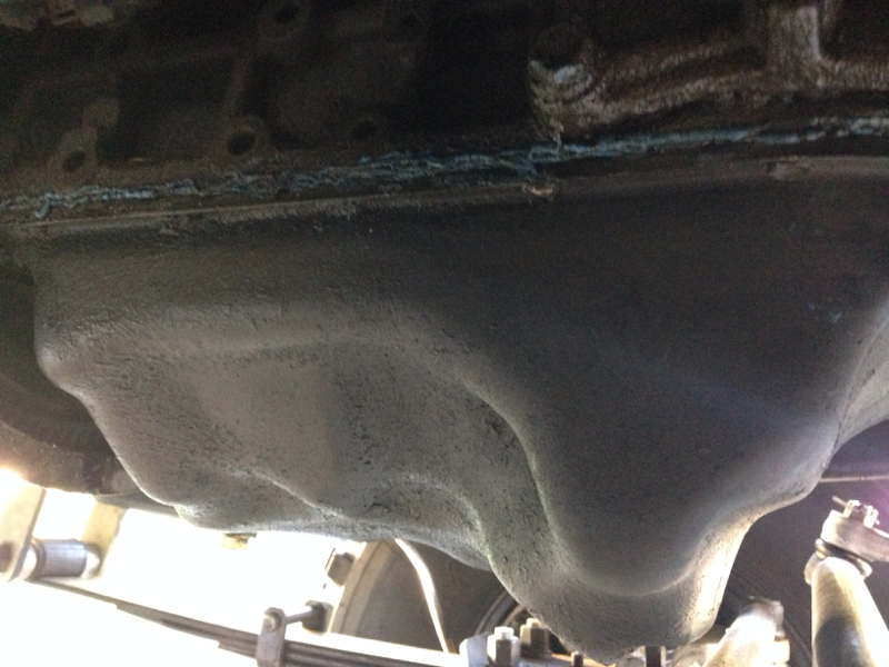

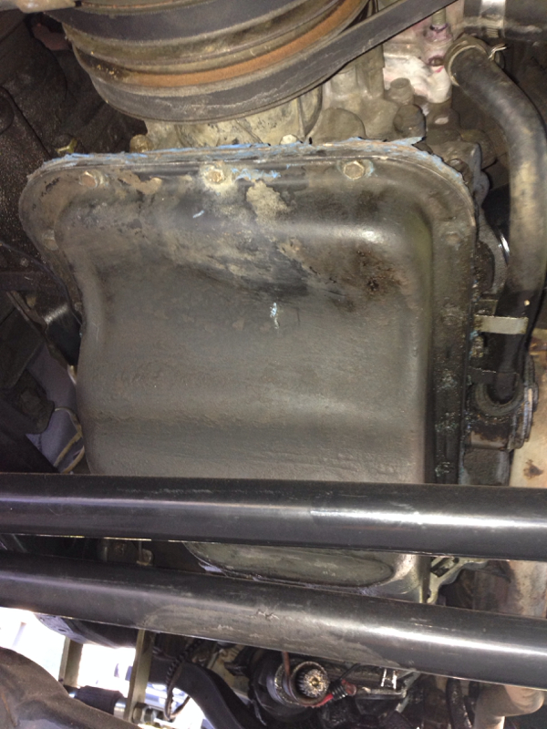

-The oil pan on the 3.4 looks very similar to an IFS pan for the 3.0. I looked at my 3.0 i currently drive and looks exact. See pics below:
3.0 Oil Pan
3.4 Oil Pan

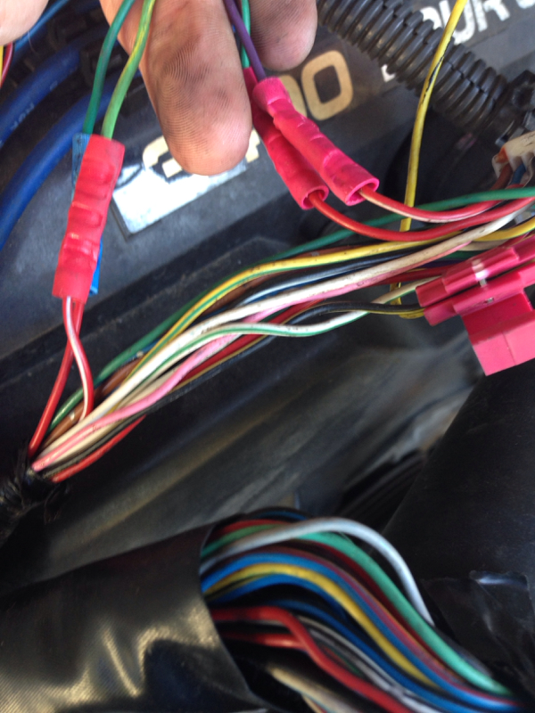

Also the wiring is looks to have been tampered with as its all labeled and some wires are spliced.

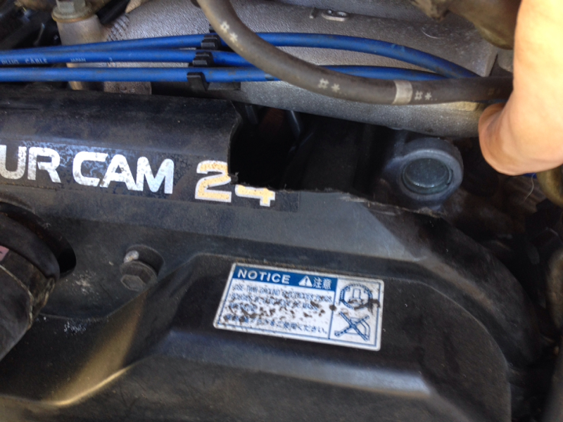

Also the timing cover was intentionally cut, looks like the same way the supercharger guys do to run the belt to the crank. Can anyone confirm?
So right now im trying to source down a manual to findout more about the wiring and seeing what all the labeling means that was done beforehand.
