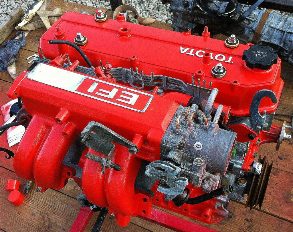

Here's a pic of my engine finished up
It's installed now

Very Nice!! glad to see it back together and running well!! new injectors seem like a good deal too...

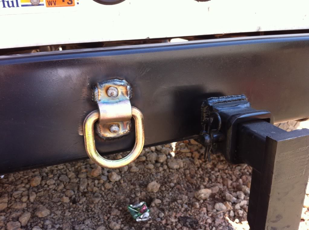

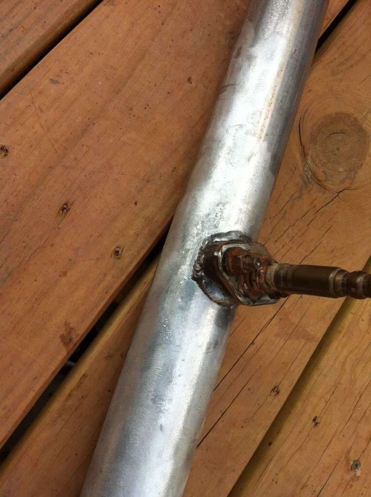

Made me a nice little hitch bumper today. I'm really proud of the outcome Name:  null-184.jpg
Size:  220.3 KB I still gotta few little things todo. But the main design is done and mounted.
Added some D Rings this morning.

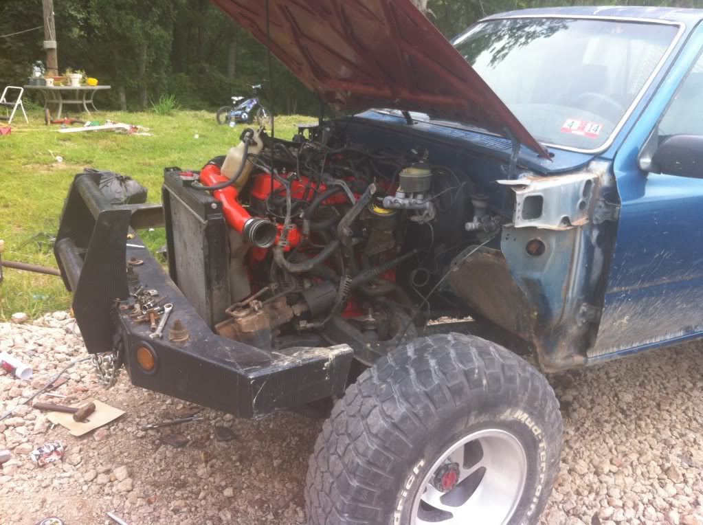

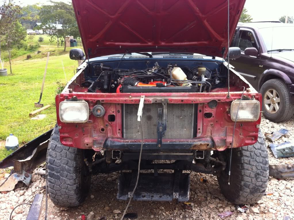

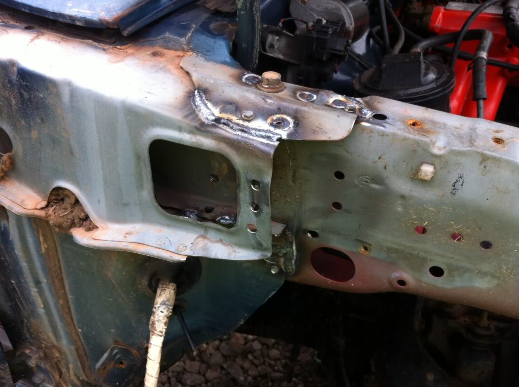

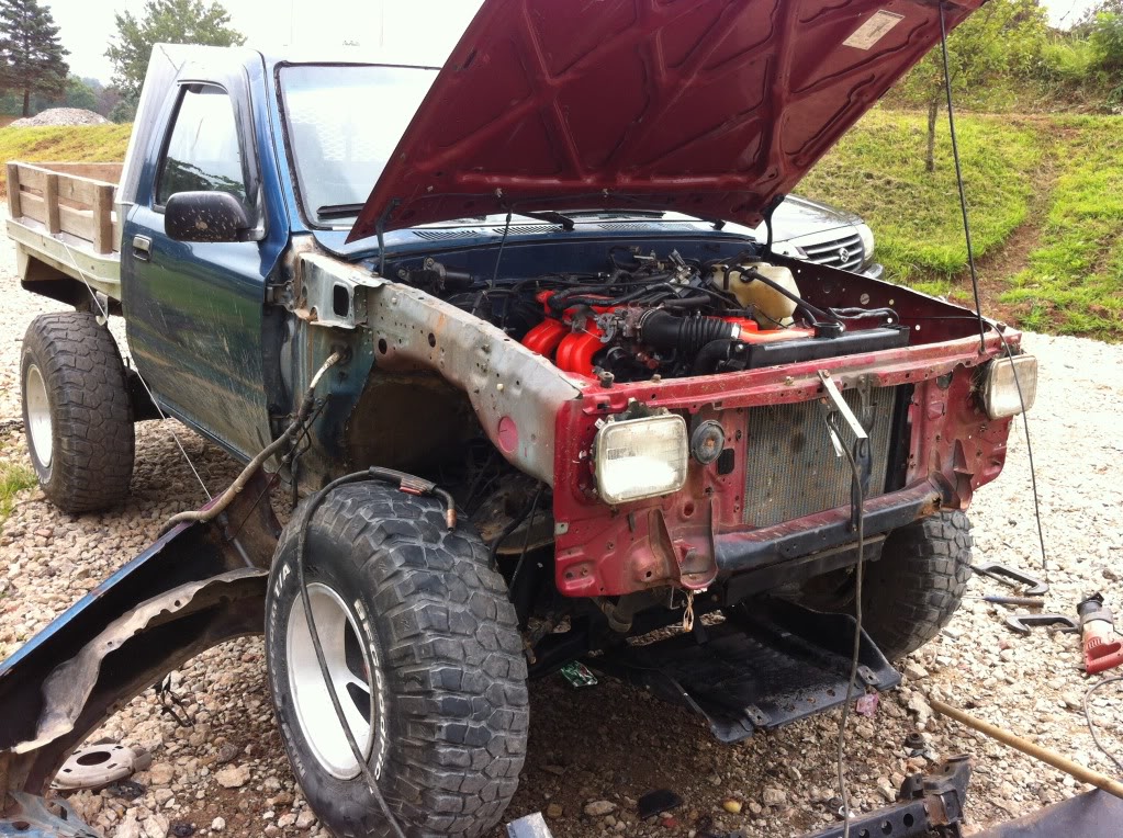

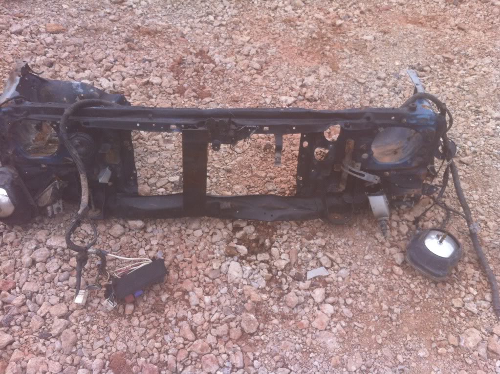

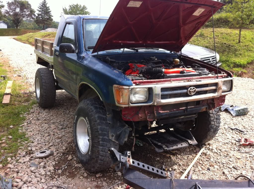

Well after months of having this truck I finally decided to change out the front apron and core support. I've never done this before which is why I never wanted to do it. But I have plans on painting my truck on Friday so I decided I'd tear into it.
First off I started on this around 10:00AM. I removed both front fenders and all components that are mounted to the inner fenders and core support. I then started drilling out spot welds and cutting with a reciprocating saw.
Here is my replacement that I removed off a 94 several weeks back

Now for assembly

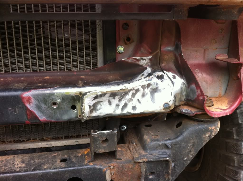

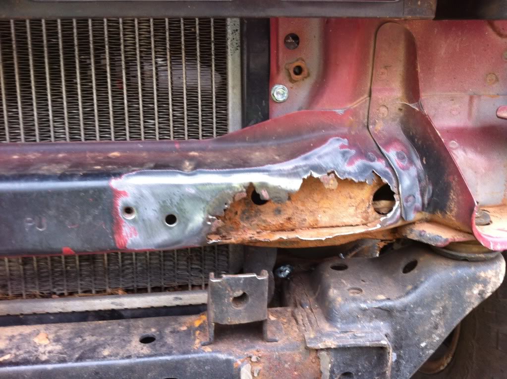

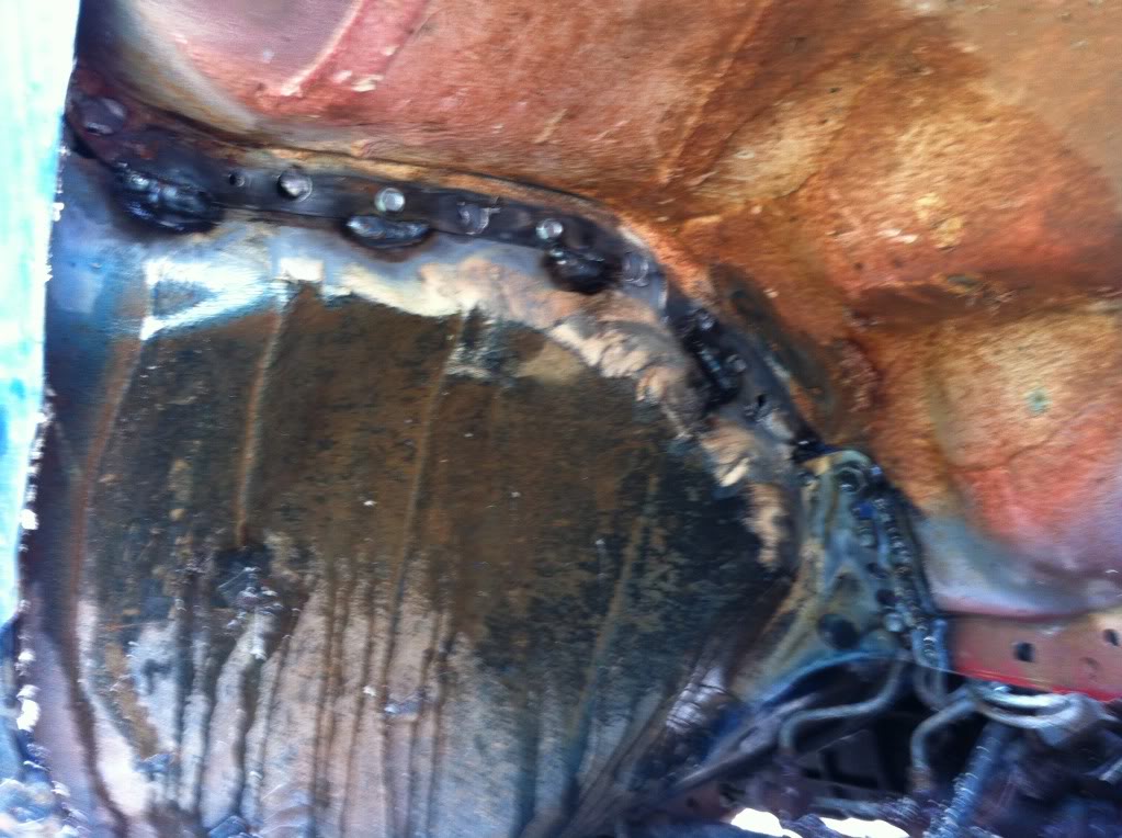

Had to patch a hole.
