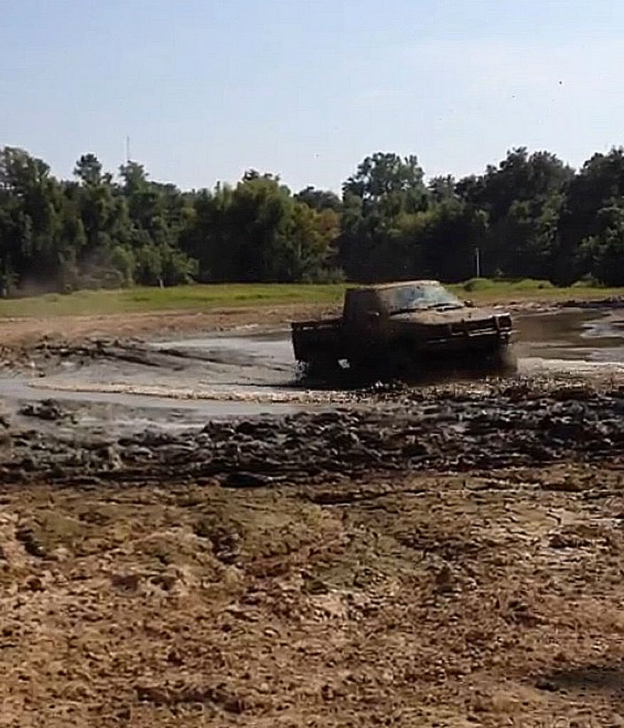

after mudding at bikini bottom with mike!

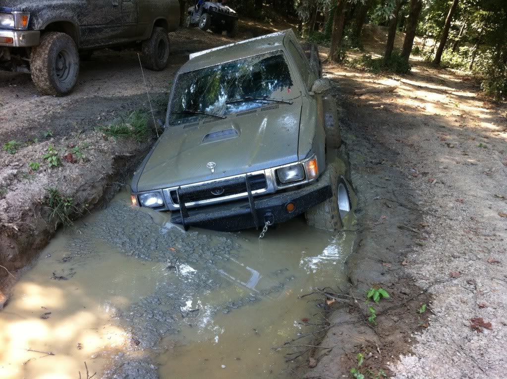

We mostly played in mud. I must admit I did get stuck twice. The first hole had a ledge that I couldn't bounce over so some Chevy pulled me out.

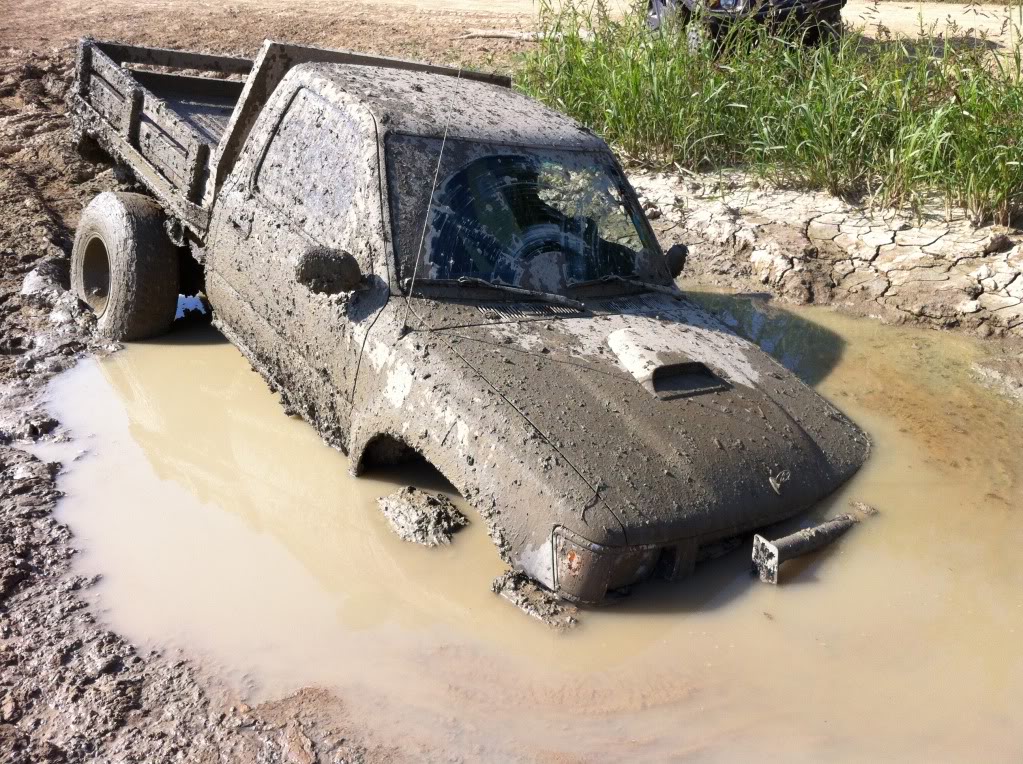

The second time I got stuck really ended my day. I sat and looked at the hole for several minutes before I chose to try it. As soon as I drop into the hole it was over. The hole had about a 4' drop off. It happened so fast that I couldn't even hit reverse. As soon as I seem the water hit my hood I shut my truck off. I was just seconds to late. The water went straight down my intake and hydro locked my engine. After I was pulled out I tinkered with my truck to get the water out. Once I dried it out I tried starting it and my starter wouldn't engage. Forcing me to bump start. It started fine except its knocking like crazy. Before I made it back to the main road it blew up. I lost all my power and it sounds as if the rod is about to drop through the oil pan. Thanks to Jackie and her husband they pulled me back to AR with a tow strap. Here's a pic of the hole that killed my freshly installed 22RE that only lasted for 2600 miles. Lol

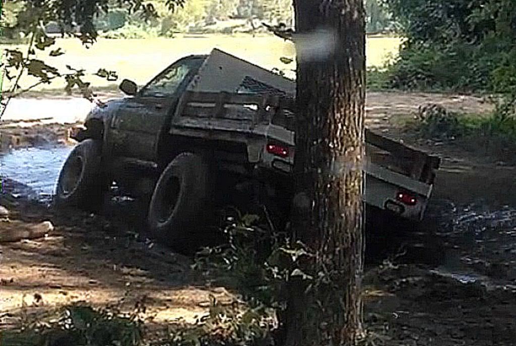

Here's some more pics.

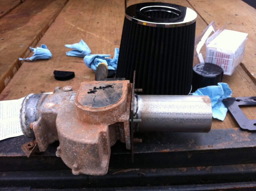

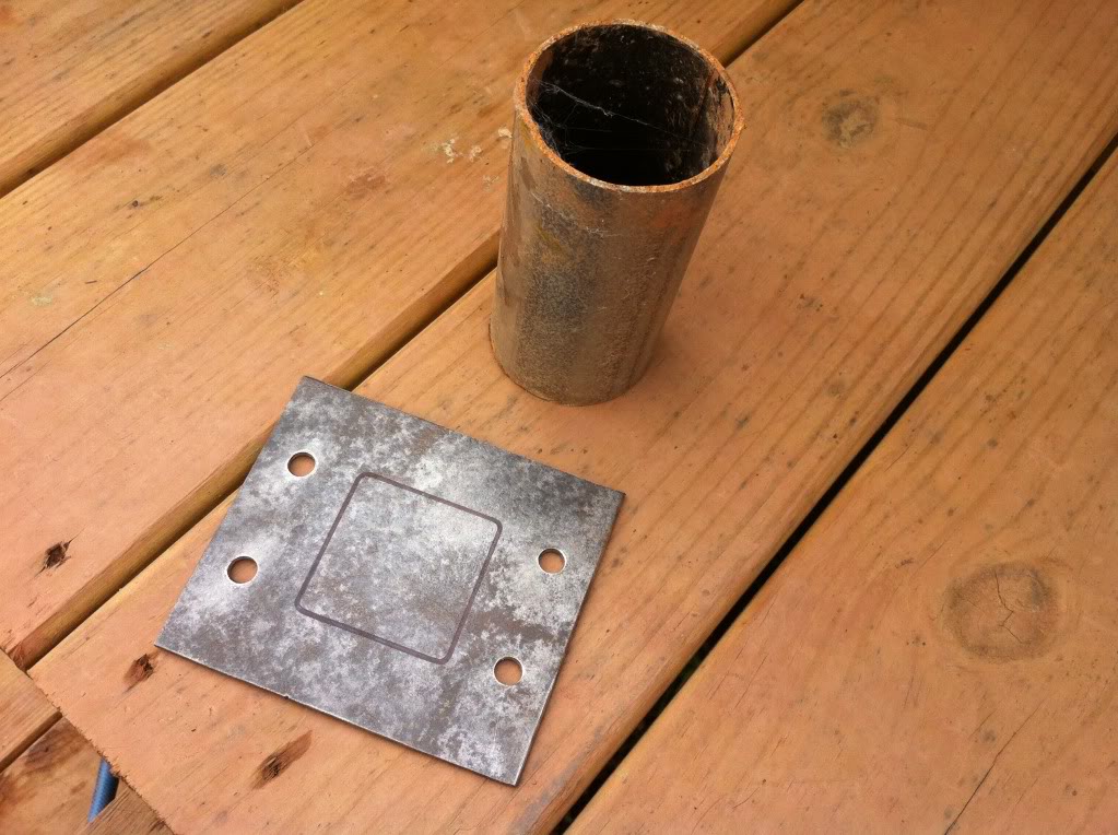

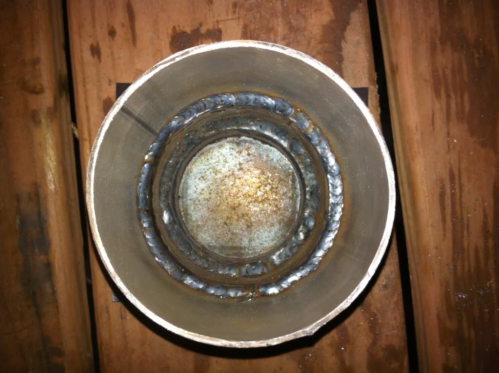

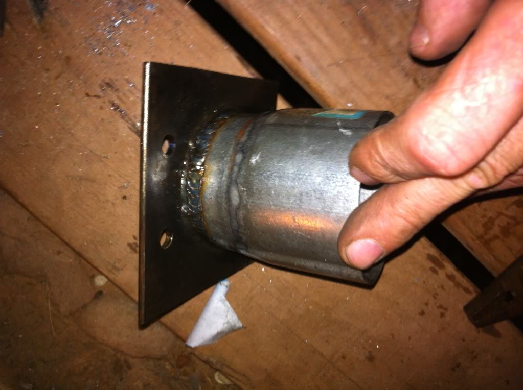

Anyone know what I'm making?
How about now.
Now I gotta get another price of pipe to go from 2 1/4" to 3". Then shorten the pipes and weld them together.
Please note that AFM is not a good one lol. I'm just using it for the mock up lol.
Once I'm done I gotta relocate the battery, install the engine, and break it all in. This little guy should run like a champ when it's all said and done. "I Hope"

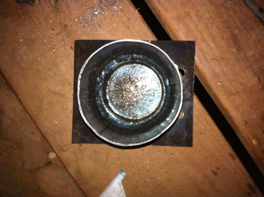

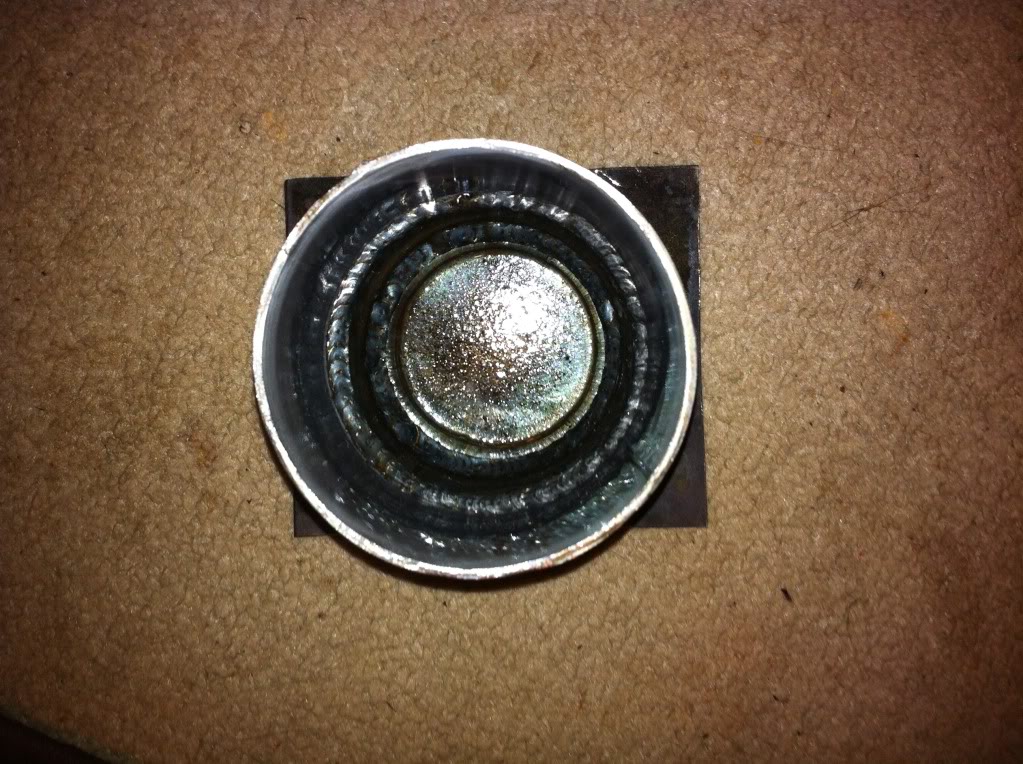

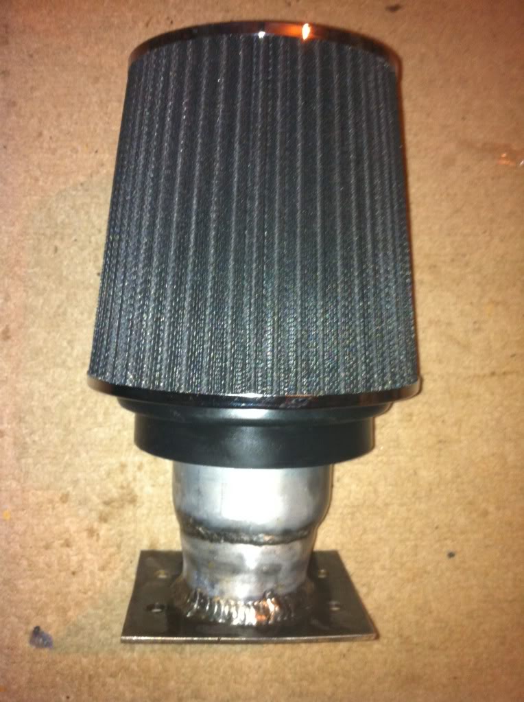

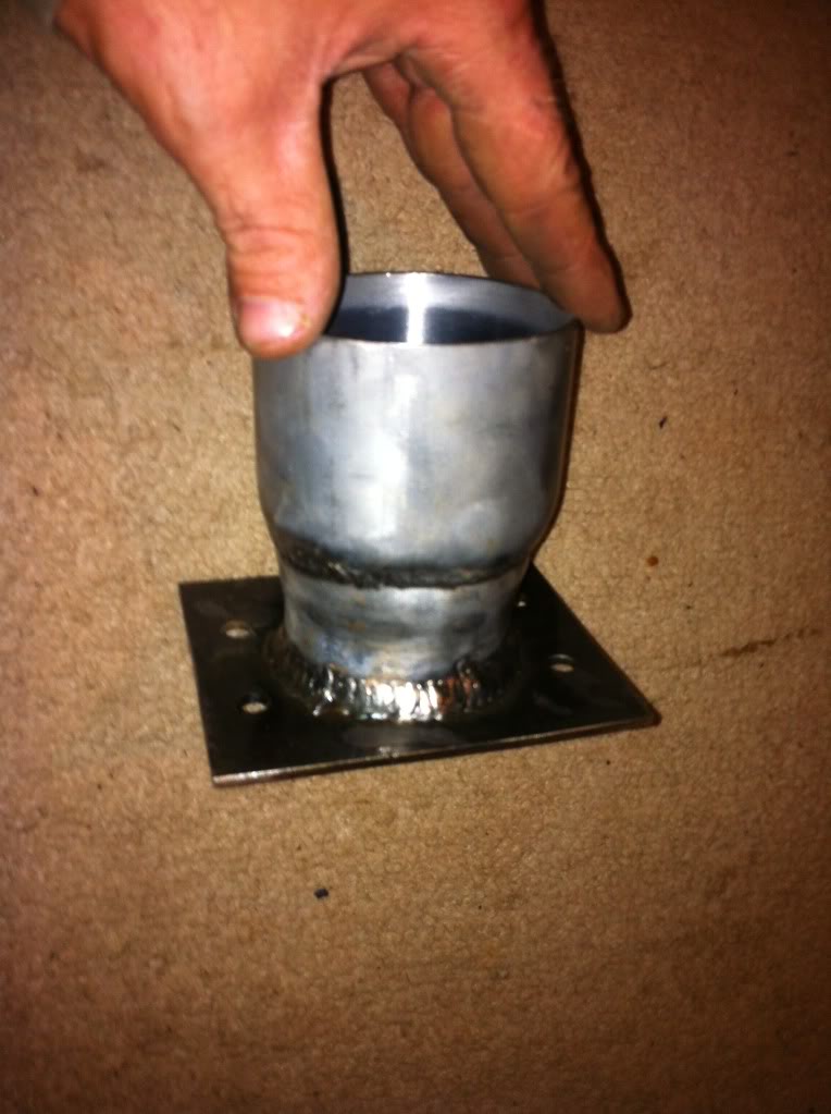

Okay... It's finished...
Mikes Custom Cone Filter Mod
All that's left is cut out the center and paint it.
Whatcha think guys...
If lots are interested I can build and sell ya know
