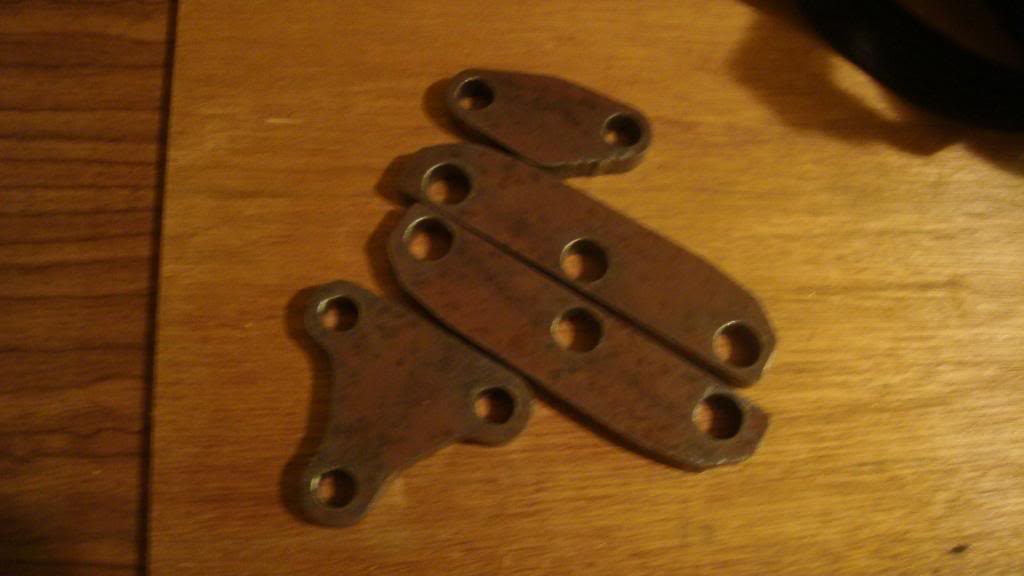

Ahhhh ok, so it idles down after its warm i assume. You get rid of the egr system?? Im assuming you dont require it.
have any blockoff plates?

No I don't have any. I left the manifold tube on and welded it shut. I then cut the EGR in half. Welded it shut then bolted everything on.

That works too, ive done that. Same principle.

Yeah the plates are just cleaner.
I was looking at getting the complete deal from LC. I would like to get completely desmogged and all prior to buying all the plates. My truck had factory air so I have all those plug-ins and vacuum lines that need disposed of along with a few other things. I'm just unsure were to start. I'm trying to clean as much junk out of my engine bay as possible. Keep in mind I have to replace the entire front clip. So what's not needed will be less to put back. And a header will be coming soon. I have the TriY headed on my carbed 87. I'm unsure of what I want for this one.

I love lc's stuff, cant afford it though. KelvinB made me plates. Plenty of threads on here that tell you what sensors n vac lines you dont need. Im in the process of doing it myself on my runner.
