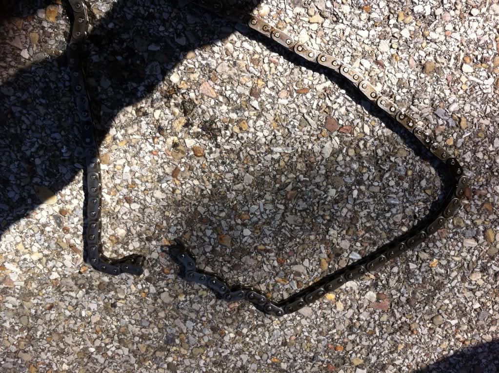

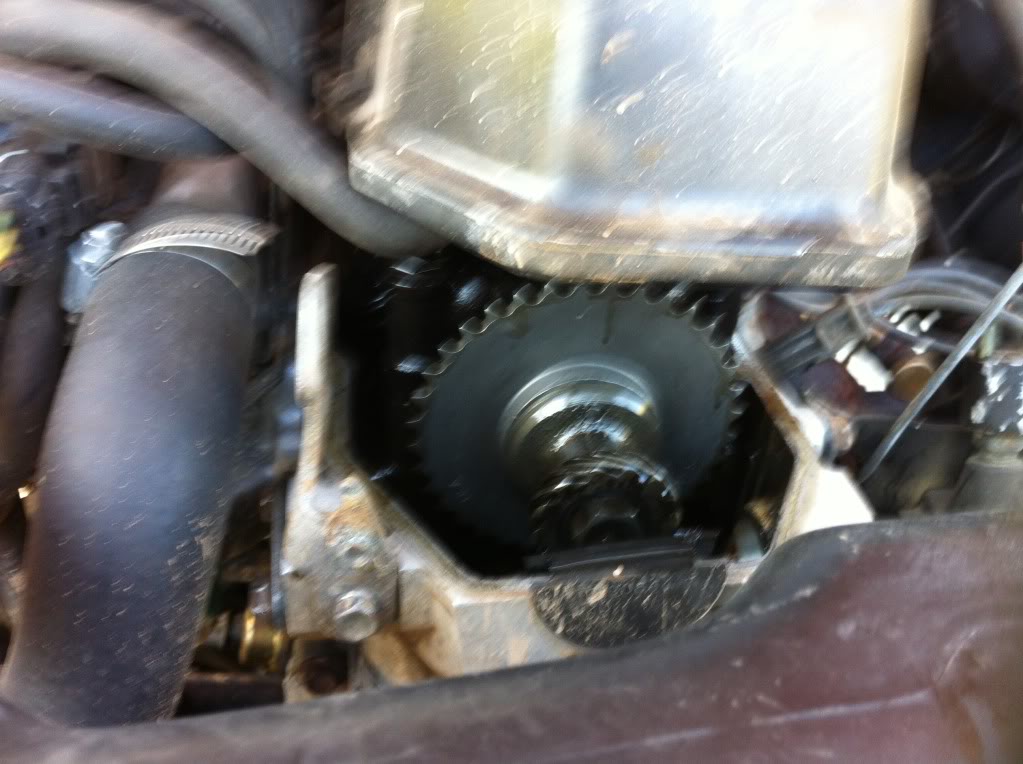

Update.
11:15AM Friday April 26 2013
Setting on side of interstate. BROKEN TIMING CHAIN.......... I have 1,633.4 miles on a brand new timing chain that failed.
Guess I'm back at step 2 again.
How tolerable are these engine. Will valves smack piston upon chain breakage. I shoved in the clutch almost immediately although I was running about 75-80 mph when it broke. So just curious if I have a junked engine or just need a new timing kit.

That stinks man. As far as it being an Interference engine, some say yes and some say no. I believe that there could be a possibility that the valves could smack the pistons under certain circumstances. But You might be ok. I would just pull the head an dsee whats going on and if any valves got hit. Then go from there.
Yeah I've cranked it over thinking I blew a fuse then I noticed it didn't sound right so I pulled cap off and noticed button wasn't turning. I did notice that my cam is almost perfect on TDC. I can't hear anything that sounds as if piston is in contact with something. So I'm hoping I just need a new timing kit. And gasket kit this really sucks. I took alot of time in assembling my engine only to tear it apart and do it again. Owell.

Update:
Got my truck fixed today. I tore it down and everything looked great except the plunger and bottom gear. The plunger was wore completely through the rubber bushing and the bottom gear was missing a couple teeth. I put a brand new timing kit in it today and it fired right up. Filled my fluids back up and drove it. It seems fine. There's no hesitation or any strange noises. Thank god no bent valves. I will take a couple pics of the old timing kit tomorrow to show you guys. Yet to this day I have no clue what caused this malfunction but its fixed now
