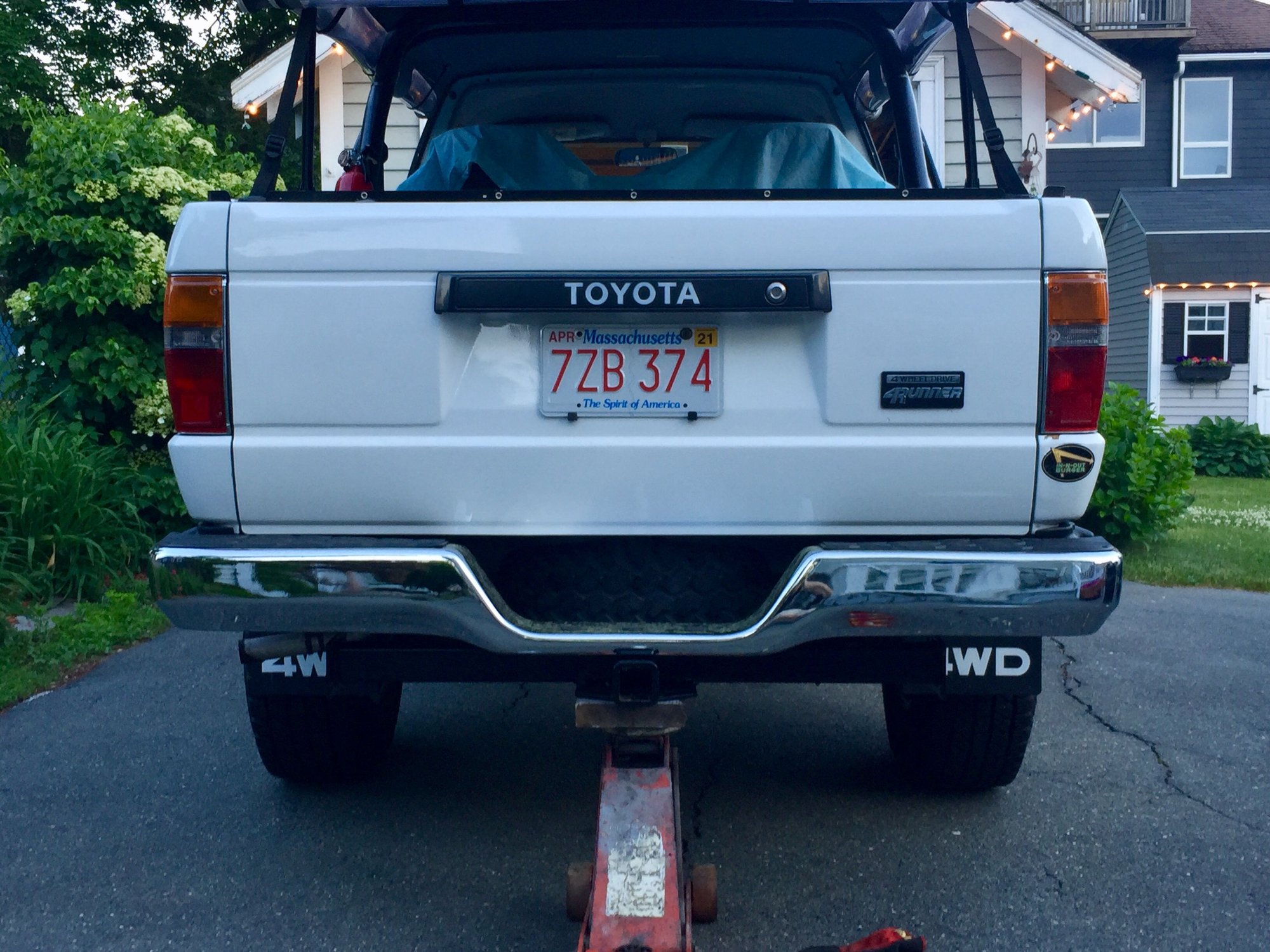

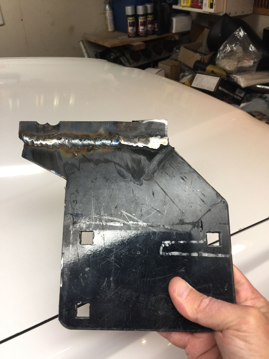

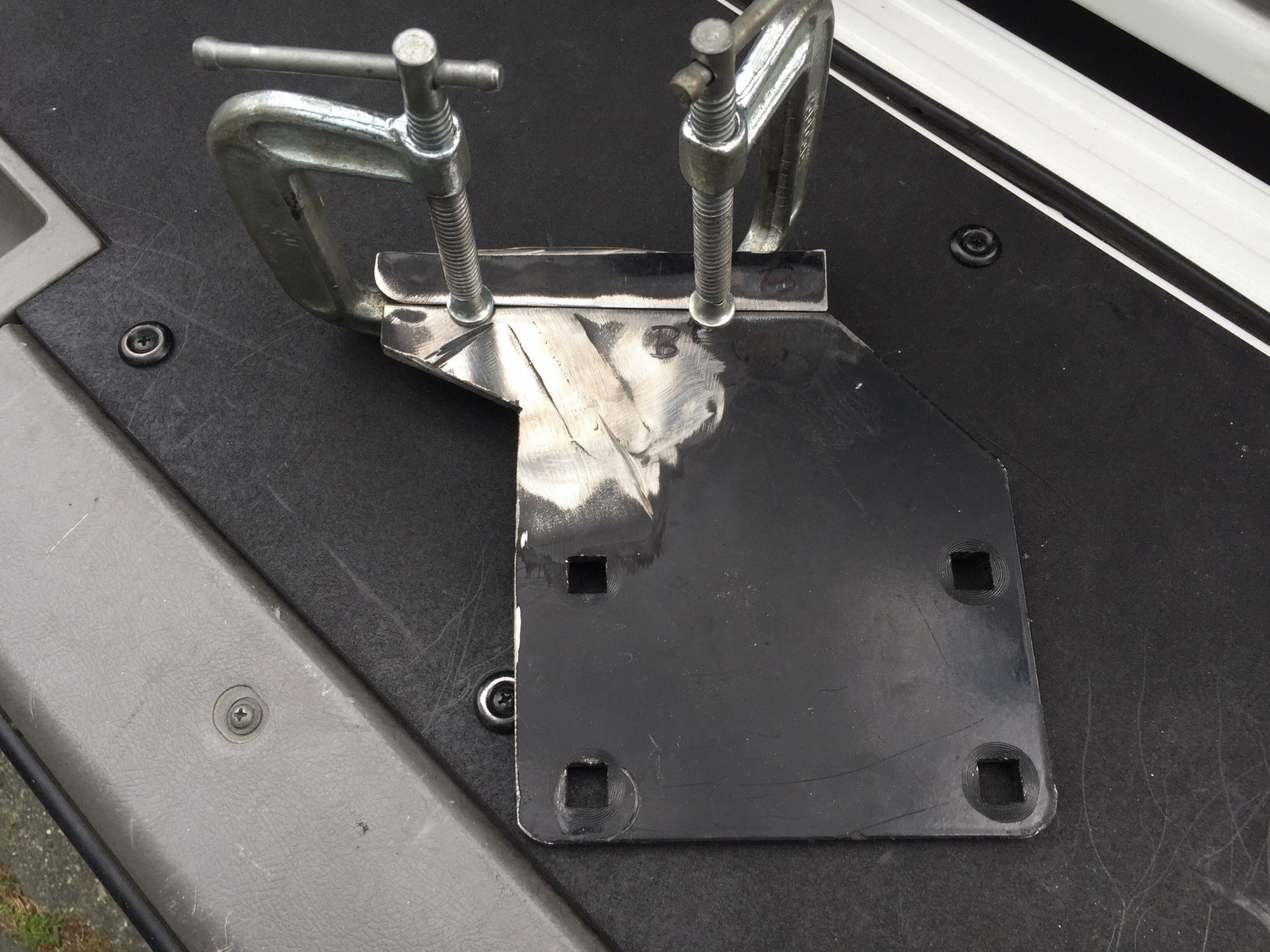

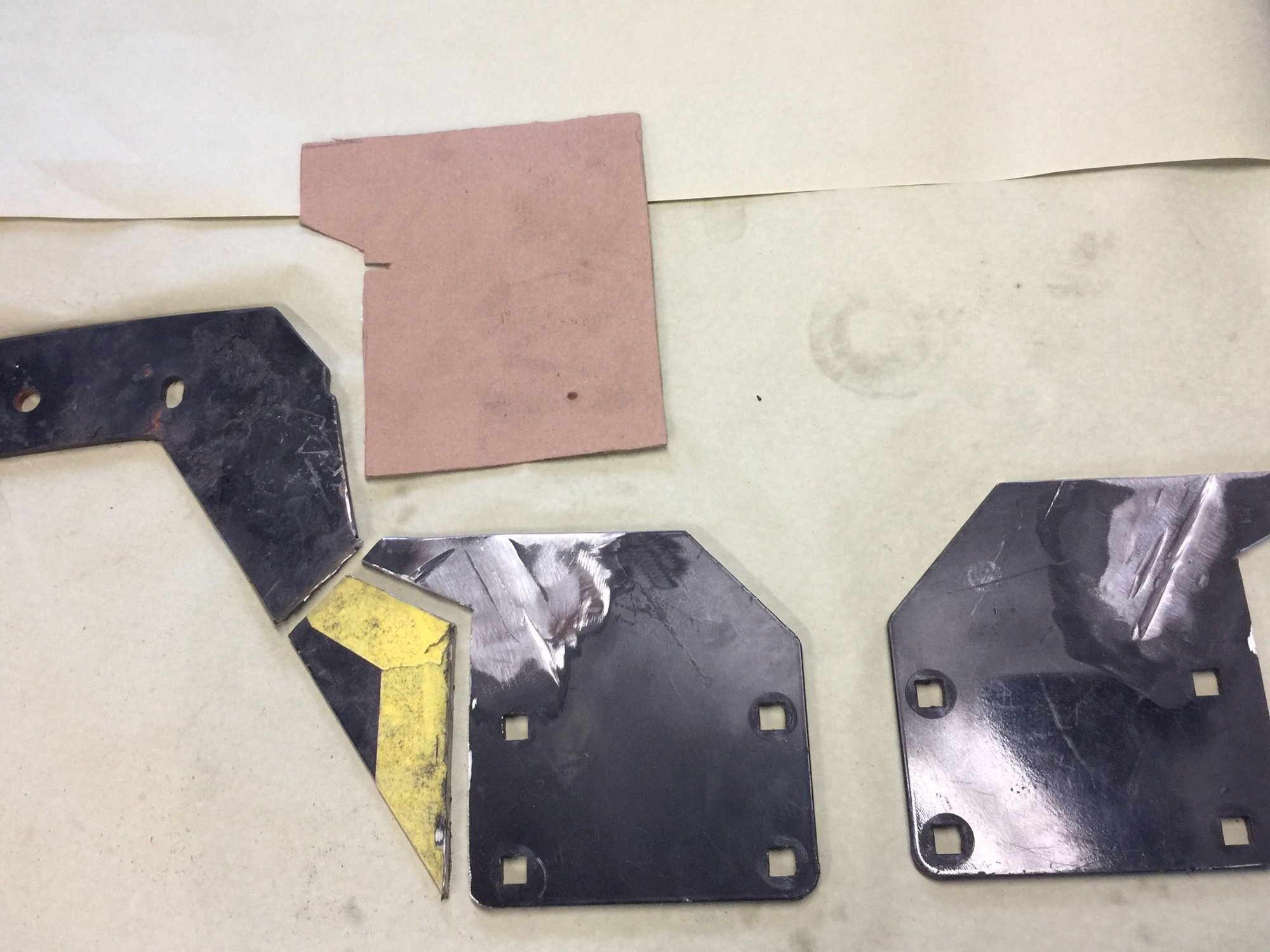

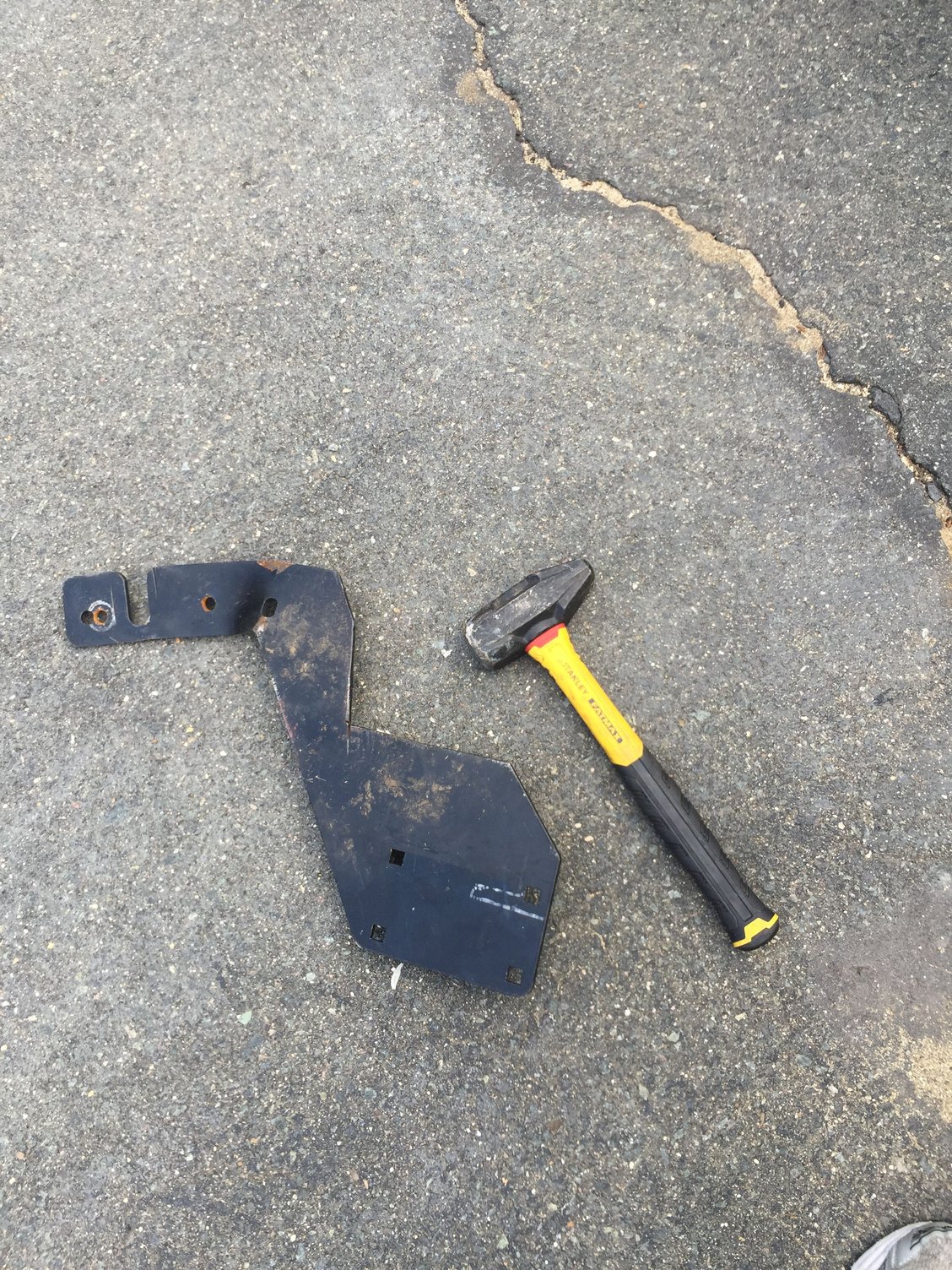

Trying to get my 2” hitch mounted somehow so i can use my bikerack. I don’t have anything to tow, so it’s just for bikes.
This is how i want it to mount.
i had the hitch on last summer, but never with the chrome rear step bumper. Then i got hit from behind recently at a red light and the 1/4” hitch plates bent.
Bent metal
so i figured i would straighten them out, and cut them down to bolt up to the bumper brackets.
Pizza box template.
Only problem, they were about 3/4” too short. I know my 110 Mig welder is not going to handle 1/4” plate easily but maybe good enough for a bike rack.
Ready to weld.
Old Jun 8, 2020 | 05:57 PM
  #588
Melrose 4r's Avatar
5 Year Member
Joined: Jun 2017
Posts: 2,436
Likes: 965
From: 02176
My welder has been down the street at a buddy’s house since i finished my bodywork, October ‘18.
Finally get over there Sunday late afternoon, begin to weld and promptly run out of mig wire. 🤬
Today, go to Lowe’s, buy both .025 and .030 mig wire(better for thick metal). Come home, load up welder with .030 and it sucks royaly. 🤬Trying to backtrack to how it sort of worked before i ran out of wire, switch back to .025”. Better, still not great. I mostly finish, then realize in all the focus of switching out wire, i forgot to turn the gas on! 🤬
The results pretty much suck.
I’m going to have to drill two bolt holes through that bead and i don’t own a drill press.
So, i’m scrapping this plan, will go buy some 1/4” plate cut to the right size and just drill some holes. Won't be able to use the carriage bolts but that’s ok.

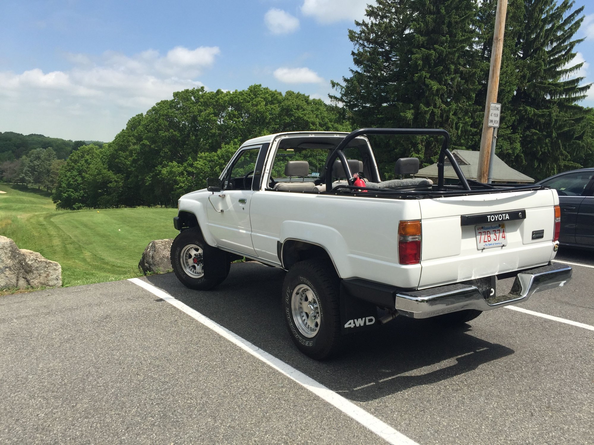

Some photos at the golf course nearby
