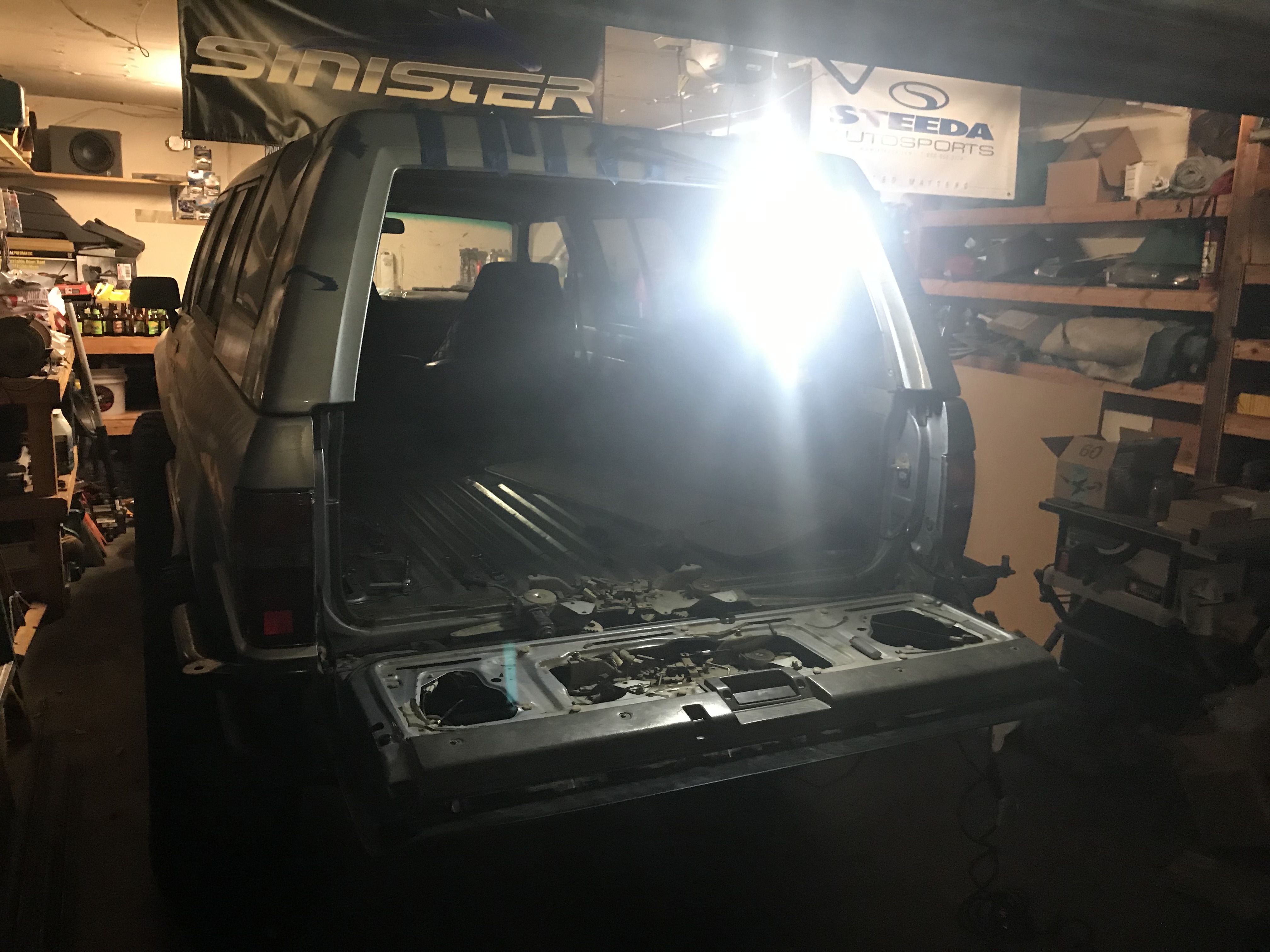

12-11-19 - Update - Rear Window
Almost have this project wrapped up. It took some time to find a regulator that was even worth purchasing, let alone finding one. The local yards were picked clean. They had a bunch of tailgate shells but unfortunately someone ran off with the regulator(s) and motor(s) way before i got there. Through a Facebook group, I was able to track one down in Idaho. The buyer was extremely generous with pictures so after $120.00 shipped and 7 days later, I finally received it. The buyer was nice enough to include the motor with it, as well.
I got around to installing it yesterday and everything went smooth. Pulled the motor, unbolted everything, slid the regulator to the passenger side, slid it back to the driver side, pulled the window and then finagled the regulator out. Reversed the steps to get the new but used regulator and motor back in, got it all buttoned back together.
I wasn't able to find any alligator clip electrical leads in my garage (surprisingly) so i'm basically stuck with the tailgate down and the window halfway up. It's like this because the regulator has to be removed and installed with the window half way up/down. I could essentially pull the motor off the new but used regulator, push the window into the tailgate but then i'd have to do a little bit of clocking for the regulator, which i didn't wanna do.
White at work i'm going to make some make shift electrical leads and jump the motor when I get home. This should lower the window even with the tailgate down and then i should be able to close the gate, grease everything and finally wrap this project up.
Here's a picture for good measure:

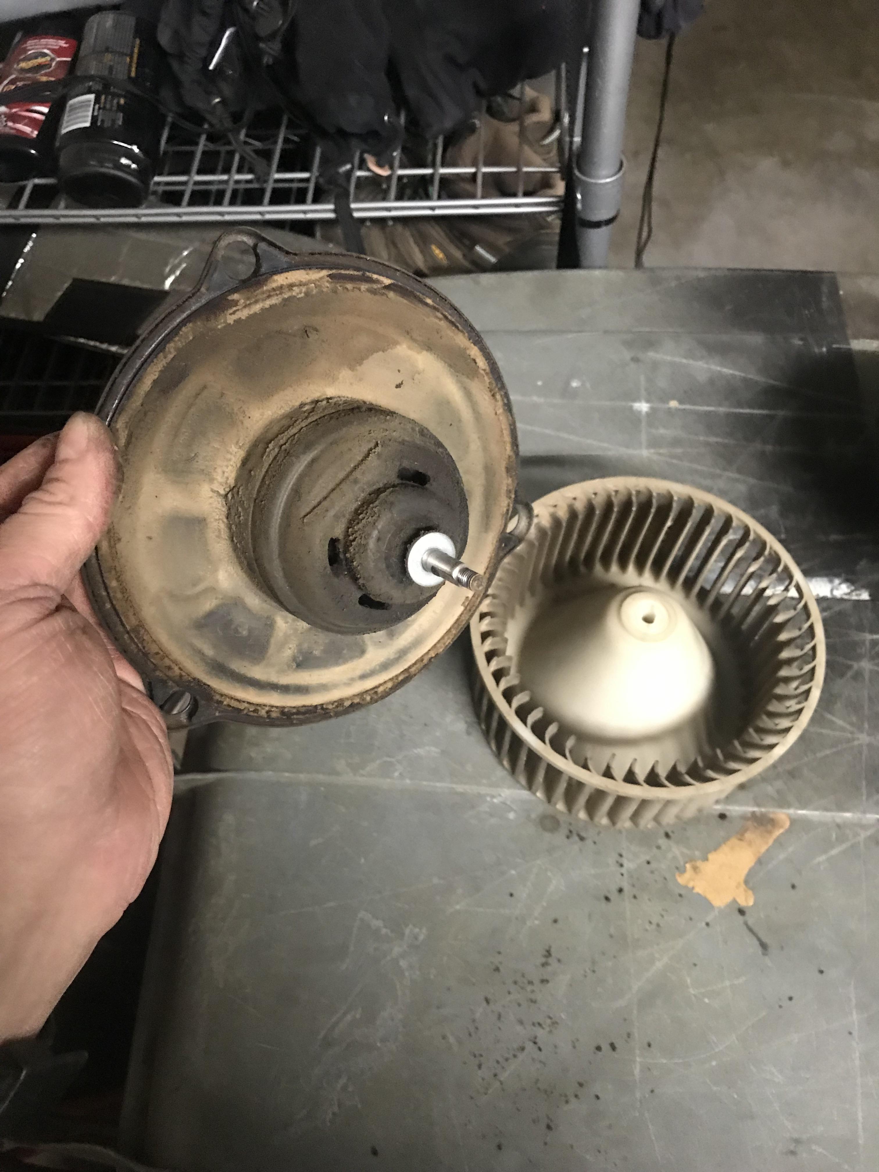

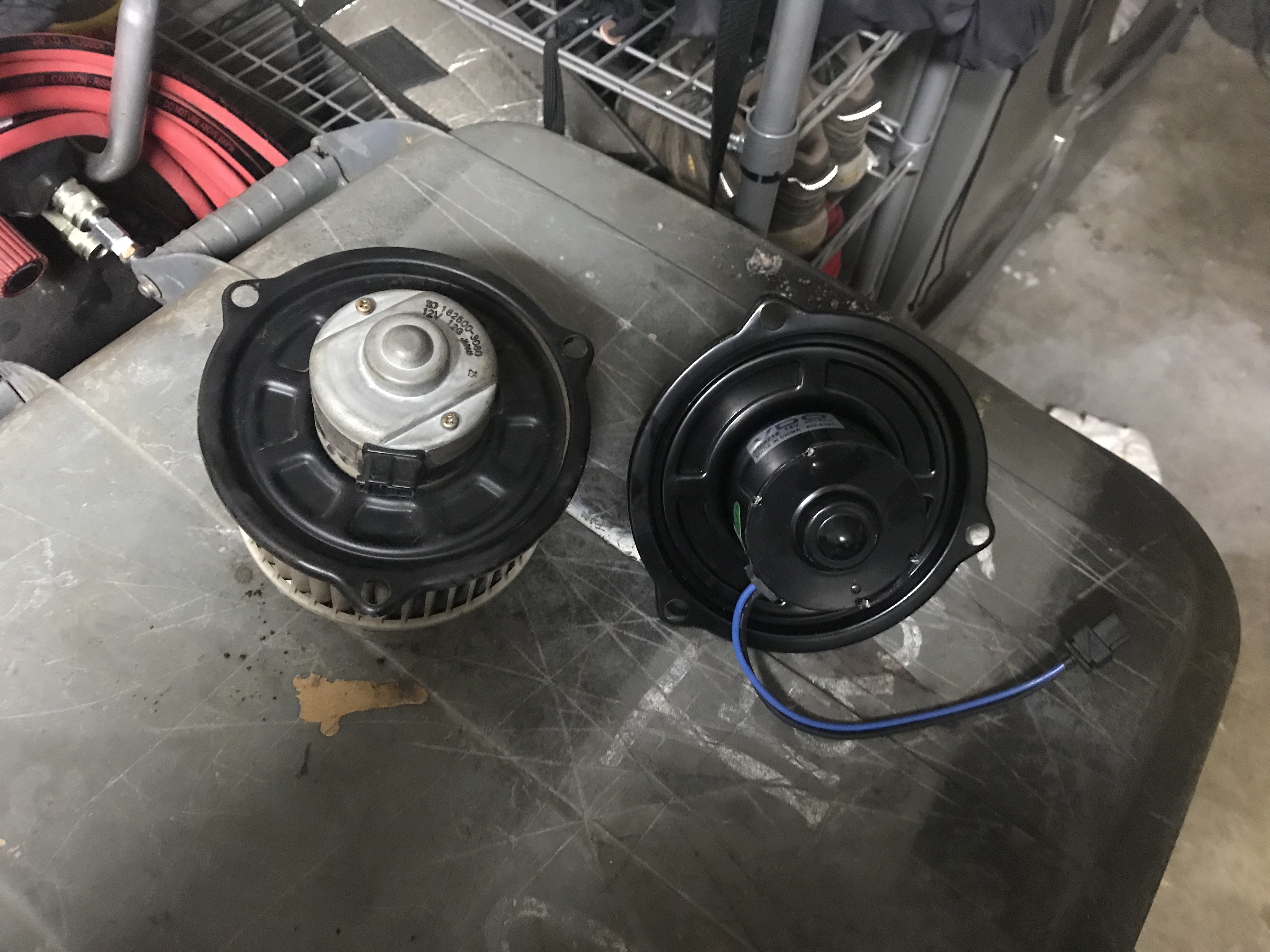

12-16-19 - Blower Motor Replacement
The original blower motor finally crapped out so I replaced it with an Autozone unit. Took about 30 minutes to pull the original motor, pull the fan blade off, wash it, install it onto the new motor and reinstall. Original motor lasted 31 years and 254k miles.

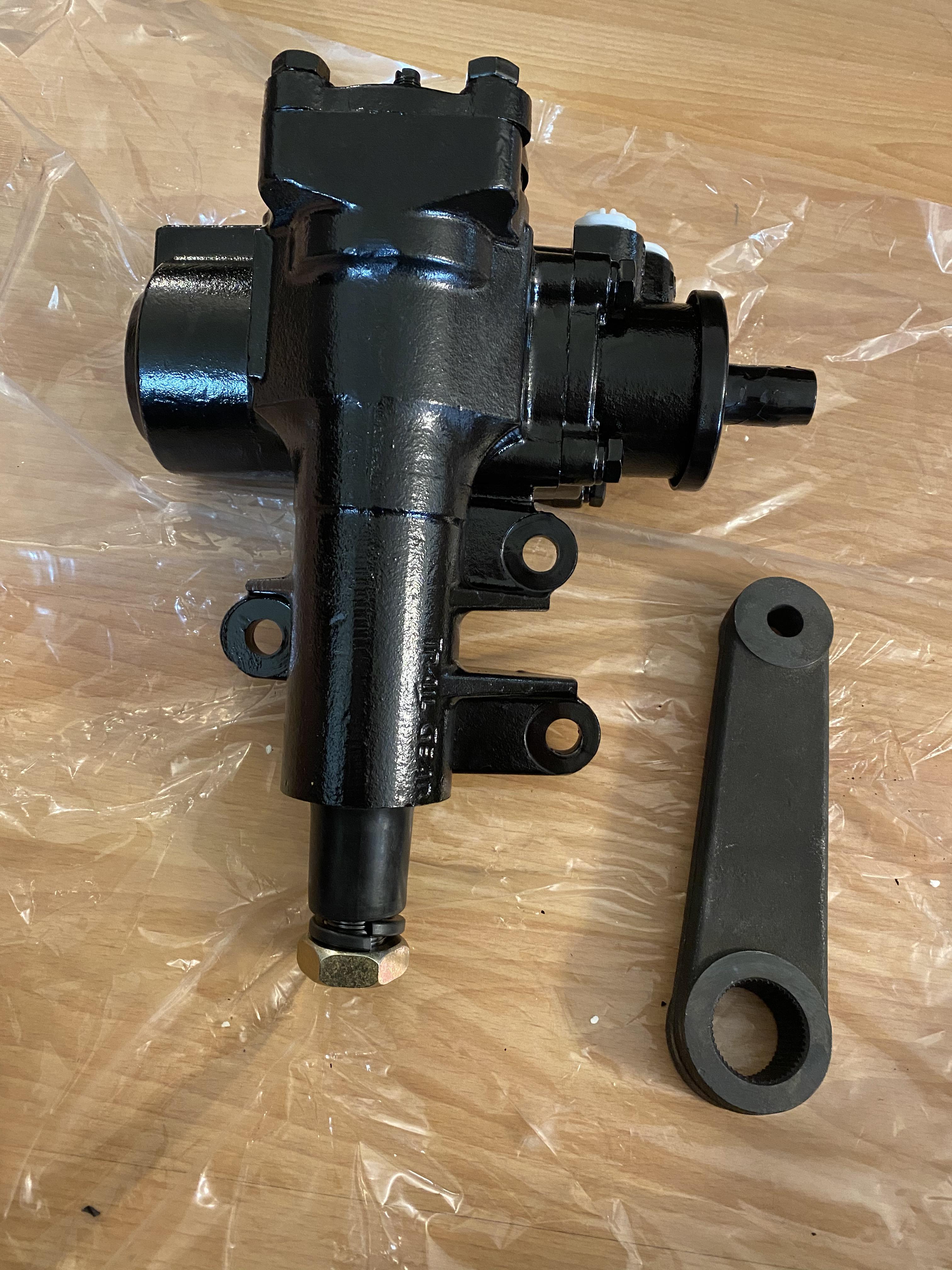

8-13-20 - Update
Took a step back from fixing the little things on the 4Runner to reevaluate the larger problems with the rig. Due to the fact that the truck is failing smog and preventing current registration in California, I decided to park it in my driveway, let it hang out for a bit and drive the Cressida.
I did add yet another Toyota to my fleet. I originally bought this car for $150.00 off of a co-worker of mine. It was failing smog because the CEL tossing a code for shifter solenoids. I got it home, fixed the solenoids, passed smog and drove the hell out of it. Shortly after that, a buddy of mine wife's car took a ˟˟˟˟ (it was a Kia) so I sold it to him for $2200.00 bucks. Well, a year later he bought his wife a new car and didn't need this one anymore so he sold it back to me for $300.00. it's got 100,000 more miles than it had when I sold it and it now has a little oil leak on the oil pan but it still drives and the AC works, which is a huge plus because the Cressida's AC didn't work and nor does the 4Runner's.
Anyway, long story short. I posted the Cressida for sale and it sold overnight. I also have the Xrunner posted for sale in hopes to free up the monthly payments associated with it and half of my garage so I can get the 4Runner in there for some serious maintenance. It still hasn't passed smog but I have everything to make that happen minus a catalytic converter. It does have the original catalytic converter and it's at 250k miles but I think i should be able to get it to pass with new plugs, wires, cap and rotor after i do a solid Seatfoam / denatured alcohol treatment..Besides getting the truck to pass smog, I need to address the steering issues. I have a brand new steering box, flat pitman arm and steering box mount waiting to be installed. I also need to rebuild the front axle and test the front locker functionality. No parts collected for this yet but I plan on running the Marlin Crawler gasket. Besides that, i'd like to get the AC fixed and relocate the rear shocks to a more ride-worthy location.
For now, i'm just waiting for the Xrunner to sell before I start all of this work. For good measure, here's a picture of the steering box & pitman arm:
