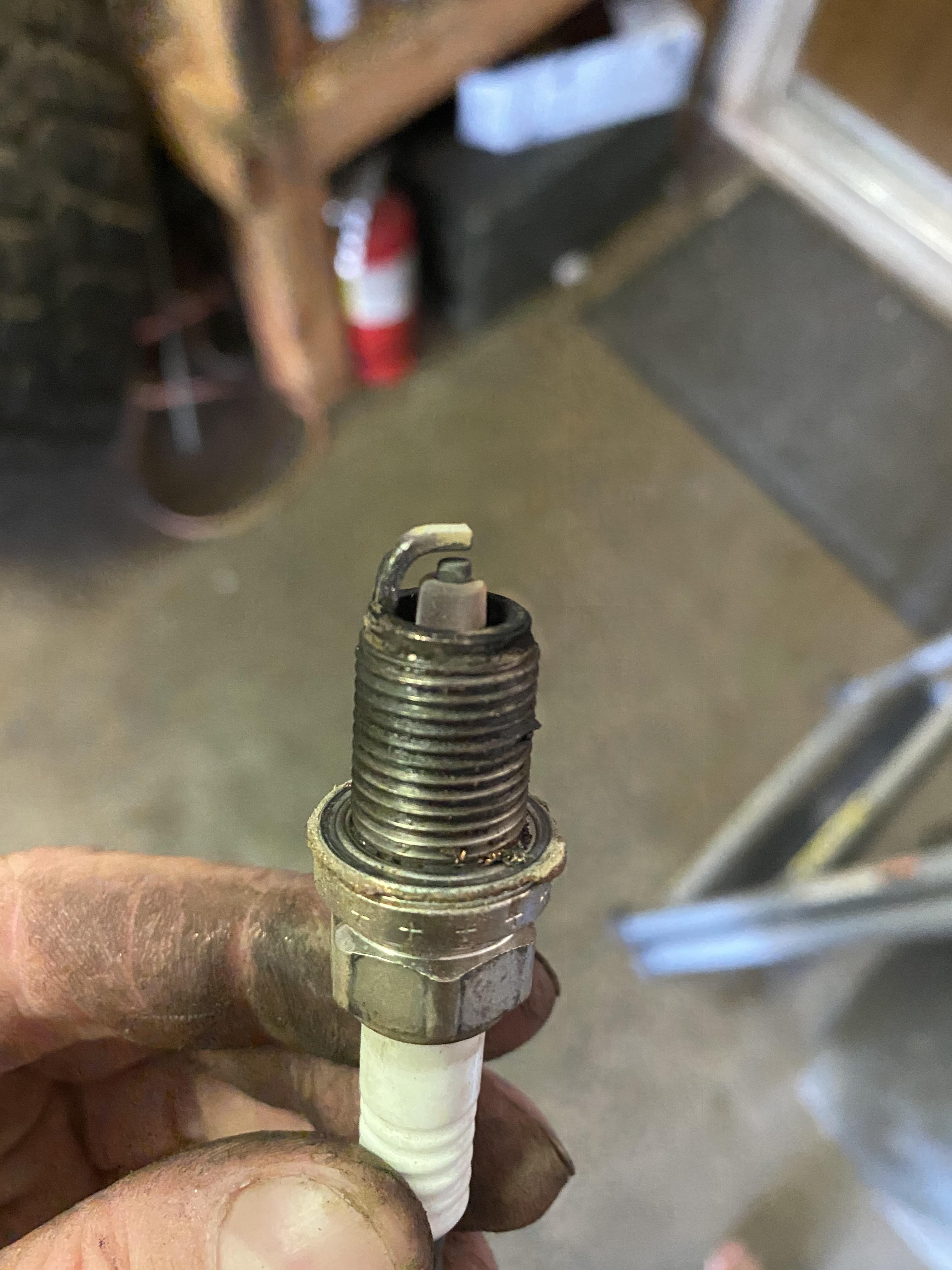

I had some free time when I got home from work last night so I cracked open a brewski and dove right in. I started with the hardest spark plug to get to, which is #5 and everything went pretty smooth. I extended my vacuum lines and formed a nice little pocket to be able to access the passenger side manifold area. The plugs I pulled only have about 13,000 miles on them. You be the judge on how they look, they seem fine to me.

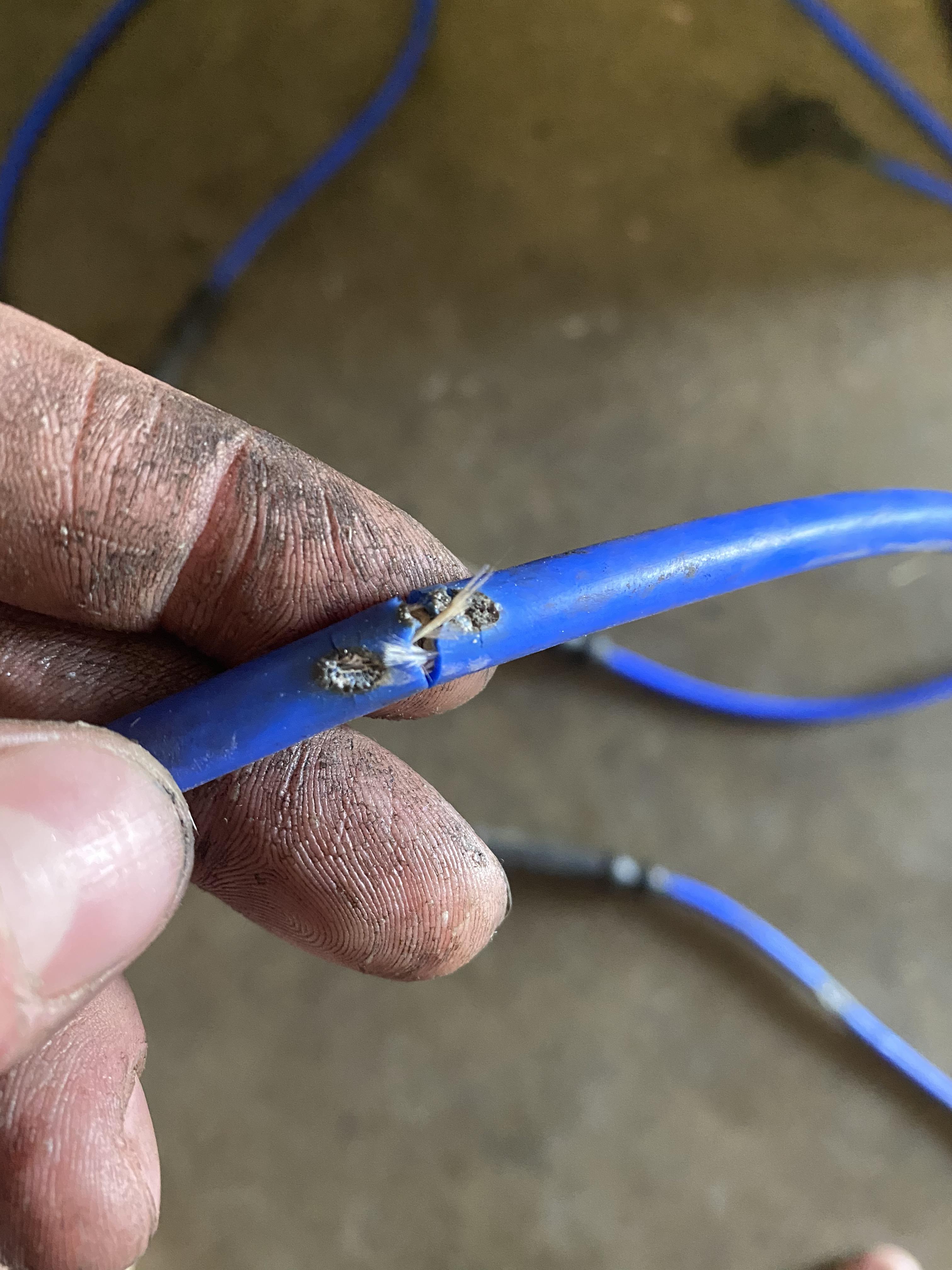

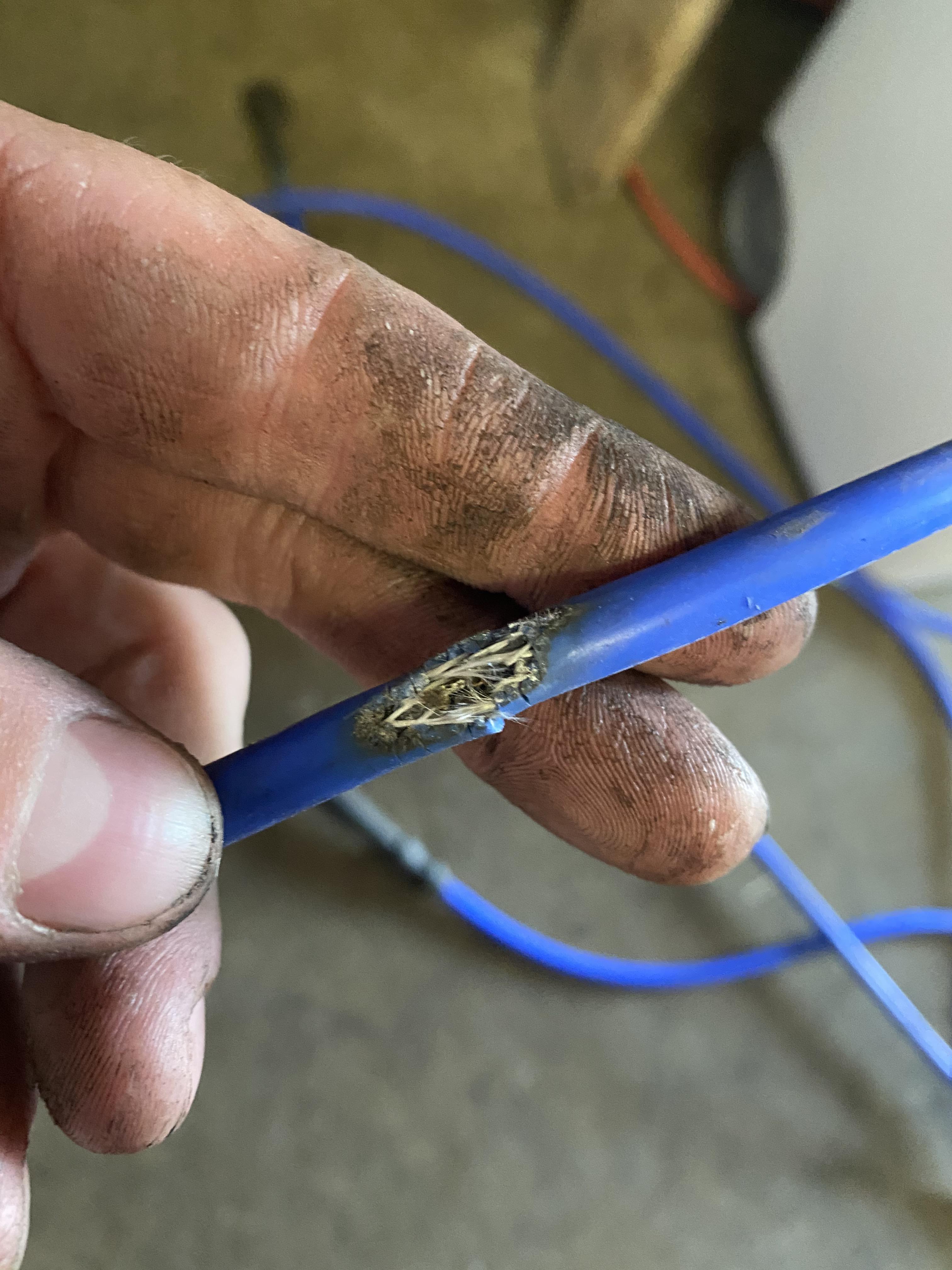

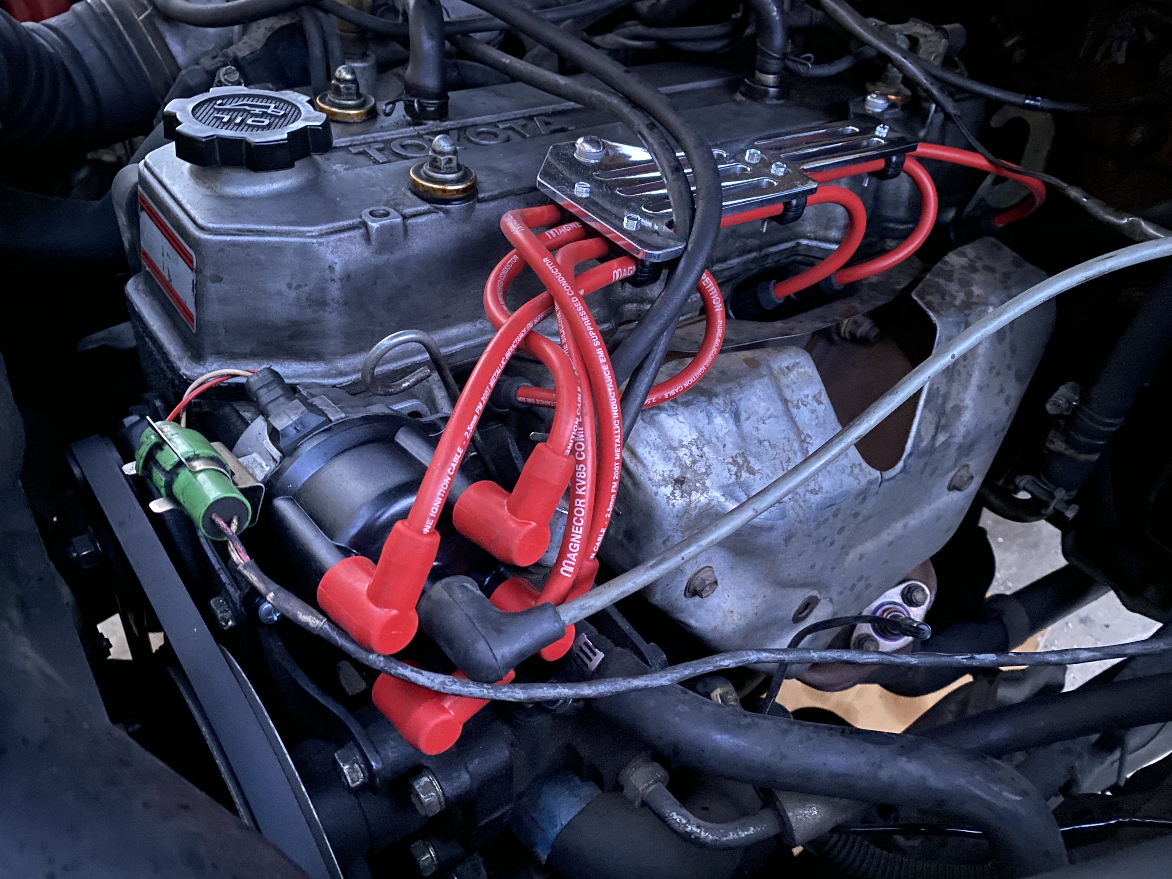

After I swapped the spark plugs, I moved onto the wires. I pulled the #3 & #5 spark plug wires and found they were both damaged. From the looks of it, they were burning on the EGR tube. This could definitely explain why the 4Runner isn't passing smog.

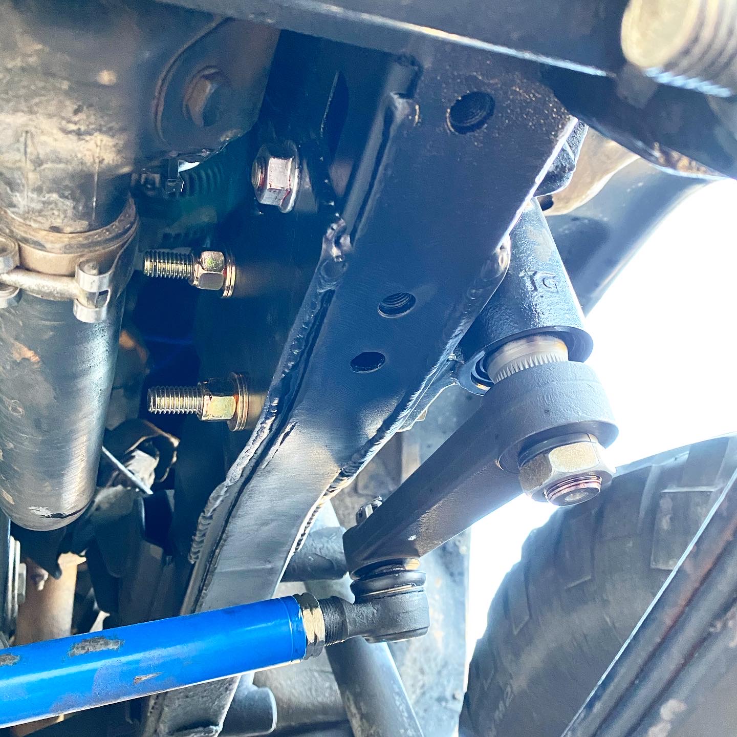

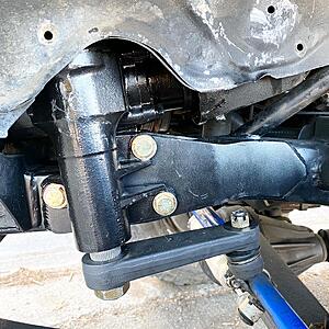

On Friday (10-16-20), i'm taking the truck to WFO concepts to get the new steering box relocated/mounted and the flat pitman arm installed. Pretty stoked to have that done finally since it's been an issue in the past.

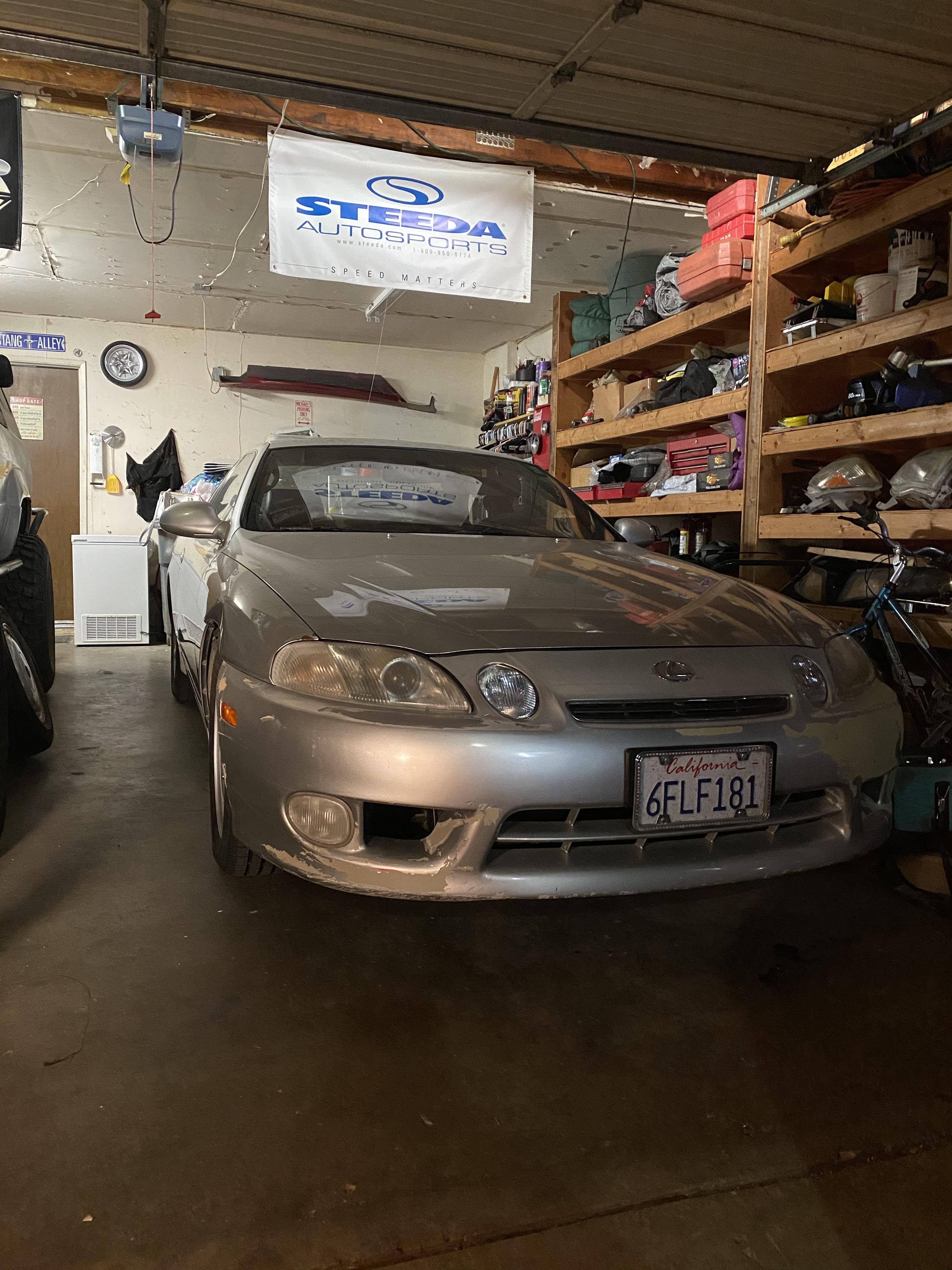

On this post: https://forum.ih8mud.com/threads/mak.../post-13425347 I mentioned that I bought a 2000 Lexus SC300. I did some odds and ends to it that made the car more whole again but I eventually came to the conclusion that it's better off in someone else's garage. Posted it for sale and it was gone in about ~2-3 weeks. Since then, i've added ~3? or 4? Vehicles to the stable. I think I already mentioned that I bought the Camry back from a friend that no longer needed it so I wont count that one but here's a list of what's in my possession now:

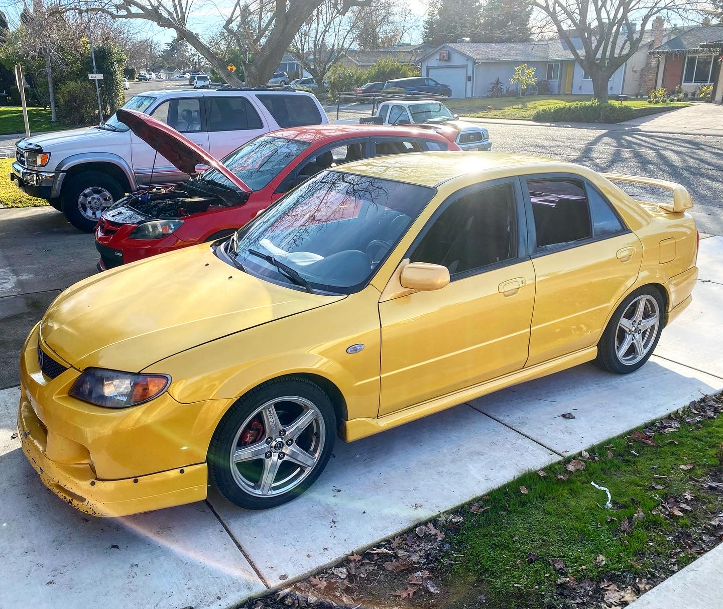

2003.5 Mazdaspeed Protege - Pretty unique little car. I dig the quirkiness of this car. It's bright yellow, turbocharged and has a manual. Miles are a little high but I bought it on a whim from a good friend of mine and a fellow forum member @space-junk Not sure what the plans are but for now it's just hanging out in the garage.

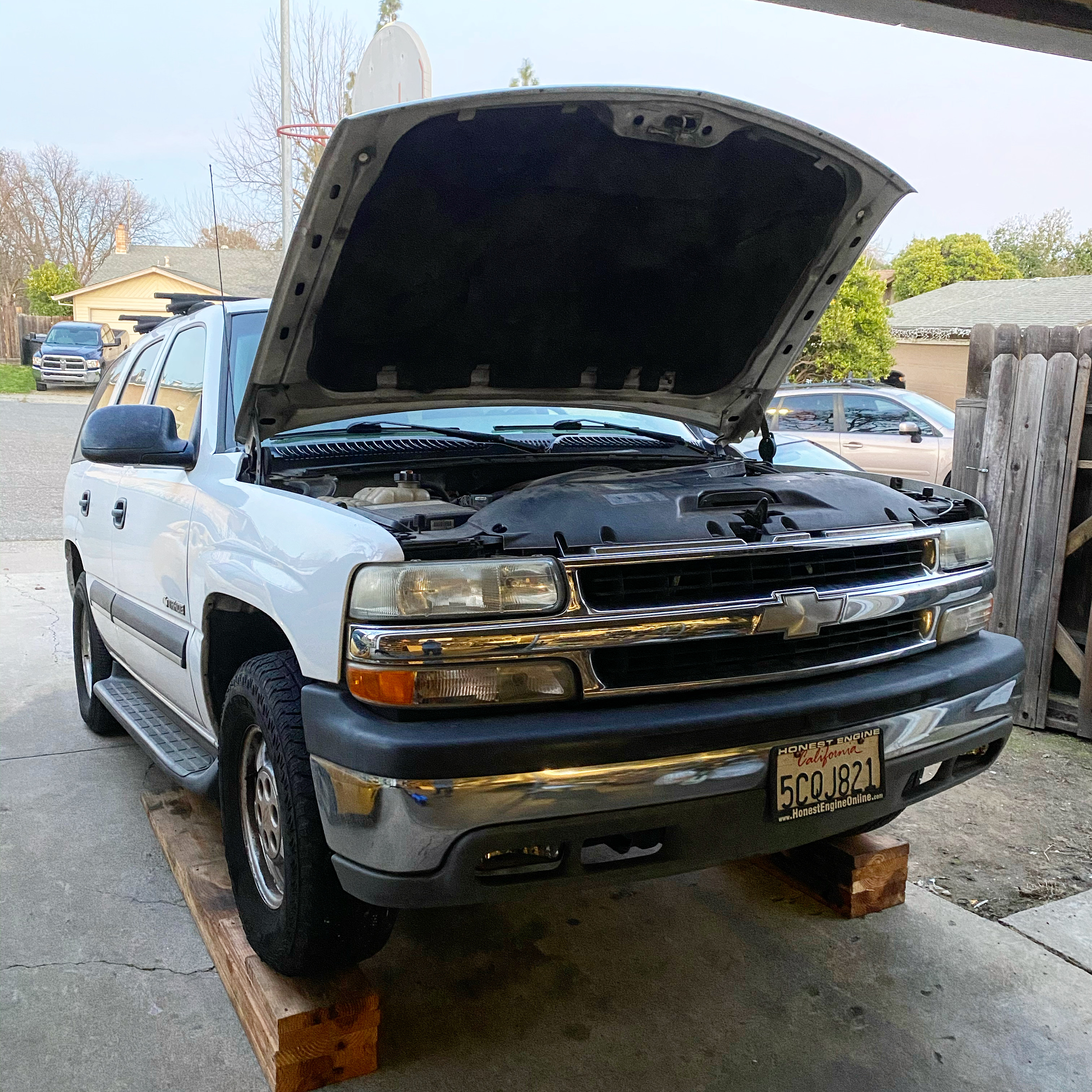

2003 Chevrolet Tahoe - Nothing special, it's 2wd and has a plethora of issues. I'm currently working on the transmission because the pan was leaking. Unfortunately, this truck has been maintained by JIffy Lube it's entire life and both the oil drain and transmission drain plugs were abused by an air impact. I was fortunate enough to get the oil drain plug off but the transmission drain plug was stripped before I even touched it. I had to drop the pan the dirtnasty way, which worked well, surprisingly. For now, this thing is living on the ramps until I get everything dialed in. This one is gonna be sold.

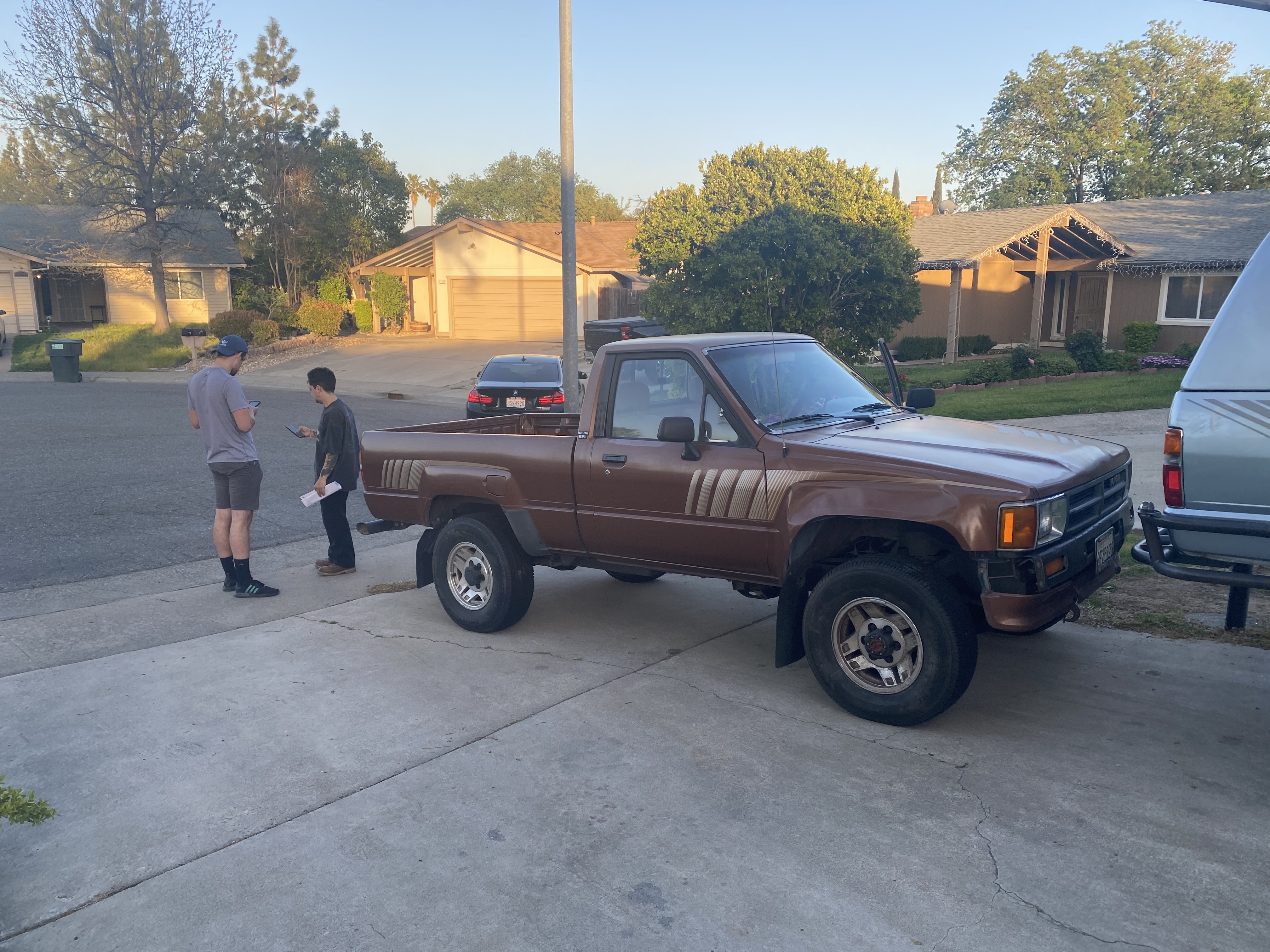

1987 Toyota Pickup SR5 - This one came to me unexpectedly. A family friend has owned this truck for a little over a decade and I've always wanted it but I could never justify the price he was asking for it. Well, finally he cracked and basically gave it to me. Pretty stoked to have yet another 30+ year old Toyota to work on. I'm probably gonna be keeping this one for a long time since it's nice to have a pickup to load stuff up in the bed. Definitely going to start a build thread and do a stock+ build on it.

I ended up getting the Tahoe operational and fixed. No more slipping transmission and no more leaks from the pan. All that's left to do is clean that thing up, post it for sale and get it out of the court.

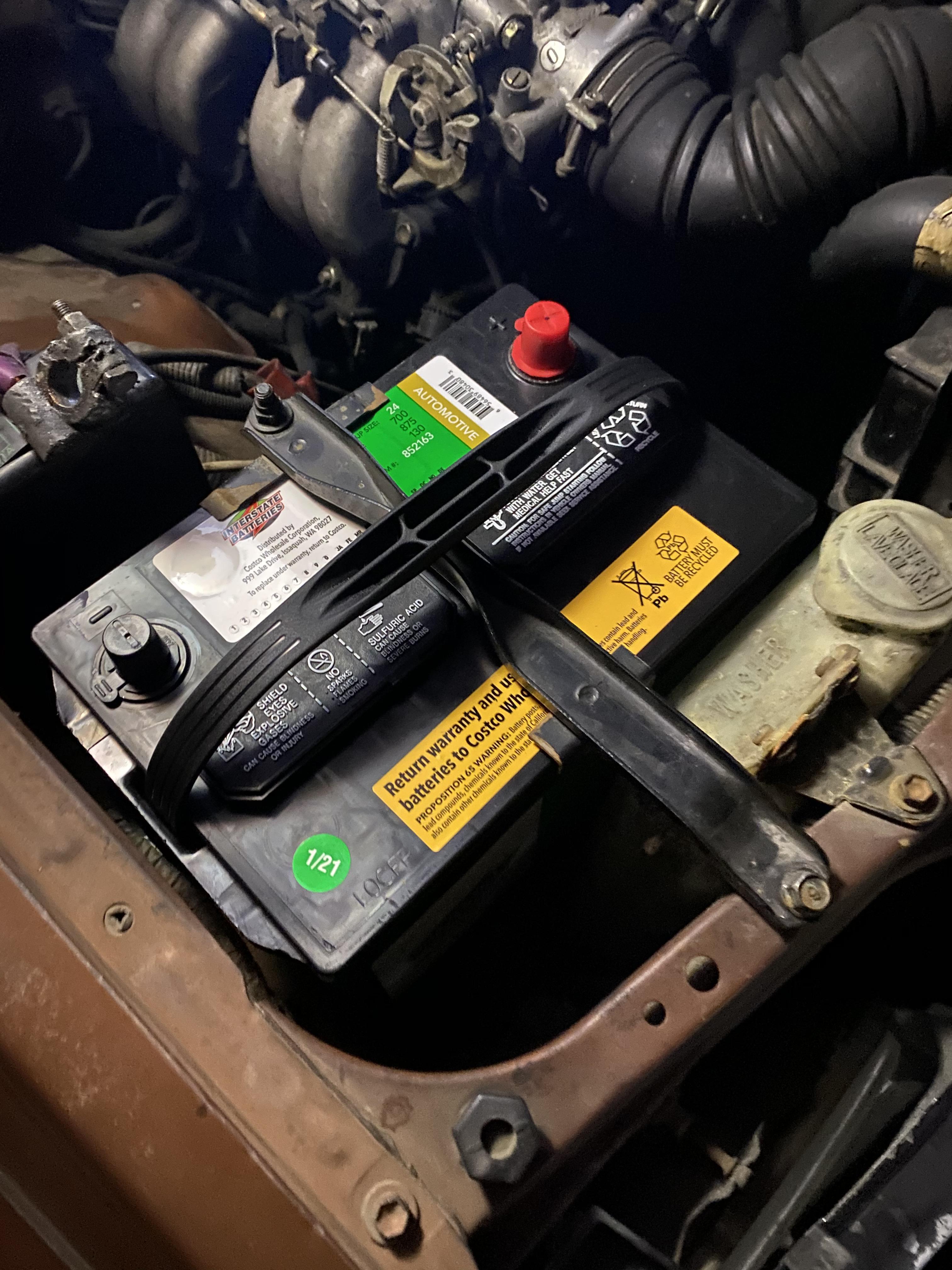

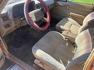

The Pickup needed a new battery so the first evening with it, I drove up to Costco and grabbed an Interstate battery for ~$70 dollars and installed that. The truck was missing it's OEM battery tiedown and for some reason I had one in my garage.

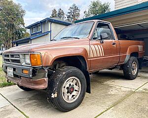

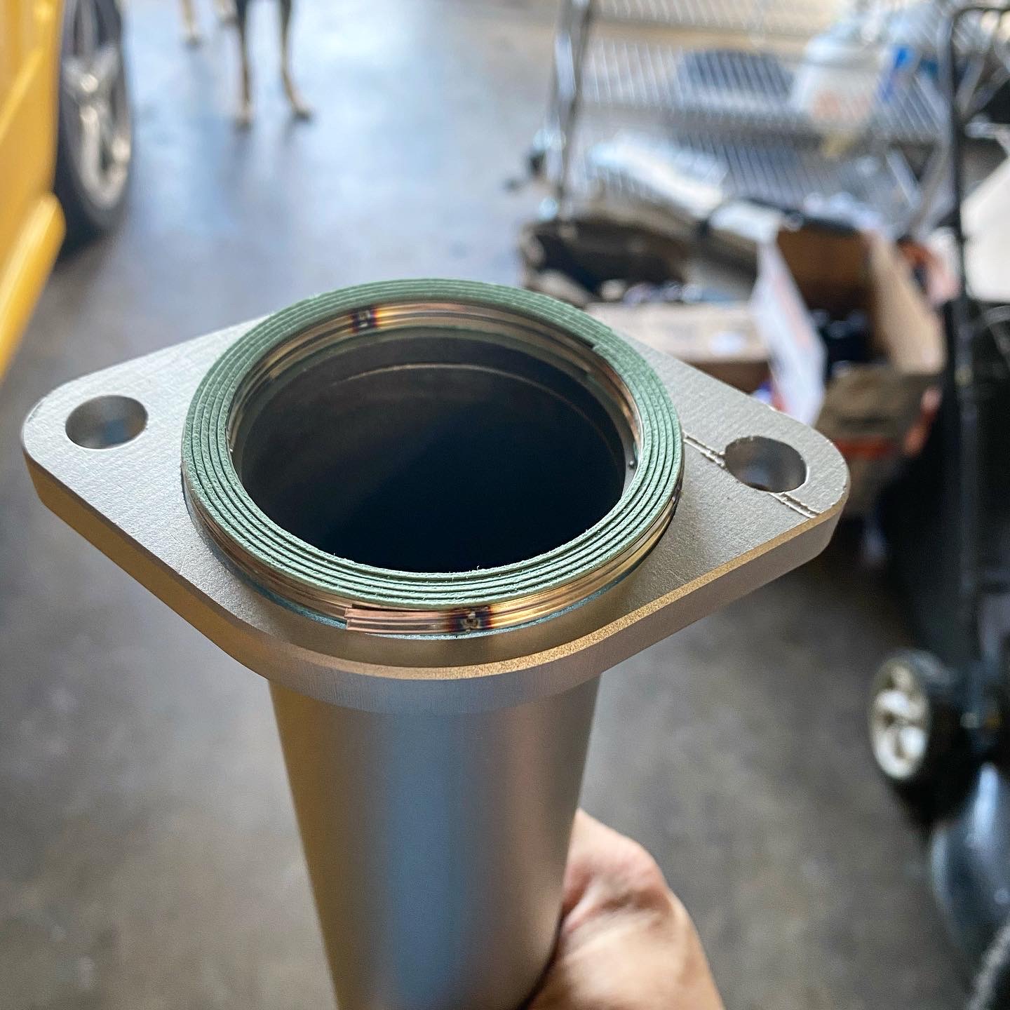

When I bought the 1987 Toyota Pickup, I got it for cheap because it was failing smog and the family friend was tired of messing with it. The smog shop I take it to doesn't really care much for the catalytic converter part #. He mostly cares about timing and if it's set within the parameters, he'll run it. Anyway, first attempt was when I first bought the truck and it still had a 49 state catalytic converter on it. It barely failed so then I had the brilliant idea to swap the catalytic converter off the 4Runner onto the Pickup, put a catback exhaust on it and put a new Denso o2 sensor, cap, rotor, coil, LC Engineering Magnecor wires and an LC Engineering Spark Plug wiring loom.

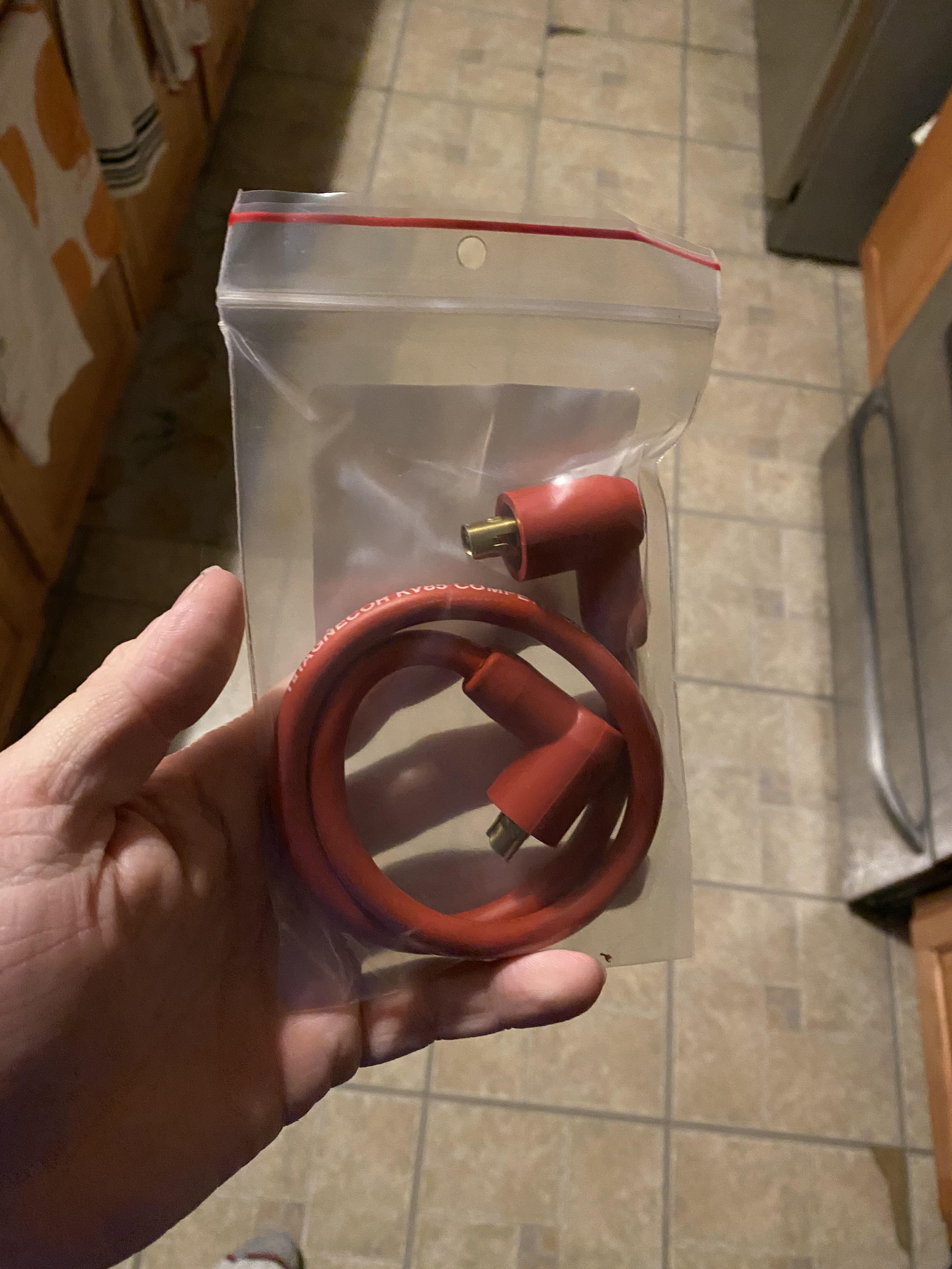

When I ordered the LC Engineering Magnecor wires, they had a bunch of wire sets deliver without the coil wire and since I was one of those customers, the coil wire eventually showed up:

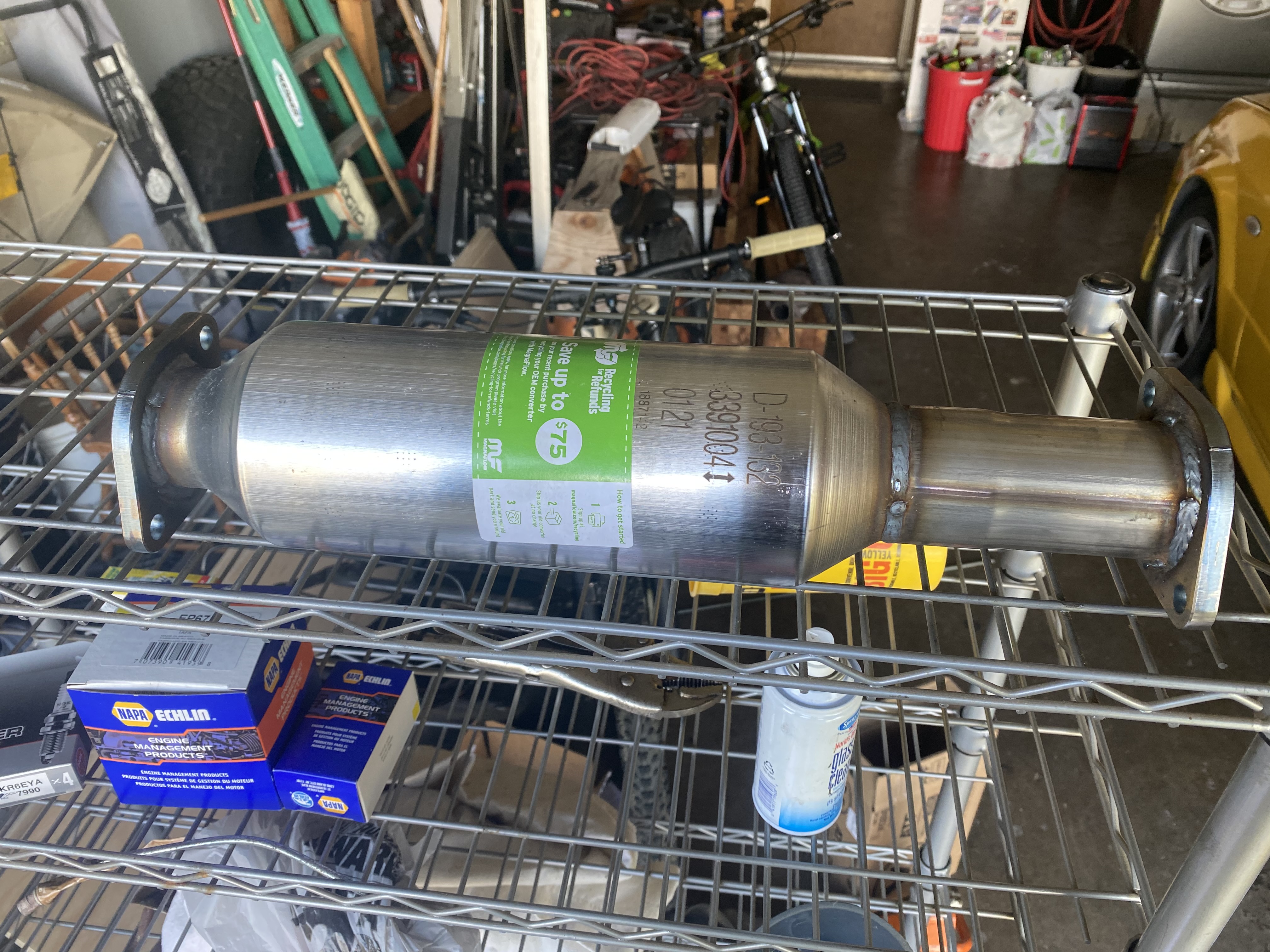

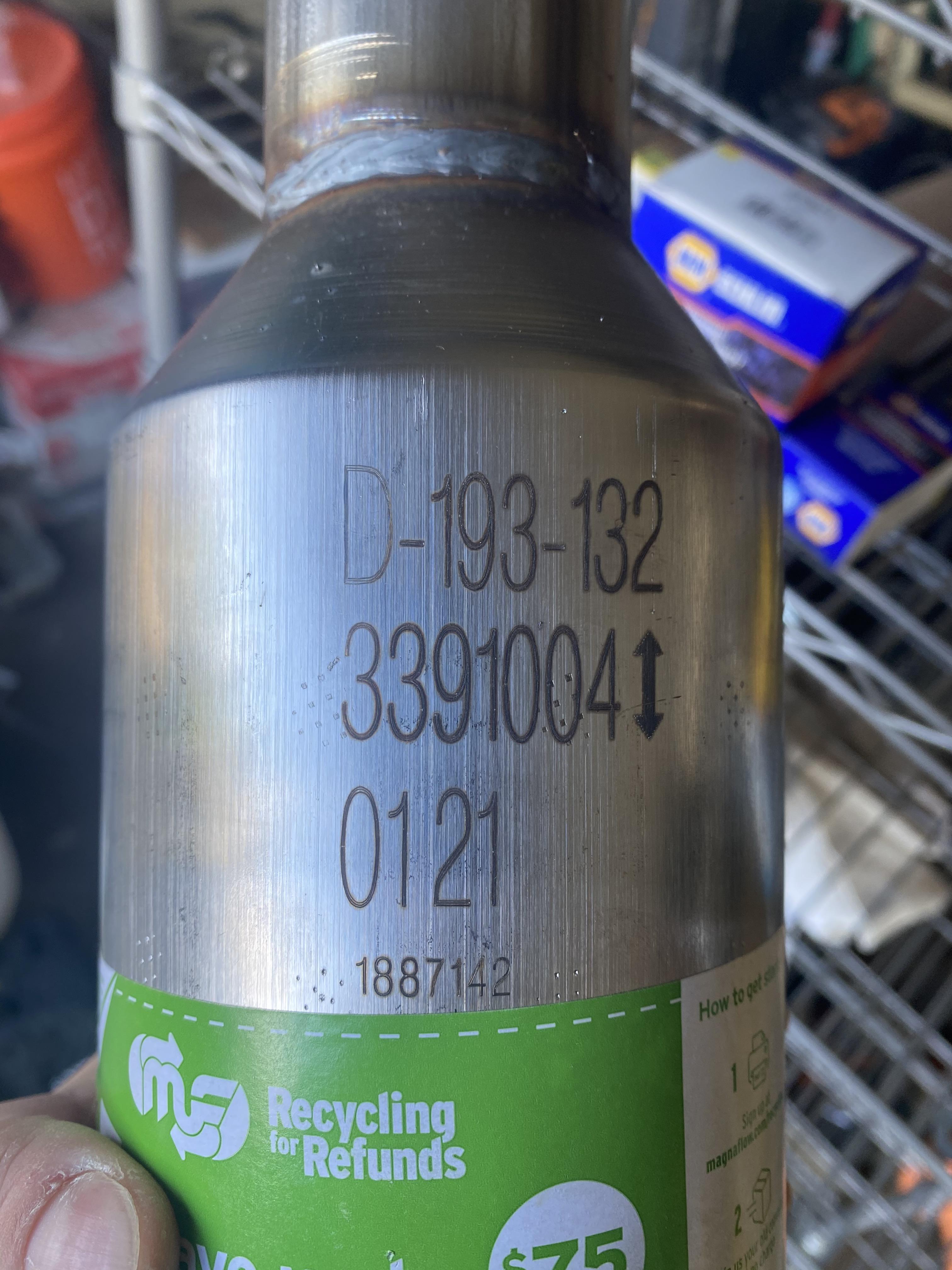

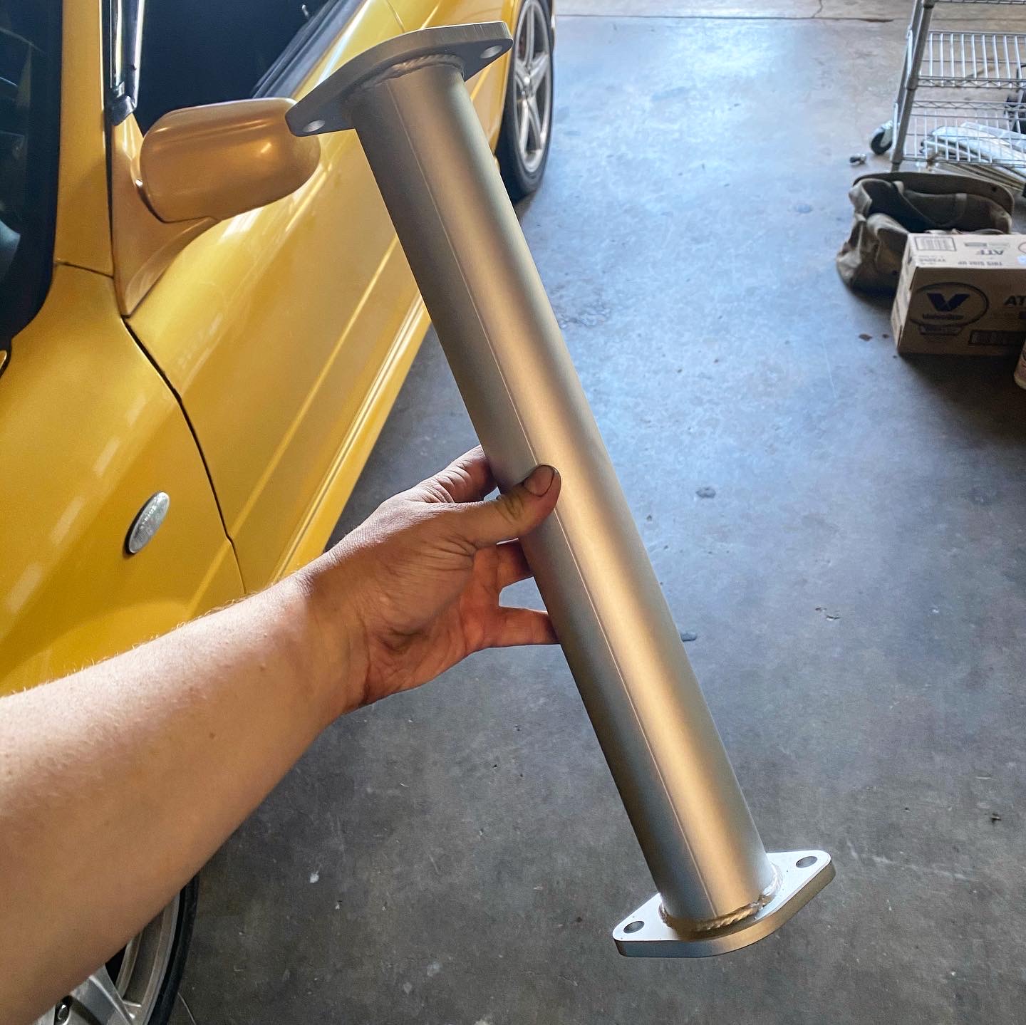

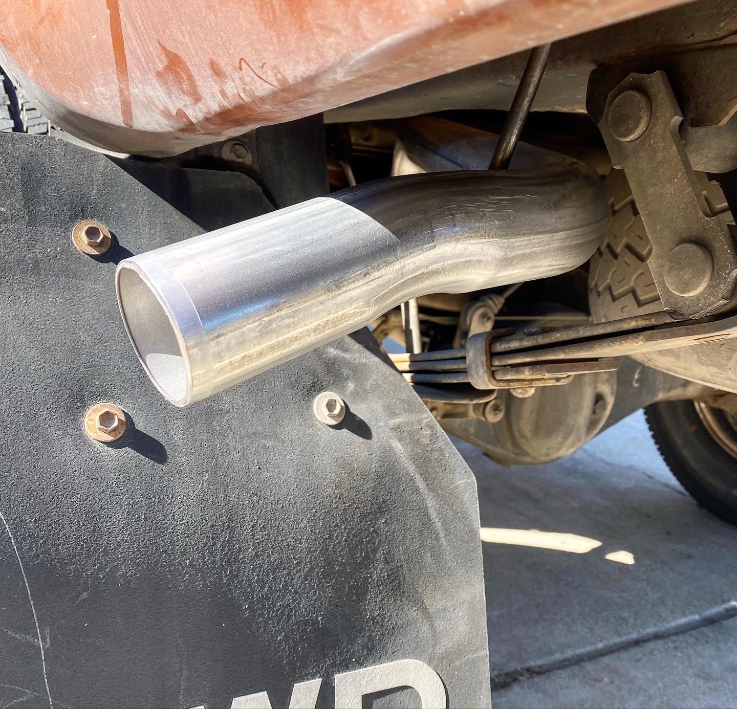

I got all of the above work done and it still failed smog for the 2nd time. At this point, it needed a new catalytic converter so I ended up pulling the trigger on a new Magnaflow catalytic converter from LC Engineering and putting that in. It passed.
Once I got it home and cooled off, I installed a test pipe in place of the new catalytic converter because I didn't want it to get stolen or go bad.

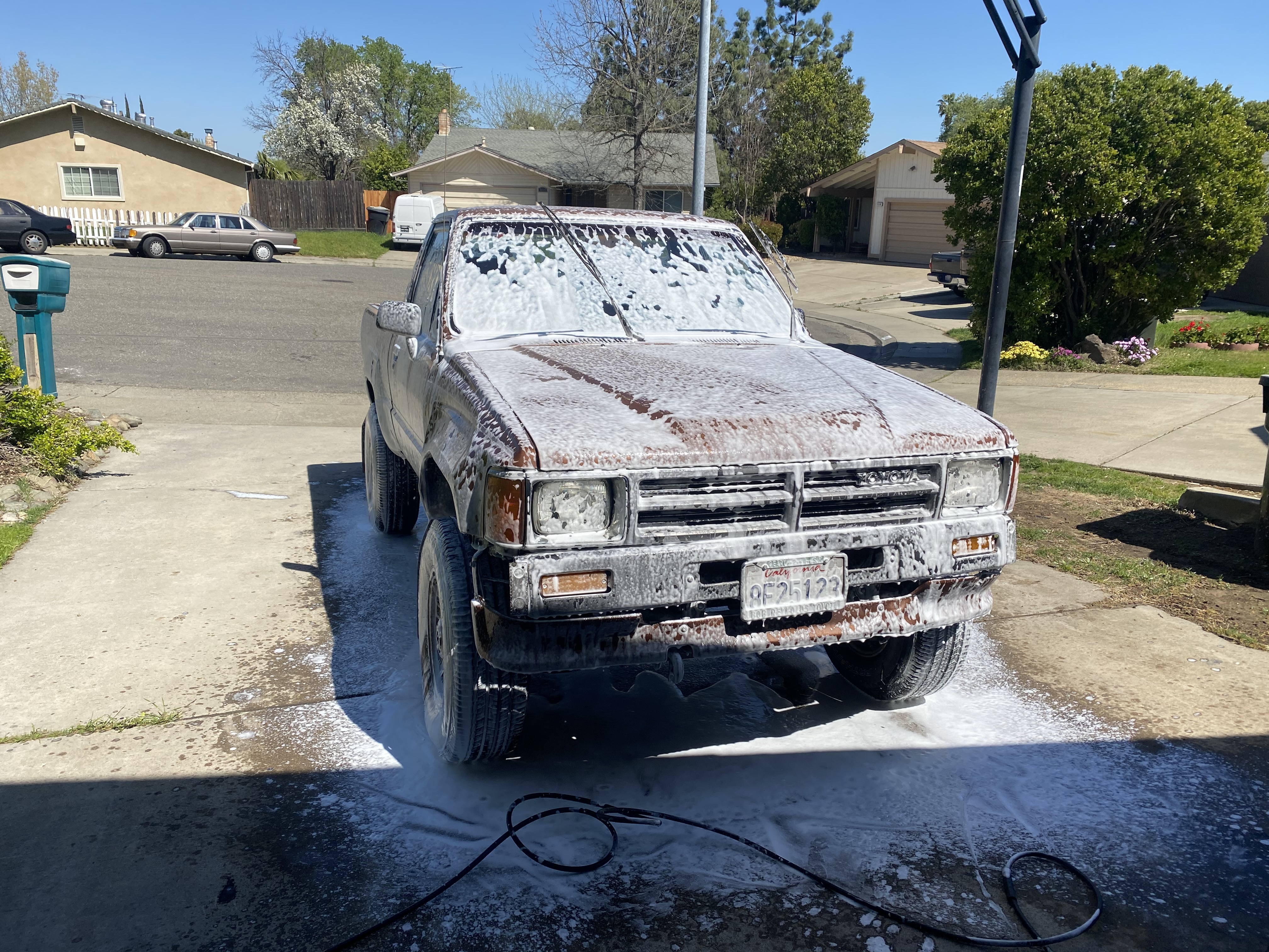

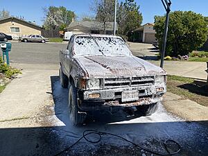

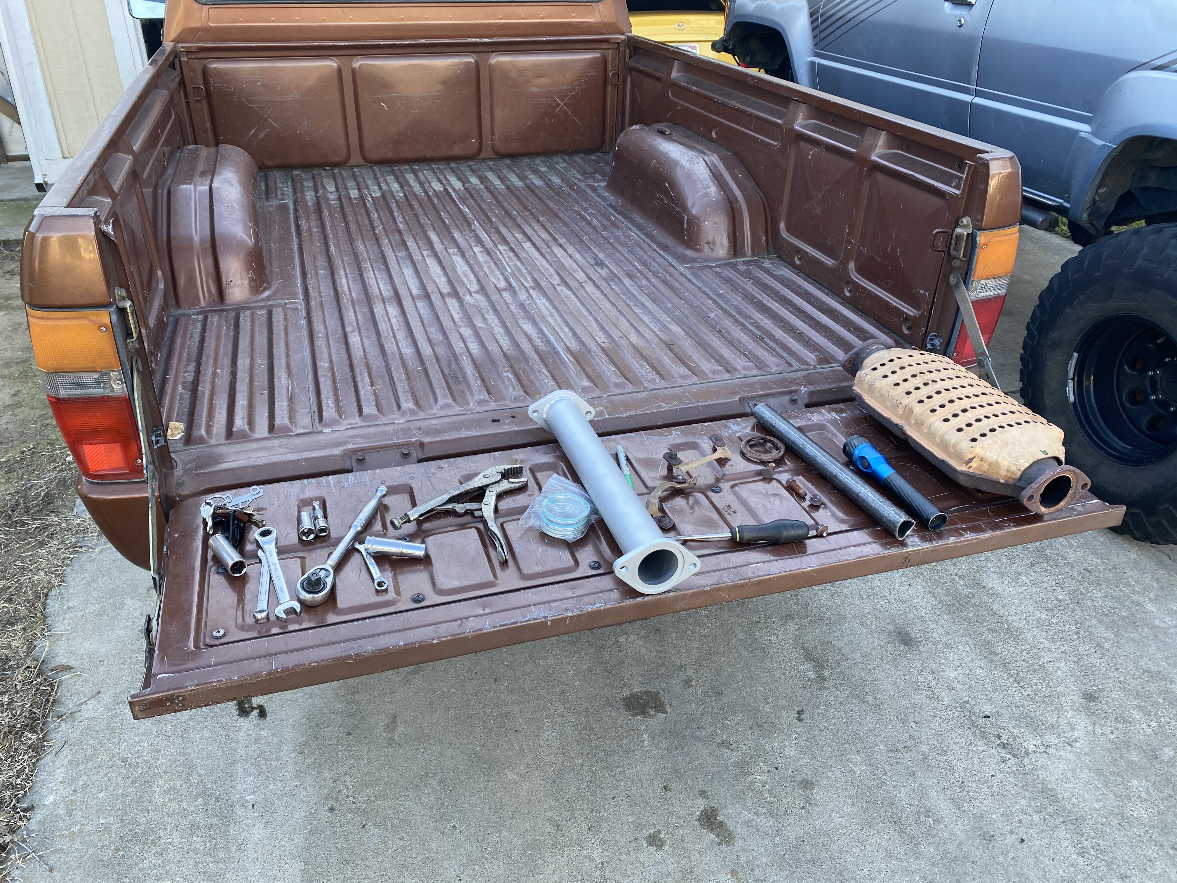

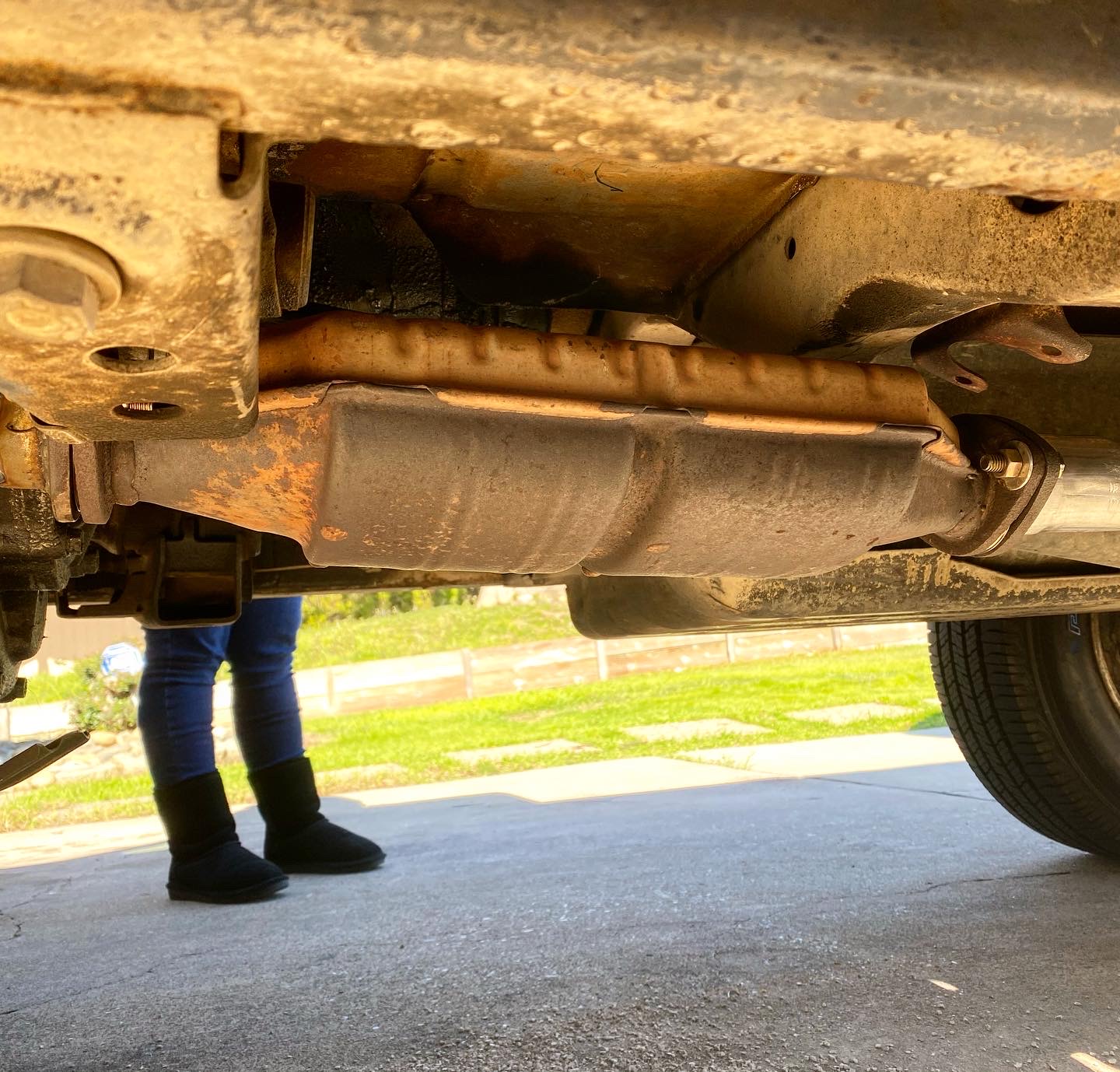

Fast forward a couple days, I got the truck registered and in my name. I decided that it wouldn't be a bad idea to clean the truck up and post it for sale for a price I couldn't say no to. Since I had 90 days on the smog cert, I figured why not? I gave it a bath, yanked the cheapo seat covers off it, vacuumed it out, took some pictures and posted it.
The Pickup sold last night.
I loved that truck but like i said, posted it for a price I couldn't say no to and it sold to the first guy that came and looked at it. Win win. Plus now I have a spare test pipe and a brand new catalytic converter for the 4Runner to use when the time comes.
