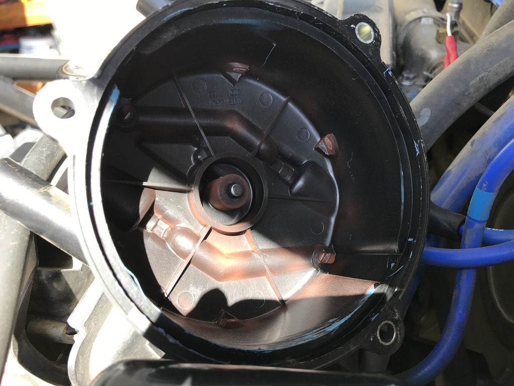

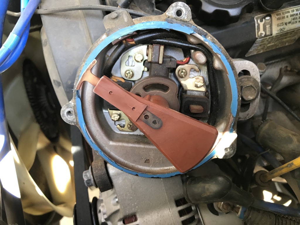

So here was the culprit behind the no start condition on the 4Runner:
I drove the truck to work on Monday (2 hour round trip) and didn't give me any issues. But the check engine light came on for code 71, which is no surprise. That code was coming up before the truck decided not to start. But I've cleaned the EGR system and it still continues to pop up.

Sweet XRunner. I wish they made them in the new Tacoma body style, I'd be all over a quad cab version as a DD.
Good job figuring out your dizzy was worn out
They made the XRunner up to 2012? 2013? so you can definitely get the teardrop front end on the Tacoma, which isn't bad looking. I do like the way the 05-2011 looks though. A good set of projector headlights and a decently cut grille and its a nice piece!
I don't really have a complaint about the access cab, either. No one ever sits back there (I have the 4Runner seats folded down at all times, as well). My truck came equipped with the factory subwoofer and there's hardly room back there anyways.
I guess you could take a 2wd double cab with a v6 in it (if its possible to find? I've no idea) and put an Xrunner kit on it and have what you're looking for.
Back on subject with the 4Runner issues. I believe I found out that the EGR Temperature sensor is the culprit behind the check engine light. its extremely intermittent and only comes on when I've been driving for about 50 miles or so. I have a spare lying around the garage somewhere so i'll swap that over and see if that fixes it. If that is the solution, i'll be able to get the ol' girl smogged and go from there.

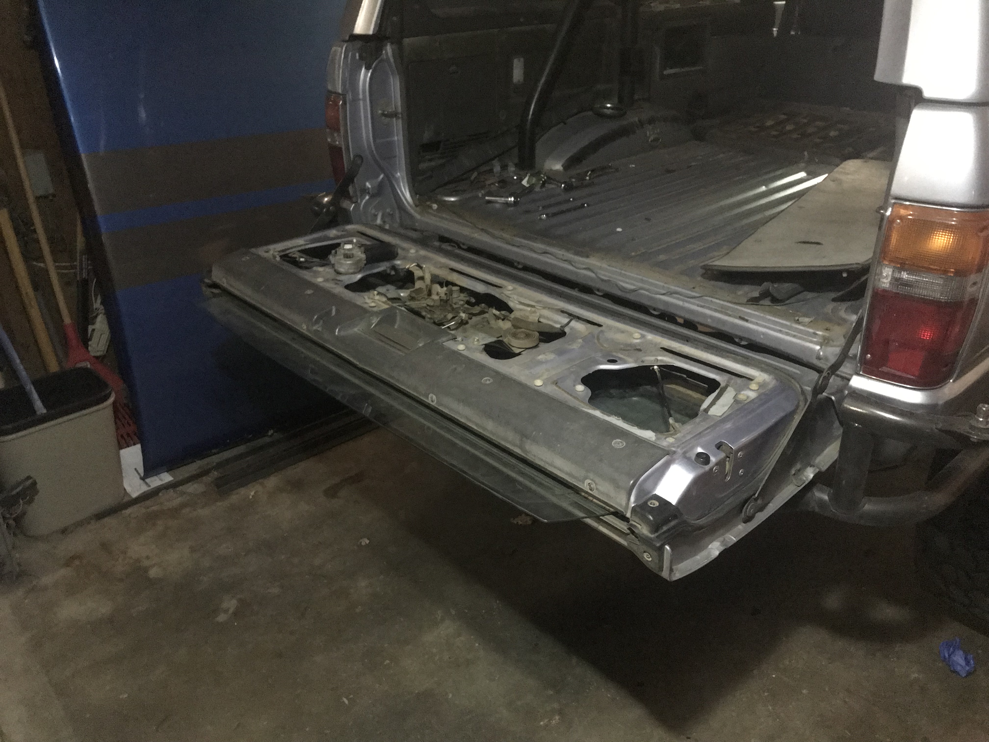

11-19-19 - Update - Rear Window Woes
Pulled the truck into the garage last night so i can work in some light. I ripped into the tailgate to gain access to the rear window/tailgate guts. At this point, I found a loose connector off the motor itself. Plugged that sucker back in and now the motor has power again but now the rear window makes a "thud" noise when I hit the switch to go up or down. Motor is definitely getting power but now i feel as if something is obstructing the up or down movement. At this point, I need a second pair of hands to hit either switch on the center console or on the tailgate that way i can track down which area is bound up.
Old Nov 26, 2019 | 07:01 AM
  #219
MaK92-4RnR's Avatar
Joined: Mar 2008
Posts: 6,059
Likes: 101
From: Sacramento, CA

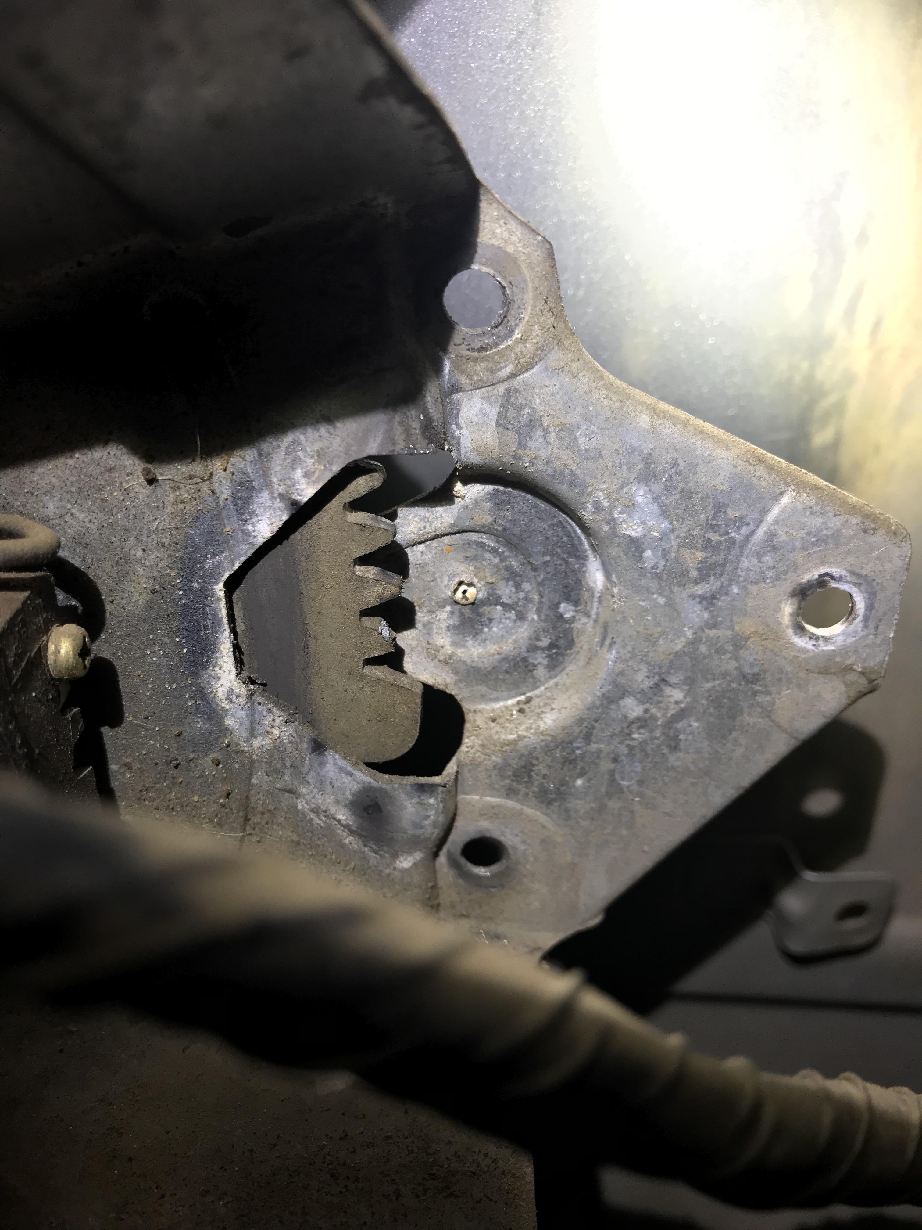

11-26-19 - Update - More Rear Window Diagnostic
Previously, I pulled the plates/covers off the tailgate to gain access to the regulator and motor. Last night, I taped the window up and pulled the motor. Once the motor was pulled, I was able to test it's function and it's definitely got power to it. It activates on the exterior and interior switches without any hiccup. Hell, it's got enough juice to actually "jump" when its not bolted to anything. I inspected the gears/teeth on the window motor and nothing looked out of the ordinary, damaged or rusted, for that matter.
Once I confirmed that the motor was in working condition, I grabbed the window glass and began to move it up and down manually and I discovered 1-2 chipped teeth on the window regulator where the motor mounts:
After discovering this, I was at work stoppage. I lowered the window down and got the tailgate open since this is the only way to remove the regulator and replace it.
Now begins the search for a complete tailgate or a regulator by itself. I wanna slap in a new motor while i'm in here and regrease everything once i find what i need.

Bummer about the regulator teeth. I'm interested in what you find for replacement as mine is making a bit of noise at the bottom of its travel, I suspect it is a broken tooth as well.
