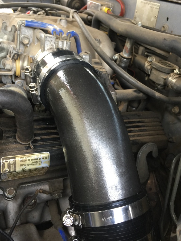

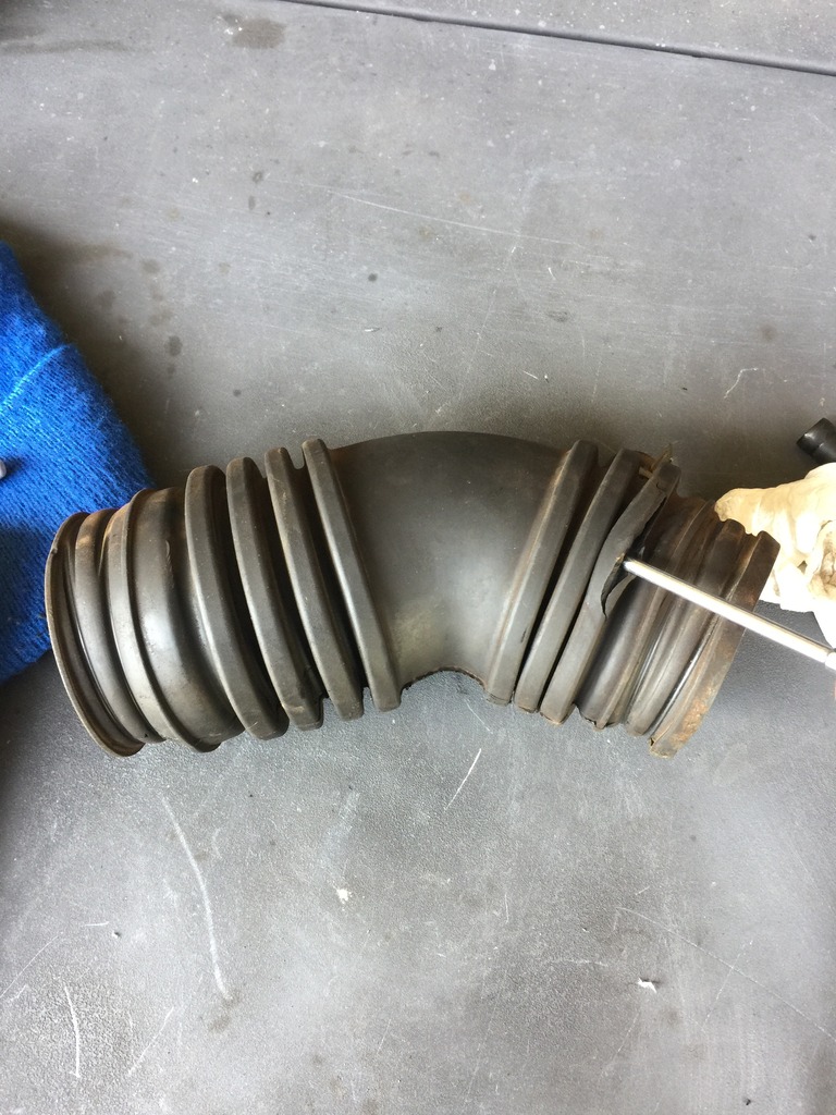

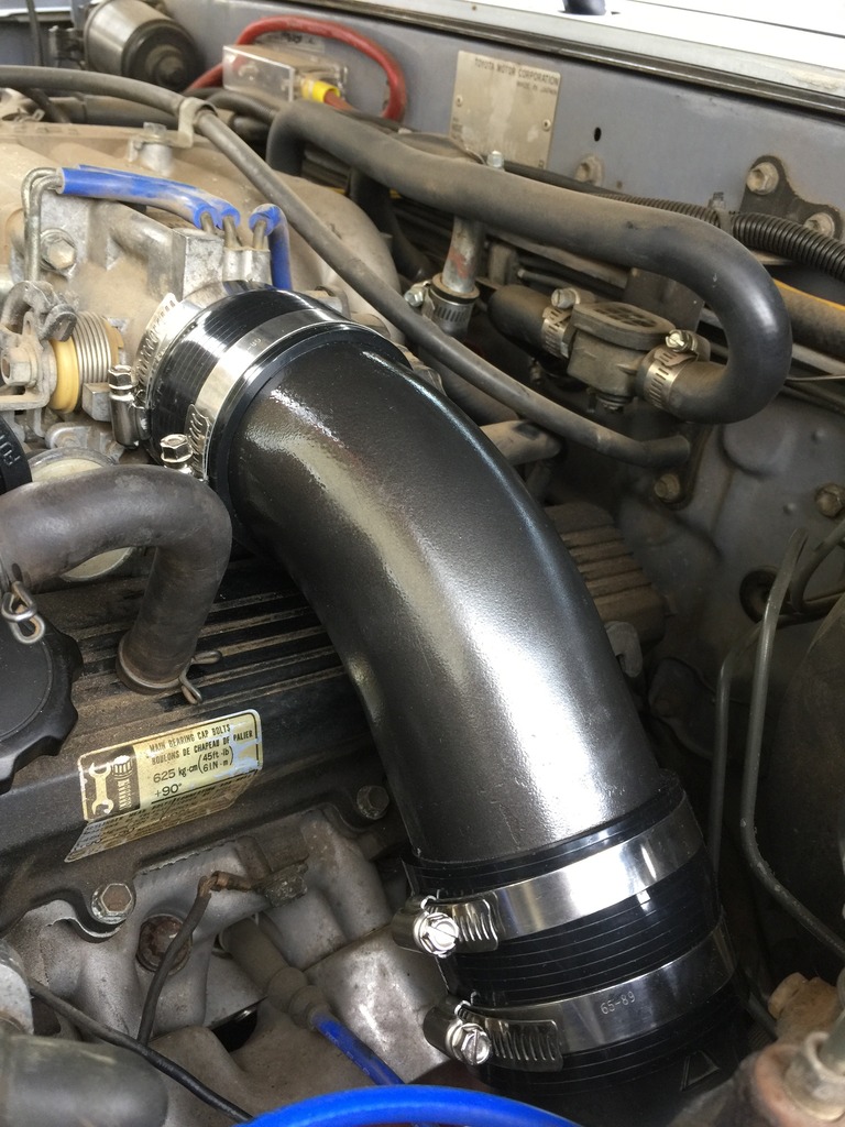

Gave the 4Runner some love today. The 3vz intake elbow is now a discontinued part and is no longer available through second hand auto part stores and it's $100+ at Toyota. With that being said, I improvised.
The one that was on the truck tore at one of the ribs which was causing unfiltered/unmetered air.
I had some spare material lying around and this is what I came up with with some silicone couplers and aluminum tubing.
What's everyone think?

+10hp easy
hah looks clean
Old Jan 30, 2017 | 04:17 AM
  #179
92ehatch's Avatar
Joined: Jan 2015
Posts: 652
From: Hendersonville NC
Originally Posted by 84 yota dude
+10hp easy
hah looks clean
Hey could be with it being sealed off properly.
intake arm looks great. Im glad you painted it and didn't leave it shiny silver
+10hp easy
hah looks clean
If it was, i'd sell them. LOL
Work still needs to be done to it for the crankcase recycle. It's currently attached to an open element for now since i didn't have any wire for the welder. I thought about leaving it silver, but i had time and spray paint lying around. Thought about getting it anodized/powdered.
