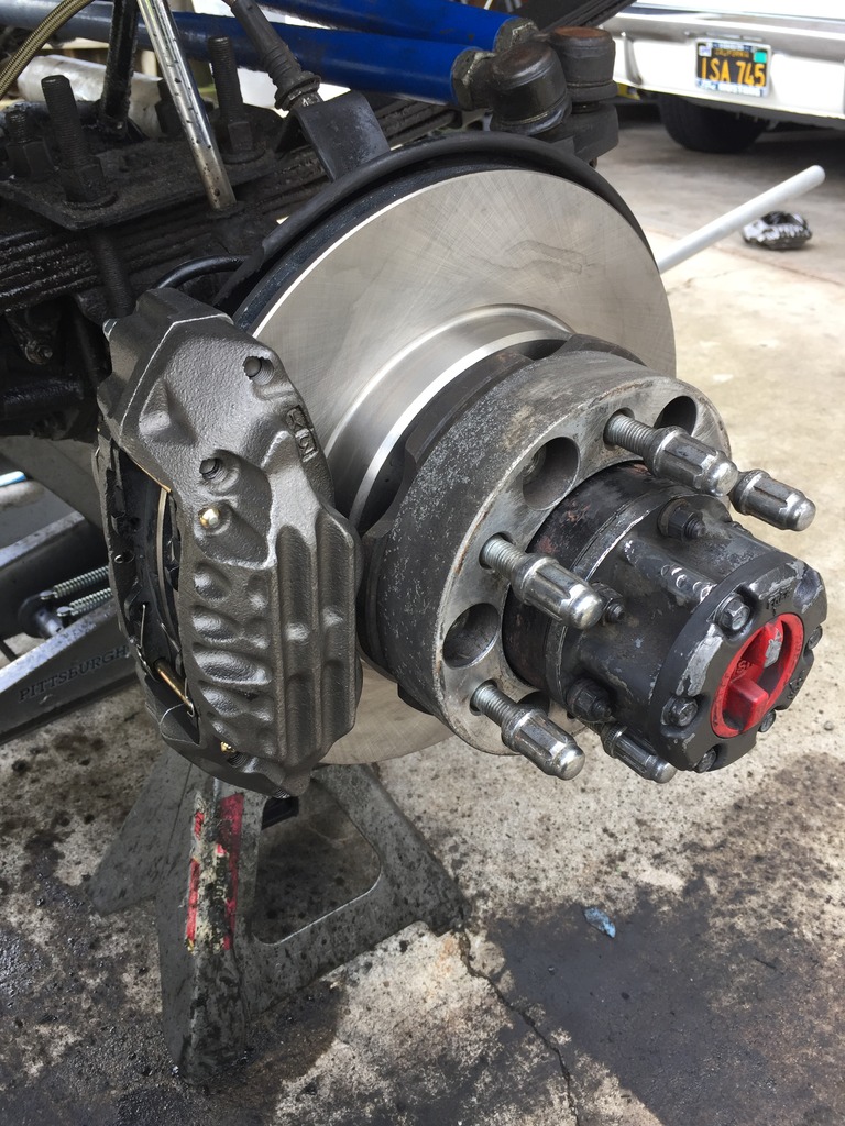

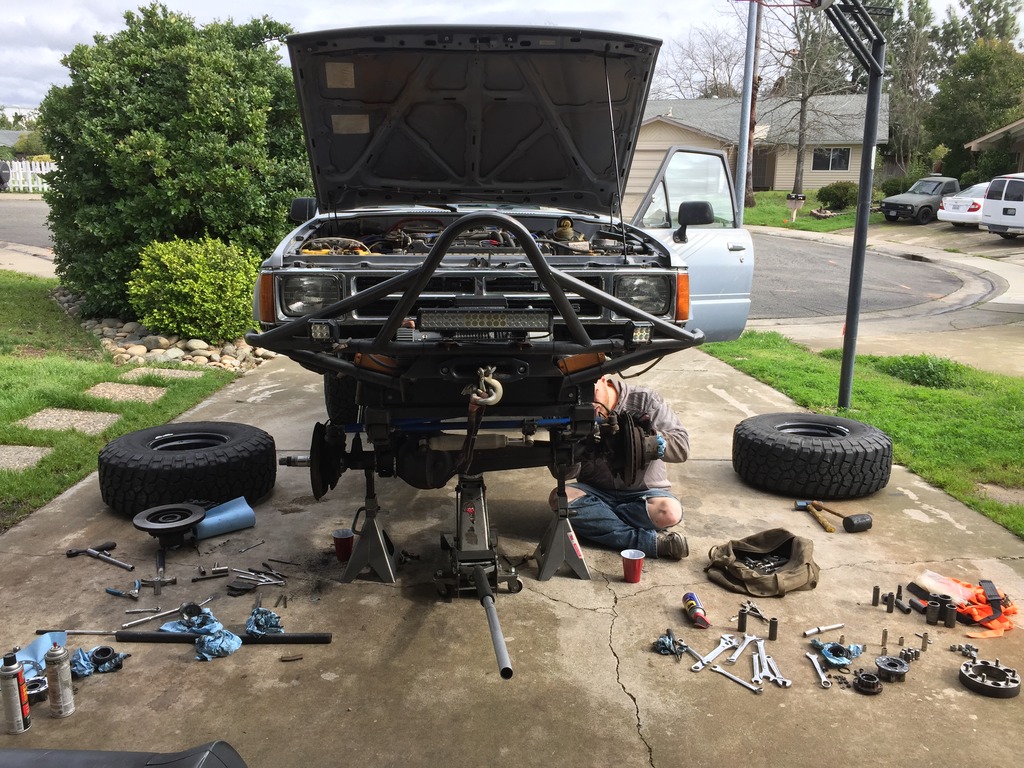

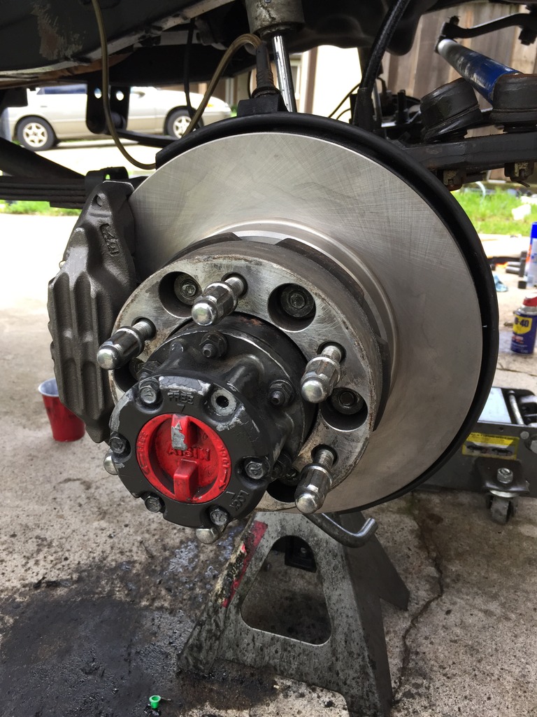

Did a full brake setup on the 4Runner last weekend. Well overdue, that's for sure. I bought the 4Runner 4 years ago at 195k and haven't touched the brakes since other than pads. It's now at about 235k and I replaced the calipers, rotors, pads and flushed the brake fluid. A family member was at my house while i was doing this so he snapped a few pictures with my phone:

Missing a bolt there.. haha looks great man!

Yeah, the manual hubs are missing a few hardware pieces that i haven't addressed. I'll be swapping IFS hub and bodies on soon enough to eliminate the wheel spacer.
Everything came from O'reilly since i'm setup direct with their corporate warehouse.

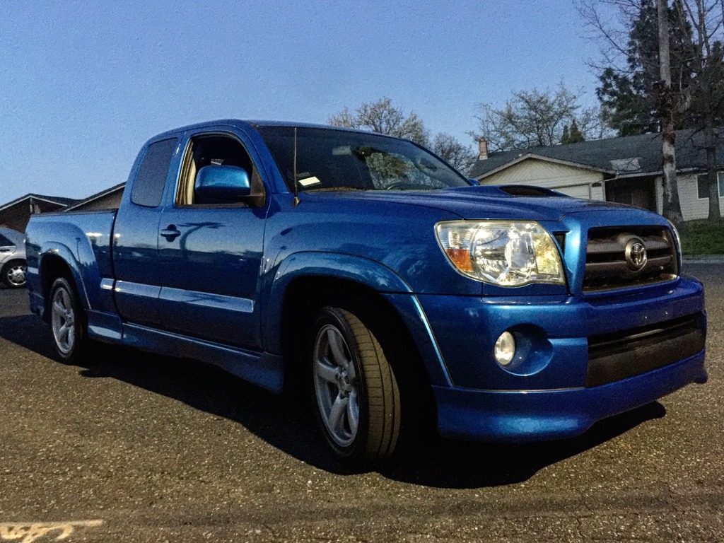

The biggest update? I added another Toyota to the family. I got a new job that requires some serious commuting and I've always wanted a pickup truck.
The night I brought her home:

The money shot:

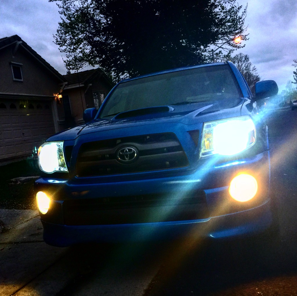

Through some HIDs in, it badly needs projector headlights now:

Put new tires on the X-Runner and America's tire discovered a cracked wheel. I tracked down a replaced 18" X-Runner specific wheel and painted them black. New wheels & tires:

That's all for now. I'll probably make a build thread for the X-runner since I already have parts piling up for it.
