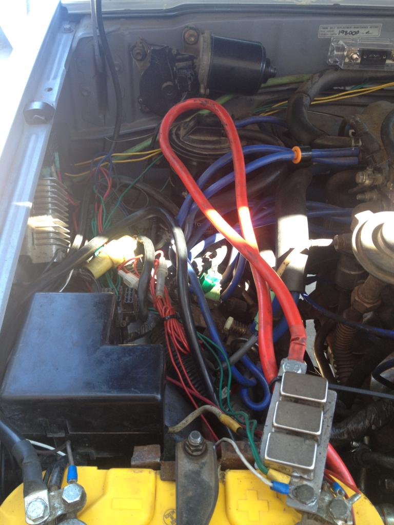

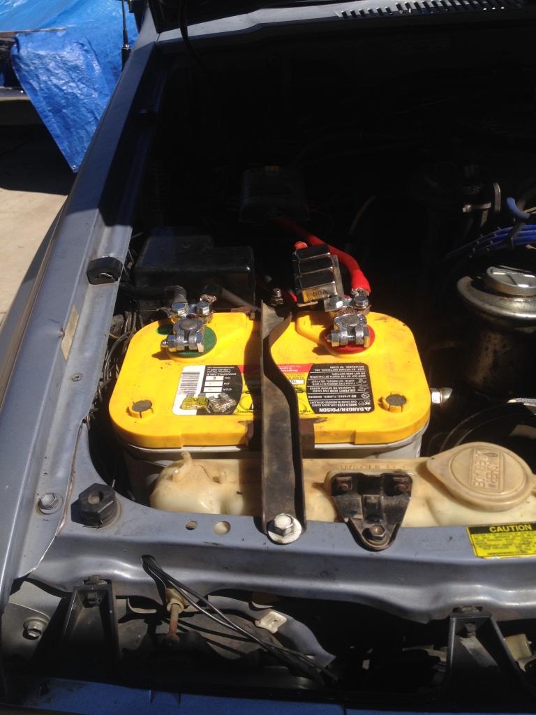

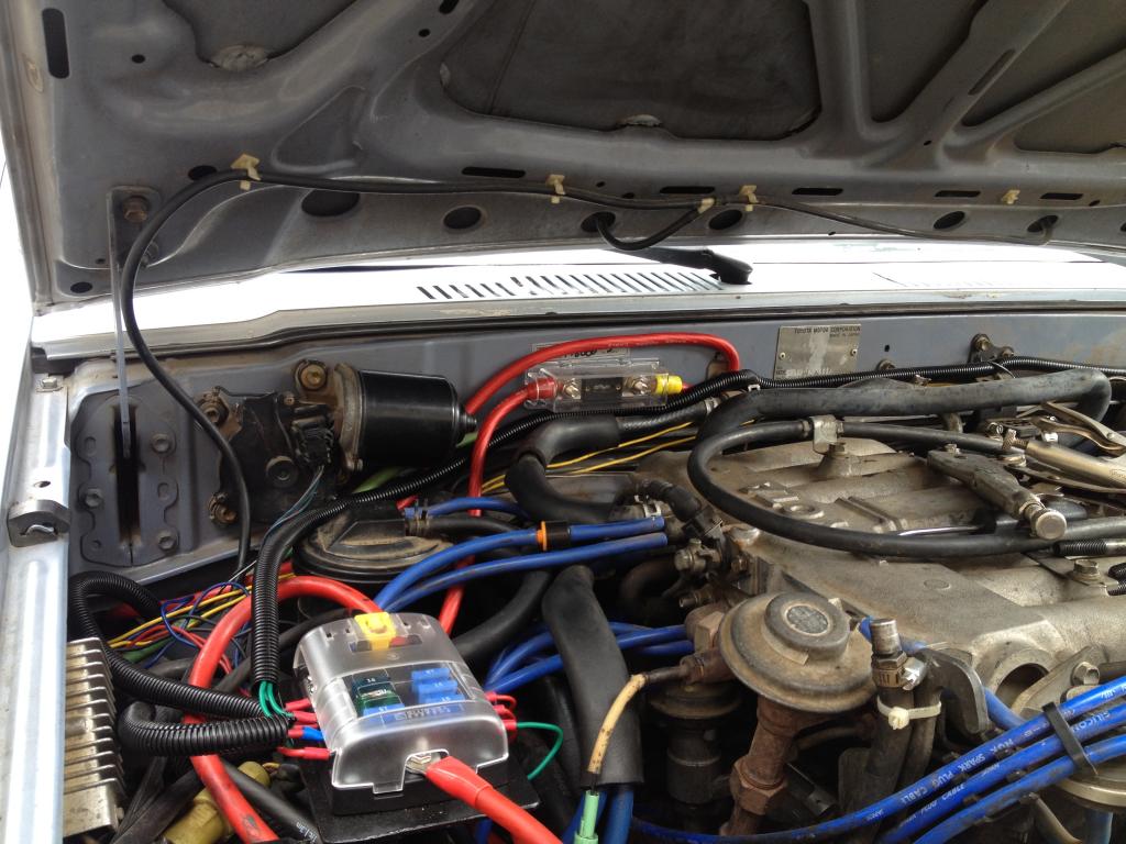

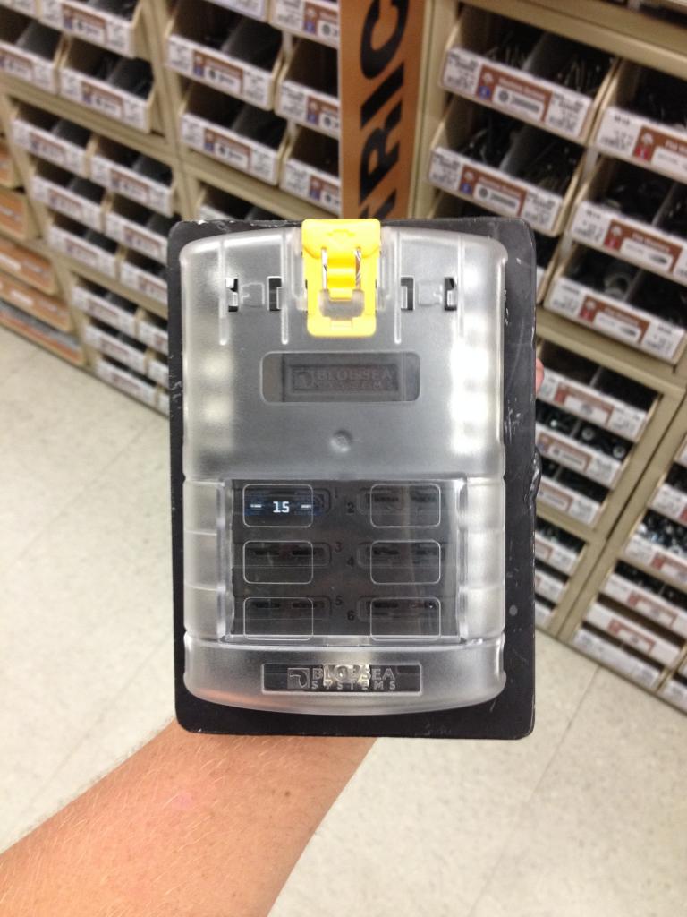

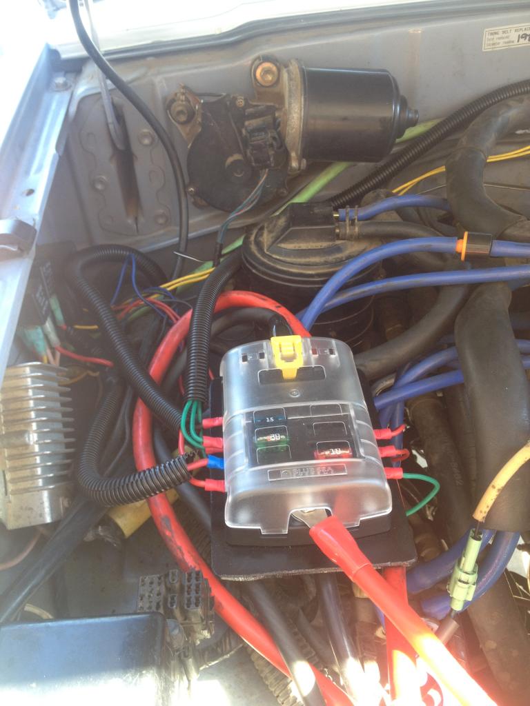

So, the Pismo Jamboree is on Thursday this week and being that this was my last weekend to really get anything done. Here's what I got done:
Blue sea fuse block:
Before:
After:
Still have a bit of wiring to wrap up, but basically all of my accessories is going to the blue sea now.
Also put new terminals on too:

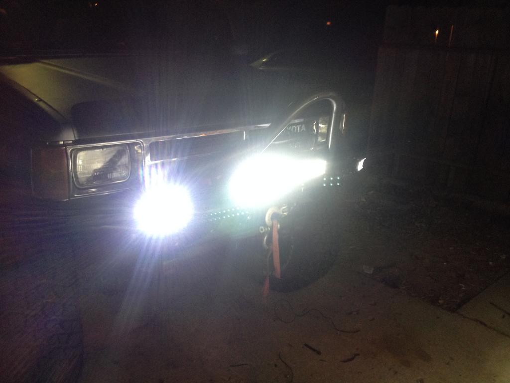

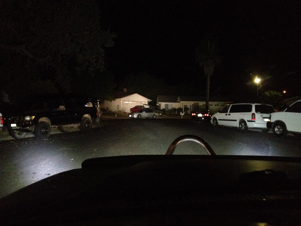

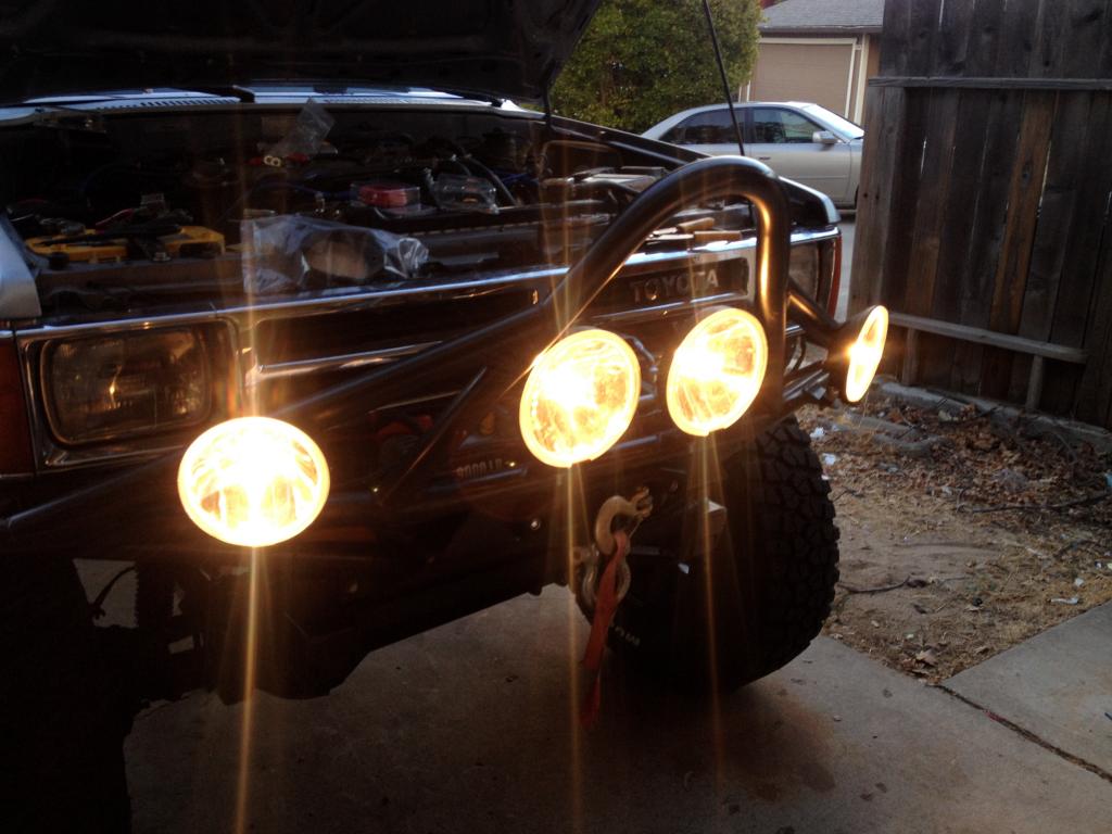

Swapped my Hella 700 & 500s for LEDs:
Before:
After:
Before (high beams):
After (LEDs & high beams):

thanks man. It was a pain in the butt to figure out the bracket to hold the fuse block. initially I designed it to have 3 legs and bolt directly to bolts on my fender well. but the thickness of steel I used was beefy, so it only has one leg and its completely solid. Not bad for my first welding project, right? haha the bracket to hold that fuseblock was fabbed by yours truly hahahaha
Dude, if you ever need help with your truck, lemme know. I basically a stones throw away from you. I don't mind helping at all. Lets get that thing on the road

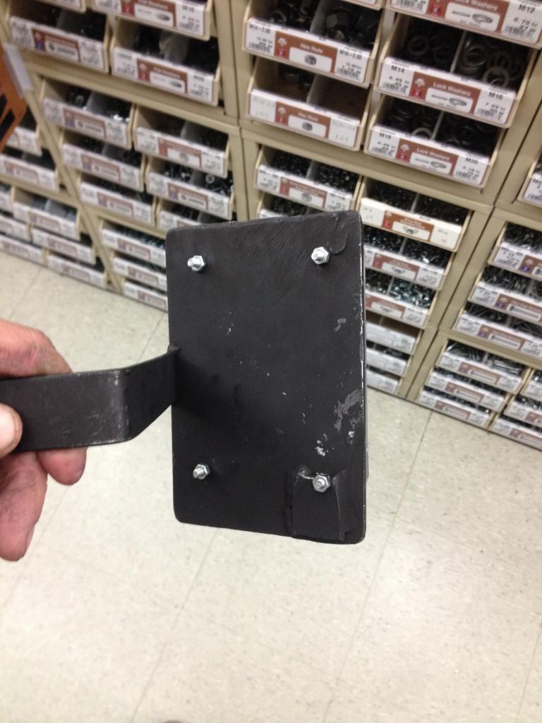

Just get a driveshaft from Pick n pull, dude. they're everywhere out there. Hell, I had a driveshaft sitting around my house a few months back that I sold on craigslist for 75 bucks. would've given it to you, had I known you needed it.
Here's the only picture I really have of the bracket. its nothing fancy... just works.
I used my uncle's lincoln 140. the bead is only 3/4-1" long... nothing special, but it came out nice.

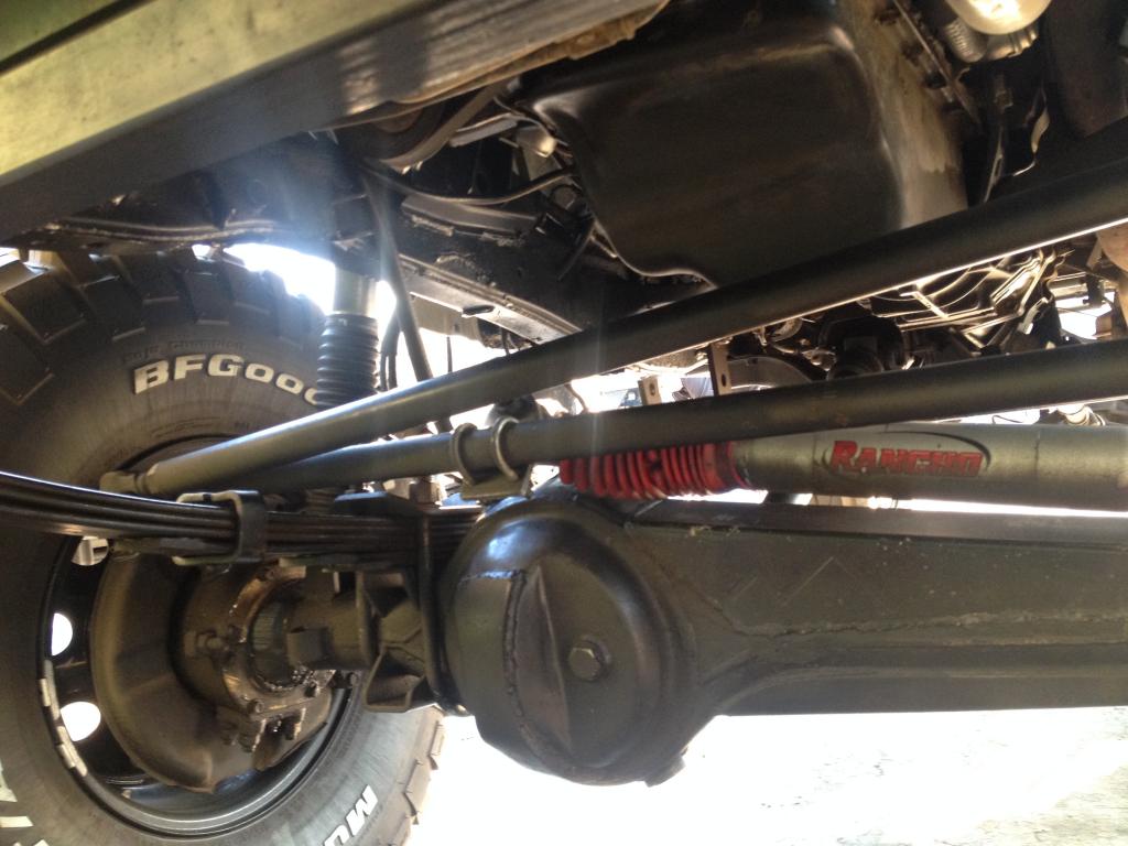

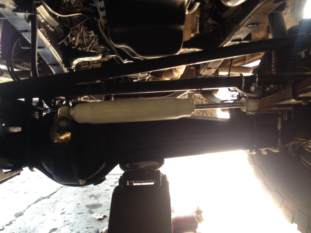

Steering stabilizer has been relocated. All I did was move it back around to the front of the axle. Sure its lower, but shouldn't be a problem getting hit.
Before:
After:

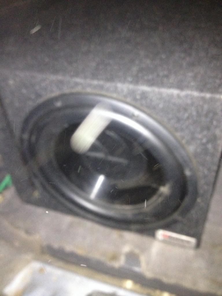

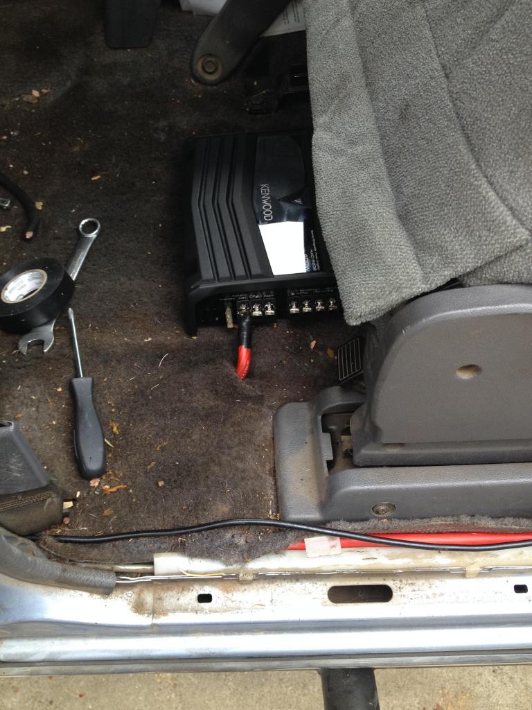

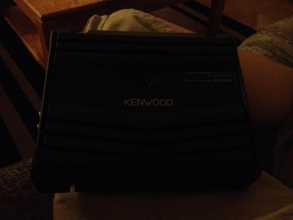

Also got a few things to add a subwoofer into my truck for a little thump while on the trail. Friend of mine traded his car in and had this subwoofer sitting around in the garage. picked it up for 20 bucks. bought a kenwood 400w amp for 65 bucks, and a 4 gauge wiring kit for 25.; should be golden!
amp:
Sub:

Mike, did you make sure that the stabilizer does not contact the the leaf spring, and the you can turn the wheels to full lock. From the pic, the space looks really narrow. Was there now way that the stabilizer would fit from behind, like if the stabilizer sat more over the tail end of the Diff.?
I also do not see any bumpstops?
Looks like you have a leaky passenger side axle seal.

the steering stabilizer is 100% perfect. doesn't hit the leaf perch, and doesn't have any clearance issue. night and day difference between having that old one ( I turned it upside down and the shaft fell out )
no bump stops on the front, yet.
it might be a little leaky. its got about 35k miles on it. I'm getting rid of the stangs to garage the 4runner

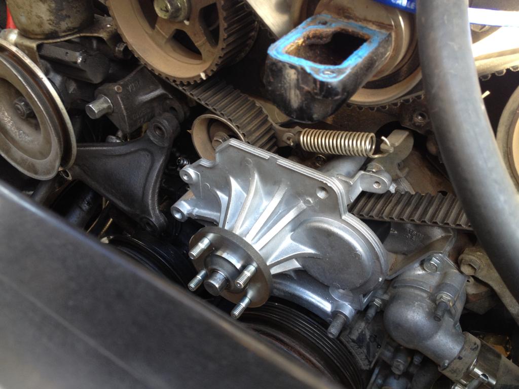

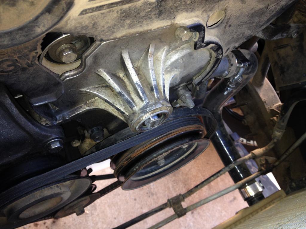

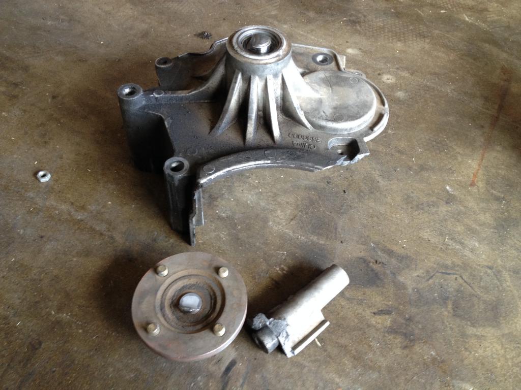

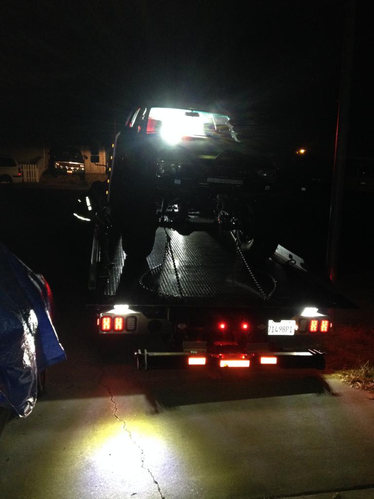

Pismo jamboree was this weekend, and it was not only an adventure while I was there, but it was definitely an adventure GETTING there...
The truck was running great, I was on my way home from school late on Wednesday night. get off the freeway, roll through the next intersection and the truck decided it didn't need its False water pump / cooling fan bracket anymore. So after some serious cussing, and getting home at 2:40 in the morning on Thursday. I got about 4 hours of sleep, took the day off work, made an abundance of coffee and got crackin' on repairing the truck HOURS before I leave for Pismo.
Pictures of the night:
Here's the fan bracket in the morning:
Here's the fan bracket after it was removed ( autozone/oreilly China POS )
Toyota AISIN fan bracket installed ( $233 dollars ):

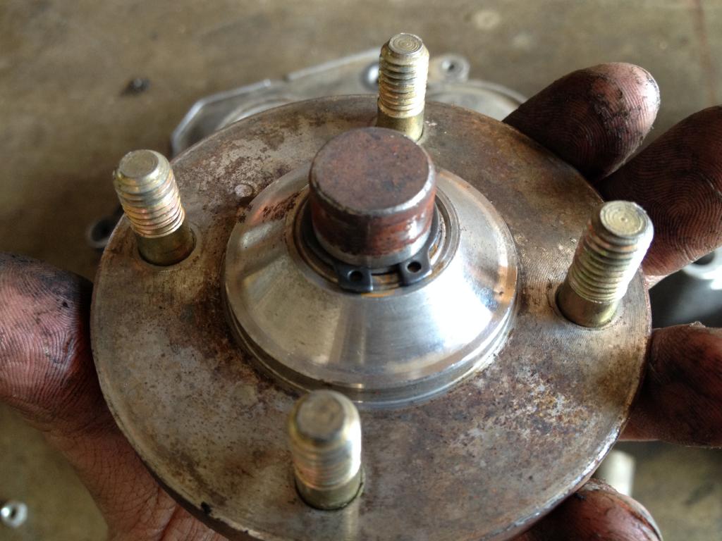

I'd also like to take the time to mention the difference between the autozone and factory Toyota ones. Seriously, get the Toyota one. I know its 150 dollars more expensive, but honestly? its a weak point in the 3vz. it holds all of your pullies on. ( power steering, alternator ) and mounts your fan.
This is the autozone one. It had this C clip in it to hold the shaft on. this was on both sides of the fan bracket. The autozone one also had casting markings in it, and was very cheaply built ( even though it highly resembles the AISIN one )
Here's the Toyota one. No clips holding the shaft
Anywho, got the truck back together kinda later than expected. It took a bit for Toyota to get it delivered from another store. So I worked on the stereo while waiting for the bracket to come in.

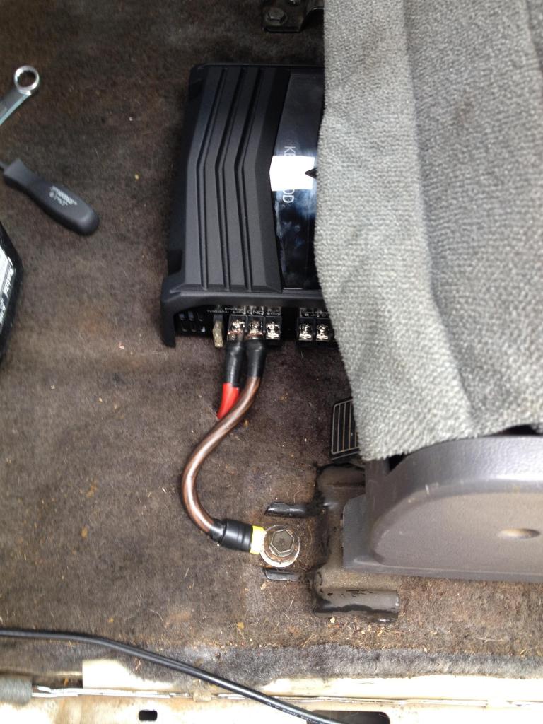

Here's the stereo all wired up:
I'm not really happy with how its wired in the engine bay. I planned on running it on my driver side, but the firewall hole is full from gauge wiring, and the e locker. so I looped it back around.

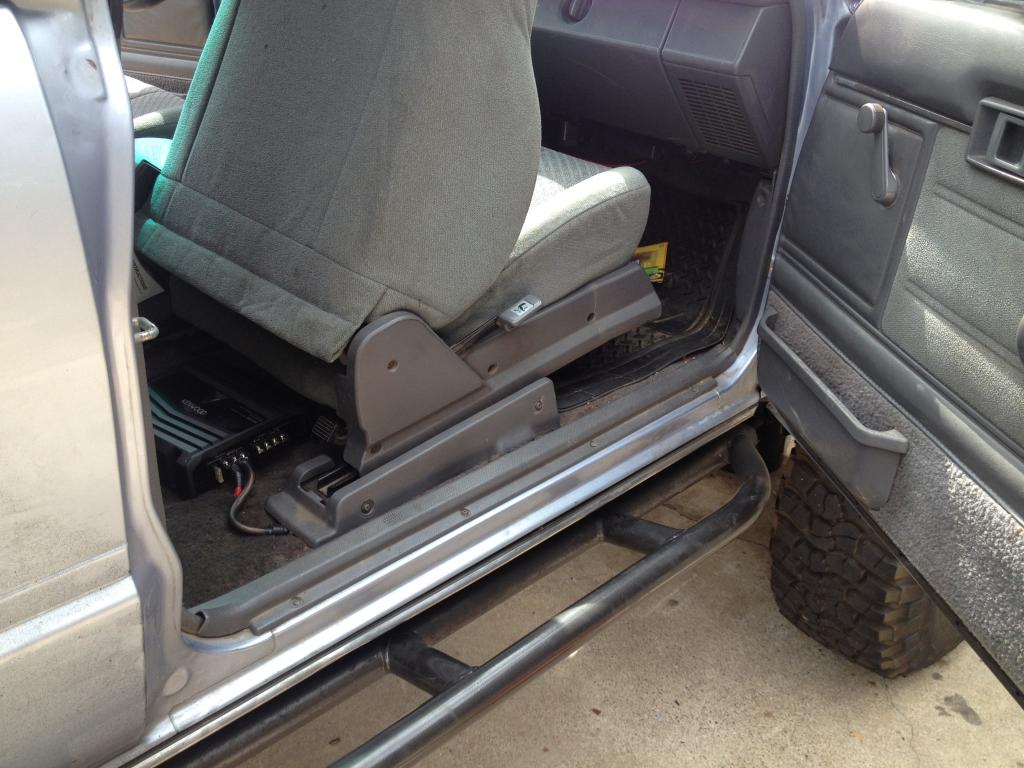

Mounted the amp under the seat. plumbed it all nicely and hidden:
Ground:
Put everything back together:
Don't have any pictures of running the stereo wiring. but it all works. it doesn't "hit" very hard, which is what I wanted. just something to even out the amount of highs/mids. with a bit of lows.

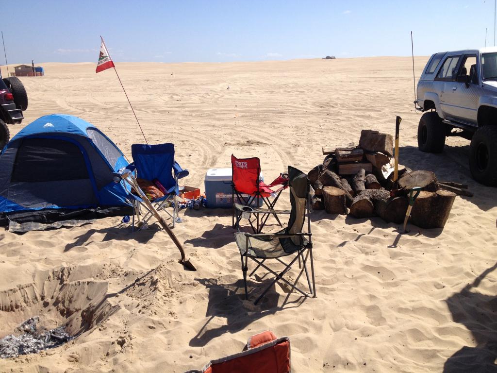

Here's the Pismo recap:
We had a total of 5 trucks caravanning from Sacramento on Thursday night. My cousin drove down in his T100 on Friday night. We also camp with a few guys from Modesto. We had a total of 8 trucks as the original group.
I didn't get much pictures when I left Sacramento. But he's the group from Sac at Kettleman. ( about 4 hours south of sacramento ):

Here's a portion of our campsite. This is early Friday morning, so people for the event aren't really there yet:

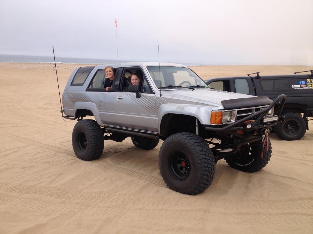

My sister and her friend in the Runner:
Driver view:

Here's a whole picture of Green camp ( don't mind the hat, its an inside joke ):
