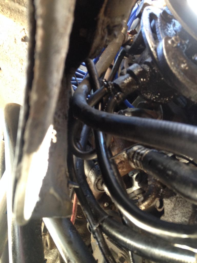

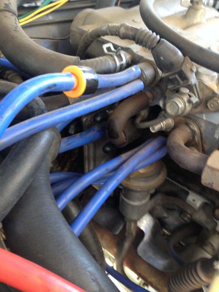

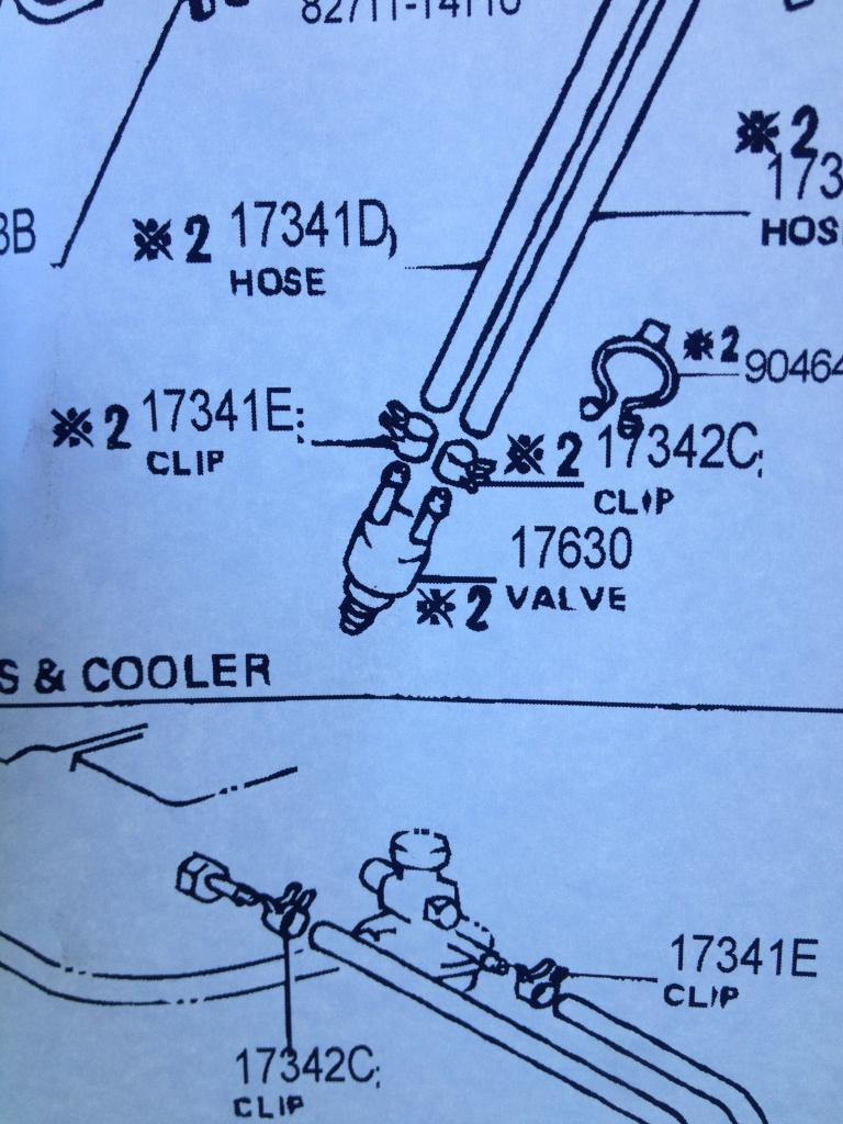

Well, I've had a day that's for sure.
I changed the oil today, and with it smoking for awhile I expected a lower than usual amount of oil to come out... right? wrong. 6 quarts. So after scratching my head for about an hour or two. I'm like how in the hell is that possible?
Lately my power steering has been giving up the ghost, and I've been keeping it topped off with ATF to keep it going as long as possible till I find time remove/rebuild/reinstall. Well, I look down at the air control valve and its completely corroded. I follow the two vacuum lines to the intake manifold, pop the hose going into the intake manifold off. ATF drips out. No... F'ing... way...
So after calling around to see how much a new valve is:
$130 typical price.
$80 online
$373 at the stealership.
So I jumped online, found a review that its basically a vacuum assist. theres no other benefit other than making the truck easier to turn under load. so F it. I capped it all off. jacked the truck up, topped off the power steering fluid, and it no longer smokes, or has issues with the power steering, other than it drips a little.
Here's the vacuum lines capped:
Here's the valve recycling everything:
That's the culprit
Just posting this for informational uses. The smallest things cause the biggest problems. Truck no longer smokes, and runs like nothing happened.

AWESOME FIND! isn't it weird how the little things can cause the most random symptoms?
