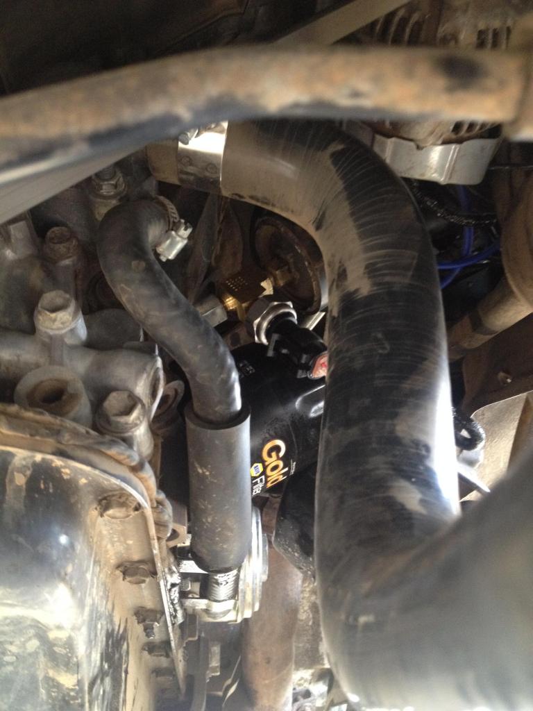

Finally got all of my gauges working correctly. It took me a bit to get them all setup because I couldn't figure out what size the threads going into my block were. ( they're 1/8 BSPT ) So ordered a 1/8 bspt male to 1/8 NPT adapter. with a 1/8 npt TEE with a male, female and one female BSPT for the stock oil pressure sender. put it all together and it worked. no leaks, and both oil pressure gauges work flawlessly.
http://vid850.photobucket.com/albums...ps2b03c3f0.mp4

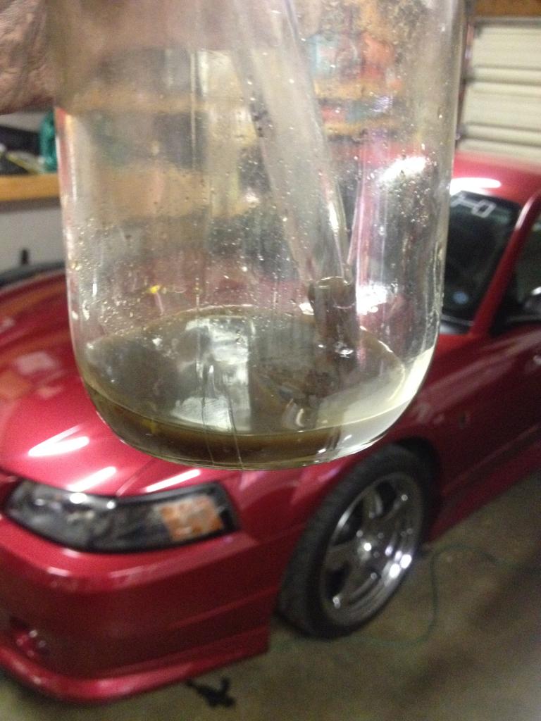

The power steering pump has been giving me a little whine. So I decided to drain the fluid and what I found was kinda misleading...
Yay for power steering fluid in a pump that uses ATF... Anywho, swapped it to ATF. no leaks, no whine, no problems.
