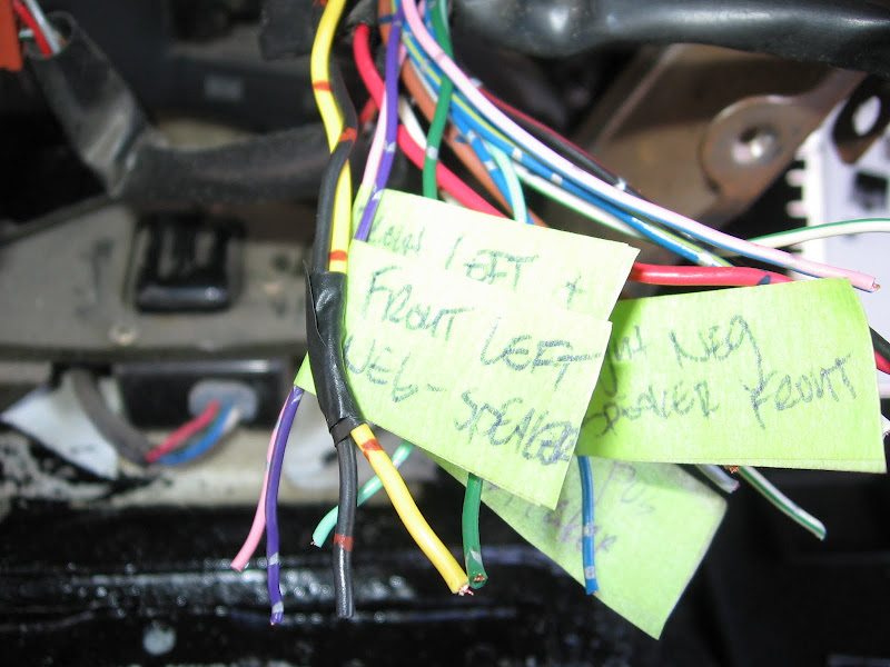

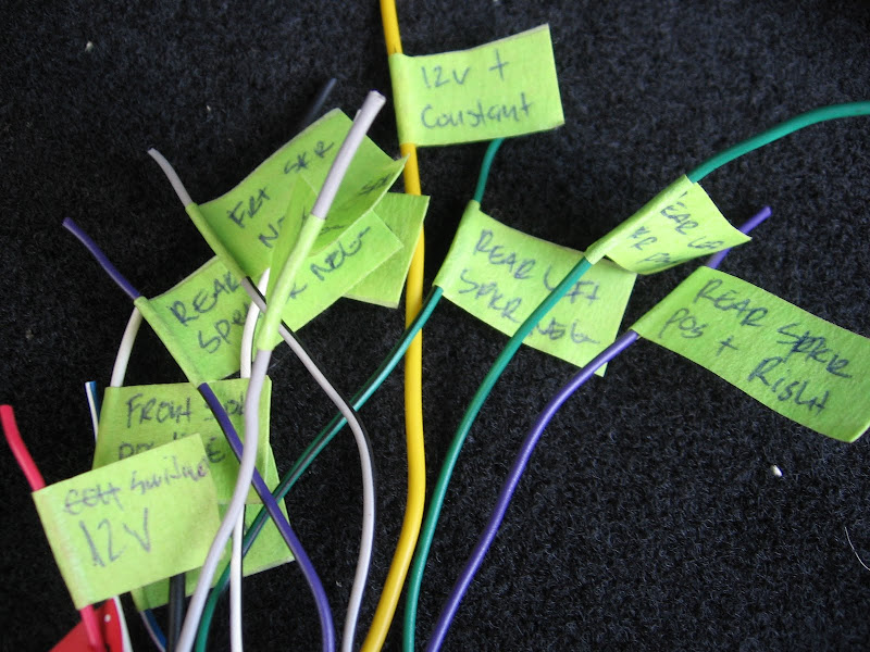

I was able to get a little work done yesterday, and that included rewiring and reinstalling the CD player that came with the truck. It took a lot longer than it should have because the stock wiring harness plus was cut off so I had to track down each wire, but as usual this just helps me learn every inch of the truck. Its a lot of work to tear everything down and redo it all but the piece of mind that I get from doing it myself and doing it right is worth the extra effort. When I got the truck the sound system install was so bad that I would have to bang the dash/CD player to get it to turn on. If I hit a big bump with the CD player on all the sound on the right side of the truck would cut out, the next big bump it would come back on. No connections where solid or really protected as you can see from the pics on the first page.
I also have a alarm system / remote start system that I will be installing over the next week or so. I have had it for years and its been sitting in a box, so I guess now is the time to put it to use.
With the help of my Multi-meter, the FSM and google I was able to getr done.

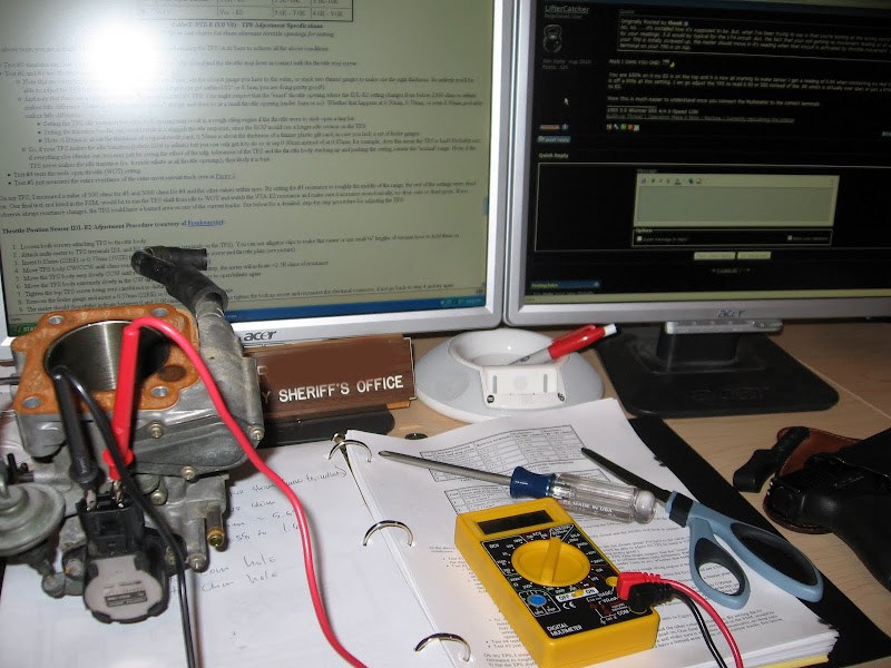

Well I was finally able to get the TPS readjusted, It took some time but with lots of help from some awesome YTers I was able to get it done. I have a very detailed thread that address all the issues that I ran into while adjusting the TPS and fix to my issue it can be found here.
https://www.yotatech.com/forums/f116...r-help-219947/
I hope my thread is able to help others that might run into the same issue. In a Nut shell the terminals in the TPS plug are actually inverted from the FSM and other sources. So I my E2 terminal was actually the top terminal and not the bottom one.
(Here is a shot of calibrating the TPS and adjusting it back into spec.)

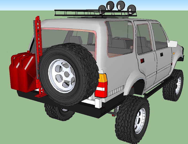

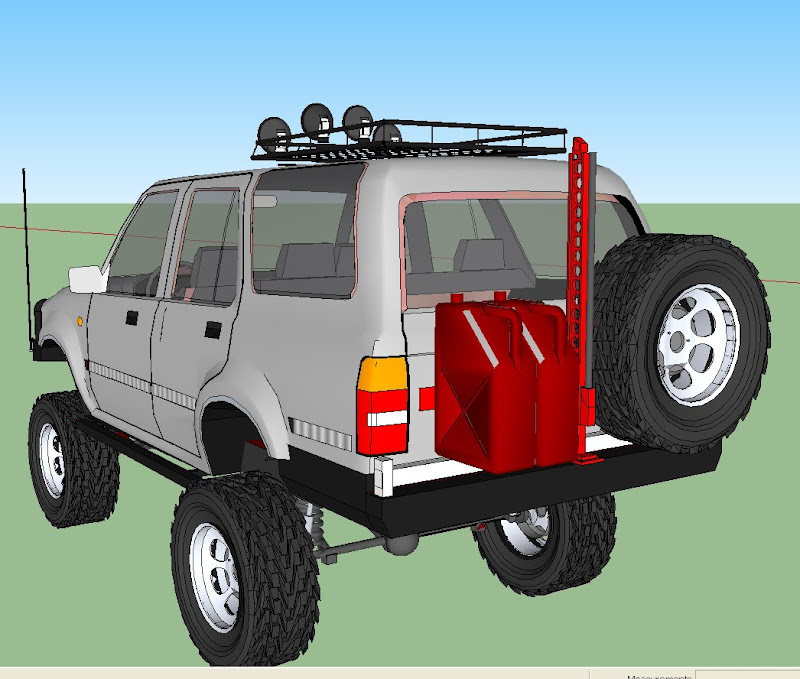

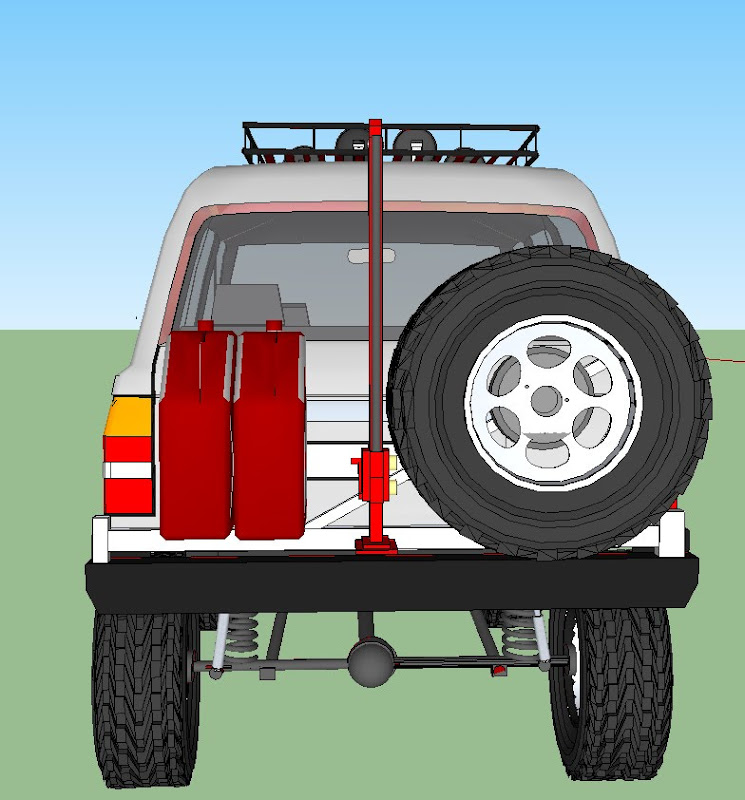

So I did some 3D rendering tonight to mock up some ideas for my rear bumper and tire carrier swing out. Tell me what you guys think
Excited to get this build under way!
Chris

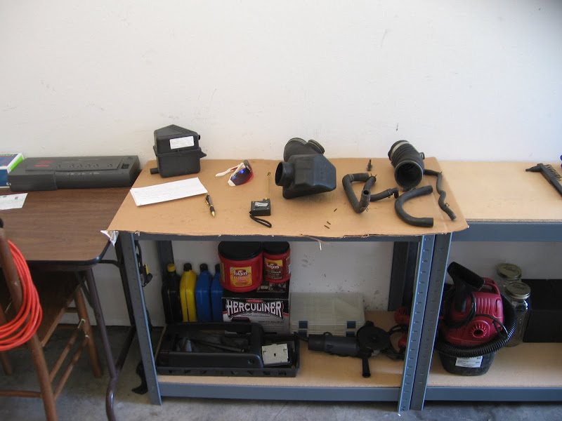

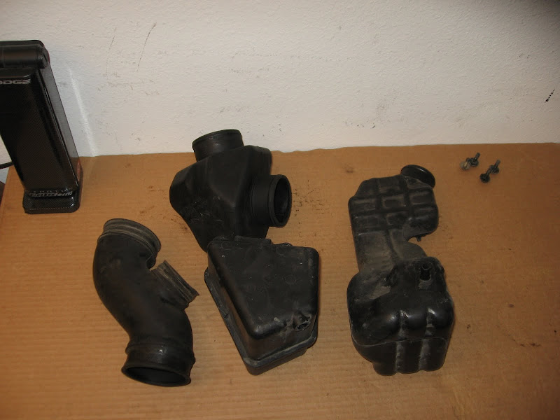

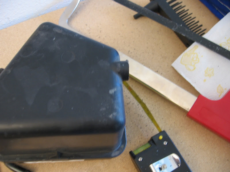

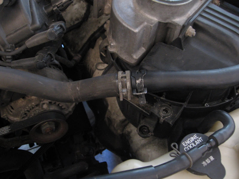

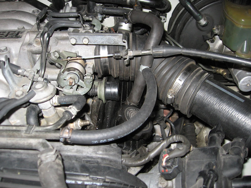

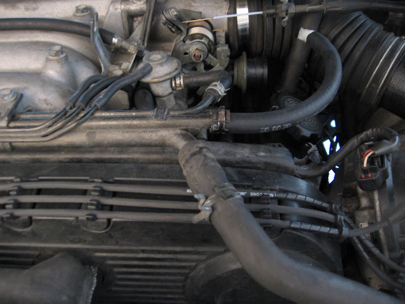

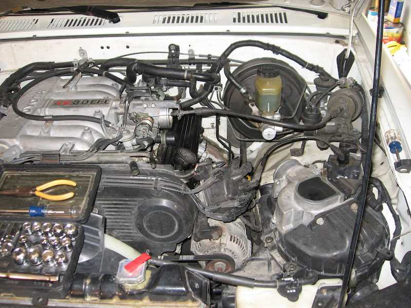

Ok so today I decided to do the ISR mod, cost about $13.00 but it took three trips to the parts store. Its not the best but its cheap and a lot better than stock.
(crap out)
(junk no longer needed on the work bench)
(Mock up to get the fit just right)

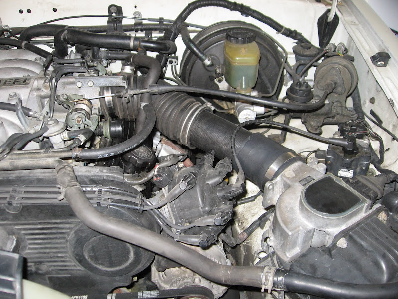

(In this pic I cut off the bend on the middle vac tube to allow me to run a hose back into the valve cover breather using a T. Looks a ton better and works great.)
(Hacked off the male outlet to use to join the two hoses back together, better shot in the below pic.)
(pic shows the hacked van tube and T.)
(This is how I joined the bigger vac line to the intake air filter can)
(Another pic of the junk not needed anymore.)
COMPLETE!
