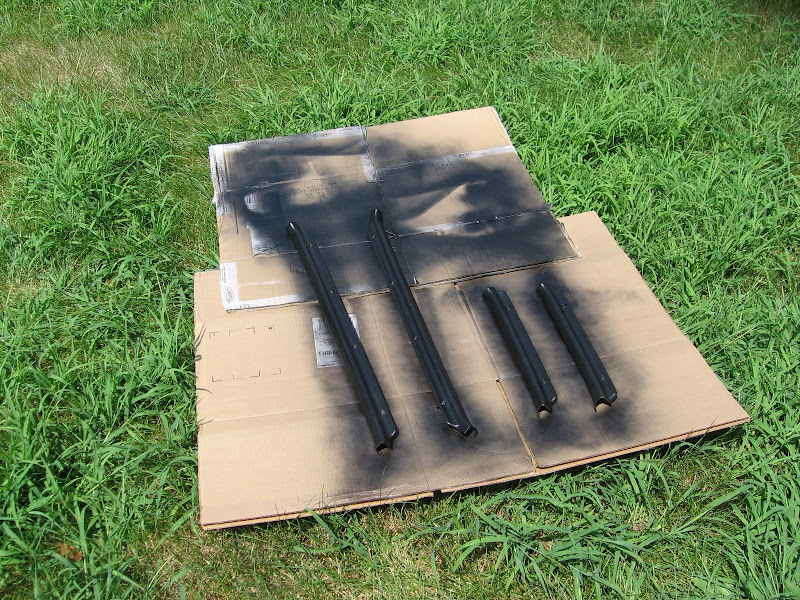

OK got some more work done today, and its really starting to look like a 4Runner again.

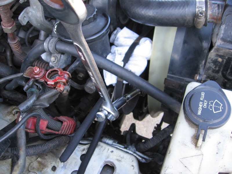

Best part of the day is that I was able to remove the old cheap alarm system with little to no problems, but I had a few. The person who installed the alarm system used some fuse taps that caused a lot of problems. These are the taps he used to tap wires into the fuse box.
It uses a metal piece that slips over the fuse and then you put the fuse into the fuse box. NEVER NEVER buy these or use these!!! Reason being is that the extra width causes the female adapters in the fuse box to be forced wider than they should be, a regular fuse without the tap will no longer fit into the fuse box. So after removing these junk taps and putting the fuses back in the dash gauges and AC quit working. It took me a little bit to figure out what the problem was but I got it taken care of. For future reference if you ever want to tap a power line from the fuse box make sure to use these devices called "ad a fuse" they are awesome, and I have used them on all of my vehicles.
They are a little more pricey but so worth it.

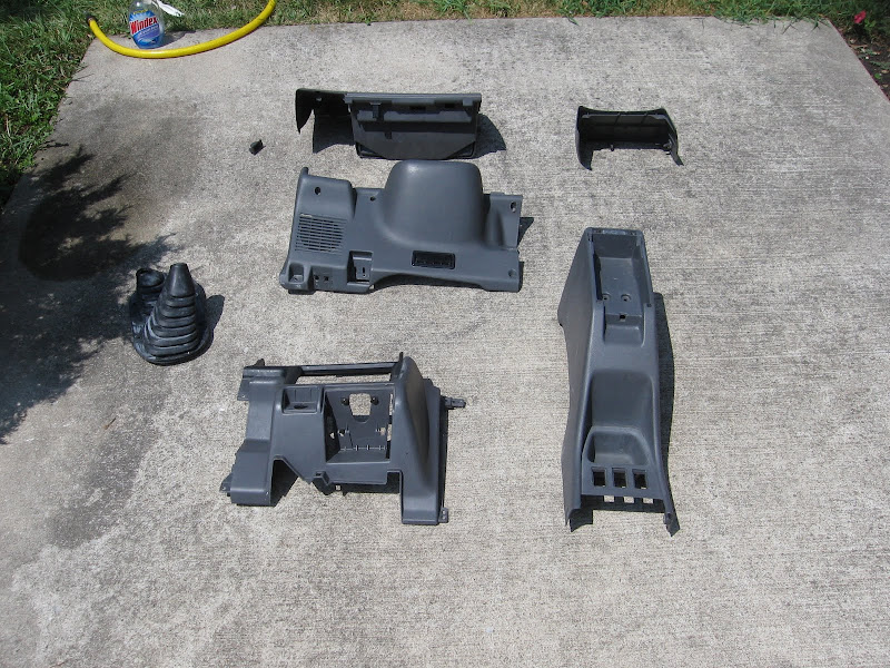

OK after spending a couple of hours getting the alarm system out, and cleaning up the wires I started to prep and paint some of the interior pieces, and they turned out amazing I am very happy, they match the Herculiner really well.

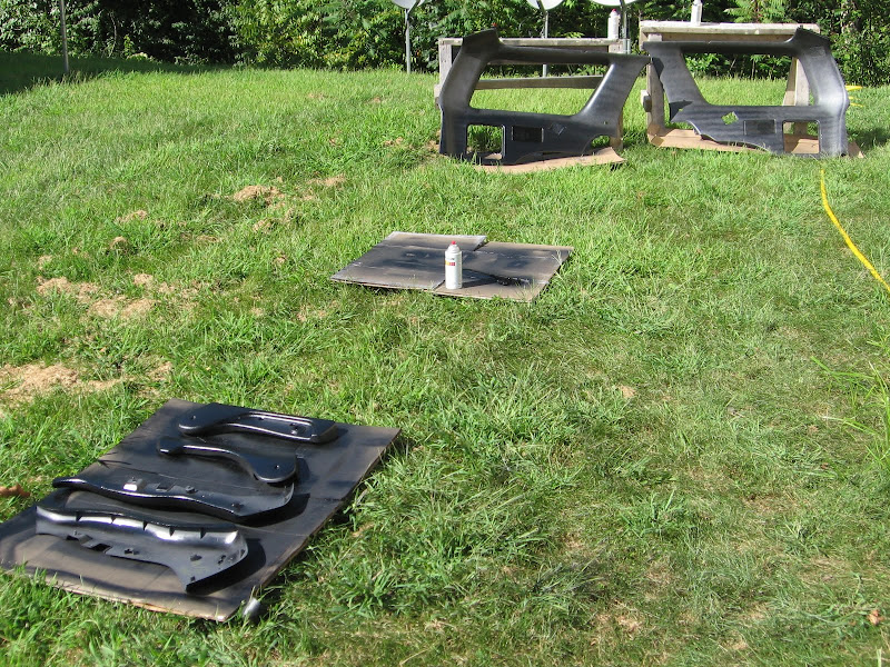

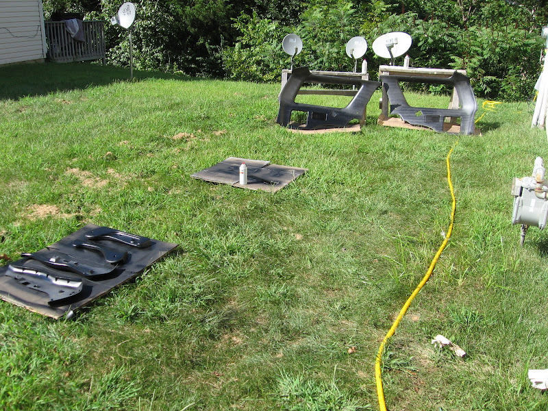

( Gray stock parts cleaned and drying in the sun.)
(lower trim painted and drying in the sun.)

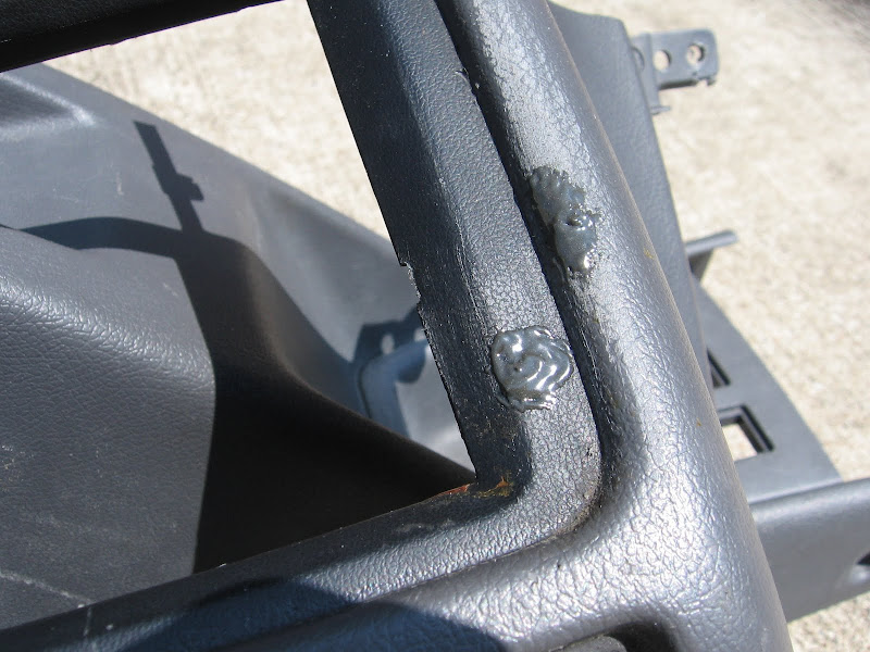

(The dash had a couple of screw holes drilled in them so I used some good ole JB weld to fill the holes and then sanded down the JB weld flush and its ready for paint, sorry I forgot to snap a pic of the sanded down dash piece.)
(Pass side kick panel painted and installed matches perfect.)
(Drivers side kick panel painted and installed )

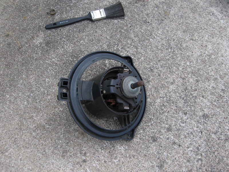

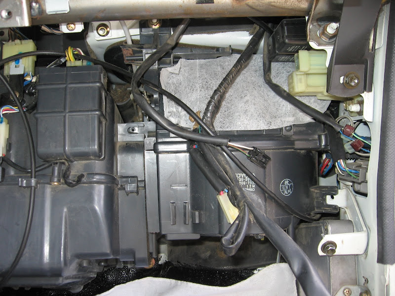

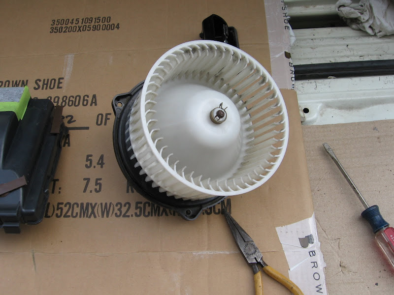

While some of the other trim pieces were drying in the sun I decided to try and locate the in cab air filter. Well I searched and searched to no avail, decided to take a little break from the sun and search Yota Tech to try and see if someone else has found the in cab air filter, conclusion is that the 2nd gen does not have one. So I decided to pull the blower motor and fan and give the system a thorough cleaning.
(Pulled the blower motor and fan)
(This pic is after the cleaning looks 100 times better forgot to snap a before shot but all the white you see was BLACK with dust and crap.)
(Blower motor and fan separated, used a dry paint brush to clean the motor and motor housing.)

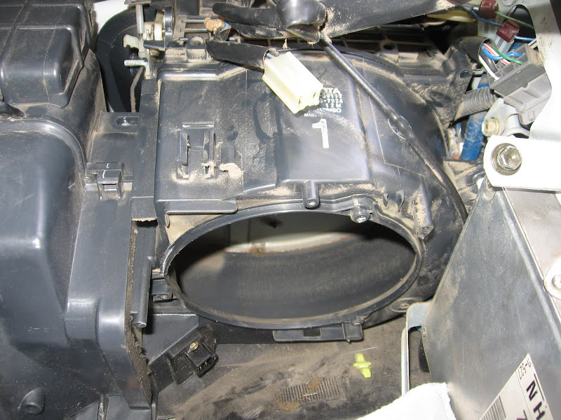

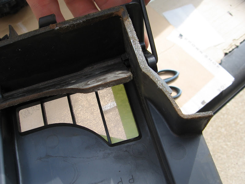

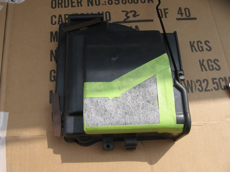

Since the 1st gen and 2nd gen do not have in cab air filters I decided to make my own I used a dryer sheet and cut it to fit over the in cab air circulation intake used some frog tape to hold it in place, don't worry once the glove box is installed you cannot see any of this. The dryer does two jobs, its thin and allows air to flow through it very easy and it also smells great
( This shot is from the inside looking out, you can also see how thin the dryer sheet is)
( Blower motor and fan installed after being cleaned, you can also see the other intake covered with a dryer sheet, I used a rubber band to hold in in place over the intake.)

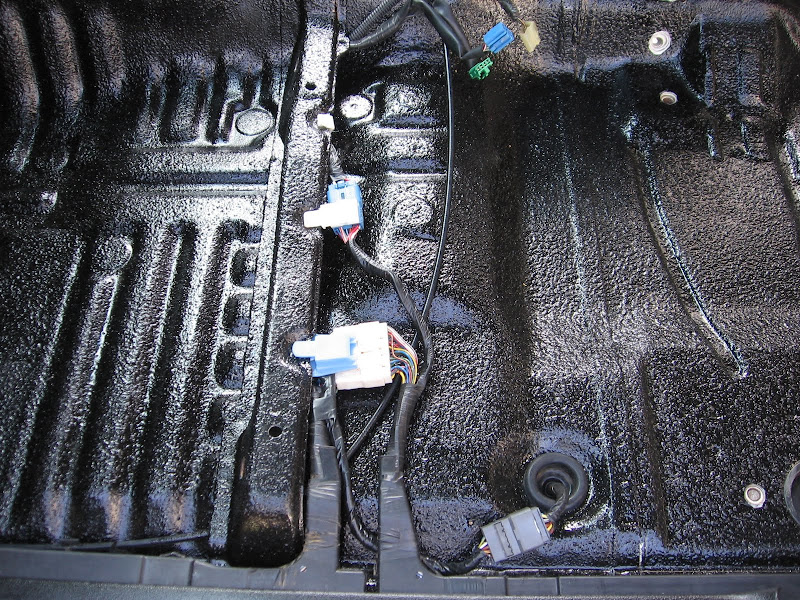

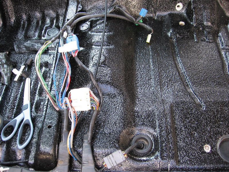

I also relocated the rear wiring harness. In stock form this wiring harness comes out directly under the front drivers seat and then does through the floor board to the under side of the truck right in the middle of the rear driver side seat area. If there was a passenger sitting in the rear seat behind the driver this wiring harness would be right in the way. You can see the wiring harness in the pic right to the left of the Acetone can.
(Here you can see the new location of the plug for the wiring harness, it moves the plug to the left of the drivers seat and out of the way of the rear seat foot area.
(In order to relocate the plug and harness I had to split the harness to gain access to the wires.)
(Here is the final product Wiring harness all tapped back up and the plug and harness relocated. All of the wires that you see will be hidden under the drivers seat. It looks stock)

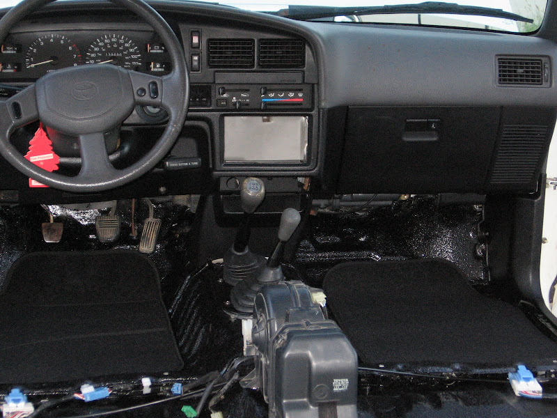

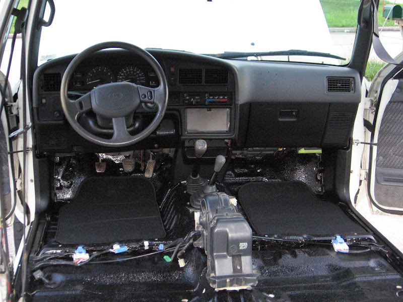

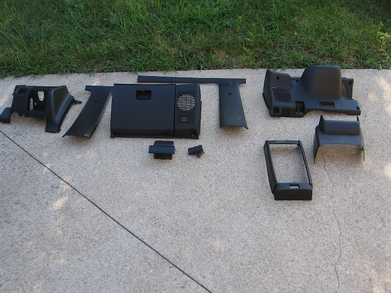

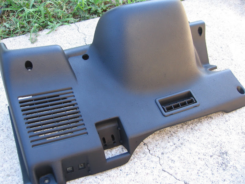

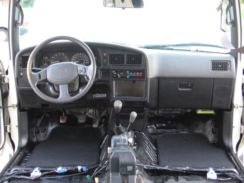

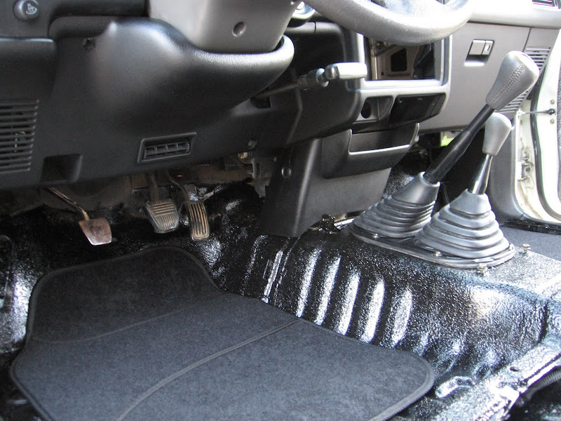

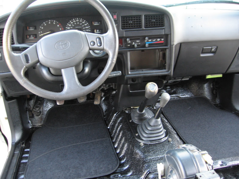

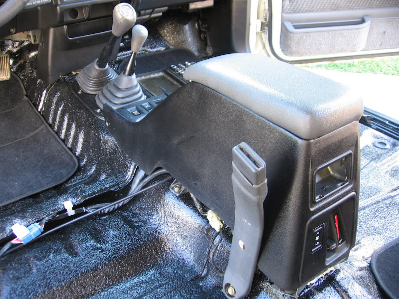

Got some more work done on the truck. I painted a lot of the interior parts flat black and they look awesome. I used a total of 5 cans of Krylon Fusion paint and some of the parts need a few more coats.

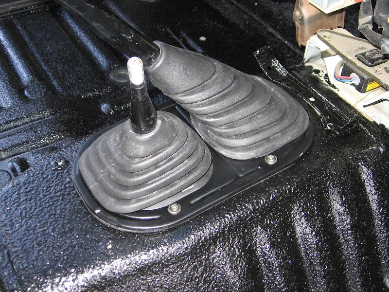

(Shifter boots all cleaned and shifter bracket painted and installed, I just need some custom shifter handles and it will be set.)
(lower steering column cover)
(Glove box, radio surround painted and installed.)
(This pic captures the color the best, also shows how bad I either need to clean the pedals or get new ones.)
(I will be getting a black dash rug to cover the top dash.)
( I am going to install a CD player and 3 52mm Autometer gauges in a custom bracket in the radio bezel hole.)

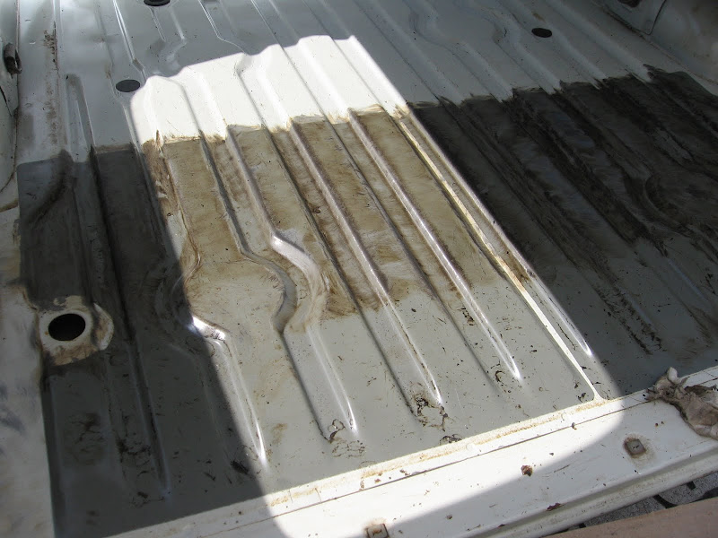

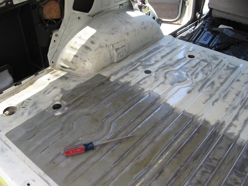

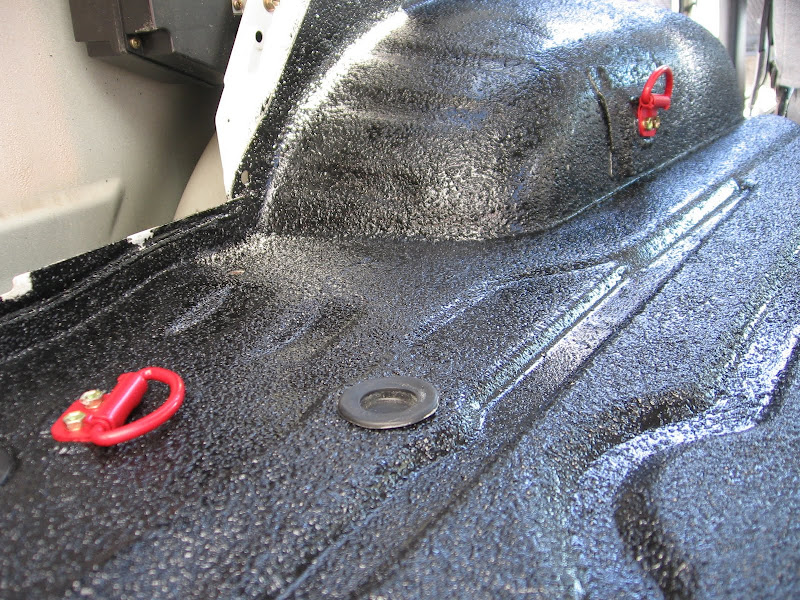

    I was able to get a little more prep work done on the rear area of the truck yesterday morning.
    I also ordered a power steering pump rebuild kit and hope to tackle the rebuild this week.
    Here are a few pics
    (Still have a lot of sanding, grinding and wiping to do on the nasty area where the sound deadening tar was laid in the rear hatch. Also put up divider to keep the wire wheel from slinging crap into the finished front area, worked pretty well.)
    (Also I will not be tapping off any of the drain holes before applying the Herculiner in the rear area, I will only be tapping off holes that have threads, the rubber plugs will still seat just fine with the Herculiner applied all the way to the edge of the drain holes.)
    (One last pic showing the area wire wheeled.)

    That is one reason, however the main reason being is that it never lays 100% flat on any vehicle, there is always little nooks and crannies that can trap moisture and cause rust problems.
    I remember helping a buddy remove his sound deadening material in his civic and the entire floor board area had massive rust problems under the material due to moisture being trapped. I plan to wheel my truck a lot and any way to lesson the chances of rust is worth the extra effort.
    Also it is heavy as HELL, in total I removed over 50lbs of sound deadening materialthe Herculiner does a great job in reducing road noise and weights a lot less than the sound deadening junk, atleast 40lbs lighter
    In the summer the sound deadening material will get hot and pliable and even gooey at times, in areas like the foot wells the material will cause the Herculiner to move and split and also get everywhere, just think of road tar. If you want a complete Herc job that will last for years and years to come spend the extra time and remove the sound deadening.

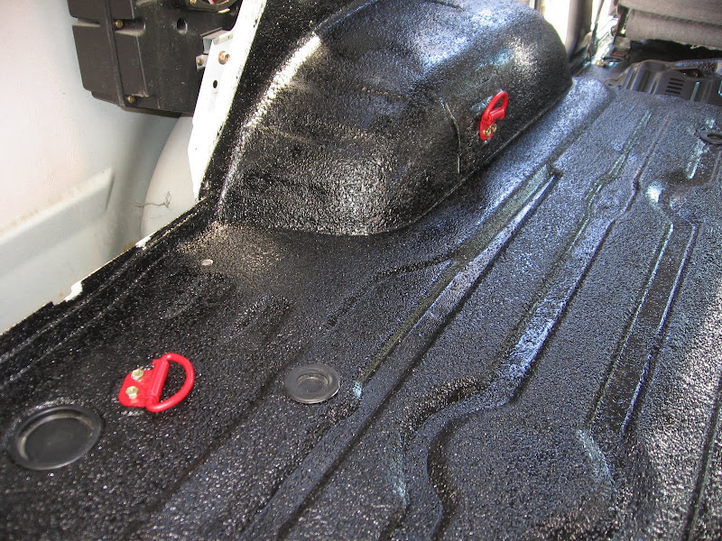

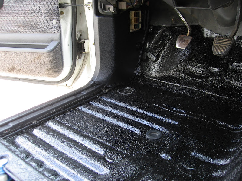

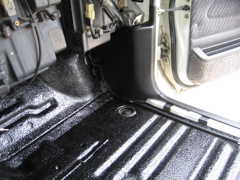

    I got a lot of work done on the truck today, and was able to finish up the Herculiner and it feels great to be done with it. It took me two weeks to get it done but I am super happy with the out come. It will look amazing when I get all of the interior parts painted and reinstalled.
    Here are the pics of todays work.
    (finally got the rear hatch area prepped and ready for the Herc, my hands and arms feel like hell.)
    (Removed the tail gate and protected the non Herc areas.)
    (First coat down and drying.)
    (Second coat down and drying I AM DONE!!!)

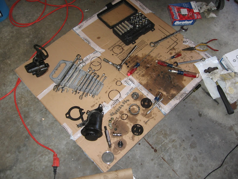

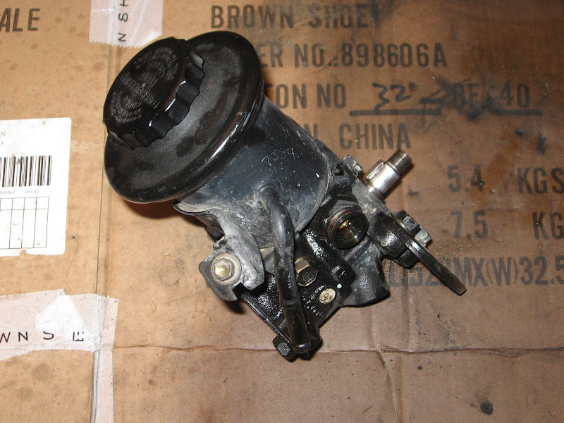

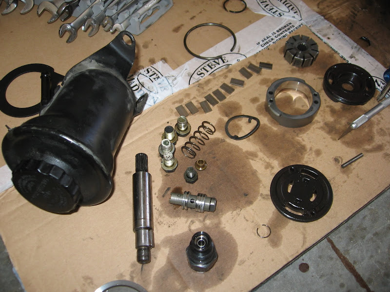

    (While the Herc dried, I decided to tackle my leaky power steering pump. I read Bugs thread about the rebuild and decided to give it a try. Well it was a huge PITA to get the pulley bolt loose. I used two thick shop towels under the belt, but the pulley still slipped. I then used a pair of chanel locks on the back of the pulley and rested the handle against the battery tray. I could not get enough muscle on the bolt so I ended up using a wrench on the end of my socket handle as a breaker bar. After lots of bad words, it finally broke loose.)
    (MOFOer is out! Now its time to tear it apart and rebuild it, I was able to get the pump all broke down and and the new orings and seals installed before calling it a night. Tomrrow I will put the pump all back together and reinstall it. Also prep and paint some more interior stuff.)
    Till tomorrow.

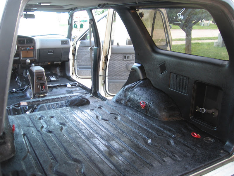

    Today was another productive day on the rig and I got the rear area almost done.
    Onto the pics.
    (Power sterring pump rebuild, man I need a work bench.)
    (Snap rings are the most PITA things ever made, somewhere some Japanese eng is laughing his ass off )

    Okay onto the Hercu
    ( I had the tie down loops powder coated red, they look awesome and give the rear area some nice contrast.)
    (Side yard AKA the paint shop)
    (Center console painted and installed.)
    (rear side panels black and installed.)
    Last one It turned out great and I am very happy with how it looks.
