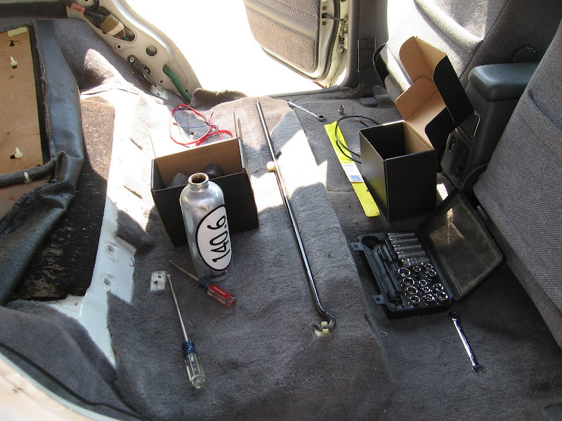

(rear side panels off)
(Found some wires under the rear seat, just a few of the many I find later)
(Rear seats out and starting to pull up the carpet in the rear.)
(PULLLLLLLLL)

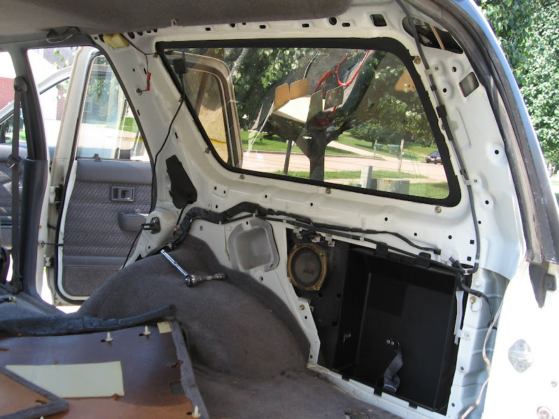

(Rear carpets out, it seems that the sound deadning crap got a little hot and melted a bit, its nasty like tar!)
(Long shot to show the carpet removed and the HUGE IDIOT holes that are cut into the tail gate for speakers, gonna have to figure something out to fix that.)

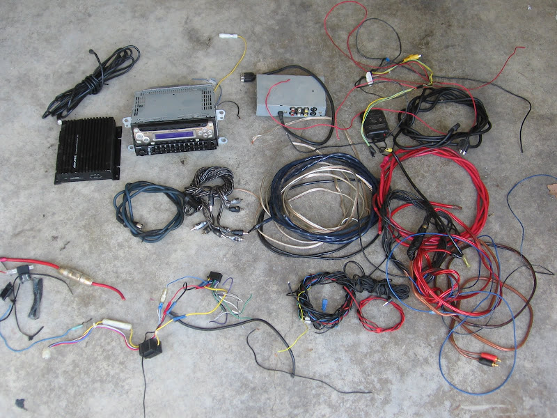

(Head Unit & Equalizer out!)
(ALPINE Amp from behind the ash tray out.)
(Audio Video Conversion something that was mounted under the drivers seat OUT)
(some cut wires leading to who knows that I found tucked behind the glove box.) At this point I have cut nothing just finding wires everywhere!
(some more wires and splicers and connectors and relays from behind the glove box.)
(Plugs to who the hell knows....LOL)
(This is how he spliced in the rear speakers )

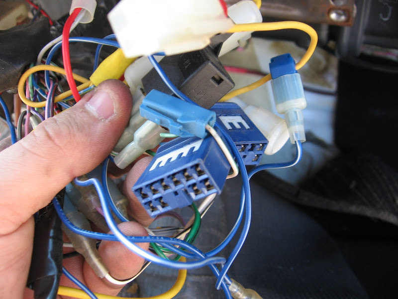

Pulled the lower drivers side kick panel to find a HUGE bundle of wires
(does anyone know if the yellow and red bundle of wires are stock?)

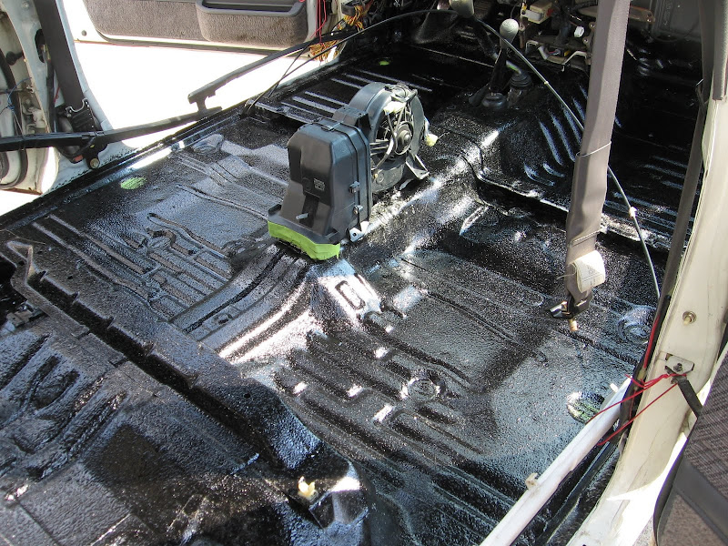

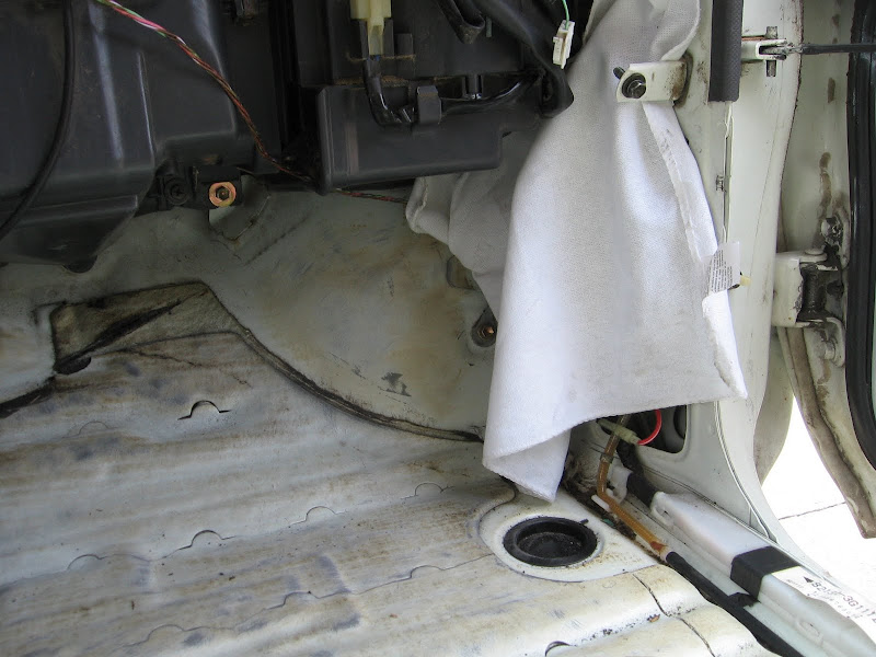

Well I got some more work done on the rig today. All the interior parts are out and I have been prepping for the herculiner. I have a lot of work cut out for me but I want this done right the first time and I want it to look as good as it possibly can. Here are some pics.
(tool box and wire wheel ready to get to work.)
(Sound Deadening stuff is NASTY in this area it is not hard like it should be but a super sticky gooey mess, no idea why?) Using a pudy knife for the majority of the gooey stuff and the rest that is hard I will use dry ice. Works WONDERS, used to use it all the time when building race cars and gutting all interior parts. Will post some pics of the dry ice in action.
(got the sound deadening cut and removed from the tranny tube starting to look better.)
(better shot of the tranny tube and prepped surface.)
(rear seat area prep work)
(passenger side almost done still needs a little more work, this is about 2 hours of prep time for the passenger seat area.)

I am not to worried about the stero wires, what worries me the most is the alarm system that is plugged in. I have never installed or removed a alarm system before so I am nervous to start trying to remove it.
I think I have figured out that the yellow and red bundle of wires behind the driver side kick panel is for the towing/trailer lights, but not 100% sure. Still trying to figure out the Alarm system

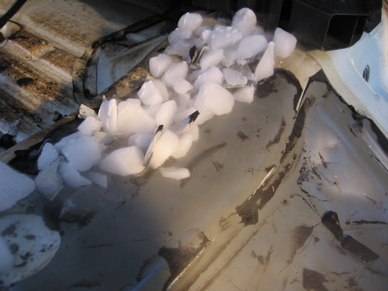

So I went to the grocery store after work and picked up 8lbs of dry ice and got to work
(ECU protected from any flying crap)
(Shifter area hole stuffed with rags and ready to beat the crap out of this sound deadening junk)
(The Dry ice doing its thang, make sure to break up the dry ice into small pieces allowing it to cover more area, let it sit for at least 2-3 min, then move the dry ice to the next area and hit the sound deadening material a couple of times with a hammer to get it to separate from the metal floor. Then you can use a flat head screw driver and a hammer to chisel under the material and it will break away from the metal floor.)
(over time the dry ice will get a shell of frozen moisture around it so make sure to give the dry ice a hit with your hammer to break off the shell.)
(Almost done with the passenger side of the truck. You can see one large piece of material left under the glove box area. I didn't have enought dry ice to keep in contact with that piece of material due to the angle of the floor board. Will pick up some more dry ice today after work and get that last piece out. Also the metal seams on the floor tend to cause the material to not come up easy, you can see this right in front of the screw driver.)

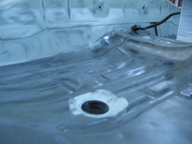

Yesterday I was able to get the majority of the truck prepped and ready for the Herculiner, here are some picks of the prep work. It took me forever!
(Wire wheeled every inch, then used a shop vac to suck up all the paint dust and then she got a acetone bath to remove any last dust and residue.)

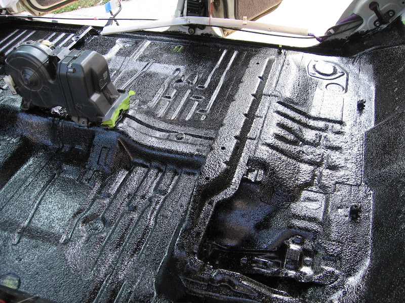

From the rear seats forward is complete and it turned out awesome. I am very impressed with the Herculiner. I do feel that prep is the most important, also its very important to make sure the Herculiner is mixed really good. I bought a mixer that uses a drill and it did a great job.
Onto the pics:
(Tapped and ready for the Herc)
(Rear Seat area)
(First coat)
(I did a total of three coats nice and thick it looks amazing)
