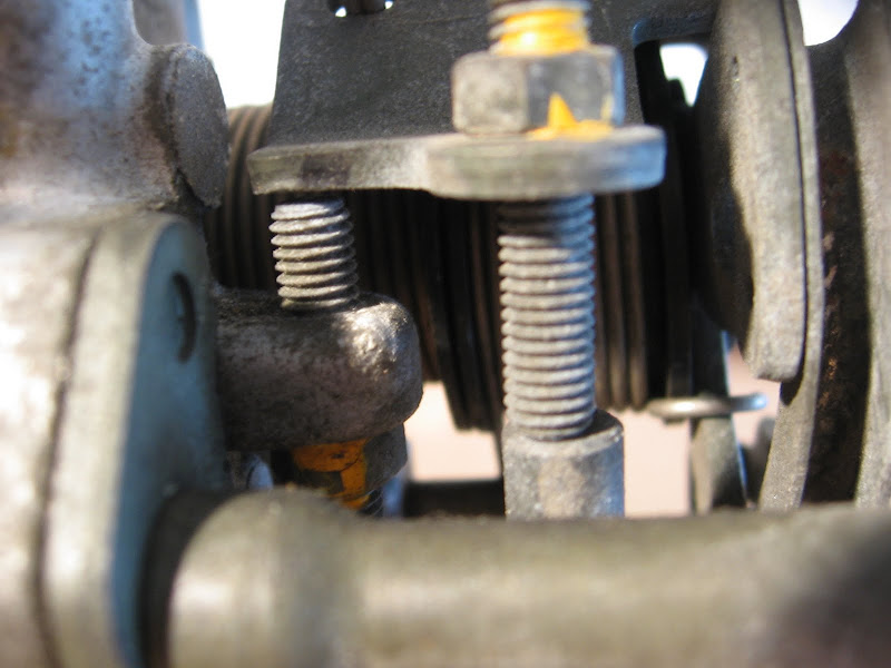

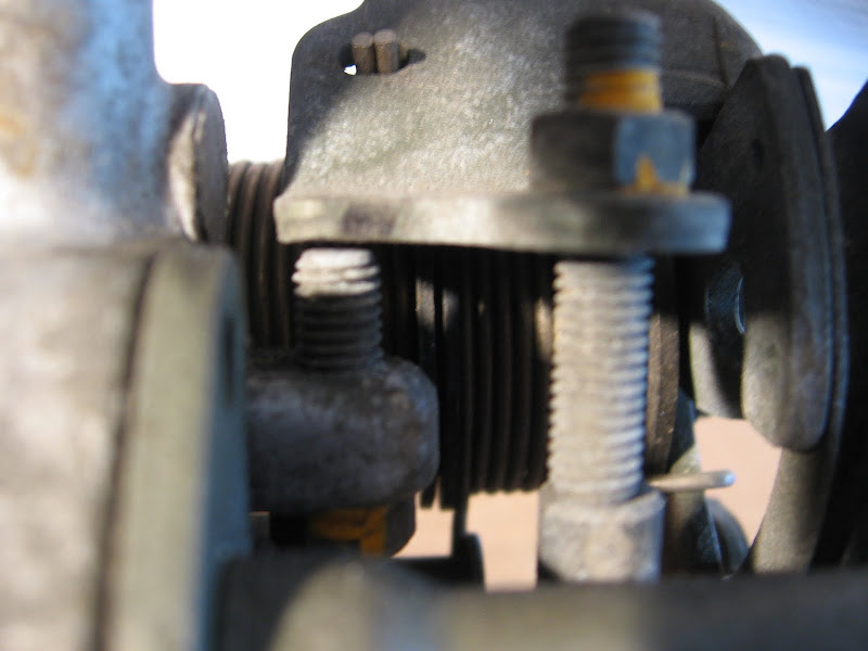

Also here are some pictures of how the set screws are setup. I have not adjust any of these.

looking at the FSM I wanted to start from the beginning on page EG2-241 Step number 2 it says
2. CHECK THROTTLE VALVE
(a) Apply vacuum to the throttle opener.
(6) Check that there is no clearance between the throttle
stop screw and throttle lever when the throttle valve
is fully closed.
However I am finding that there is a gap between the throttle stop screw and the plate that it is supposed to touch.
(you can see the gap here, do I need to adjust the throttle stop screw so there is ZERO gap.
So does this mean the base setting for the TPS is off? Could this be throwing all of the other readings off?

The gap will definitely throw readings off. What it looks like to me is the throttle opener is still engaging the linkage.......meaning, if you have vacuum applied to the opener, it does not look likes it's responding to vacuum and therefore the stop screw is not being allowed to rest on the stop. Manually move the opener piston away from the linkage. Then, see if the stop screw comes to rest.
What it means by deflect is that the meter simply changes reading from what was previously reading. Sometimes it's necessary to adjust or find a different point at which the TPS idle contact will register due to variances in manufacturing or just plain wear on the unit. So, a slightly thicker guage is used in this case. The same end can be achieved, however, by simply starting the engine, and with the sensor loose enough to pivot, simply turn it until the IDL contact will register noted by a drop in RPM. This is the point at which the ECU is reading the throttle plate's idle position.
