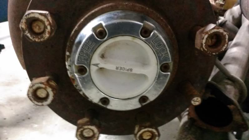

getting the D60 torn down. Gears look good, pinion bearing shot, lockouts were a rusty mess, but they came apart.

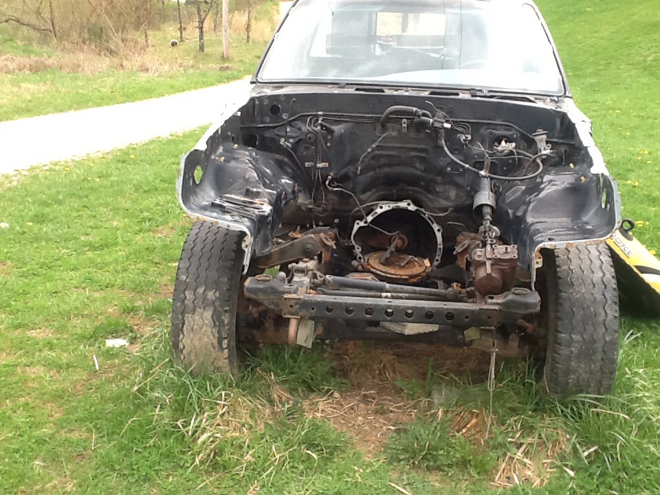

Also, picked up another piece to the 1TONTOY puzzle.
I figure project 1TONTOY had a good ring, and hopefull license plates later this year.

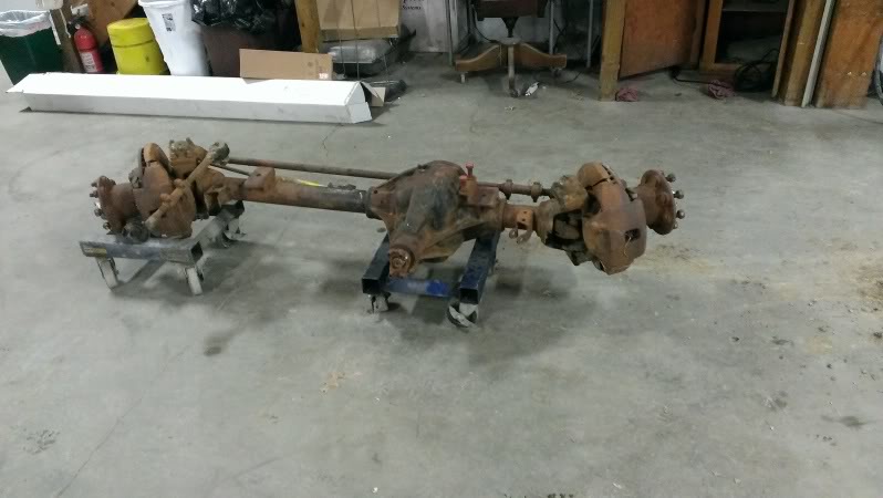

14 bolt dropped in the shop, Dana 60 stripped.
It looks to be in decent shape. The gears look good, pinion bearings are loose, but carrier side bearings are good. The passenger side king pin has been apart, and looks to be newer. Drivers side, not so much. The bushing was broken, and it was kinda crusty in there.
