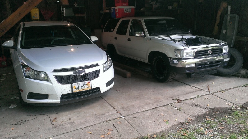

Decided to go a different route today.
http://lincoln.craigslist.org/pts/4542282056.html
Clean inside and out, no rust, frame has been coated.
Already been stripped of its guts.
Converete to SAS and rear leaf already.
Brake master and proportioning valve plumbed in.
~50k on body and frame.
Came with Dana 60 and 14 bolt swap parts.
I think I did guuuuud.

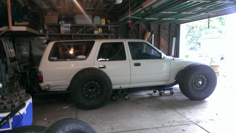

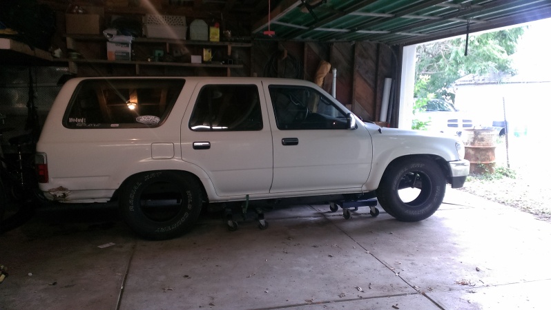

Got it all situated in the garage yesterday on stands, and set the wheels at the width they will be 67.5". I think it looks pretty good. Going to be quite a bit higher, but I'm happy with the width.

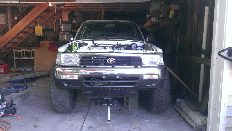

Started removing the old brackets from the leaf swap.

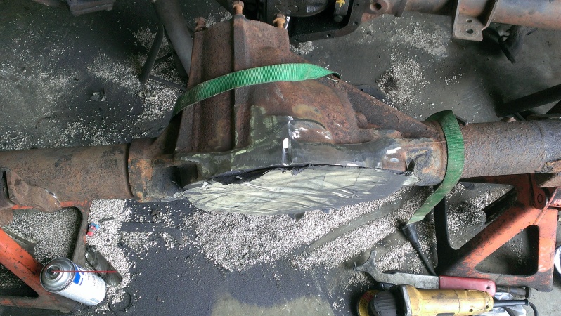

Worked on the 14 bolt last week a little bit, cleaning off the old mounts and perched. What a bitch that was.

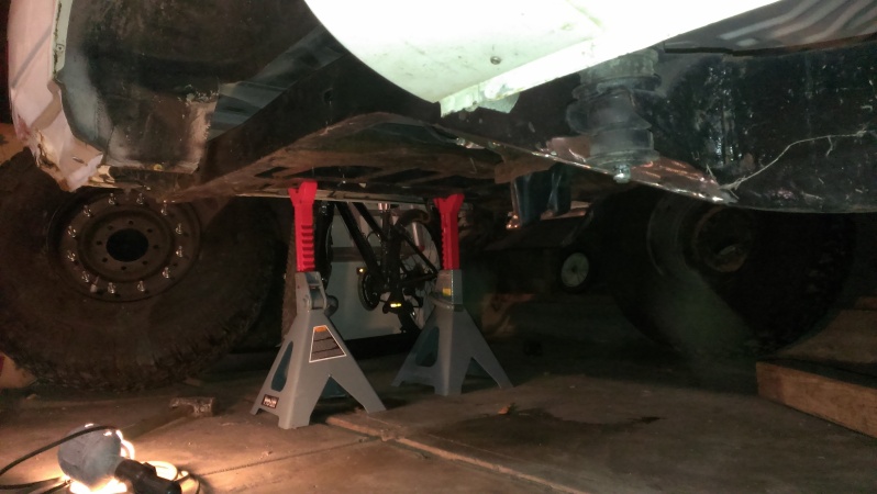

Rear mounts all removed, cleaned up and ready for a 14 bolt.
Also got the skys front hanger removed, still need to do some clean up grinding.

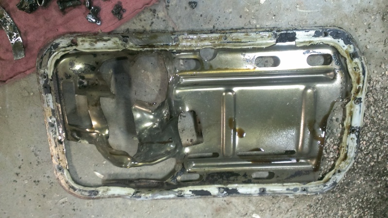

Turned the focus back to the red one for a while, hoping to get it back together and either on the road, or down the road to someone else.
Tore apart the original engine to find this:
Two broken rods, and all kinds of other stuff.

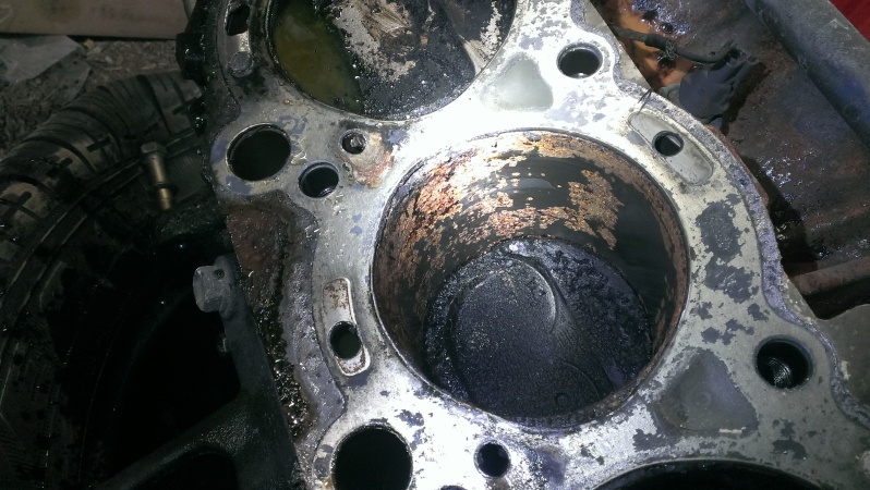

Also tore into the engine I bought to replace it with, and found this:
blown headgaskets, coolant left in cylinders, rust to the point of pitting the walls. Did not clean up with a hone. Now I have two boat anchors.
