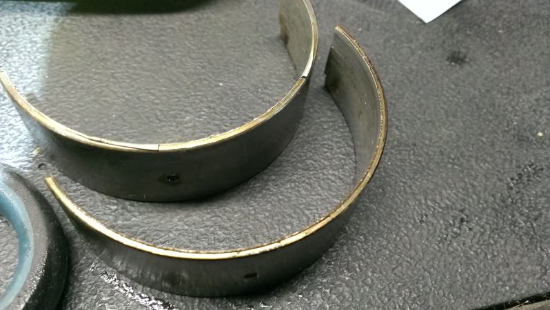

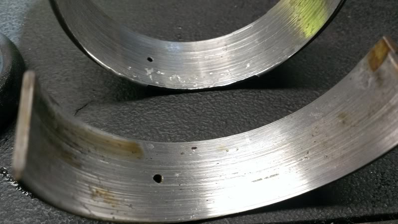

Picked this up about a month ago, it was a trade in at the Chevrolet dealership I'm a technician at. Clean interior and exterior, but it had a pretty wicked rod knock.
only one of the six were still in spec, after 144k.

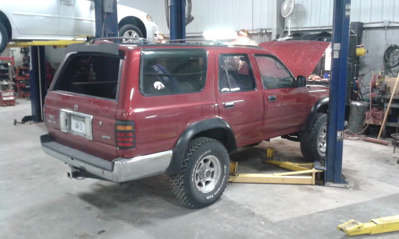

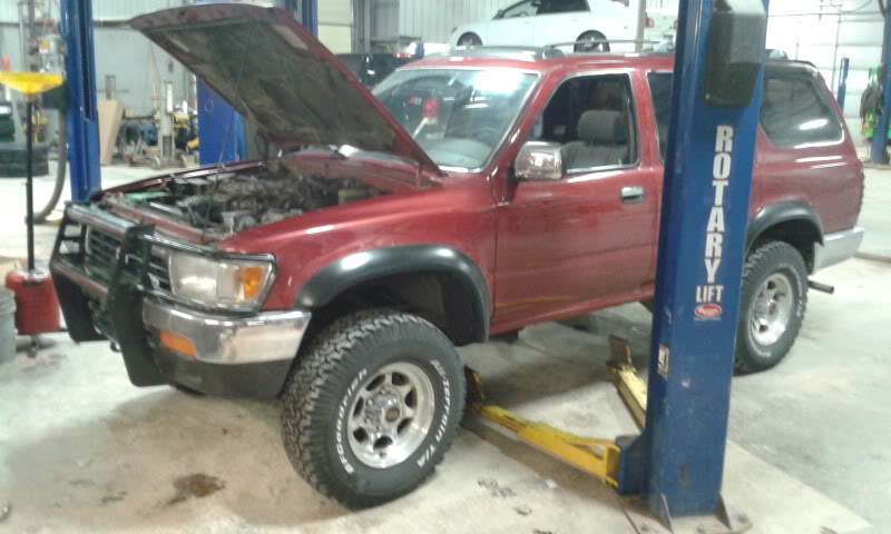

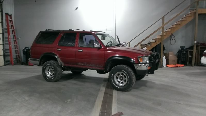

front spacers in, bars cranked up, stock rear
after pics:

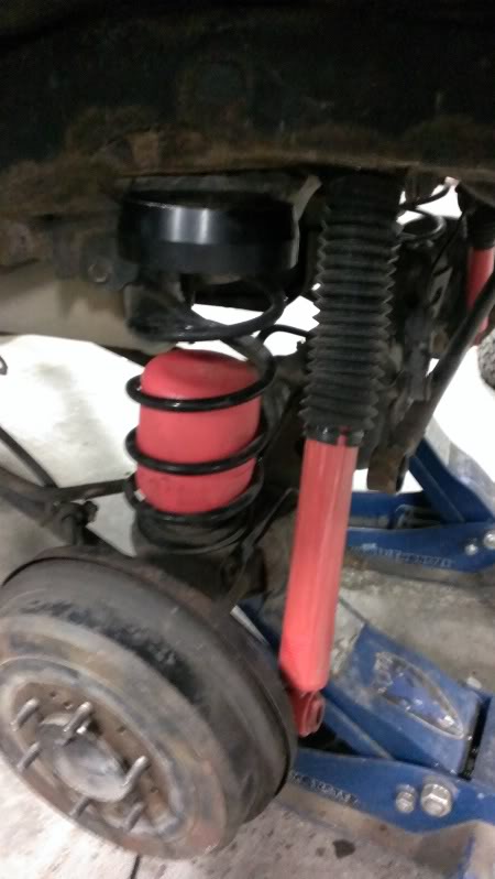

2 1/2" rear spacers, 3" ball joint spacers, diff drop, Airlift rear bags.
Planning on swapping in a 5.3, 4L60E, and NP241 in about a year, along with a SAS.
I bought it mainly for hunting and fishing, and some wheeling. Should make for a good winter vehicle.

Sounds like time for a rebuild or a swap. Did u put new bearings in after the pics of the old ones or what? And were you ablet to pull the pan with engine in?By the way welcome to yotatech.
Old May 5, 2013 | 05:26 PM
Jthod's Avatar
Joined: May 2013
Posts: 77
From: Auburn, NE
thanks. Yeah, that is the old bearing. I pulled the front diff and pan and did the bearings in the vehicle.

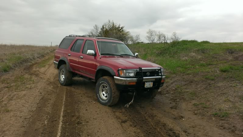

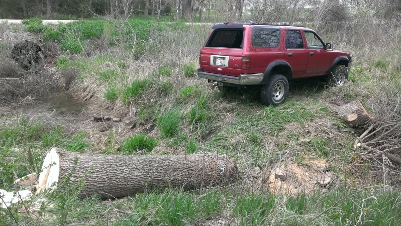

Had some fun with it today:
it's hard to see how big this log is, but it's 9'+ long and this big around:
got the deer blind moved
Old May 5, 2013 | 05:41 PM
kornhuskerwizard's Avatar
Joined: Dec 2008
Posts: 2,391
From: tecumseh nebraska
so did it pull it out?
nope
