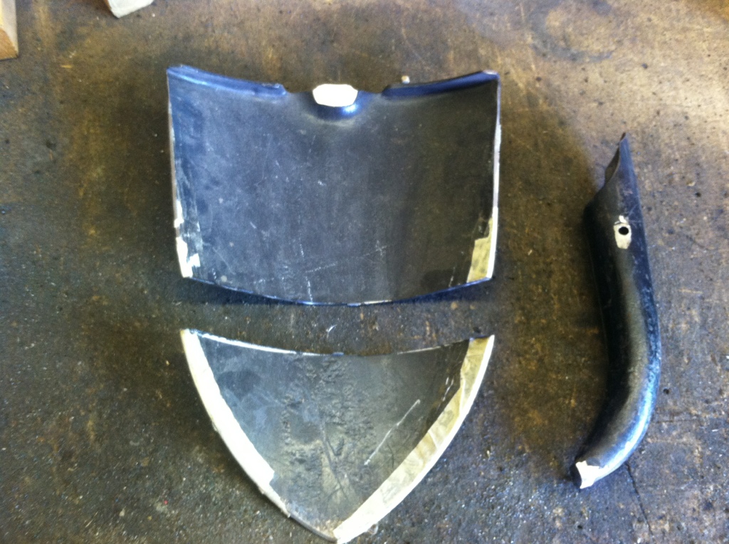

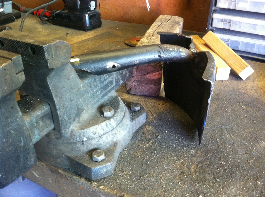

Well, not a vehicle update, exactly, but I'm gonna consider it related since it has to do with welding practice. And it's my build thread, I can do what I want, right?
In case anyone was wondering how we make custom fire tools(yeah, right. probably as interesting as watching grass grow), I have a tutorial for a "Reinhart" which was first done by a guy named Reinhart, I'm pretty sure.
First, take a shovel, remove handle, and cut it apart like so
Contort yourself in any way possible to hold the 2 pieces together sort of like this until you can at least tack it in place

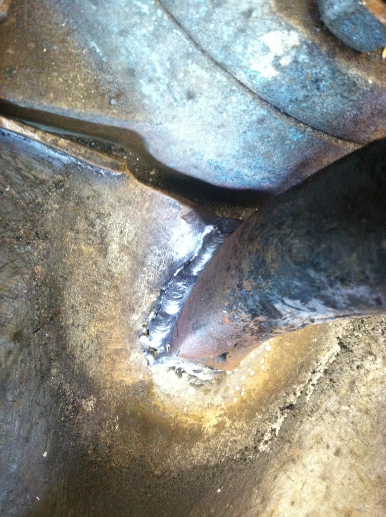

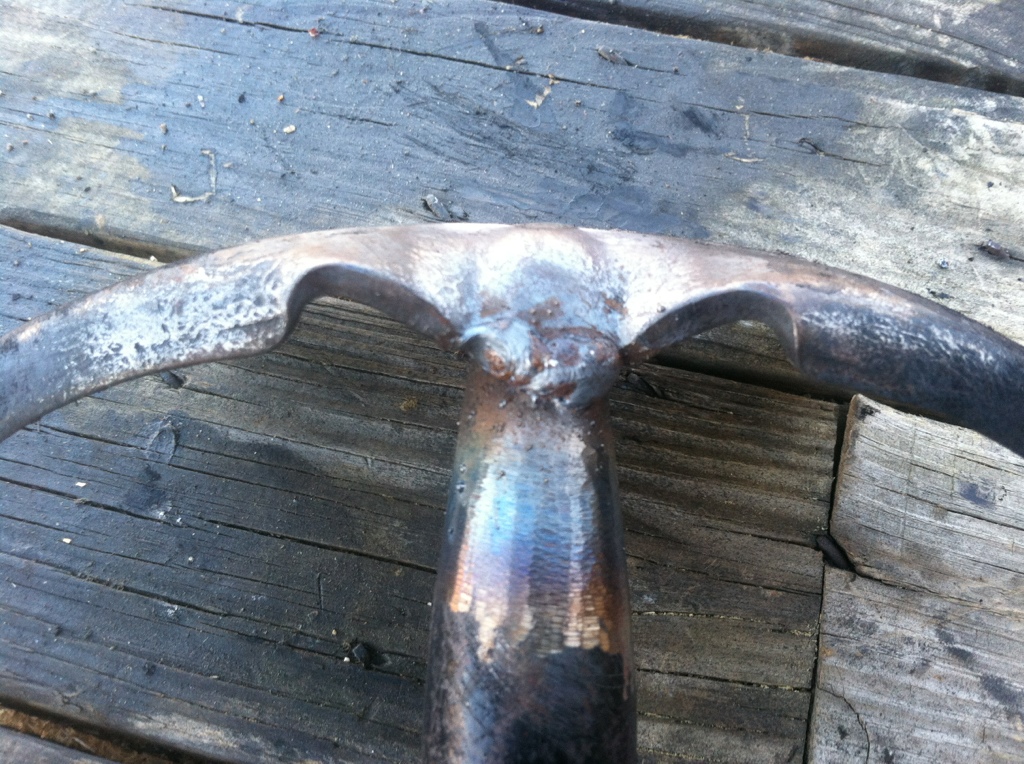

One of my better welds

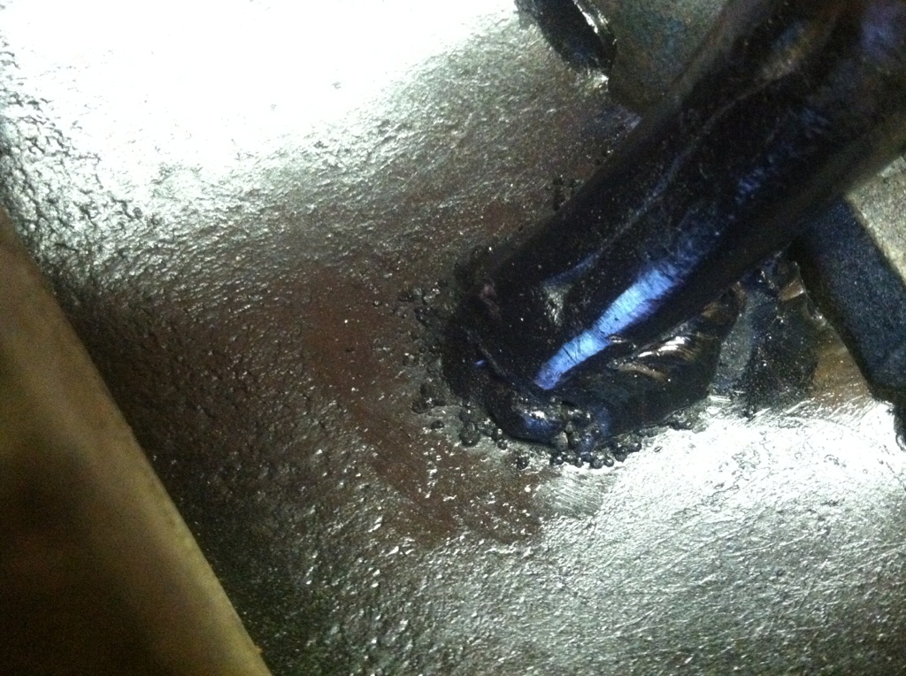

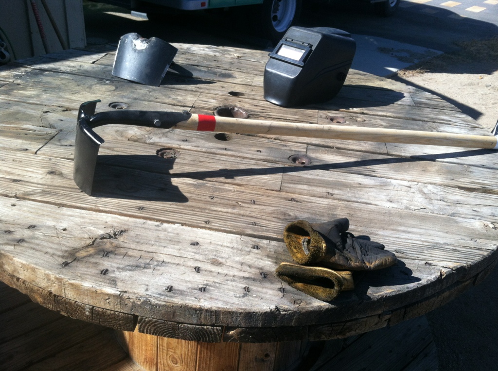

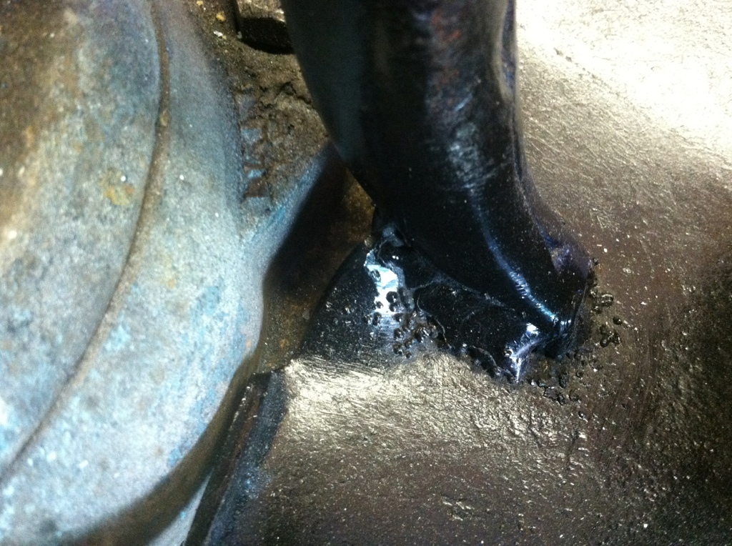

Then you paint it to hide the welds and fasten it to a new handle
Congratulations, you've made a really stout garden hoe

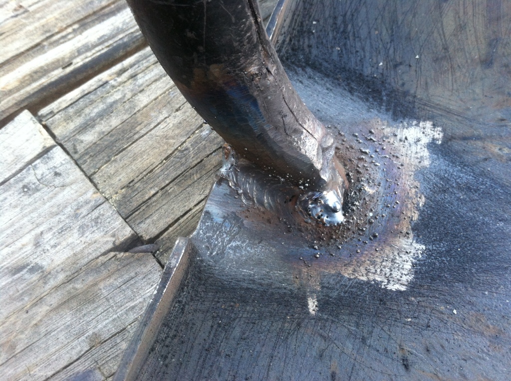

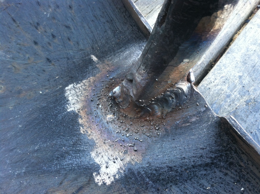

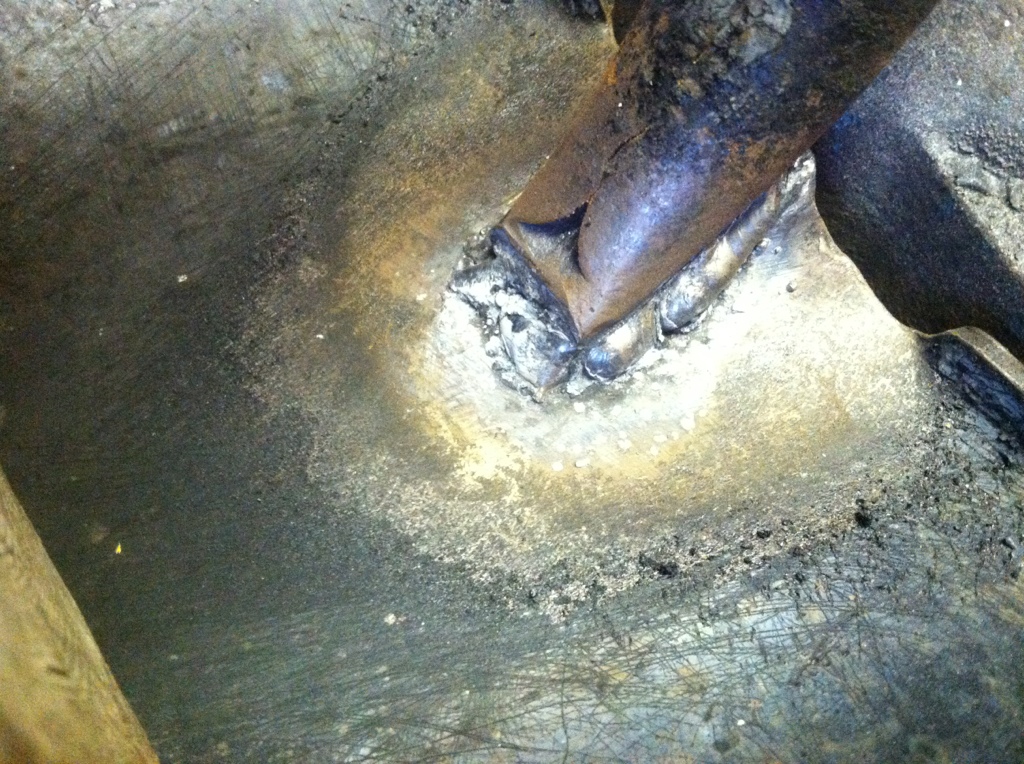

One of the first of this batch that I made, a few weeks ago with the flux core wire

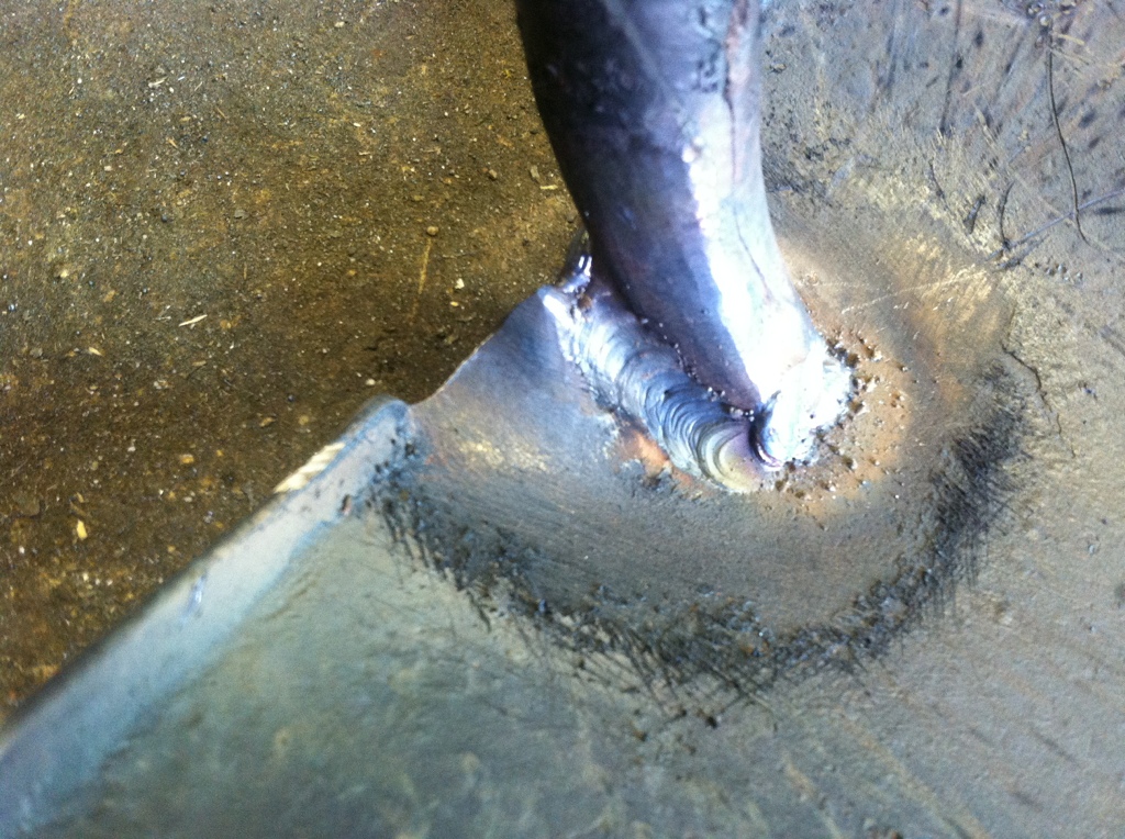

Pretty sure this one was with regular wire and gas. Don't remember the exact settings, but they obviously weren't optimal

I feel like I'm getting a little more used to gas now, don't think I'll be messing with flux core anymore. This one
was done with the settings at
.030 wire
Argon/CO2 mix
wire speed a little under 60
voltage all the way up(4)
All while practicing Chef's safety tips and rocking out to metal on Pandora

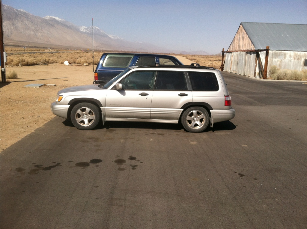

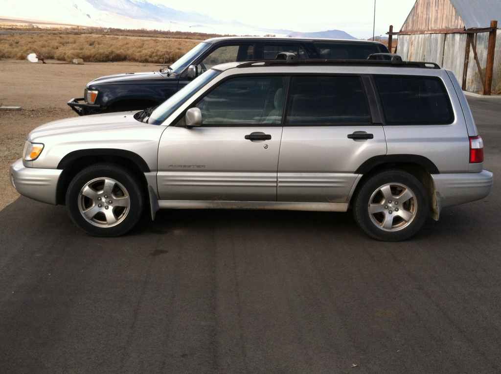

Well, I told Chef in his thread to keep an eye on mine for suspension work this weekend, but he'll probably be let down that it wasn't on the Runner. Got my Forester a little lower!
Before
And after
I'm a little disappointed it sits so butt-low since these were supposed to be WRX wagon springs and they're to supposed to sag as much in the rear, but spacers aren't too expensive and not too difficult to install. Next will be 20" spinners and rubber band tires!

Wow man I don't know if thats work or home, but WOW. Makes me miss the mountains, living on the plains is so drap and dreary compared to that scenery!
I'd look into an adjustable air suspension w/ onboard air compressor for that ride. My guess is it might see some dirt roads once in awhile. I don't mind the look of a low rider so much as my knees to linke climbing in or out of them anymore
Looks pretty good. Can't tell where the low profile tires will set in the wheel wells, I'd prefer them tucked in a bit. We had an olds with the wheel well panel/covers it's just such a nice look.
