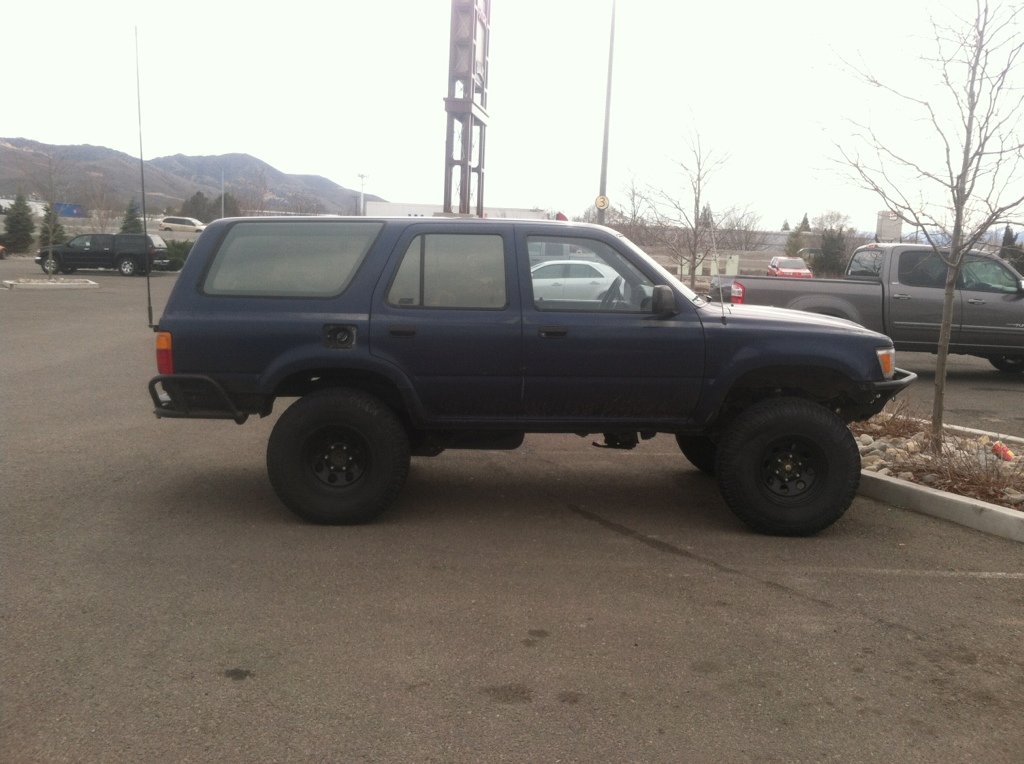

I think what I'm going to do is get a 1" spacer kit for the rear, I don't mind it being a little higher in the rear and then just level if I throw some camping gear in above and beyond my normal emergency gear. Also, I'm not actually gonna do big wheels and low pro tires, I like the stock wheels, might just paint them cause the clear coat is coming off in some places. Sticking with the same size, also, considering that it definitely will see dirt, so the extra sidewall isn't a bad thing to me.

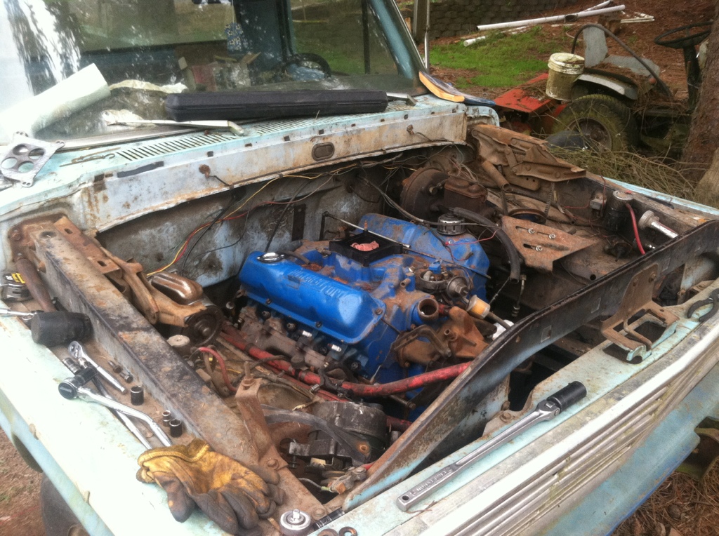

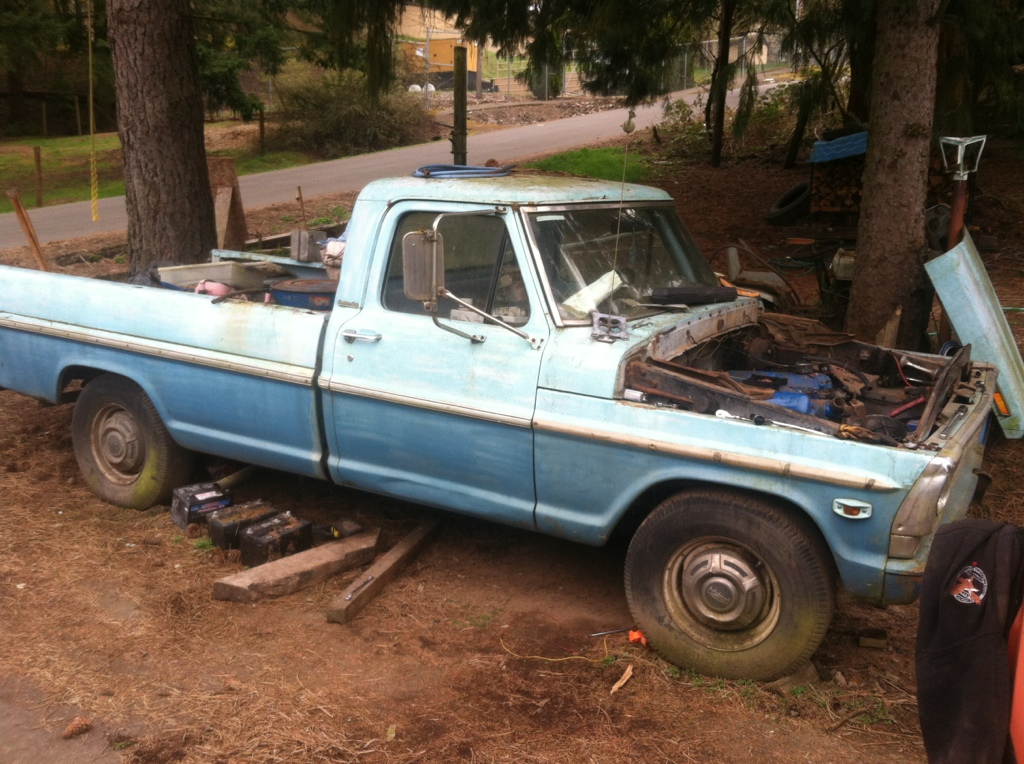

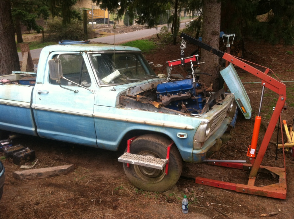

Well, no more progress on the Runner, got it up here to Portland area to get the bi-annual DEQ check done, and while "vacationing" I've been working on my(one day, anyhow) tow rig!
It's got a 390 I rebuilt about 6 years ago that's never been fired up, just covered(though not very well while I was gone) and setting in the engine bay. Years ago when I was first installing this engine I didn't get the torque converter seated all the way and broke the bell housing trying to get the engine and trans together. Gave up on the truck for far too long, and finally assessed the damage. Still has 5 of the 6 bolts holding the engine to the trans, so it should be good to go.
The 390 should be just a little under 400 hp and in the ballpark of 500 ft/lbs of torque, shift kit in the C6 auto, and 4.10 gears in the stock D60. Should do for a tow rig, right?

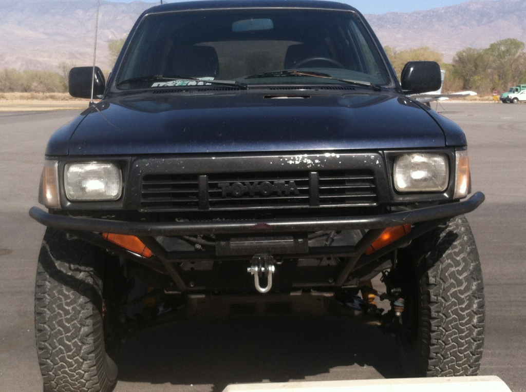

Also, I apparently need to rough up my chrome a little better before I paint it. This is from the ice that built up when I was going through snow over Willamette pass, probably
A good trip, now to work towards the sas!
