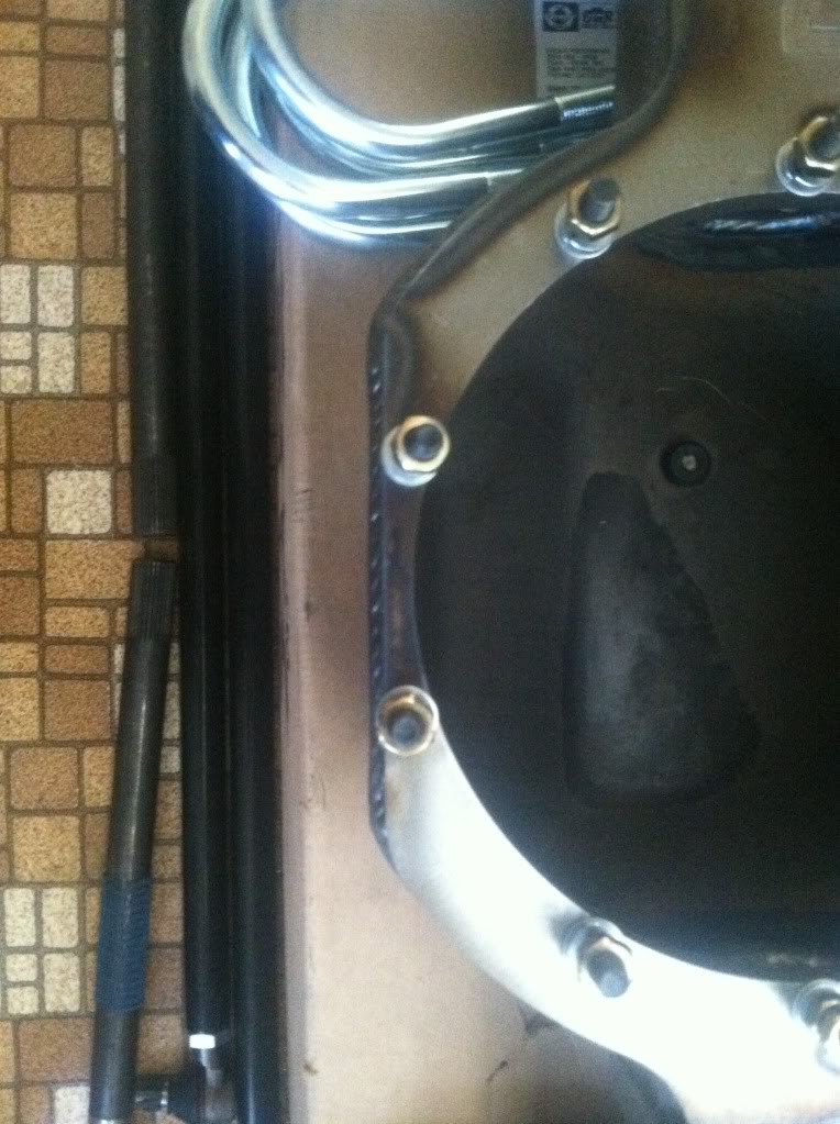

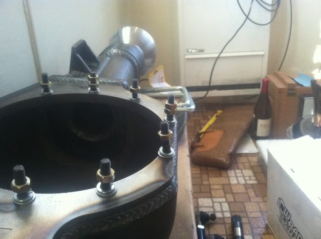

It looked like a quality product til I started scrutinizing a little more...
It comes with their stud eliminator kit, minus the bottom 2 cause of how they made it flat and low profile and all. There's no drain plug, so they provide 2 nuts for each of the bottom studs, presumably to use them as the drains. Well, no way in hell is that stud gonna come out once the diff is installed, so I put in a call to LowRange to see if I need to deal with them about it or TG, since it was drop shipped directly from them. Also told them I scored an elocker and would like to switch to an elocker housing, if possible. Dan said shouldn't be a problem as they're the same price. Looking at the thickness of the diff flange, I won't have fun if I have to mod it myself.

They don't come with a drain plug?

Nope, I believe the idea is that it'll prevent getting hung up on the drain plug. Smooth bottom, to the point I'll have to grind off some of the diff so it doesn't protrude below the pumpkin.

Hmm, so how do you change fluid?
You pull the bottom studs to drain it.
Which is why the quality control on this housing is unacceptable to me. Could you imagine trying to get that thing back in after you got it out to drain? Enough ranting, I'll update when I hear back from either LowRange or TG.

They do make them that way on purpose. I'm on my third drain plug on my stock rear. Eventually, I'll be welding the plug shut, and pulling two of my stud eliminators and replacing with studs (or bolts).

wow that is disappointing about the misaligned holes but seems like they are willing to work with you, and also get you the E-locker housing almost worked out better this way.
Always had good luck with low range and would recommend them to anybody

i dont see how you cant remove the stud once diff is installed since two you said are still studs?
its not uncommon to shave the drain plug. most do it to stock housings all the time and either suck the fluid out from the fill plug or like you said remove a stud or two

I'll clarify my thoughts on this stud...
Yes, I could bend it and just pull the one stud to drain it. It could be used, but I just won't accept something like this from a $700 axle housing. If they only are willing to trade for exactly what I have, and I have to modify it for the elocker, I'm ok with that since I'm the one who ordered it prematurely. If they'll trade for an elocker housing, all the better. I'm not really pissed off, just not willing to accept this. If they won't exchange me something, I'll get my money back and buy something else. I could do long travel for the amount I'm going to pay for the whole axle assembly, and I could install that myself in a weekend with no major hiccups.
