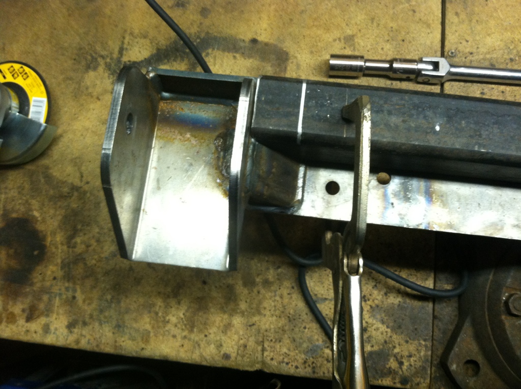

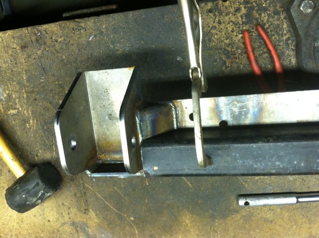

Ha, probably should be too embarrassed to post pics of this, but this is why I'm having someone else do the welding on my sas
Here was my first attempts
Cleaned up a little
Well, went to move it, slipped out of my hands and fell. The welds broke. That won't do at all. Figured it was maybe because I didn't get the metal on the hanger clean enough, so I removed all the boogers and cleaned it up with fresh metal showing, and set the welder to the correct speed as well(faster).
This is that result
Looks better, right? Not good, but I obviously got penetration and it's more even.
Nope
This is what's being left on the hanger
But it's sticking to my 3/16" piece of angle iron I'm using for the spacer just fine
Anyone who's good at welding, feel free to chime in on what I'm doing wrong here.
It's a Miller 110v wire feed with gasless flux core wire. Different wire and use CO2 instead? Is the Sky hanger some alloy and maybe my piece I cut from the angle iron is just plain steel? I'm pretty welding retarded, so spell it out in Crayon for me if you have any advice.

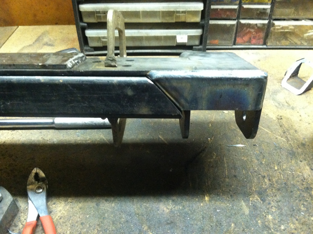

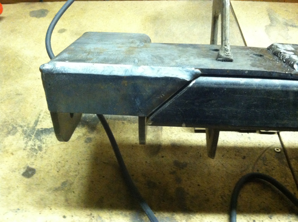

Lucky for me, we have a big chop saw at work. I'm more comfortable cutting and grinding metal anyway, I'll leave the important welding to my buddy. So here's the cuts to match the tube to the high clearance Sky hanger
And then I cut off that ridiculous chunk of metal booger welded to the top of the hanger. Who the Hell had that great idea, anyhow. Idiot.

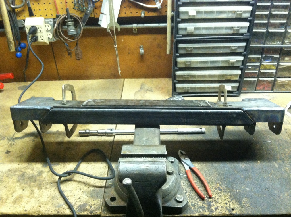

Yeah, the original plan was to use that hanger because I'm not planning to lift it as much as the normal kits, but with the crossmember compromised, it just makes sense to replace it with the hanger. It should end up stronger than stock.
Even if I don't do that, I went ahead and used the rest of that piece of square tube to make a new crossmember and practiced my welding putting caps on the ends. I'd like to say my welds are getting better, but I'm probably just getting better at hiding my crappy welds by grinding them down after. I at least have gotten the weld to not be full of pinholes, and was able to make 2 passes on the cap pieces since the square tube is 1/4" wall.
Should be all the beef I'll ever need, since I haven't wheeled to the limits of the IFS. My level of wheeling will probably change mostly because the Runner is no longer my daily driver, but it could also depend on when I can budget in a locker for the front. I still have my v6 third from the rear, so I might get a setup kit and locker to learn how to set up gears. Always keep learning!

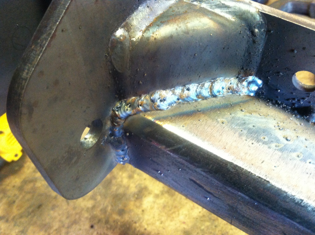

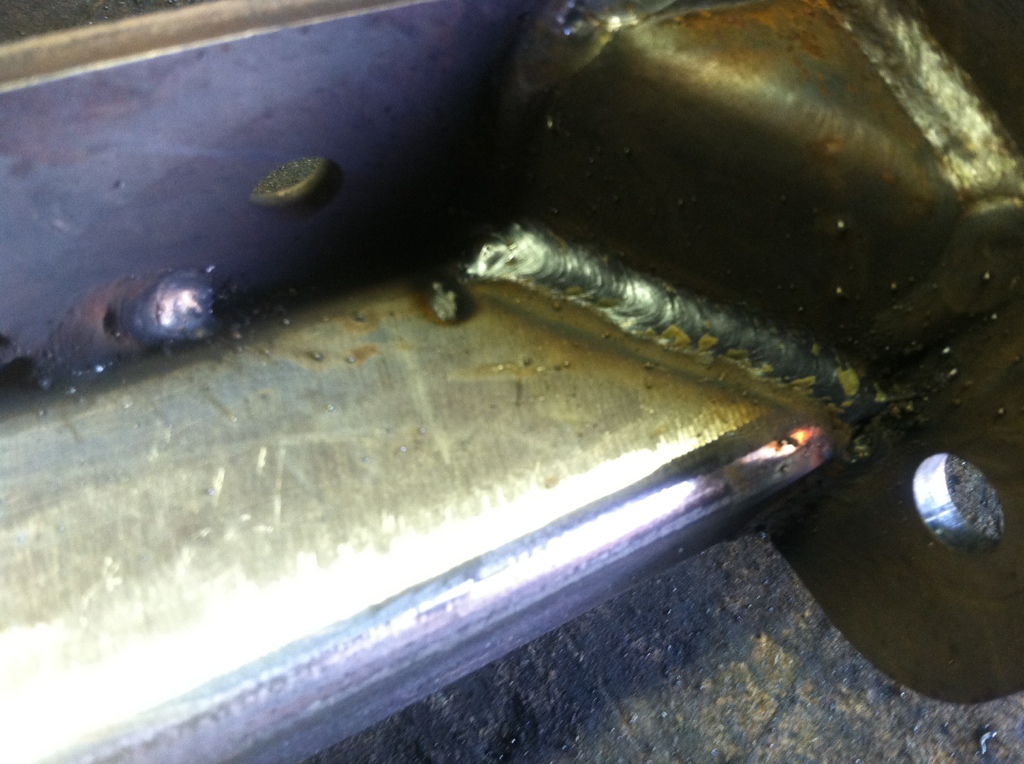

Well, talked to the fab shop in Ridgecrest. They said it's generally 8 hrs labor and worst case is about $800 for them to do it all with my parts. So I'm going to get more serious about learning proper welding.
This is my best so far completing the crossmember/hanger: Name:  5325AFBA-660E-4136-BF60-BEA91147263B-3244-0000076958846D31_zpsd9b92c54.jpg
And my worst: Name:  9A5E2026-A9E8-4ED7-8EB5-C3B6072E7065-3244-000007696177A1CA_zpsed535e59.jpg
I figure if I mess this up, after I've already tried welding that filler to the top of it and all, I'm out the cost of another hanger and I have to cut another chunk of the square tube. Small potatoes compared to $800! All you welders that have been looking at my build, let me have it on the welds. Decent? Absolute crap? Shouldn't even be trusted for new age art?
