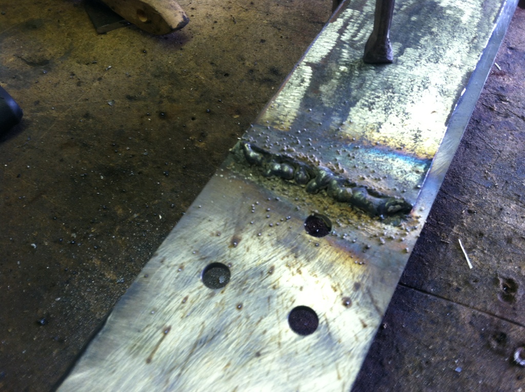

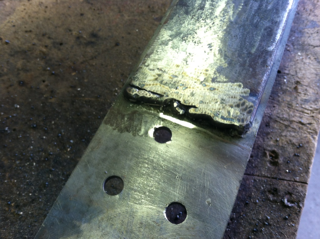

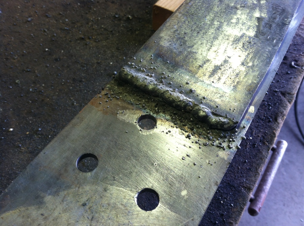

Ha, probably should be too embarrassed to post pics of this, but this is why I'm having someone else do the welding on my sas
Here was my first attempts

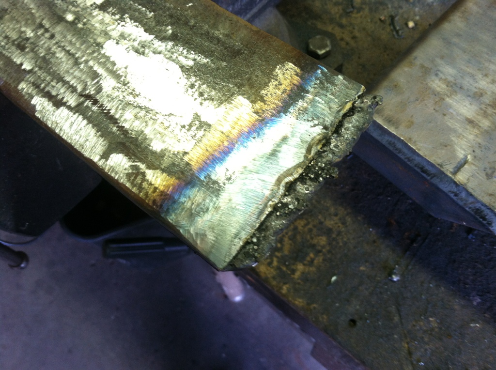

Well, went to move it, slipped out of my hands and fell. The welds broke. That won't do at all. Figured it was maybe because I didn't get the metal on the hanger clean enough, so I removed all the boogers and cleaned it up with fresh metal showing, and set the welder to the correct speed as well(faster).
This is that result
Looks better, right? Not good, but I obviously got penetration and it's more even.

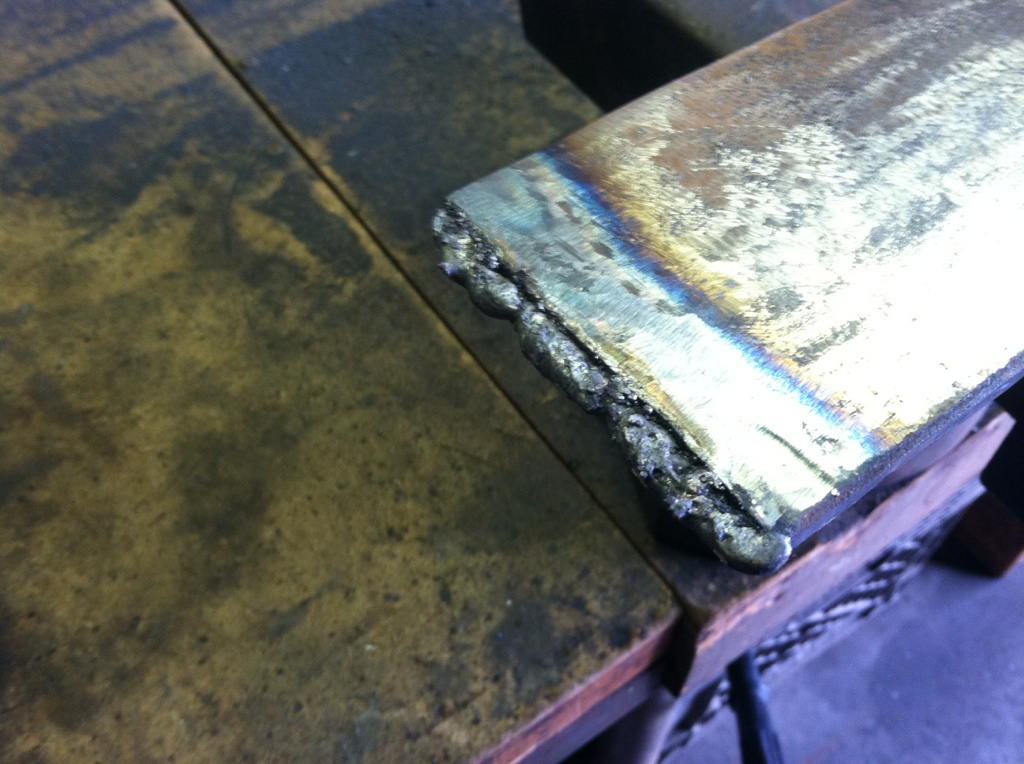

Nope
This is what's being left on the hanger

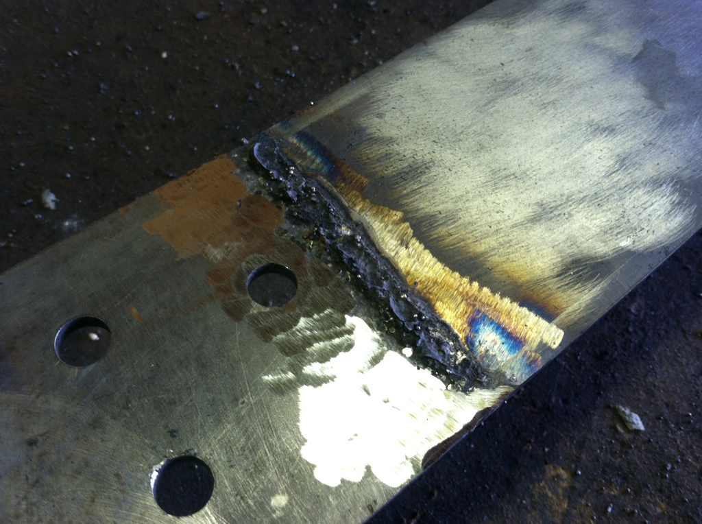

But it's sticking to my 3/16" piece of angle iron I'm using for the spacer just fine
Anyone who's good at welding, feel free to chime in on what I'm doing wrong here.
It's a Miller 110v wire feed with gasless flux core wire. Different wire and use CO2 instead? Is the Sky hanger some alloy and maybe my piece I cut from the angle iron is just plain steel? I'm pretty welding retarded, so spell it out in Crayon for me if you have any advice.

Miller 175, new ones are 180, 220V is the smallest welder you should use on structural welds. 035 solid wire with argon CO2 mix. Do not use that welder for your truck. Or if you do let me know so I can tell my wife to stay off the road.
Old Jan 24, 2013 | 03:37 PM
  #129
88_Red_Runner's Avatar
Joined: Dec 2012
Posts: 223
From: Montana
Smile
That welder is good for sheet metal work with argon CO2 and maybe 023 wire.

Alright, it's not the one being used and this isn't structural. My buddy that's doing the welding has a 220 and knows what he's doing, which I obviously don't.
We do have some .035 wire around and I have argon CO2 also. Think it'd stick?
This is just to hold this piece I cut to the top of the hanger so there's not a huge gap between the frame and the hanger. The welds along the long edge to the hanger will all be done with the 220, as well as this piece being welded to the frame crossmember.
Your wife will be safe from me, I don't trust my welds for life and death welds. My welding experience pretty much ends at making custom fire tools. If they break, we grab another one.
Haha, thanks for the compliment on the rest. Everything but welding has been within my skill set. Aside from wiring, I've had as much as possible wiring done by other people or had Crayon instructions that anybody could follow.

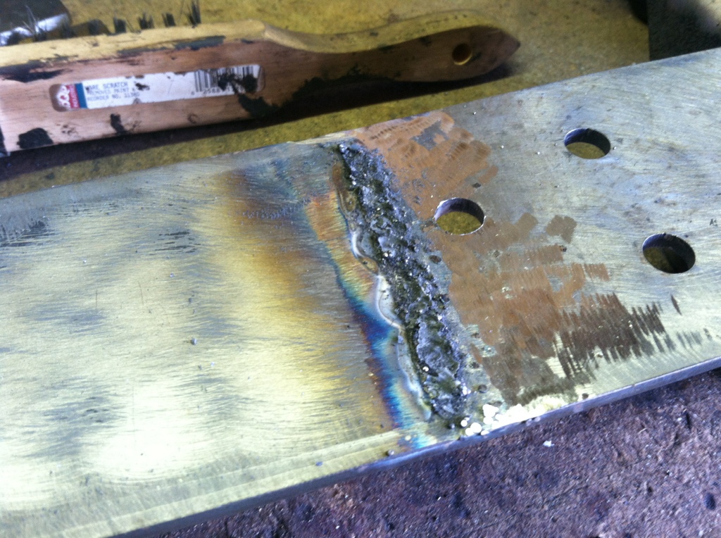

Ok, switched wire, turned on the gas, gave it a shot after watching a couple short videos. Here you can see the gap I'm trying to fill part of
Then again, after looking at it a bit, the bottom of the front crossmember looks to be frowning, so maybe I should just get some square tube to replace it since I'm now going to use it to support the car.

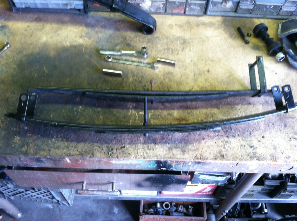

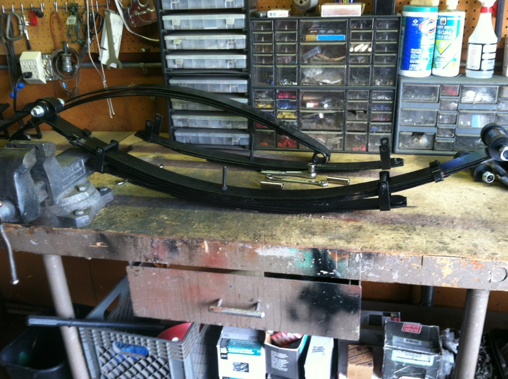

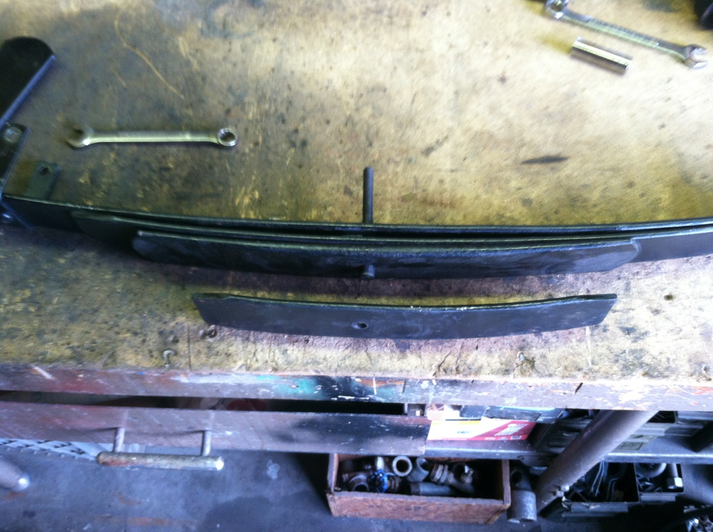

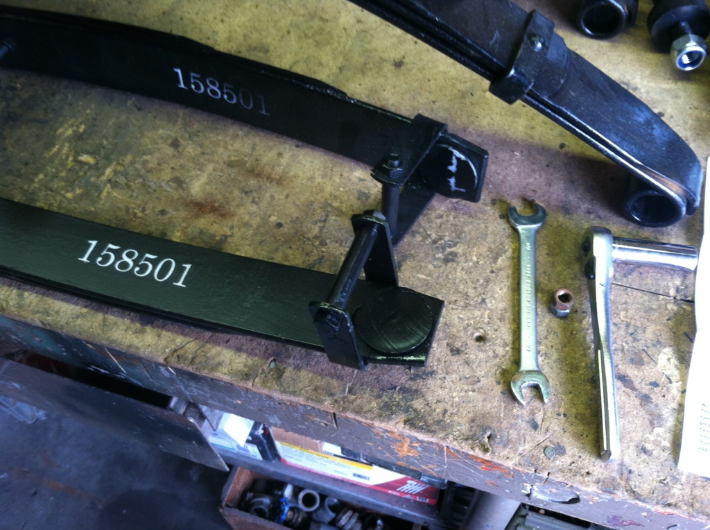

Today my Wheeler's mini packs were supposed to show up, and they did. Big Brown usually comes about 1:30 here, so I delayed lunch til they got here.
Can't say review yet, but first impressions:
Comes with the spring keepers/retainers, slip pads, new pin and nut, and normally u bolts, but I don't need them, so they omitted.
Overload springs being replaced on top, compared to mini pack

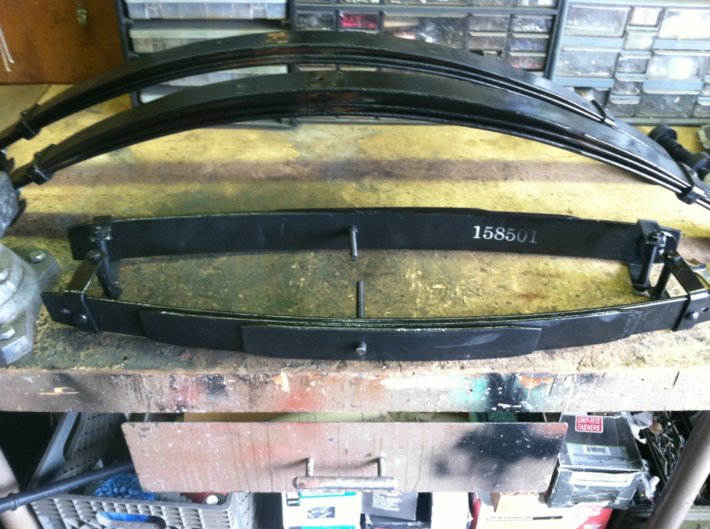

Then decided a little stiffer would be preferable to bottoming out, and with the reputation that RUF's have of being soft, I replaced the mini pack's lowest spring with the original short overload
So the assembled product
I think what I like most is that they aren't arched big time so they won't stress the original leaves where they meet, and also with less arch they hopefully won't create a ton of lift. Now it's just whether they're stiff enough, cause I don't have any other leaves around to add other than the long overload and the smallest one from the mini pack. Maybe not the long overloads, if I try to modify them for an anti-wrap spring.

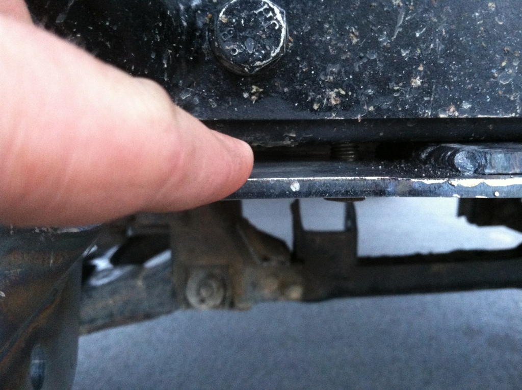

Show me some pics of the welds. Did it work well?
With that piece on top of the front spring hanger I would measure out from bolt hole to bolt hole, drill, and measure the gap, replace with the thickness of the plate steel(3/16, 1/8) can't remember. Then pass the bolts through the cross member and the plate and into frame. Then weld all of it together.
Sorry for rude remark.

It's all good, I'd say the same thing if I saw welds like that and someone saying sas at the same time. I'd also assume same as you, that that person planned to use the 110 for all of it.

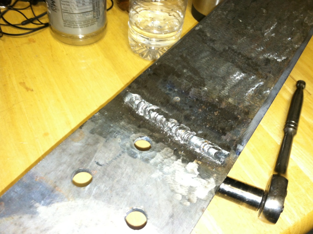

I'll get a pic real quick of the weld. It looks worse, actually, but is holding. What pressure should I set the gas at? Haven't really seen anybody talk about that and no guide for it on the settings chart inside the welder.
The reason for wanting to cut it that short and not drill through it is our drill press at work is wobbly, hard to make any sort of precise hole, and we all know it just sucks drilling a 1/2" hole through 3/16" plate with a handheld drill, even a decent corded big one. You're right about it being a good idea, though, so I guess I'll just remove this. Still thinking about replacing the crossmember. I have a couple pieces of 3/8" wall 1.5" square tubing that are just barely too short for sliders, was gonna use them anyway and use some round tubing to extend it slightly and form the step, but since I'd rather overkill the crossmember than the sliders, I'll go see how much work that'll be.

I'll show you the better of the 2 welds

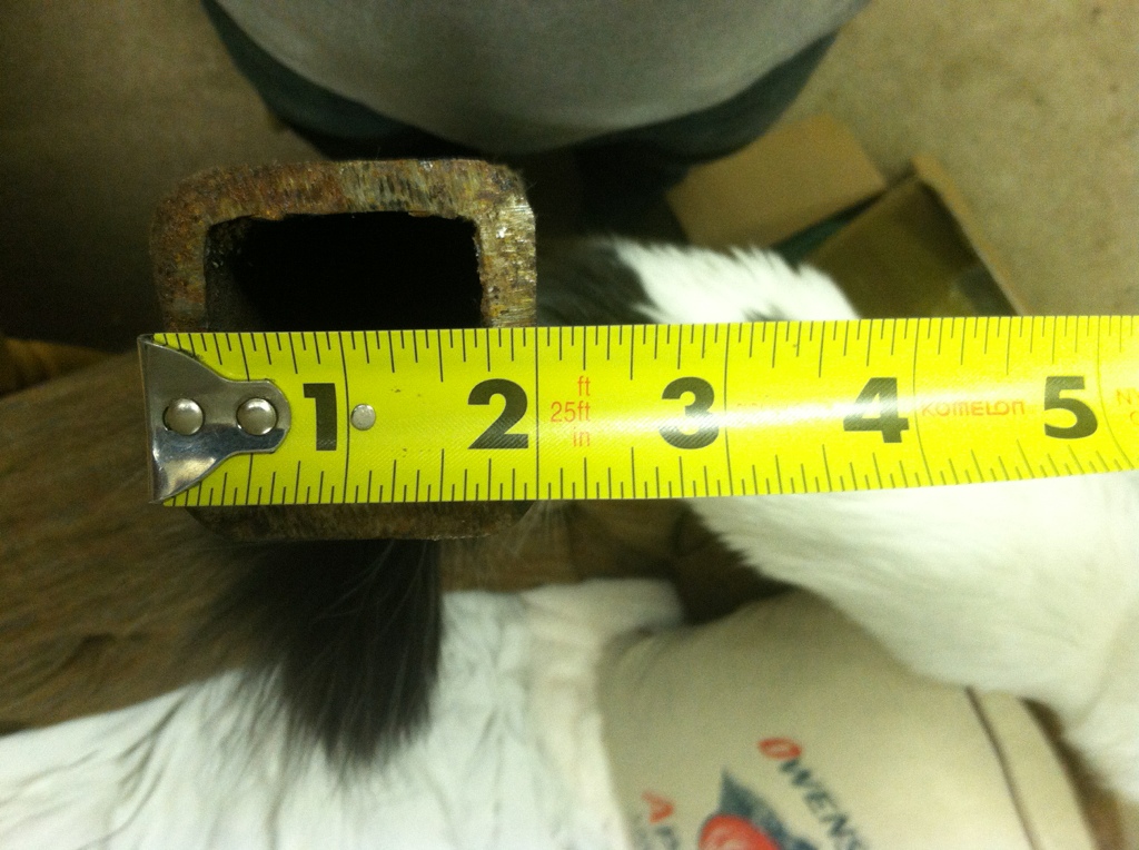

And apparently my coworkers don't know how to guess tube size...it's .250 wall 2x2, but the crossmember is 2.5x2.5, roughly, so it doesn't really help much.

15 max psi for the argon. Mig welding is kinda like using a glue gun you will get it. It took me a long time to learn how to weld good it won't happen overnight. Even now if i don't weld for awhile i allways do a test peice to set the machine. To test welds cut them in half or grind them to look for pin holes. Keep the nozel clean from spatter and use anti splatter in a spray can.
