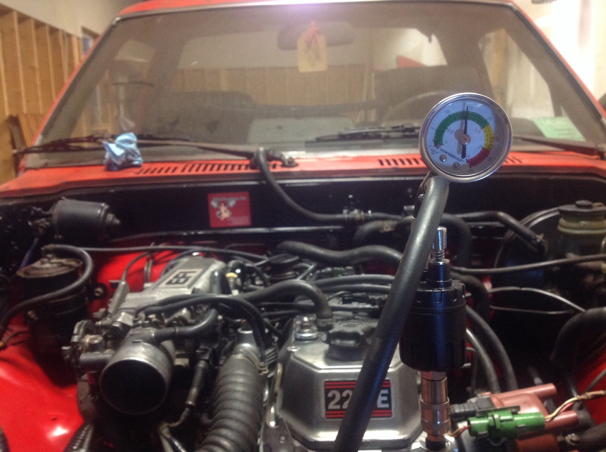

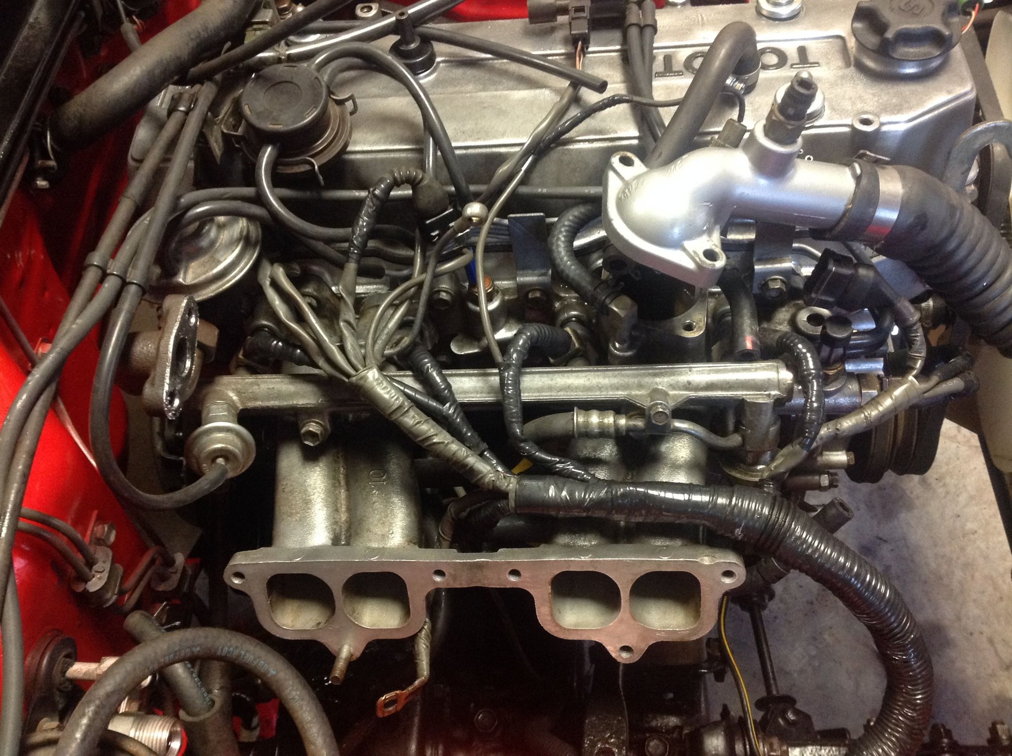

My dad was out visiting last fall, working with me on a remodel project in our house, and he bought me an air compressor. I hadn't known all these years tht I really need an air compressor. Well, that thing was awesome tonight! I ran compressed air through that thing for two hours. I took everyone's advice and blew it out, then added some oil into the chambers and turned the motor a few times by hand. Then blew everything out again. Then turned the motor and blew it out again. I got air to blow through the intake and out the chamber on all four cylinders and blew air in each chamber and out the exhaust side. I feel confident that almost all of the coolant is out- probably a little residue, but clean. I shot some WD-40 down the intake, also as you all suggested, and turned the motor a few more times.
I even had a little time to take my angle grinder with the wire wheel to the crossmember so I can get it painted before it gets reinstalled.
I'll get the upper intake bolted on (again) tomorrow and try again to get my cooling system pressurized and tested.
All in all this mistake cost me a day of work, some coolant and a $2 gasket.
I'm feeling optimistic once again!

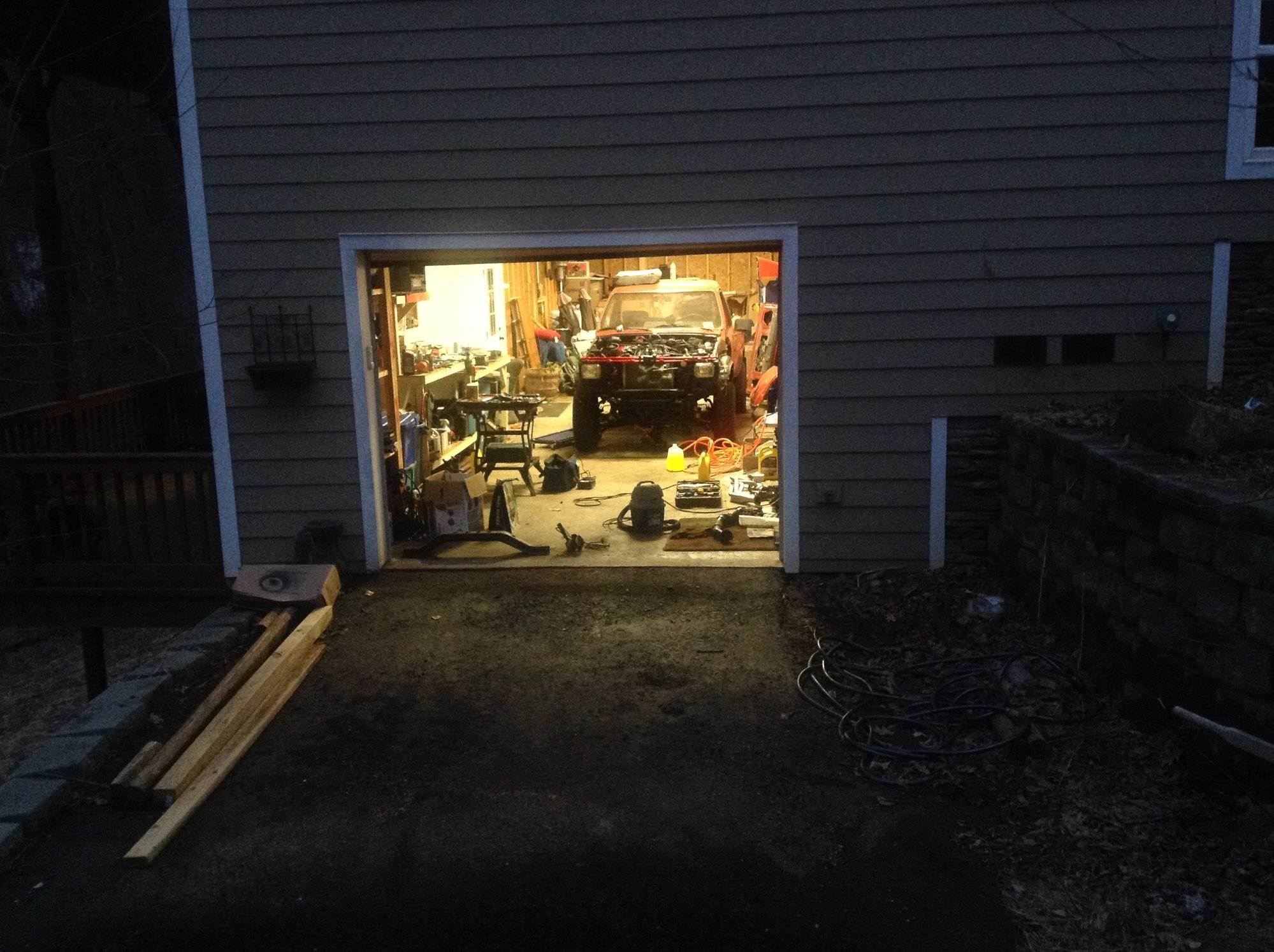

No leaks!
I checked. I checked again and then once more because I just couldn't handle another disappointment. And for over thirty minutes without losing a single pound or inch that sucker sat. Whew.
I'll watch to make sure nothing drips over night.

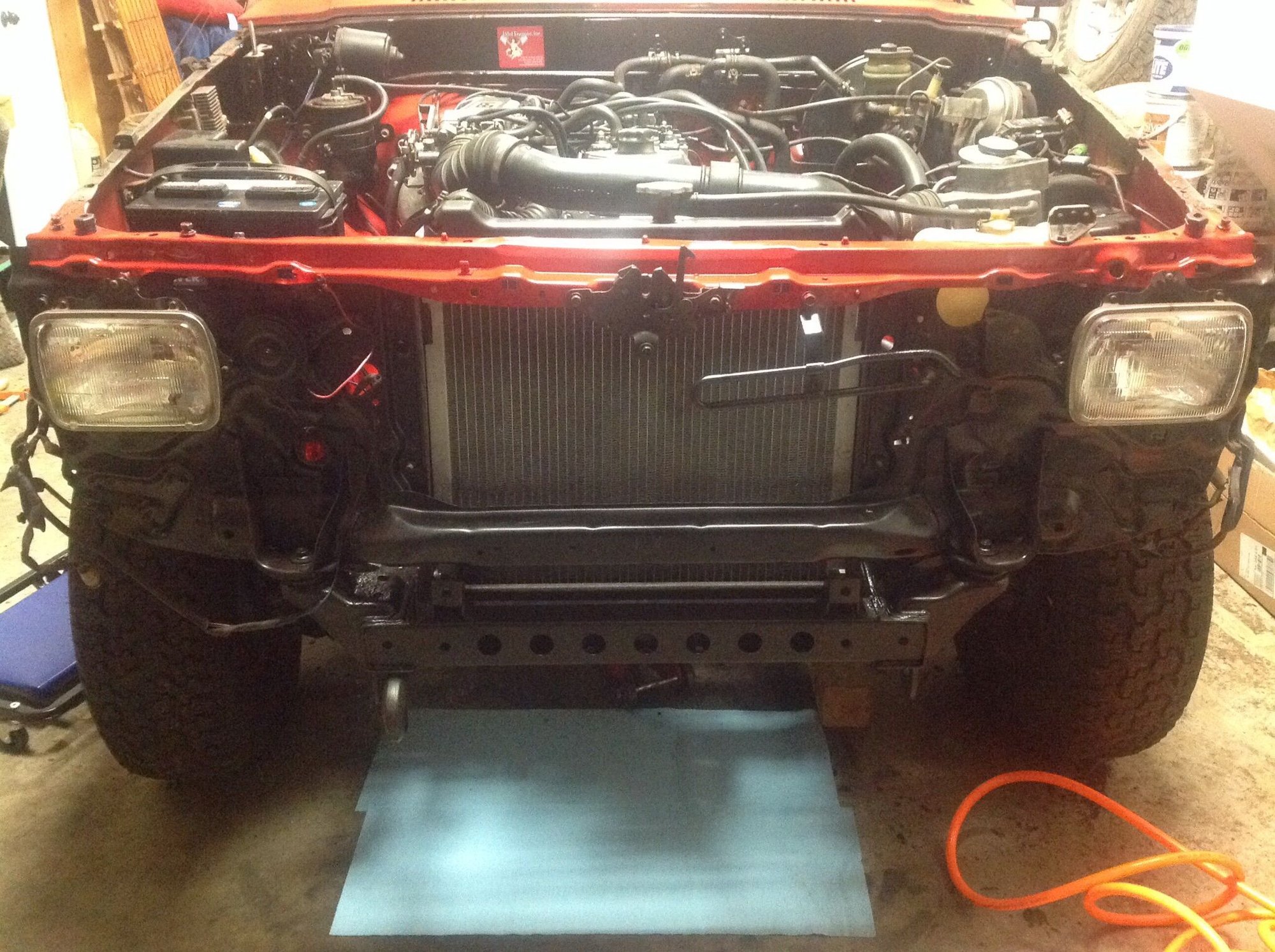

Also got this shot of the work space I'm lucky enough to get to use.
The only thing missing for y'all is the Drive By Truckers blasting out...

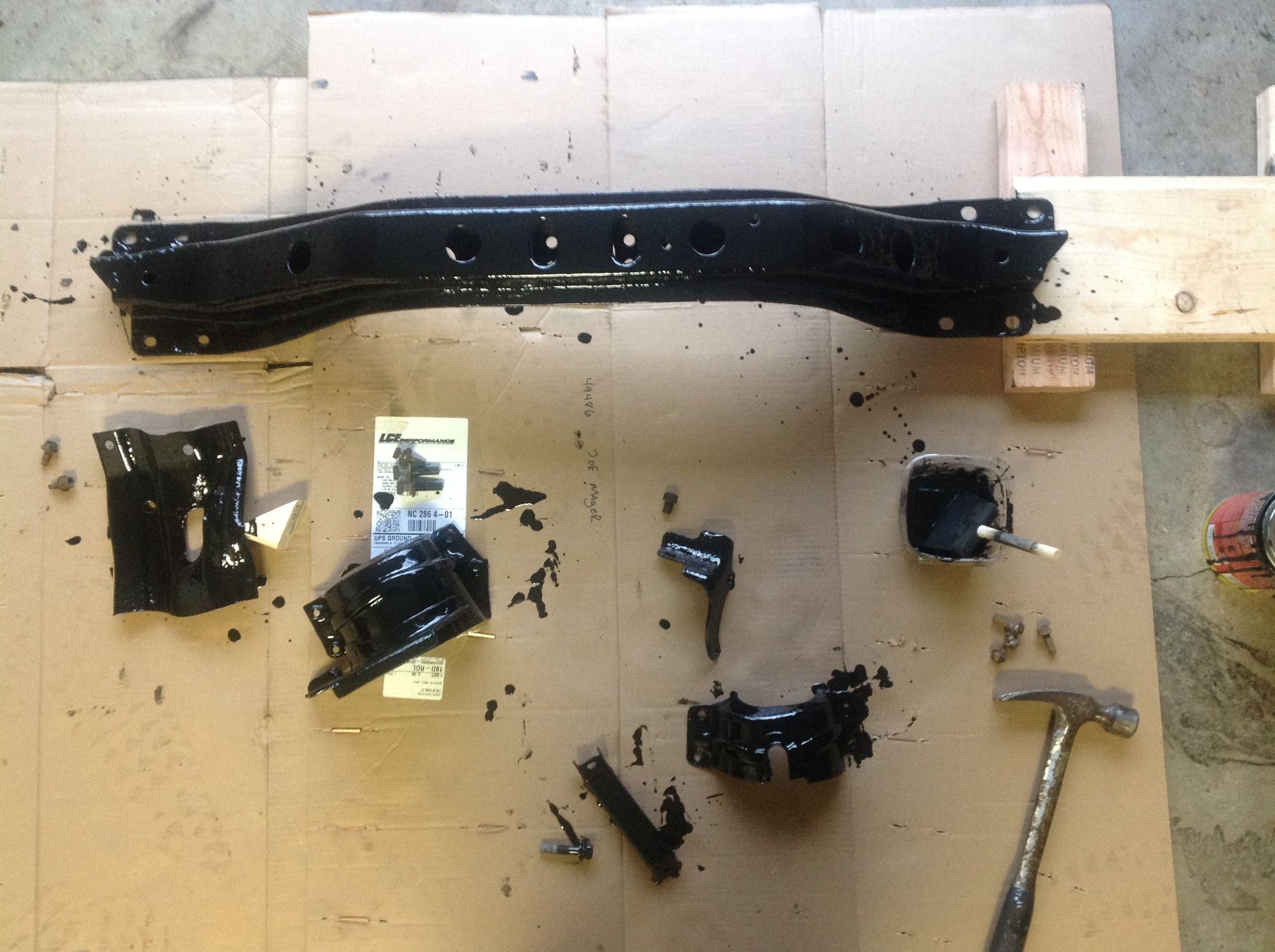

Did some painting today.
A nice coat of POR on the crossmember and some plates:

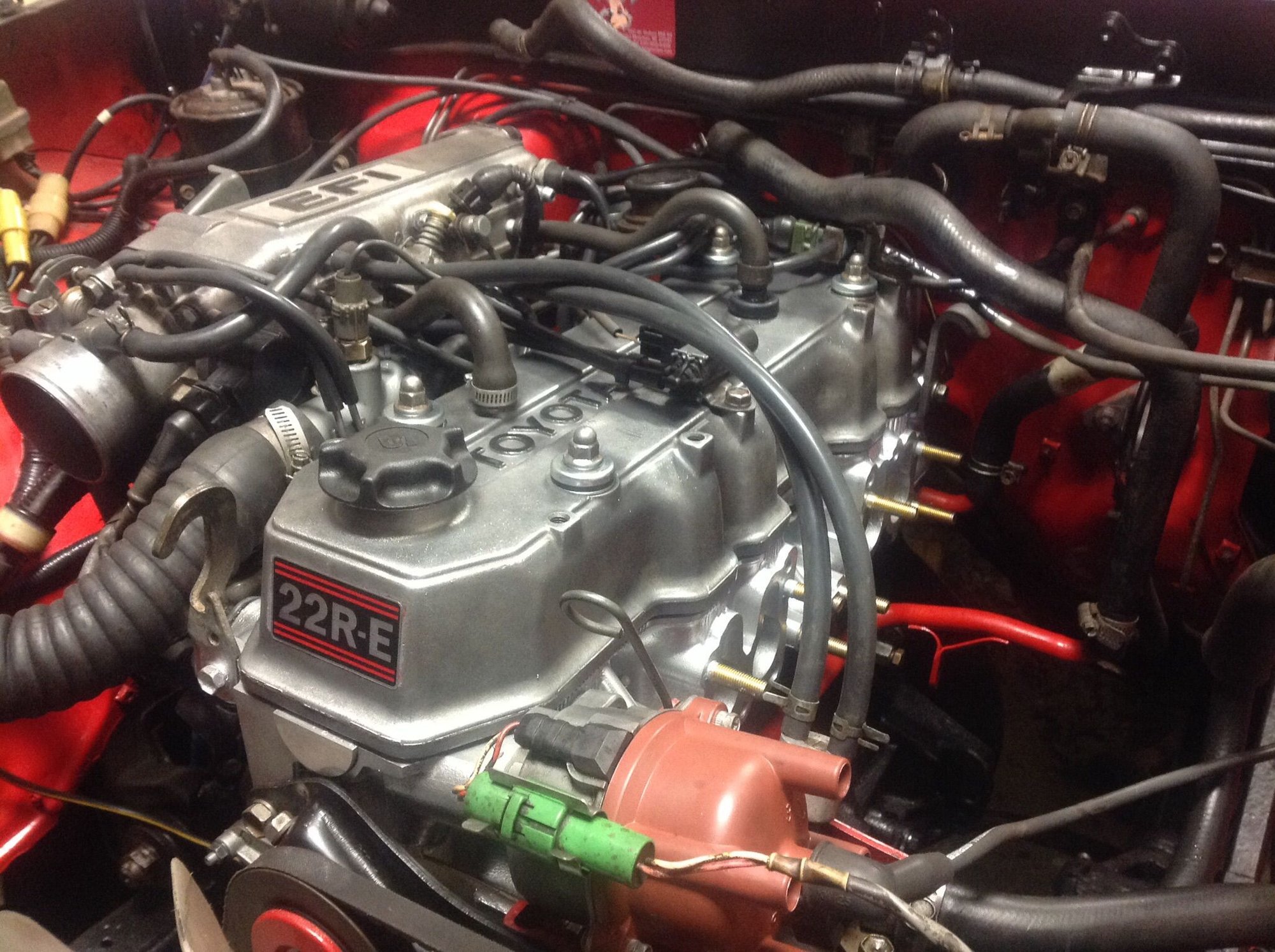

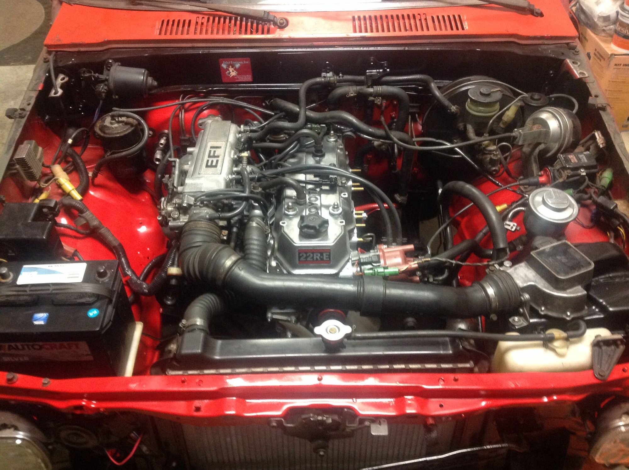

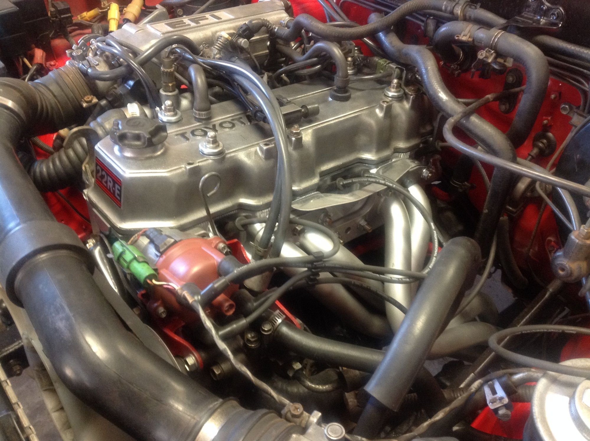

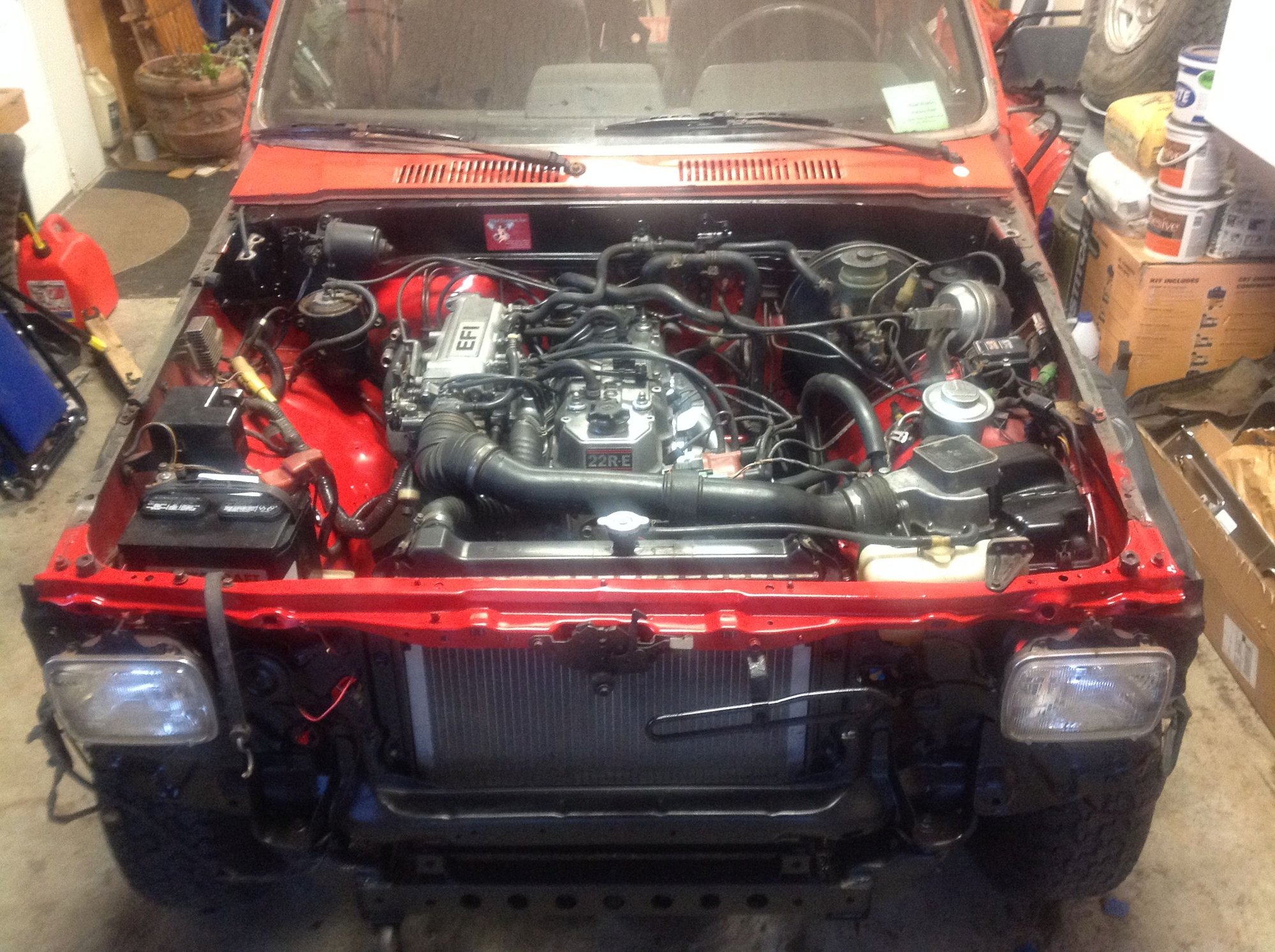

Most of the day was spent on my back as I got everything hooked up underneath the truck. Fixed the broken line to the slave cylinder and got the clutch hydraulics working. Then the driveshafts bolted up and gear oil in the transmission and transfer. The stick shifts reinstalled with new seals- though I want to replace the rubber boot on the transmission shifter- broken and I can see where water and dirt could get into it.
Then I got the exhaust started. Installed the header and the extension pipe with the o2 bung and plugged in the o2 sensor.
Other little things, spark plug wires, etc.
Got it all ready:

And it's alive!
The girls all came down to show me some love. My wife happily recorded it for me, too. Took a little cranking, but it fired up!
I let it run for about thirty minutes- open pipes and and all- watched the temp, watched for leaks, drove it back and forth a bit and it was nothing less than a complete success! It was doing some funny fluctuations in idle speed, dropping and picking up, but I'm not going to worry too much until I time it and get the rest of the exhaust on it.

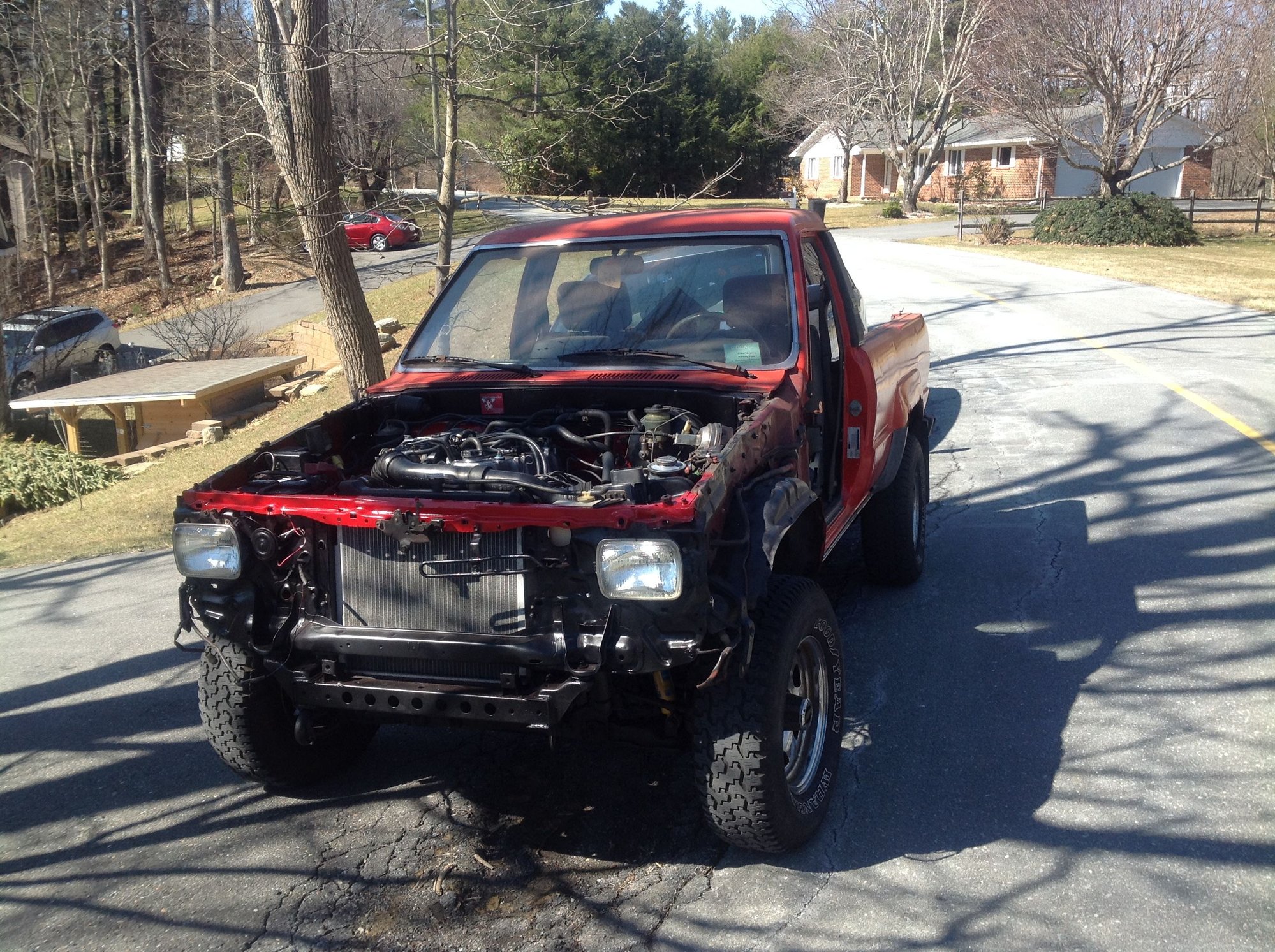

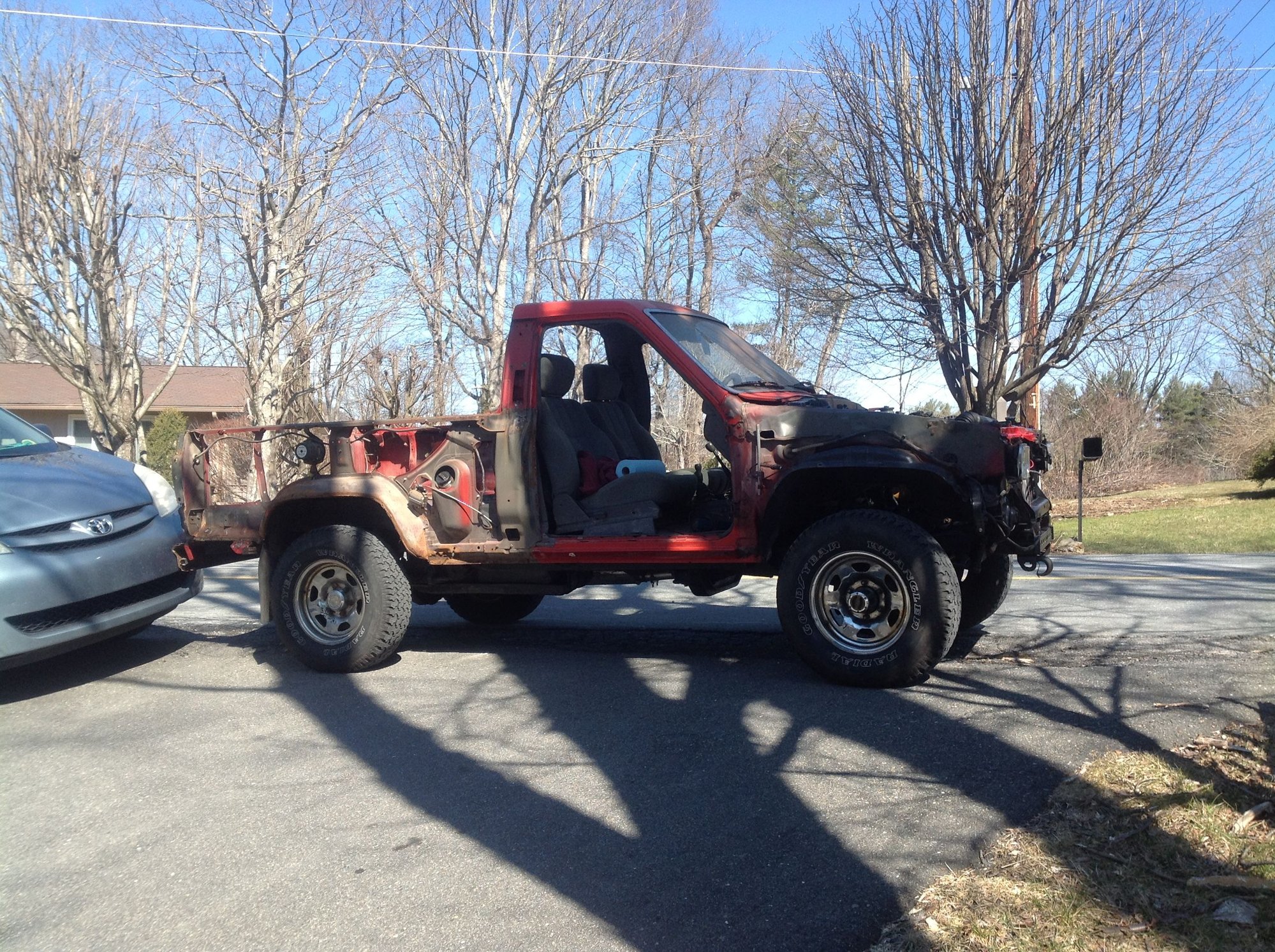

First road test
I had a couple hours today before heading to work so I borrowed a timing light and got the motor timed, double checked my coolant and oil levels and took it for a spin!
In addition to having no doors, fenders or a quarter panel, it also has no registration or insurance- so I kept it in the neighborhood.
