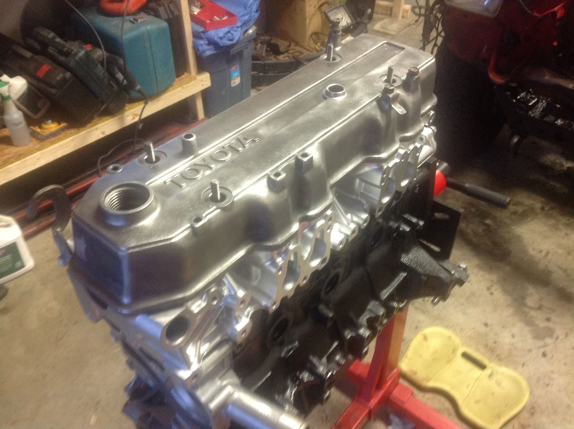

I wasn't really happy with my valve cover, so I took a wire wheel to it for a while.
I will repaint the letters black:

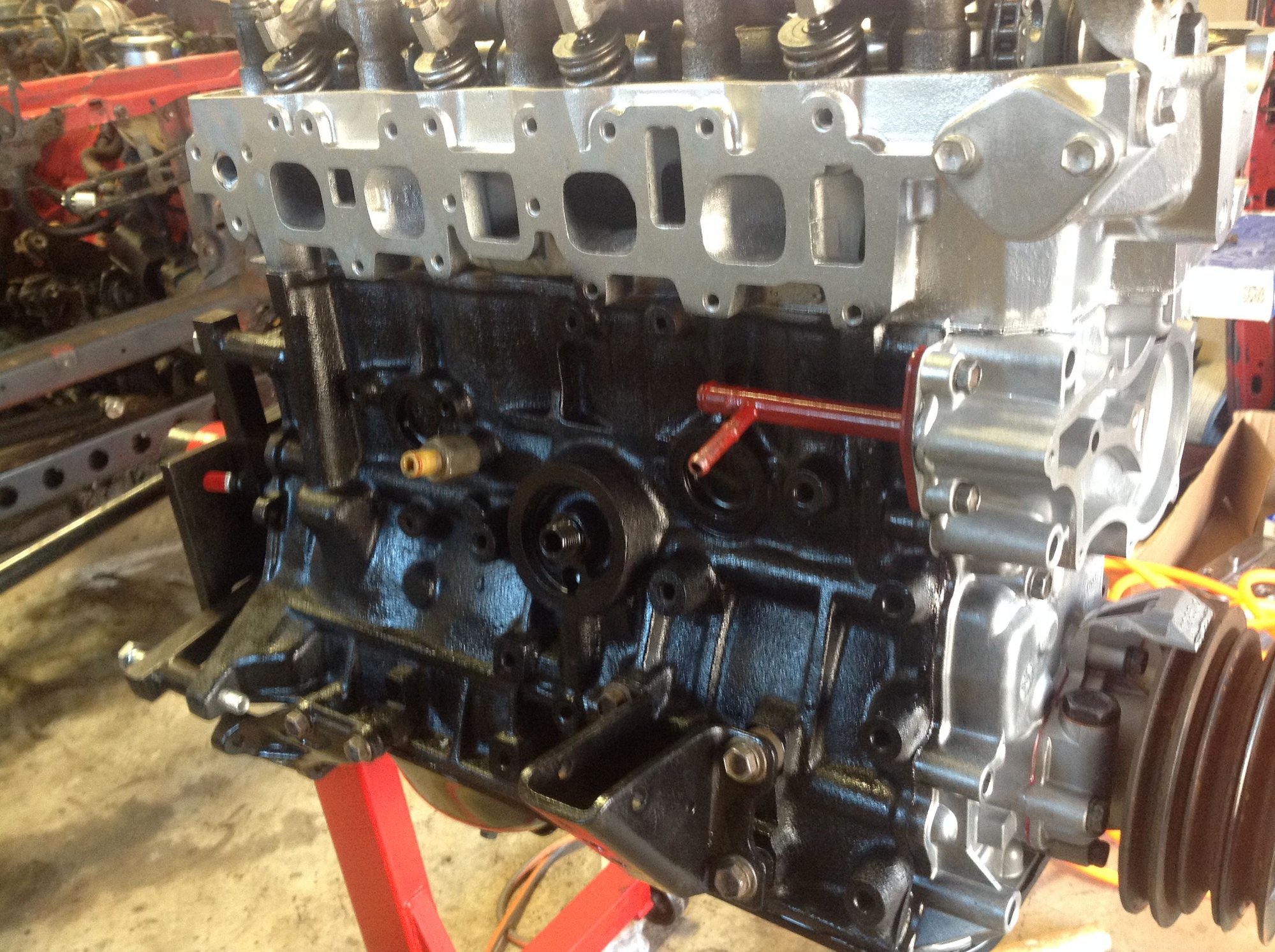

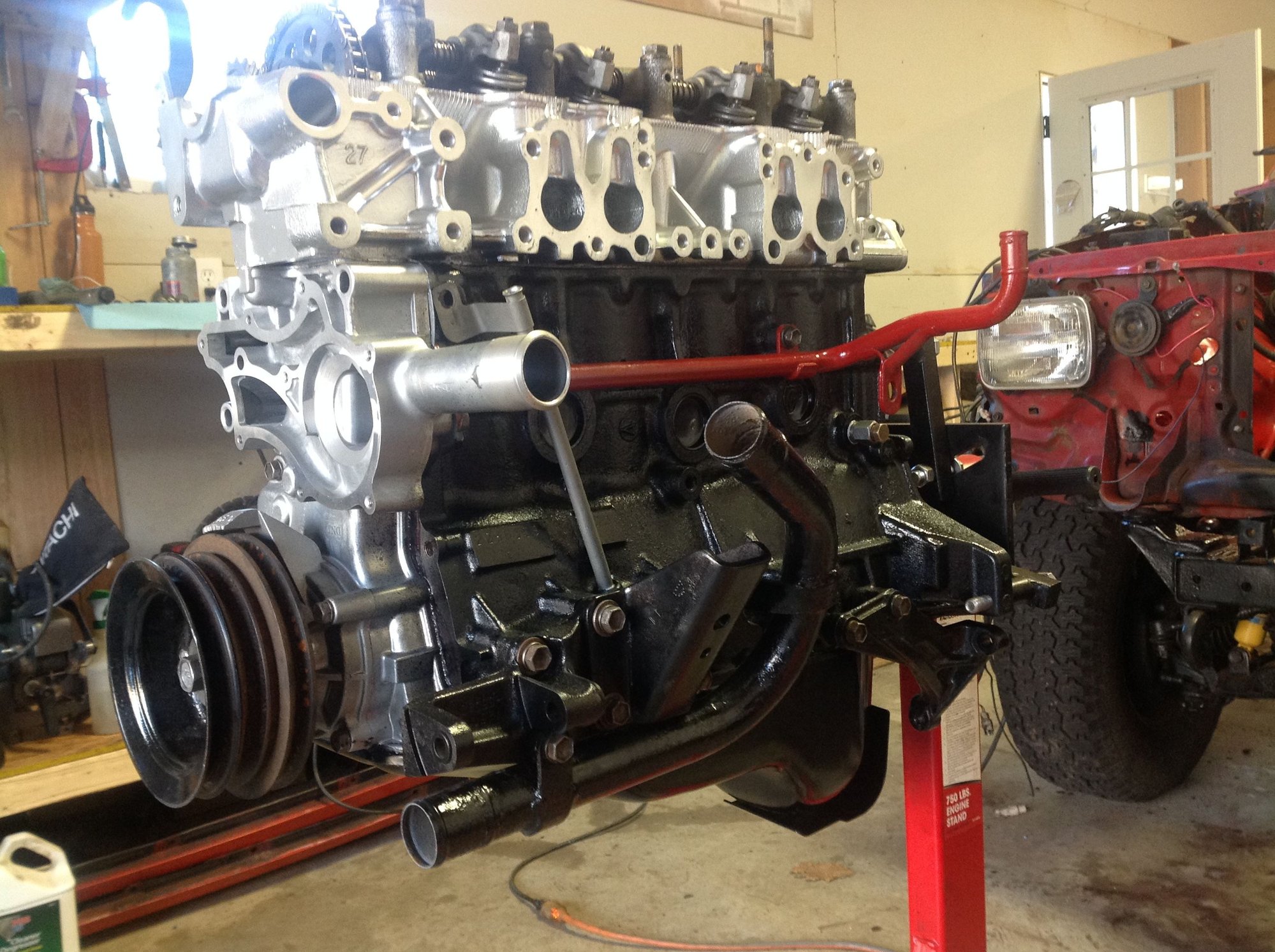

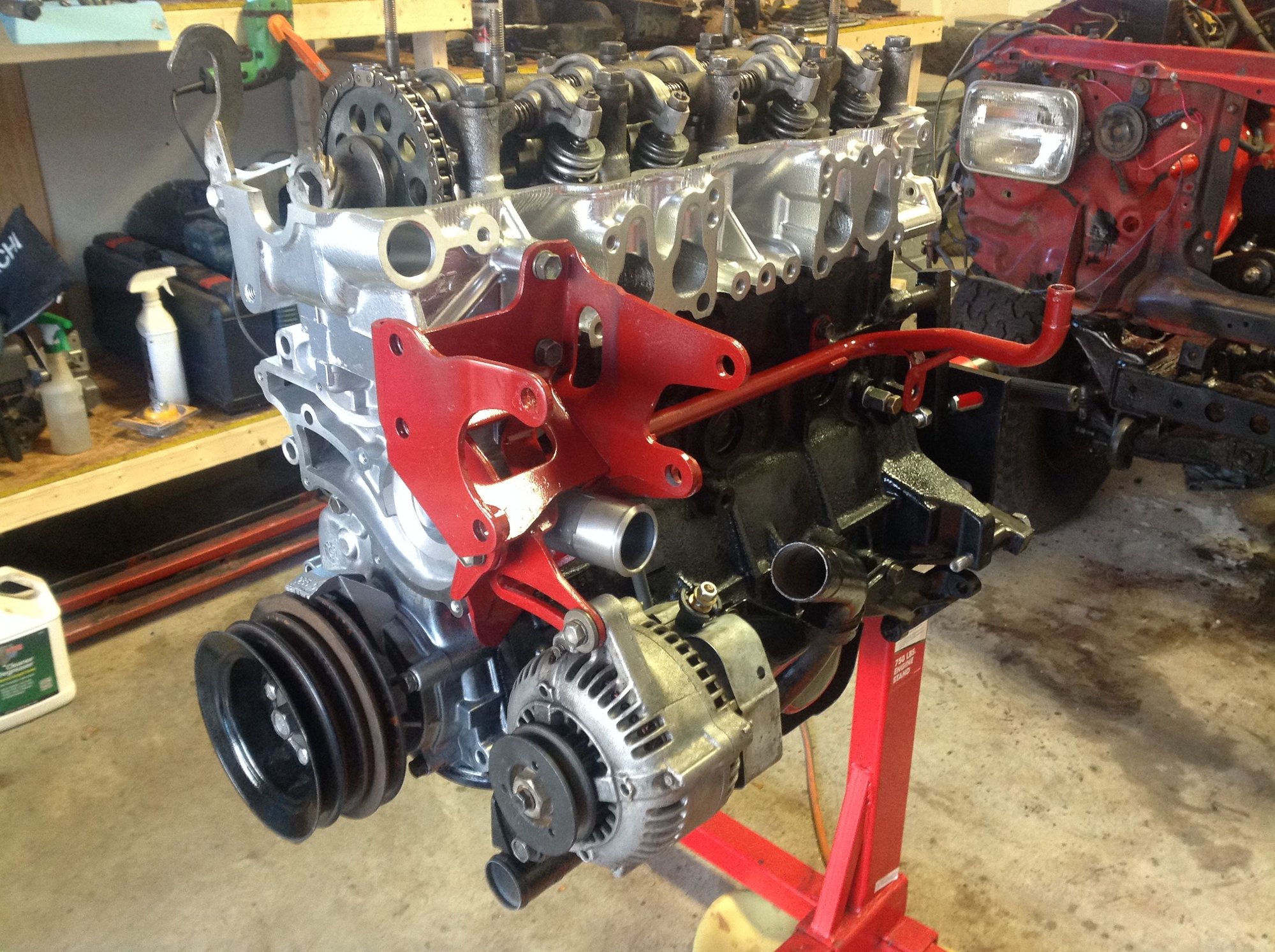

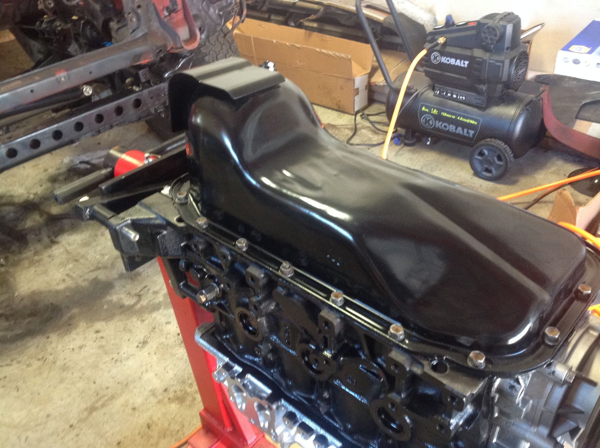

Okay, getting closer to being ready to put the motor back in. I spent some time with the POR-15 the other day. I applied it liberally with a foam brush. Two coats, the second just as the first was barely tacky. After it cured I was left with this:
Everything is pretty thoroughly covered in the stuff.
Next I was able to start putting things back on my motor!

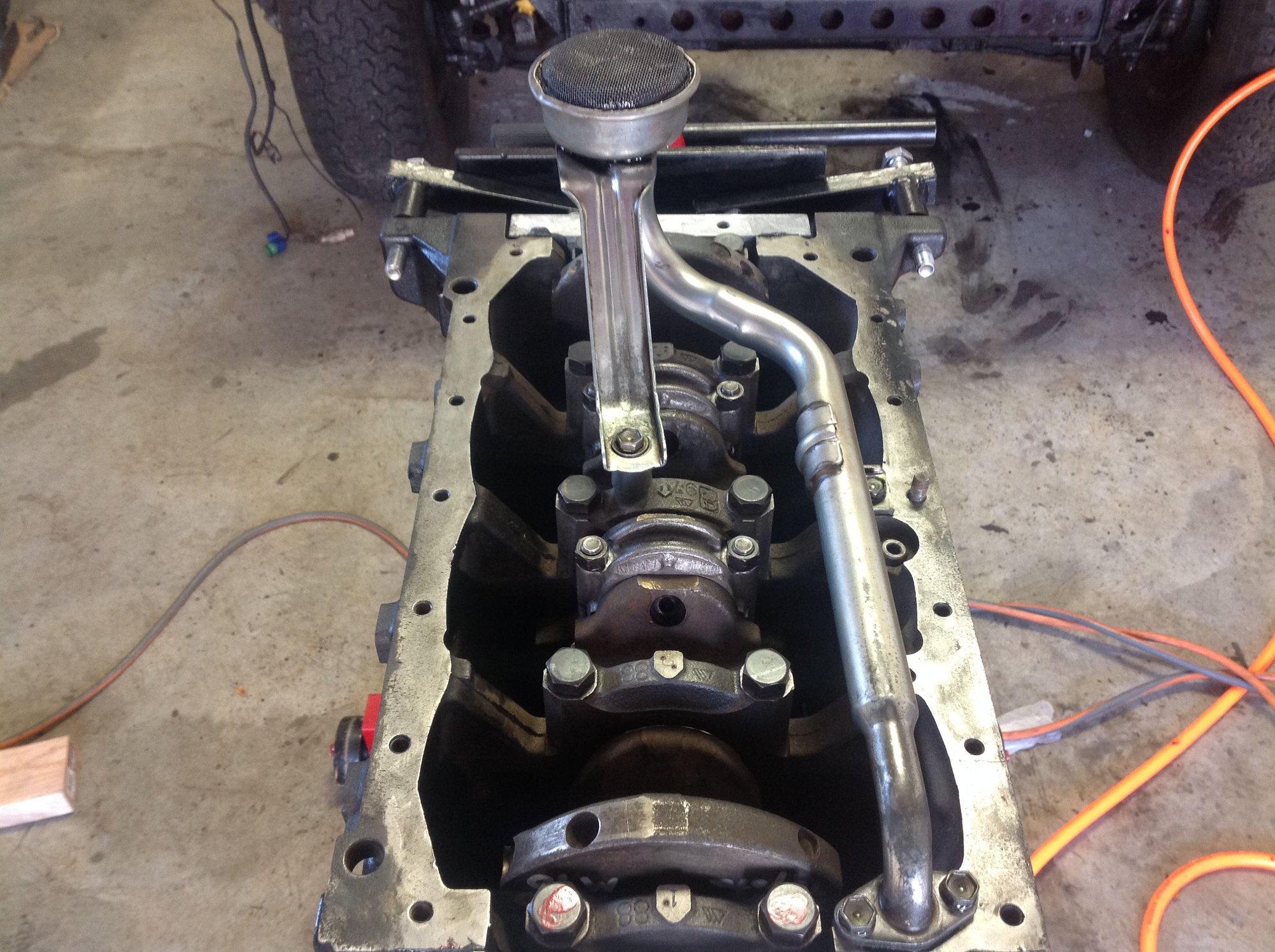

First was the oil pickup tube with a new gasket:
I cleaned the screen really well and wiped it all down. Next was the Toyota FIPG and a brand new oil pan (the old one was damaged when the motor fell and the drain plug was stripped):
All the oil pan bolts torqued to 9ft/lbs.
Then brackets and hardware as well as some water lines:
Not bad for a day's work!

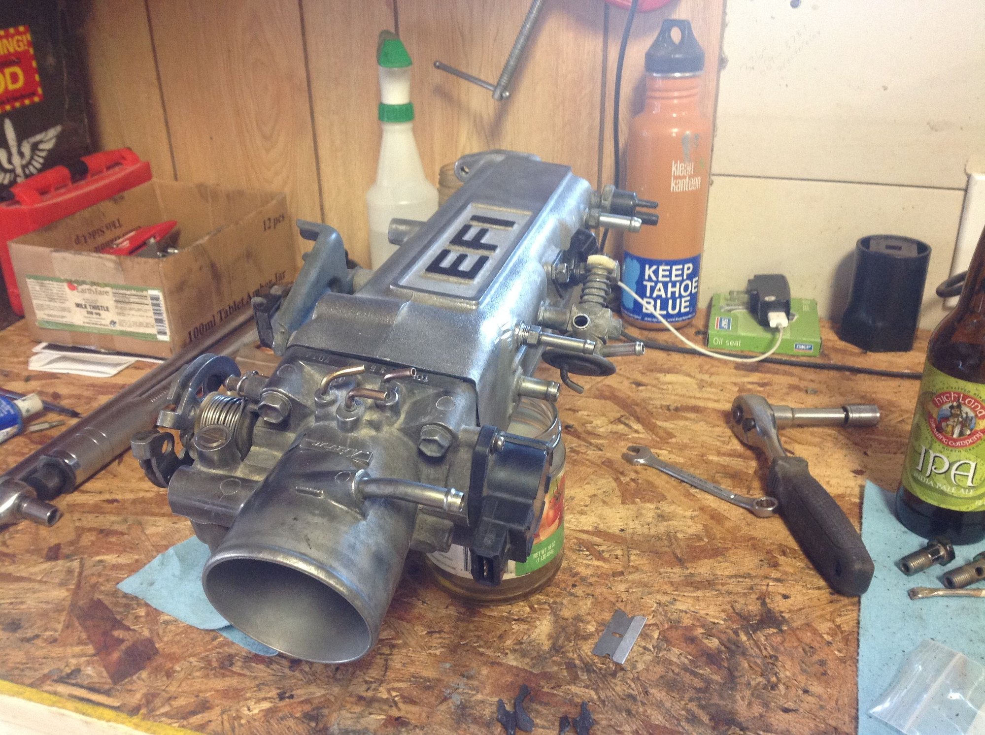

After a shower and a beer sat with the throttle body and a multi meter and set the TPS using 4Crawler's write-up. Thanks again to Gizzler for the heads up on that!

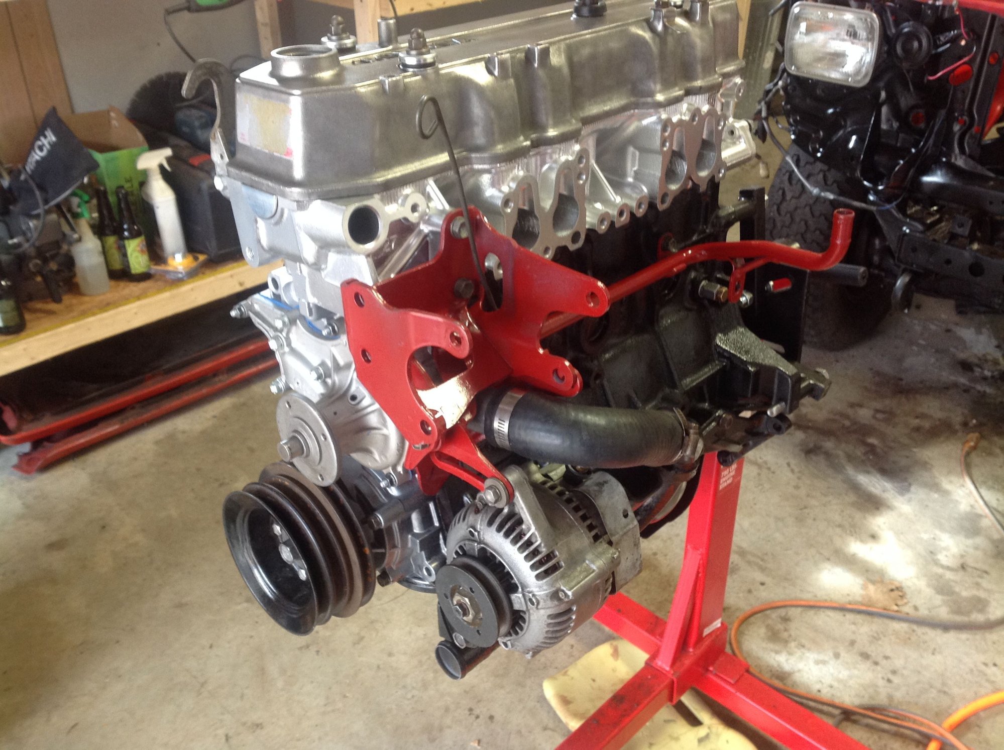

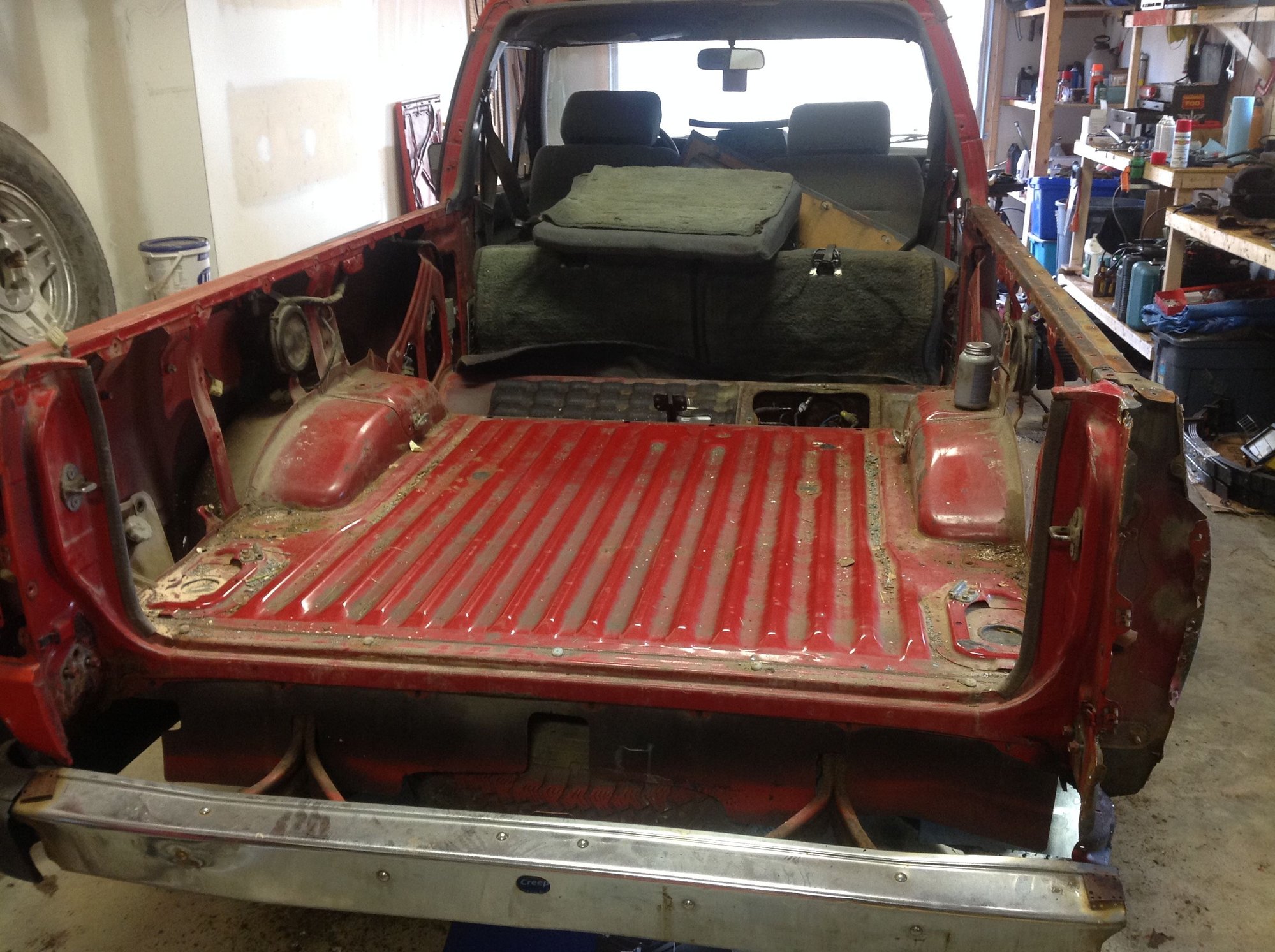

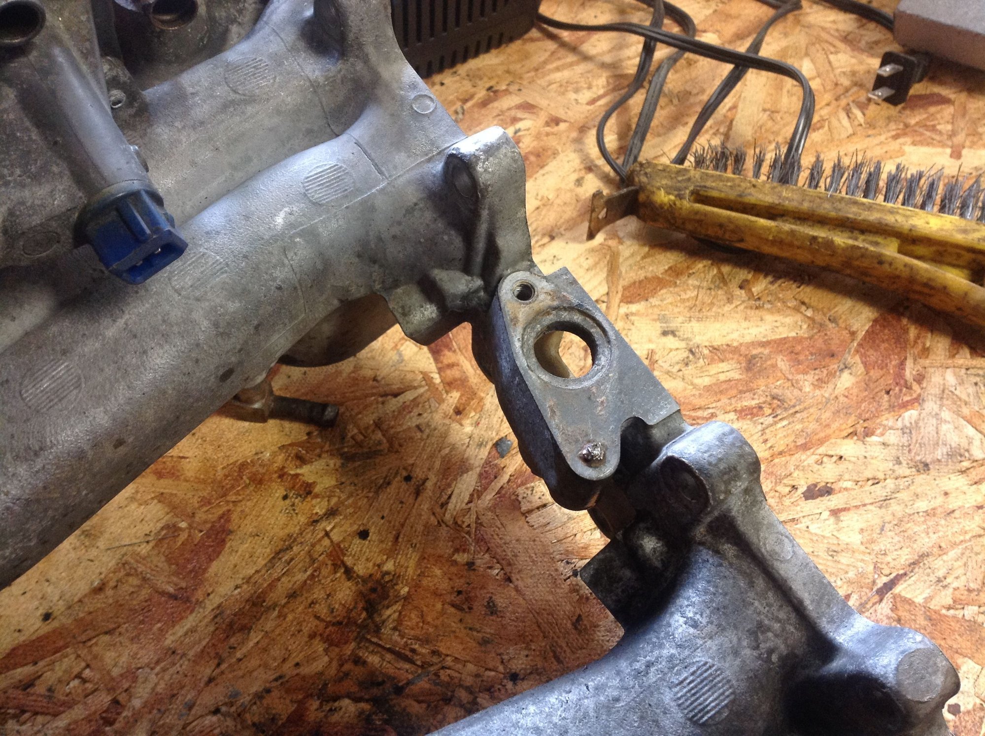

Got to spend the day working on the 4Runner- things are getting closer. Yesterday I dropped the intake off at a local metal shop to see if they could get this bolt out for me:
I need professional help with that one.
The transmission also got dropped off at the shop this week. Just a good go-through, bearings, sincronizers etc. I should be able to pick it up next week.
Worked mostly on the motor today. I got the water pump on and the associated hardware and the hose from the timing cover to the pipe. I also purchased a set of aluminum half moon head seals from 22re Performance out west- got those put in too:

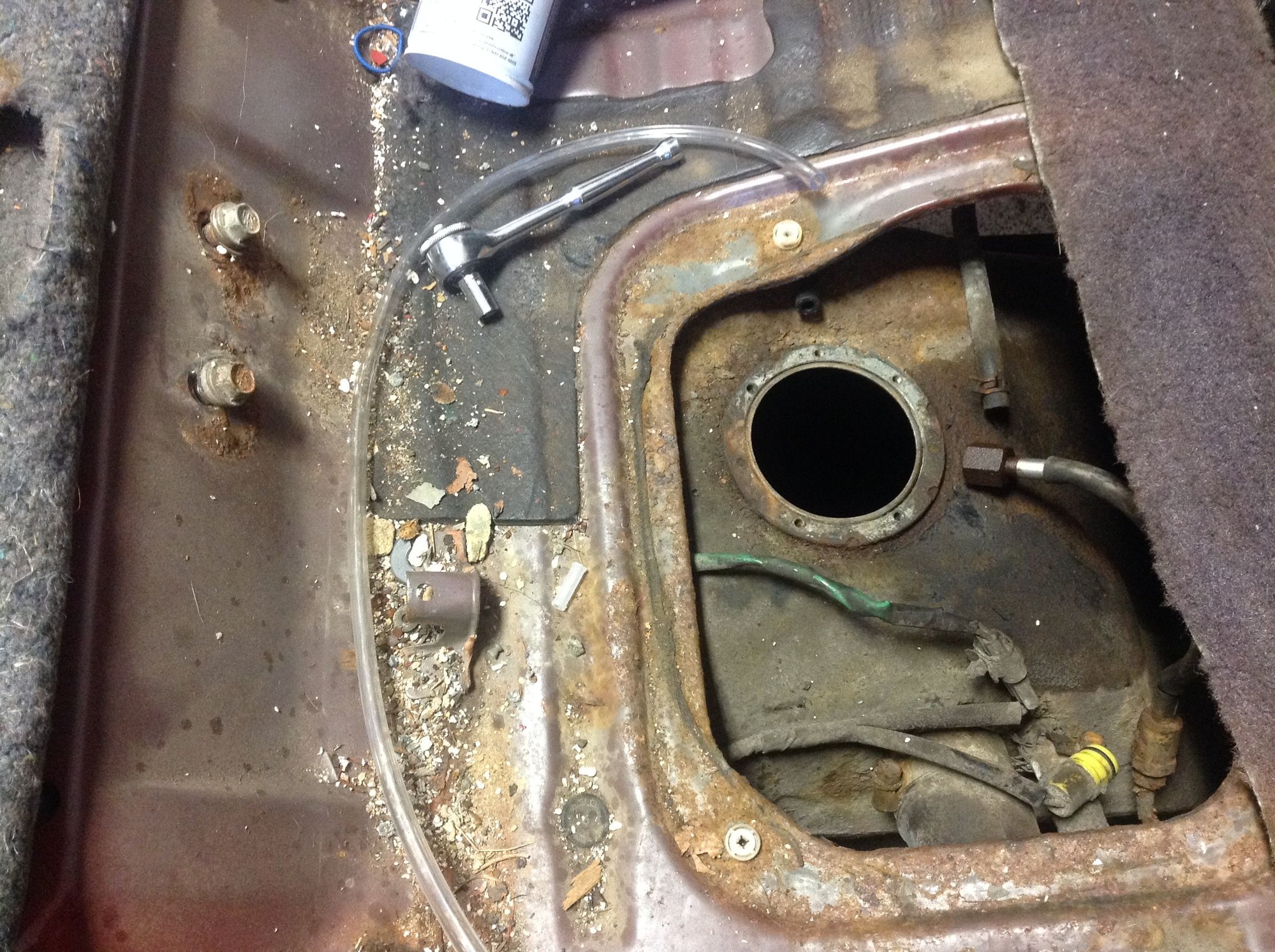

Most of you are probably aware of the access to the top of the fuel tank under the back seat- but just in case you weren't, here it is:
You can see I have some cleaning up to do there. I pulled it off so I could access the fuel lines to clean them. The gas has been sitting for over a year now- I'm not interested in running it through my new engine. I siphoned all the fuel out of the tank and blew out the fuel lines. Before putting it all back together I'll do some rust remediation...

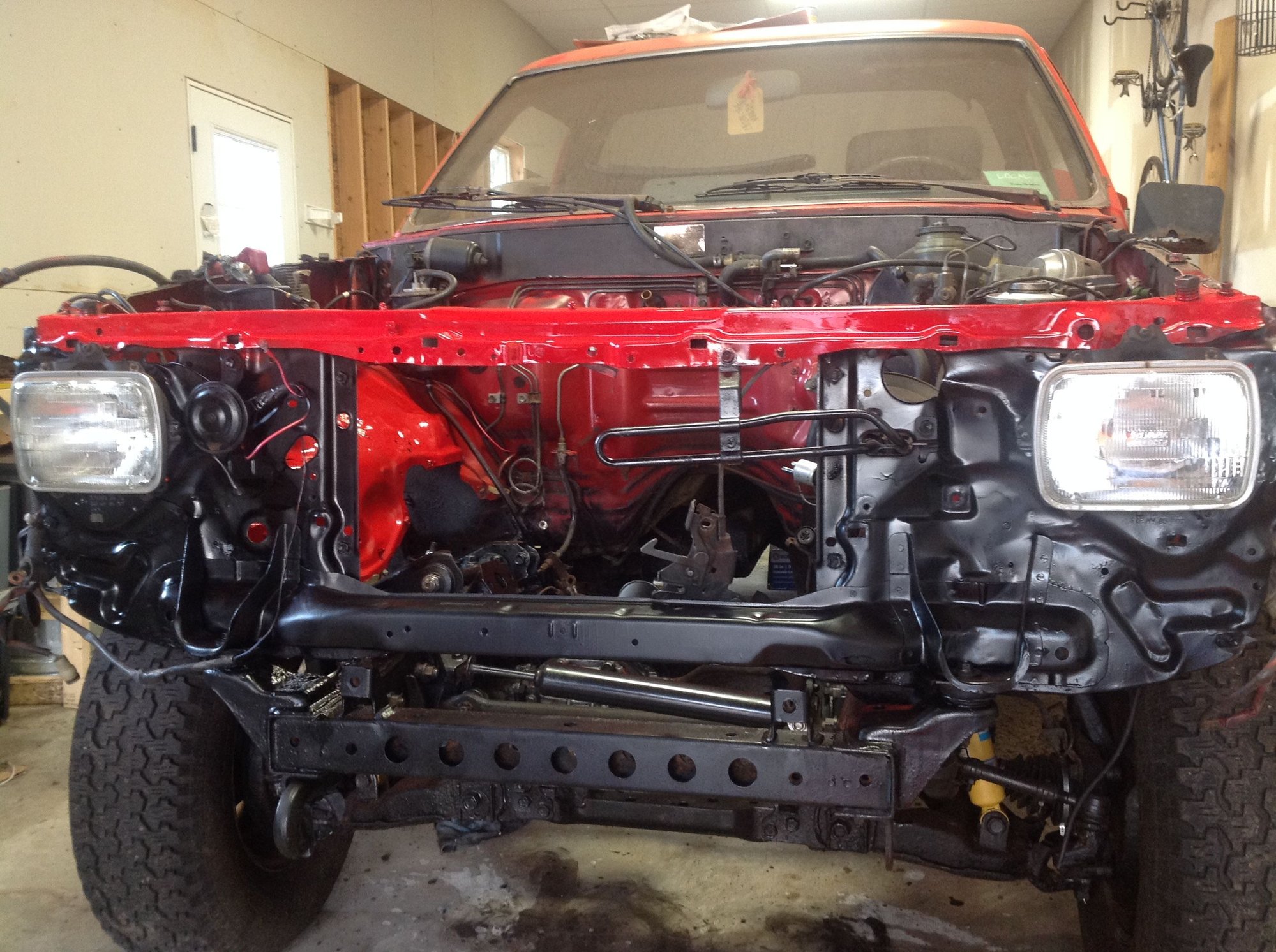

I then did some touching up on the front end:

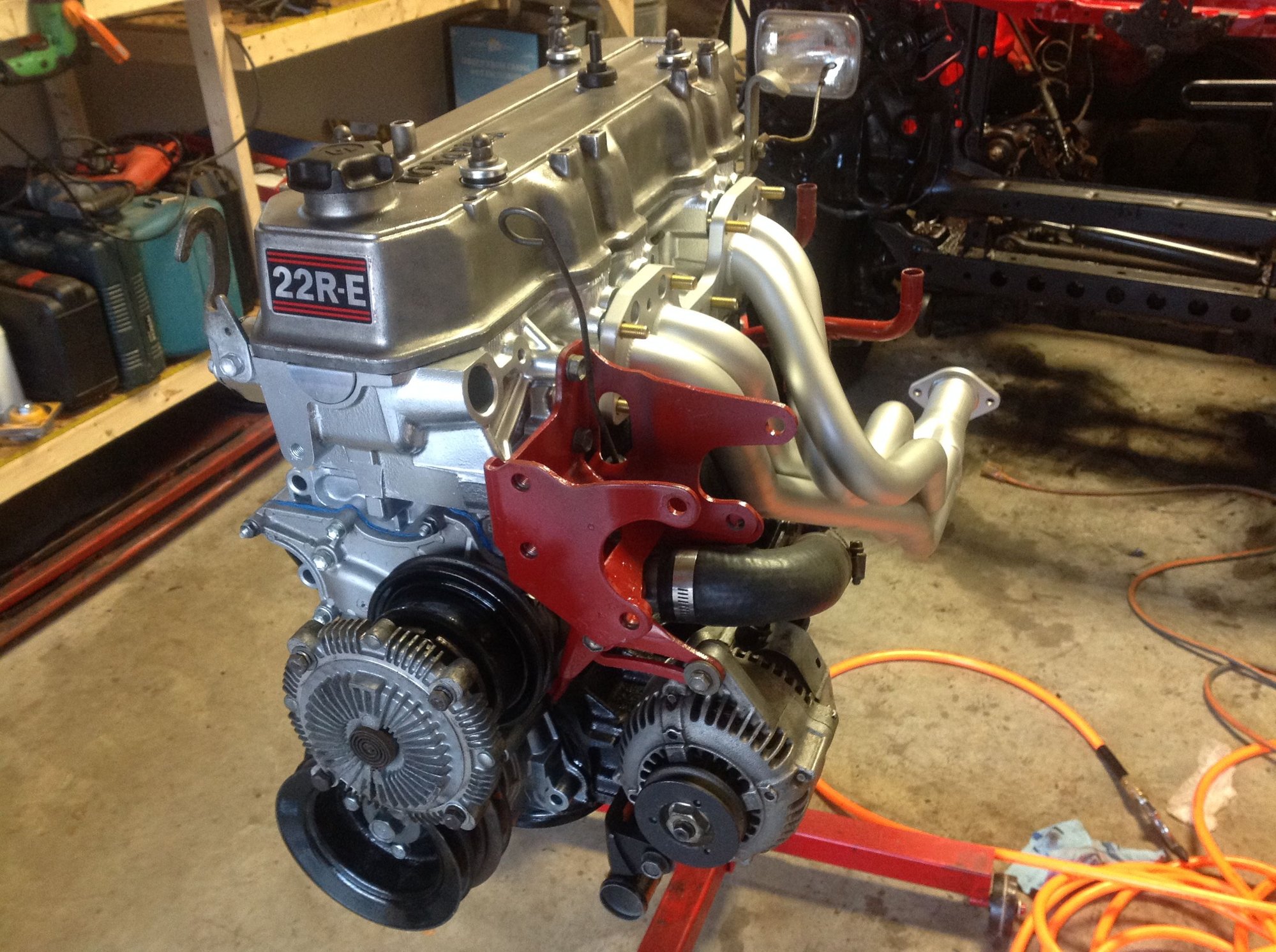

I got the new head studs installed for the header and did a little mock-up to satisfy my curiosity:
Other little things, too. Pulled the carpet out of the back to get cleaned. I realized I accidentally threw away the head studs for the EGR when I tossed the studs on the exhaust side... Put the throttle body back on the intake.

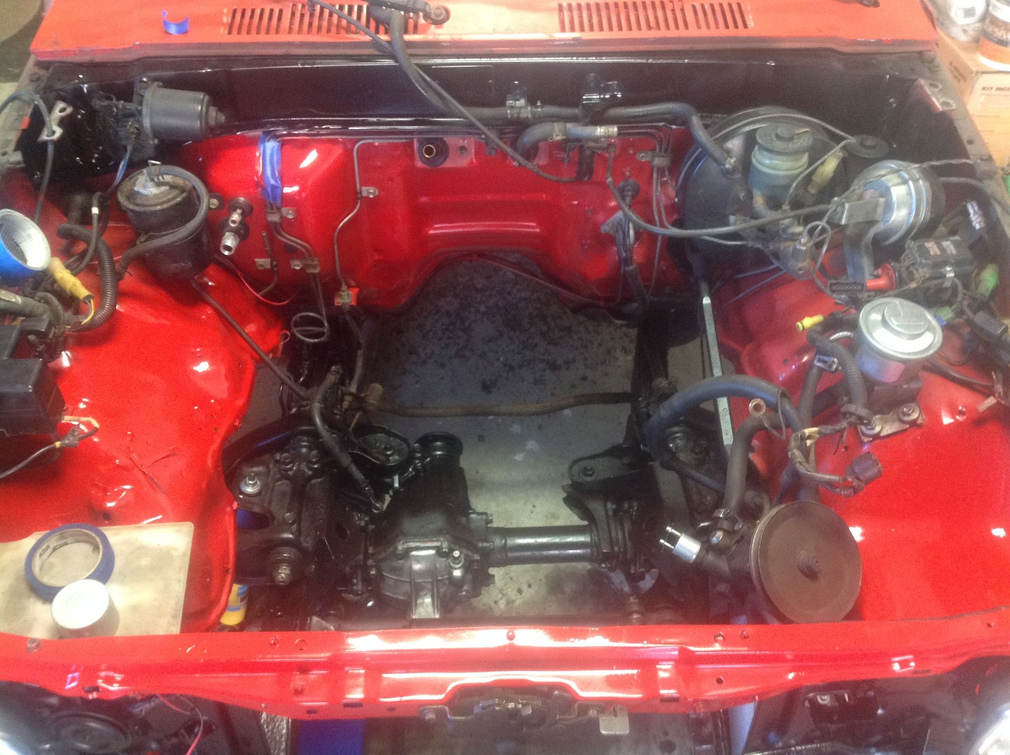

Cleaned and installed the distributor today- nice tip from this video:
Also did some more painting and I just about have the engine bay where I'd like it for the motor:
Changed the front diff fluid, too. Pulled the breather and cleaned it out.
Creeping ever closer...

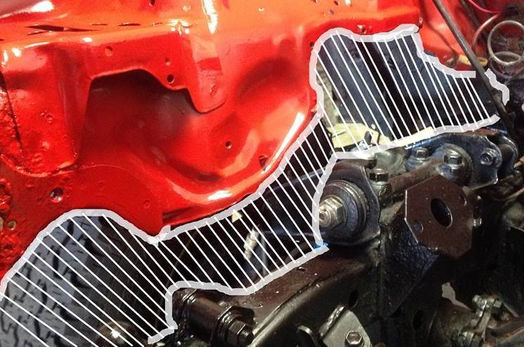

Name this part
I want to replace these:
Not sure what it's called or how to search for them. I want try to keep water and road salt out of the engine compartment.
Any ideas?
Thanks!

Do you mean fender liners? I suspect most of our generation trucks are missing them. I took mine off about four years ago and haven't put them back. It doesn't look like they are for sale anywhere. I'm not sure what Toyota would call them anyway. This guy with a 4th gen made them out of rubber mat:
http://www.toyota-4runner.org/4th-ge...umber-s-2.html
Old Feb 8, 2016 | 01:55 PM
  #119
92ehatch's Avatar
Joined: Jan 2015
Posts: 652
From: Hendersonville NC
I still have mine. They are just a thin rubber or softplastic. . I would make them out of something similar like started above. Shouldn't be hard.
Old Feb 8, 2016 | 02:00 PM
  #120
ladybugRC's Avatar
Joined: Feb 2012
Posts: 323
Likes: 20
From: Boone, North Carolina
Yeah, exactly, my '03 has some sort of rubber matting- which is a great idea! I'll see if I can make some...
I'm sure you're right about them being missing- I rarely see them. But I was noticing how much my relatively new starter and fuel filter had rusted- inexpensive aftermarket, for sure, but they were obviously getting exposed to a lot of debris from the road. I feel compelled to try to protect my investment and I really like the idea of getting those liners back in there.
Like Nervo said, I can't find anyone selling them. Thought maybe I was just searching the wrong name.
Cutting some heavy rubber and fitting it in seems like a realistic alternative though. Thanks for the idea Nervo!
