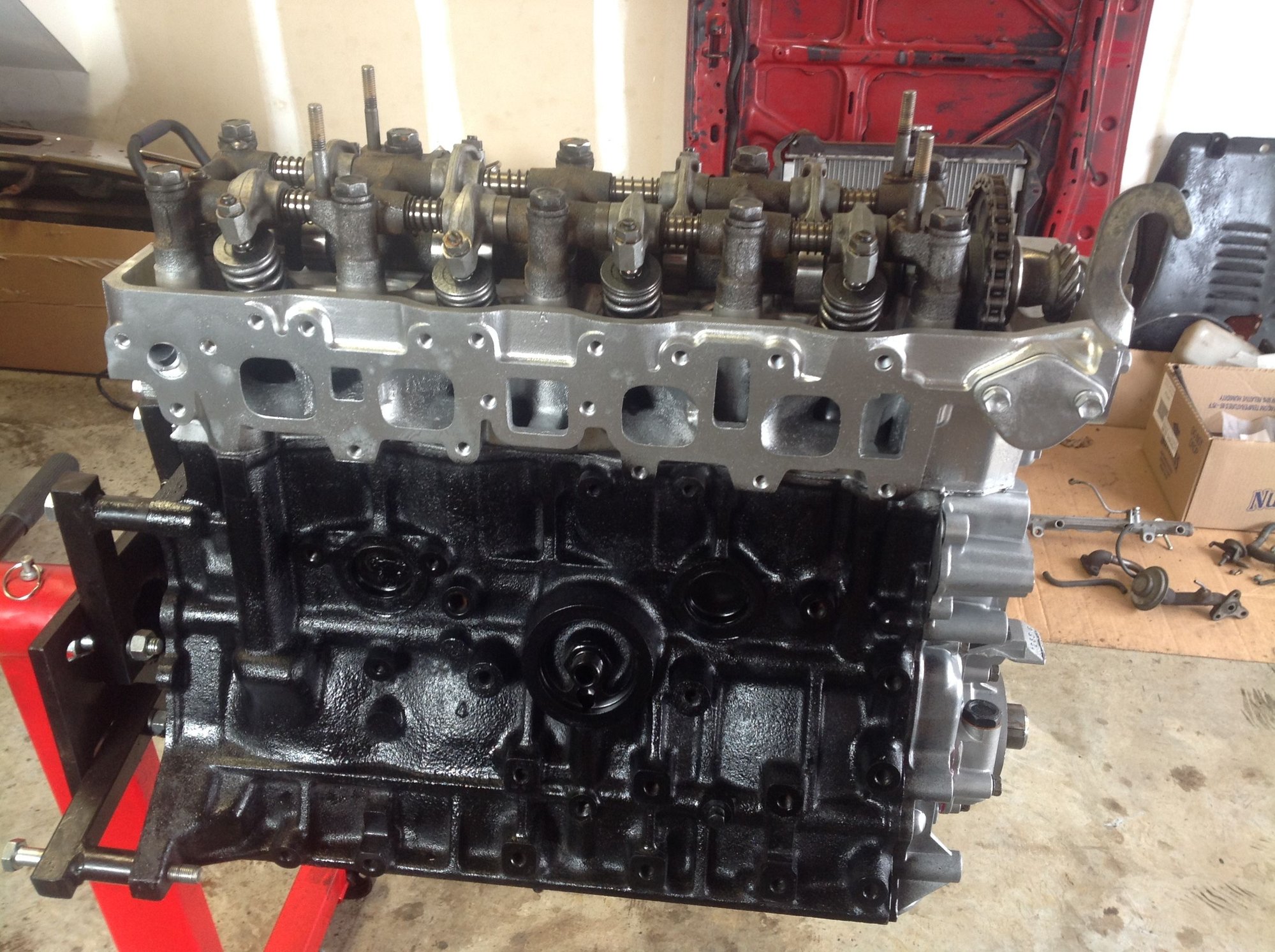

Engine shop called yesterday. The motor is ready to be picked up!
Less than two hours away is a remanufactured engine just waiting for me. Here's the breakdown from the shop's website:
Our Remanufactured Engines Include:
The block is taken down to the bare casting. We clean, deck, bore & hone it, it gets new freeze plugs and cam bearings. We turn the crank and resize the rods. It gets pistons & pins, rings, rod and main bearings, cam, lifters, timing components, oil pump & gaskets.
We go thru the heads completely, resurface the heads,we use a 3 angle cut on the seats, reseat the valves, knurl the guides, new valve stem seals. All new gaskets for the engine are included. (Some things are done a bit differently for different engines.ie: some don't take cam bearings, etc.)

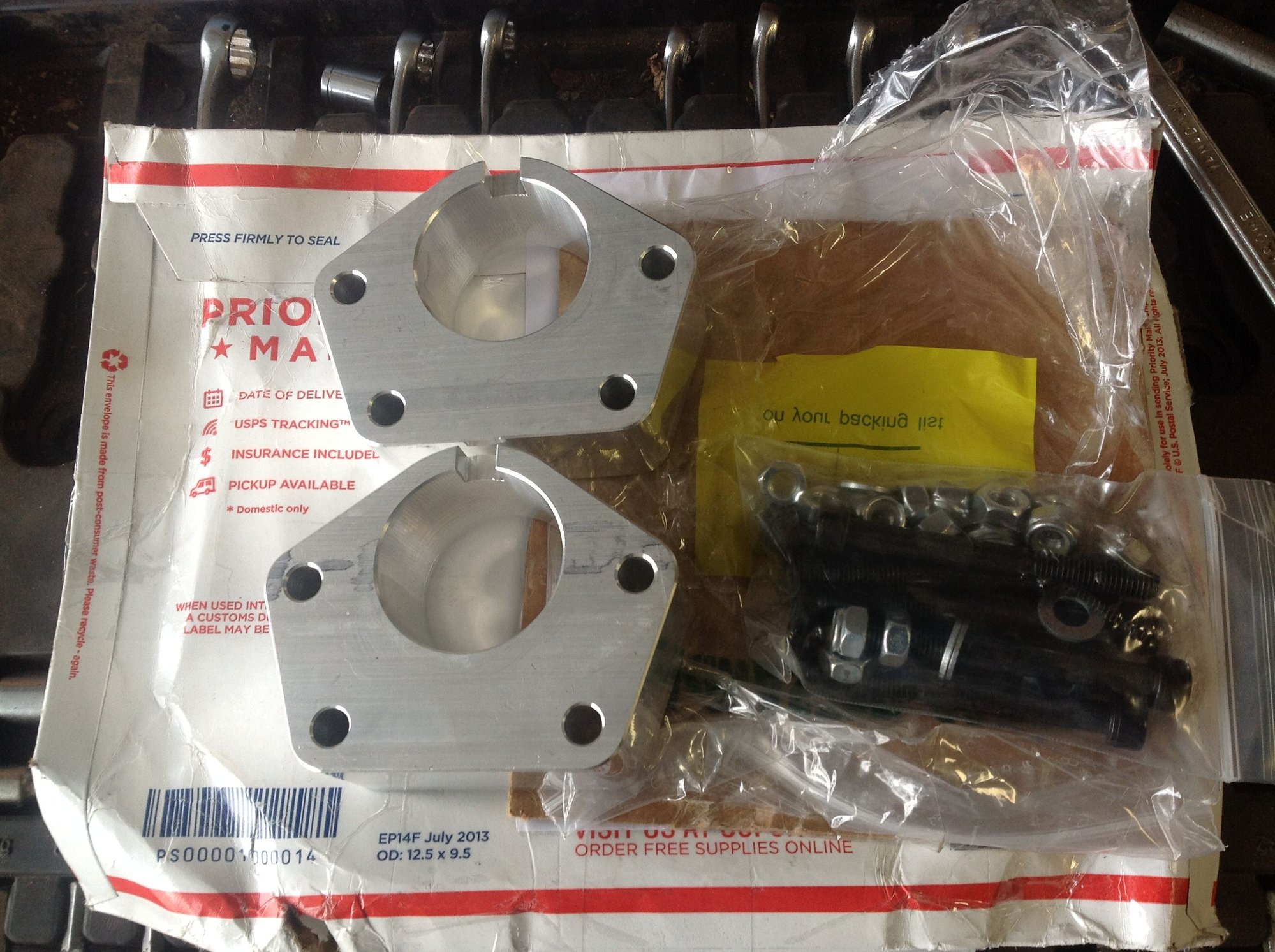

And my ball joint spacers arrived from 4crawler today, too!
