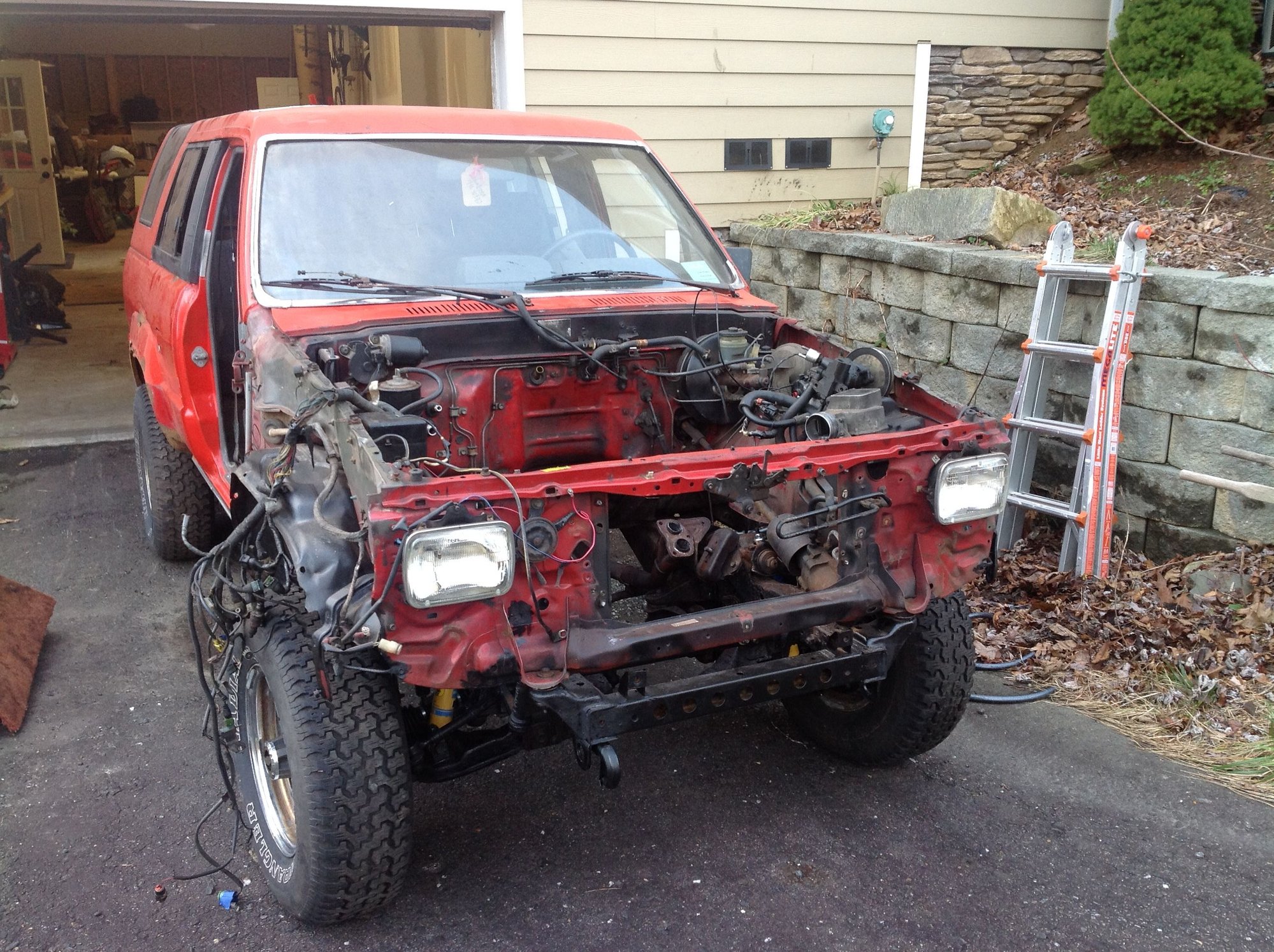

So it's December 29th and when I got off work this afternoon it was 68 degrees. I figure this could be one of the last nice days for a while so I did some more cleaning.
The 4Runner saw daylight for the first time in nearly a year today:
I rolled it out of the garage and prepared to get wet.
I know there are differing opinions out there regarding water and cleaning the engine bay- but I said the hell with it and took a power washer the the whole front end.
Here's the before:
...and after:
I couldn't believe how much crud came out. I sprayed everything down with the por-15 degreaser beforehand- I think that really helped.
I also have to say that I experimented a bit: I took the power washer to the parts I had painted with the por-15 and the paint did not budge. Anything that had that stuff on it could take the power washer at point blank and not flake at all. Even at the edges. I tried but had no success. This gives me more confidence in that stuff, especially considering it's not cheap. I'll continue painting all rusty spots as I did where the battery mounts and the frame.
I wasn't sure of the ediqutte for bringing a block in to a machine shop so I also power washed the motor. A bit less greasy to handle anyway.
