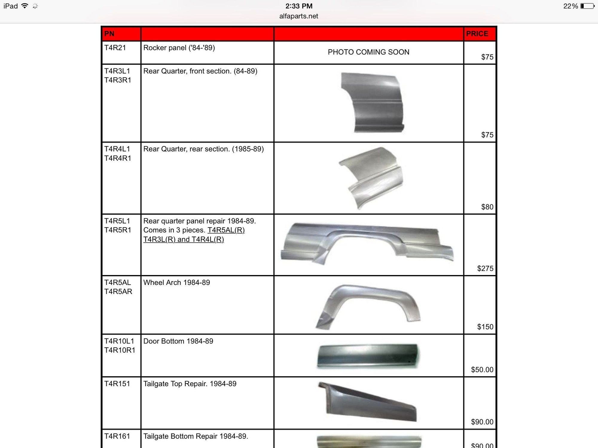

Saw one of your earlier pictures and I am also looking at doing a rear fender repair. Stumbled upon alfaparts.net which has a pretty good selection.
Thanks man, yeah, I think I looked at that site when I was researching how I wanted to fix my 1/4s. Your post is timely though as I spent the day focusing on that repair.

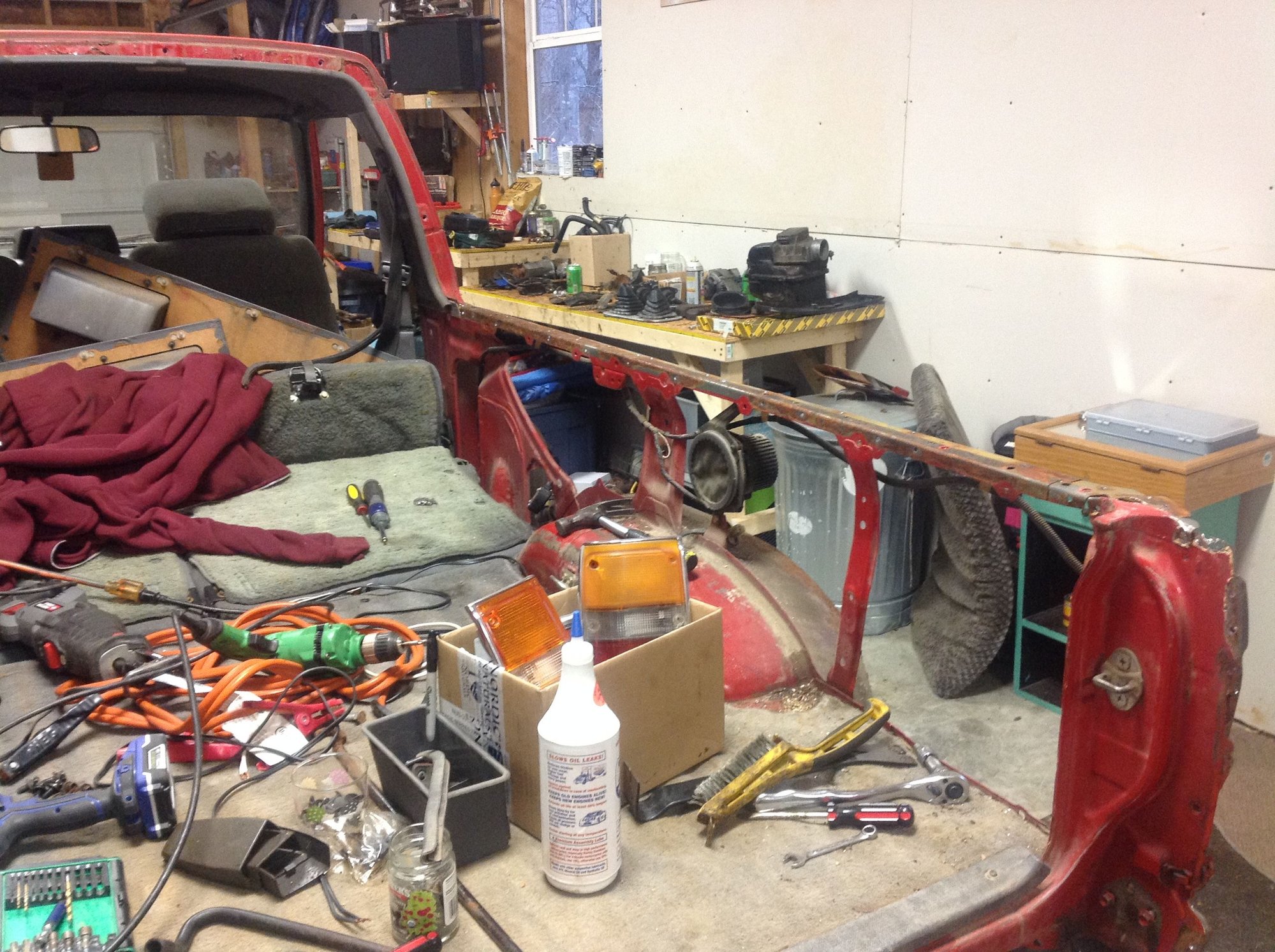

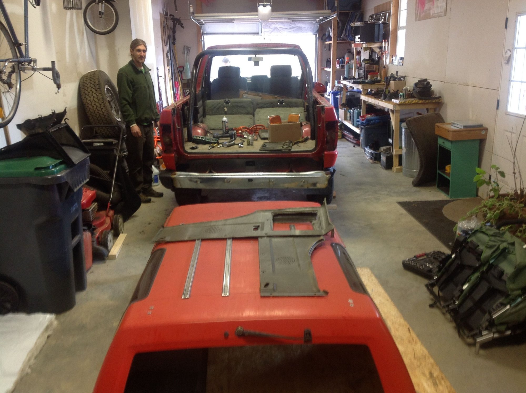

Today is my birthday and my wife asked me how I'd like to spend the day. So after a nice breakfast with all my girls I headed over to the garage. I stopped at the grocery store and picked up a 12pk of beer on my way. I had a couple of buddies from work come by and work with me, too. The first thing we did was get the lid off:

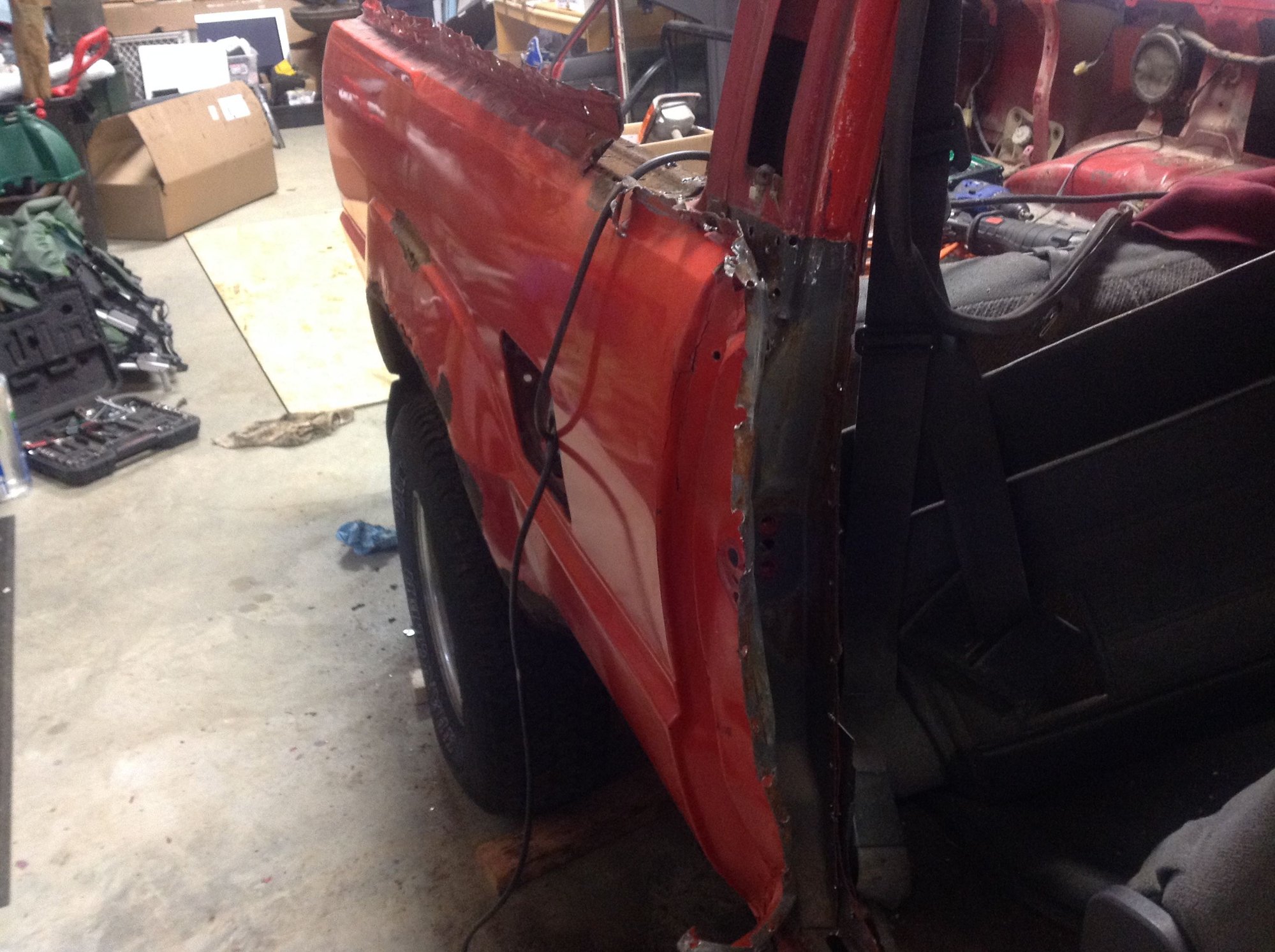

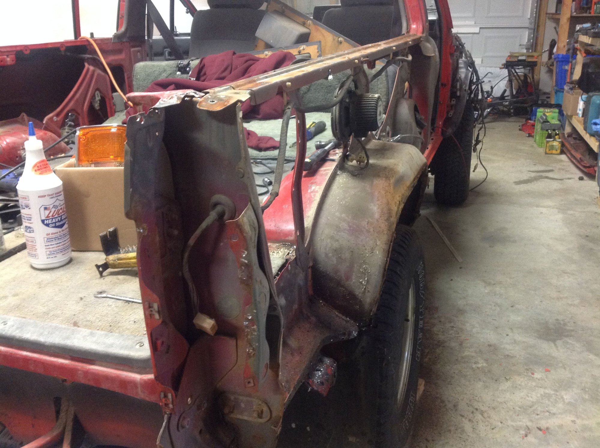

1/4 panel removal
Getting the 1/4s removed has been something that has been stressing me out a little- really wasn't sure exactly what to expect. I have no body work experience and I've been a bit nervous to tackle it. But with beer in hand and most of a day to work it began.
Once the top was off the tailgate was removed, the tail lights and then the interior panels:
There are little dimples all the way around the edge of the panel where it is welded:
Got those drilled out along the inside edge and started peeling it back:
There were two more rows of welds along the top of the panel:
Then along the inside of the door and along the bottom of it:
And finally at the tail end and pulled it off!

Originally Posted by 92ehatch
Happy frigging birthday. I'll open a beer and have one with you.
How bad is your quarter rust?
I'm considering a quick removal and cover up with some fender flares to hide it. Should cost less and look pretty decent as well
Thanks, still enjoying my beer!
The flares will most definitely be more cost effective than these fiberglass panels I ordered. I am fortunate that I'm able to do the fiberglass and it is certainly my goal that I be able to drive this truck for many years to come. Here's some of the nastier areas I'll have to contend with:
The top one is where the tailgate bolts up on the driver side.
And then there's this:
