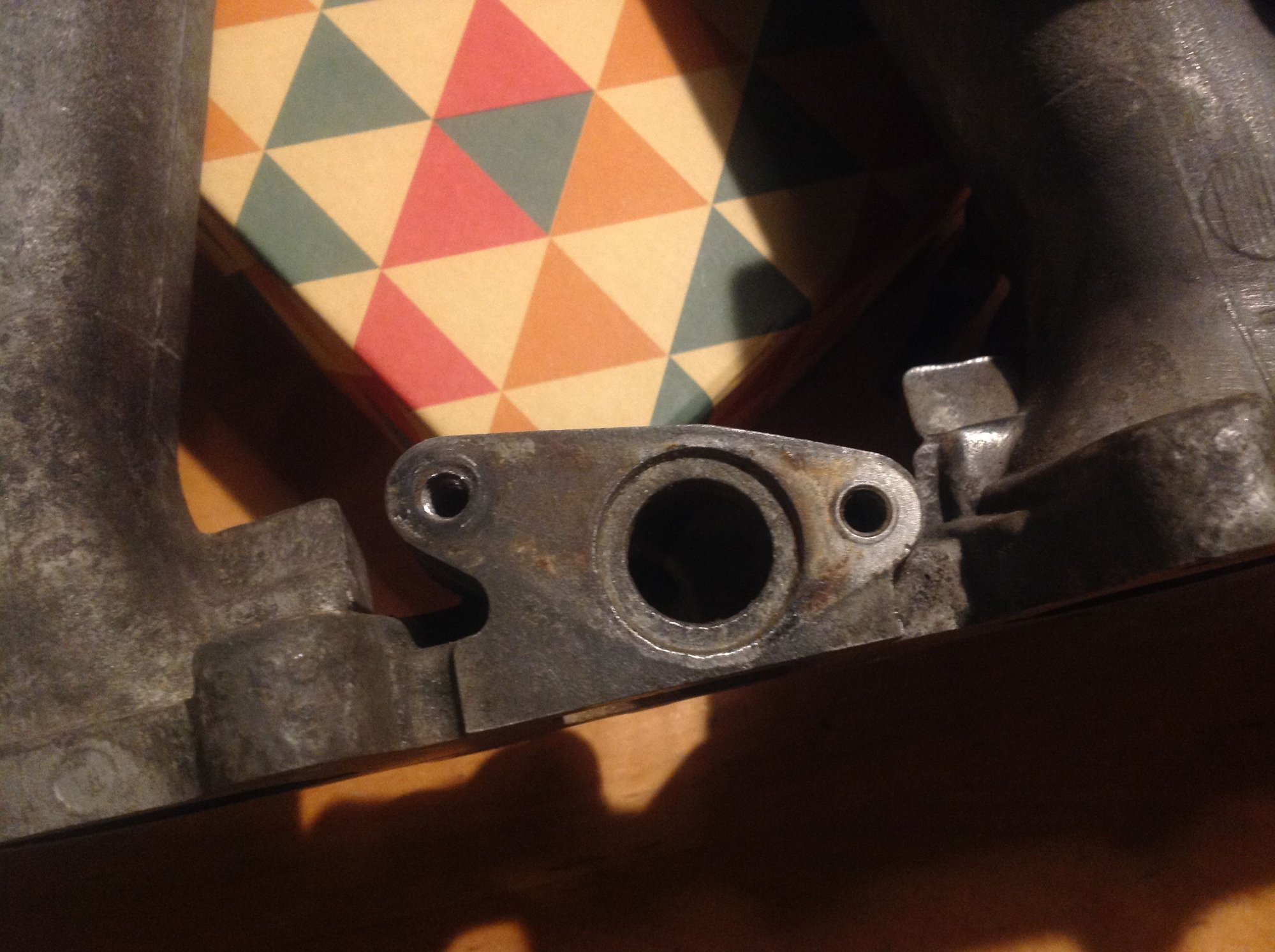

In the meantime, I'm chomping at the bit here in anticipation of getting this motor started. Another piece of the puzzle today:
Local shop got that broken bolt out for me. $12. Way cheaper than me attempting it myself, screwing it up and having to replace the intake.

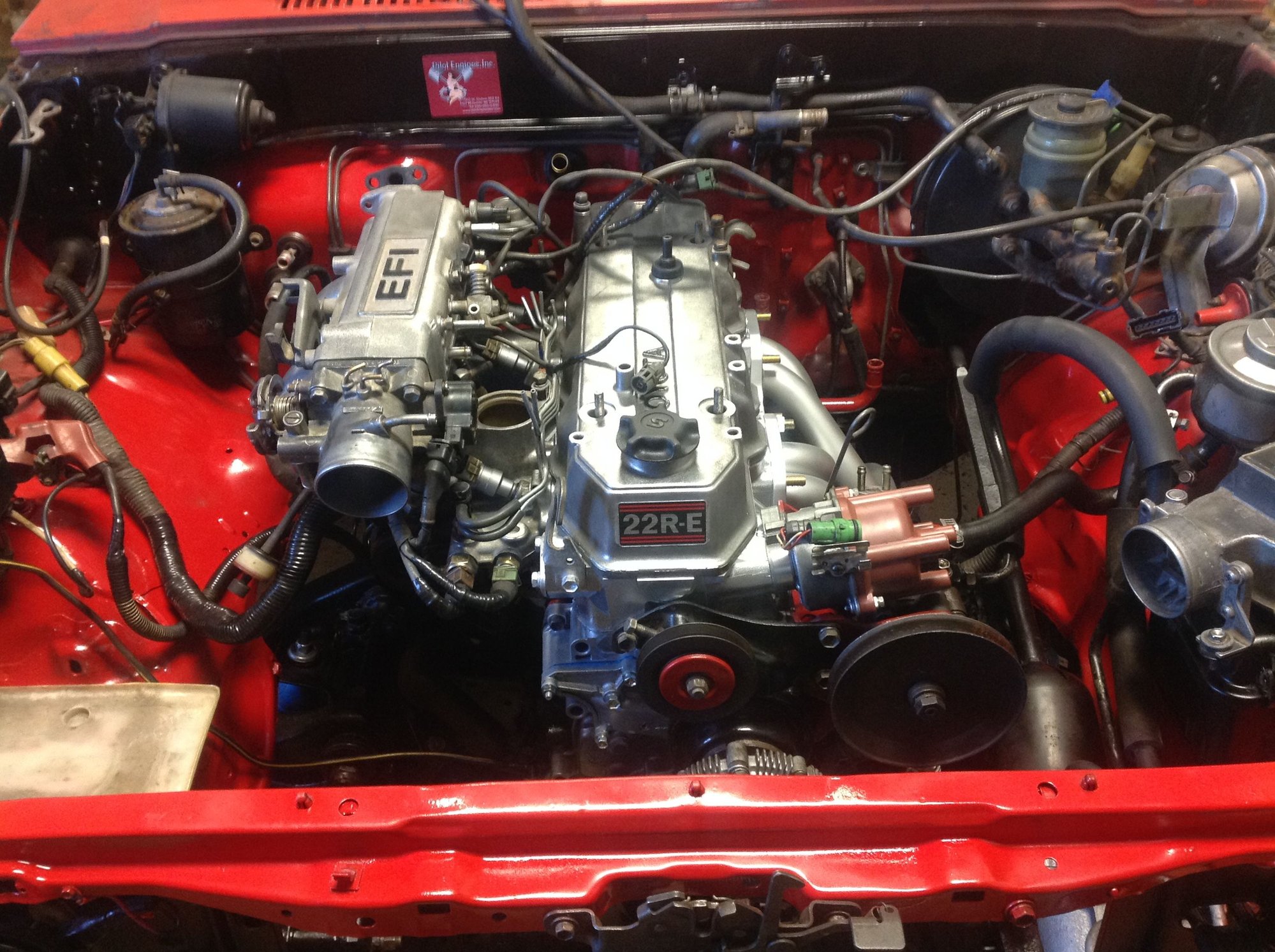

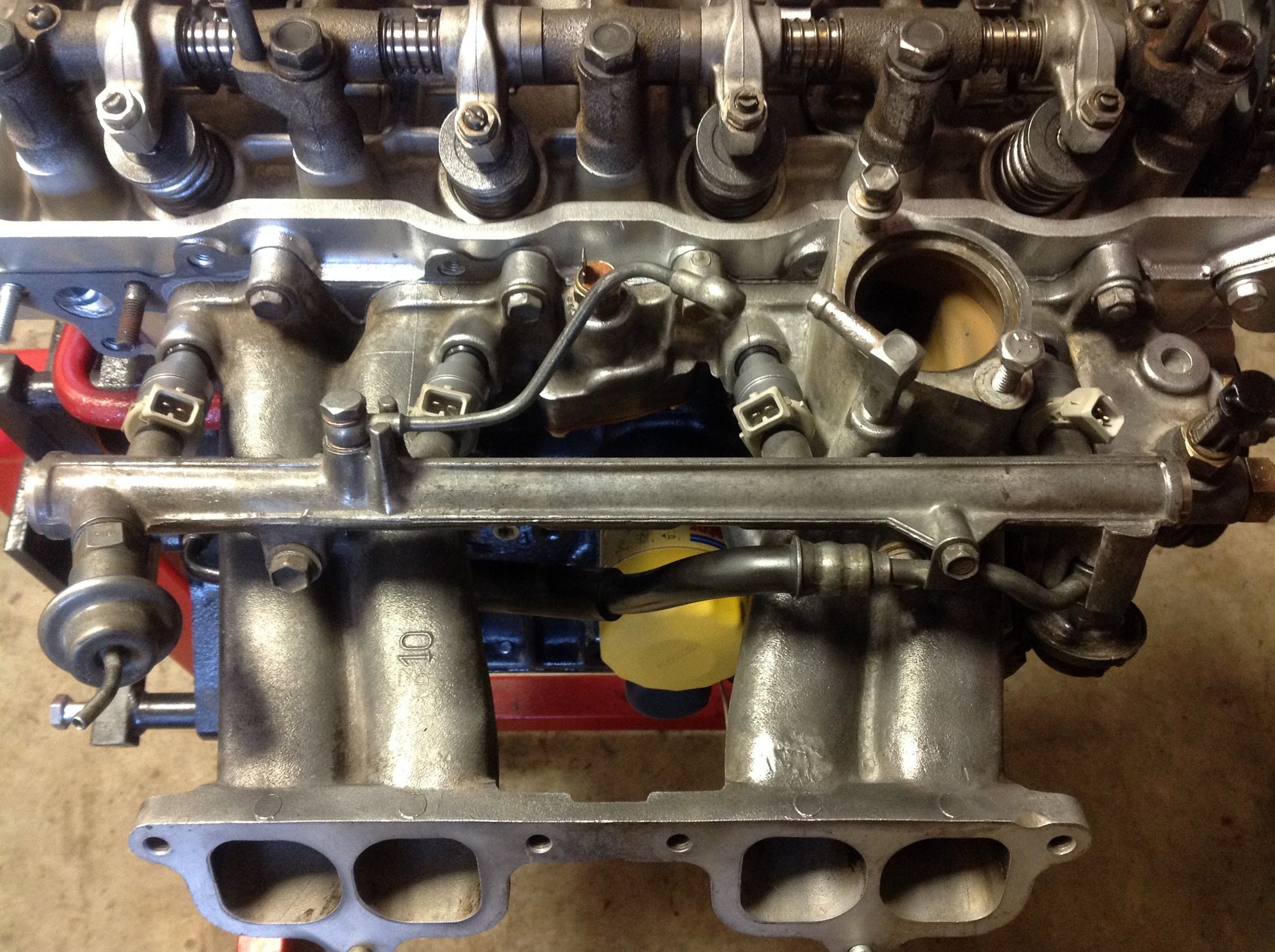

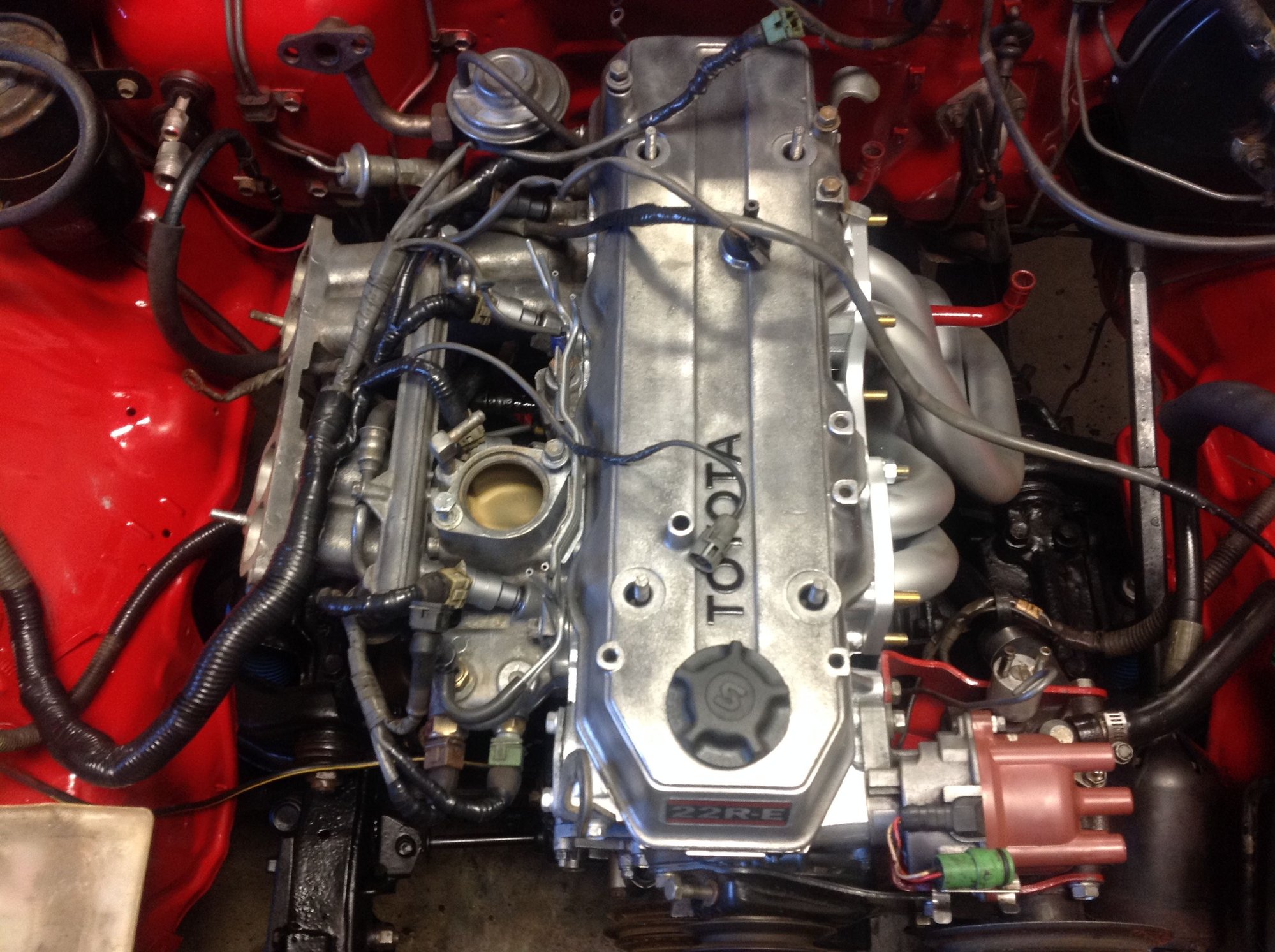

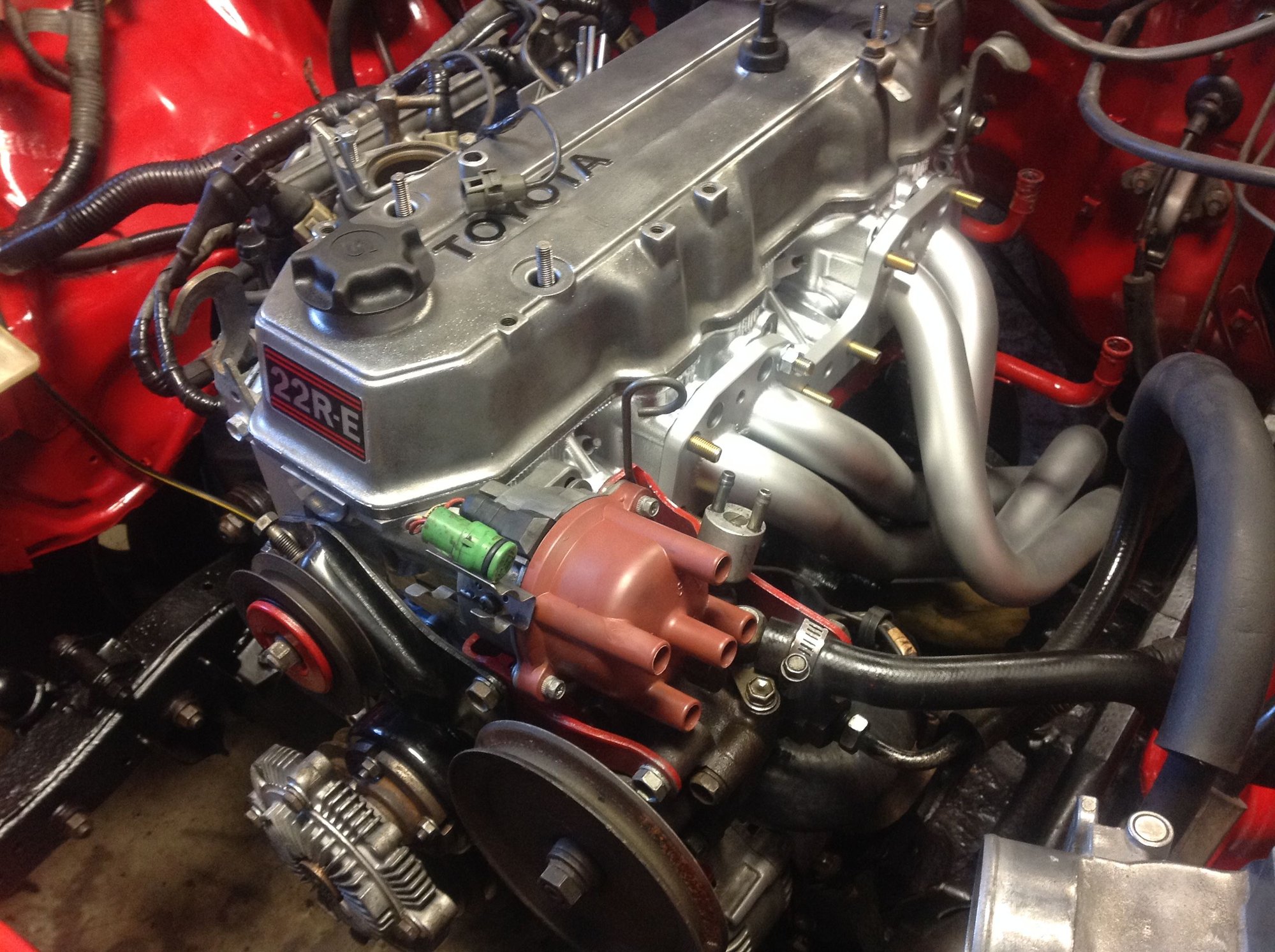

Some more work today:

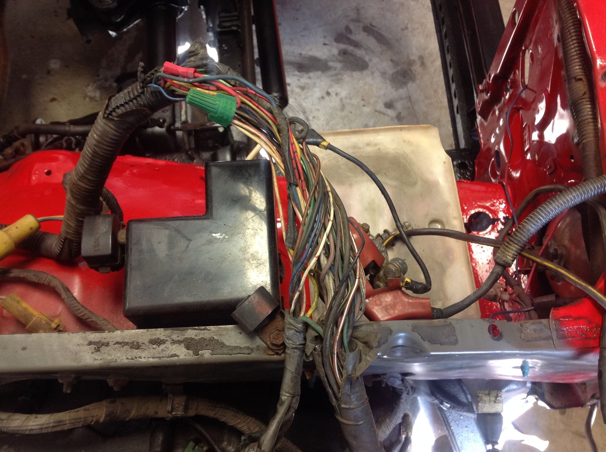

The upper intake isn't bolted up yet. I'll wait until I get the motor in and the wiring harness hooked up. Had to do some repair work to the wiring harness, too. Not sure what is going on- it's cut into and wires cut and swapped- it's ugly, but it was running fine before so I'm just going to clean it up, wrap it up and hope for the best. Saturday is the day the engine is going home!

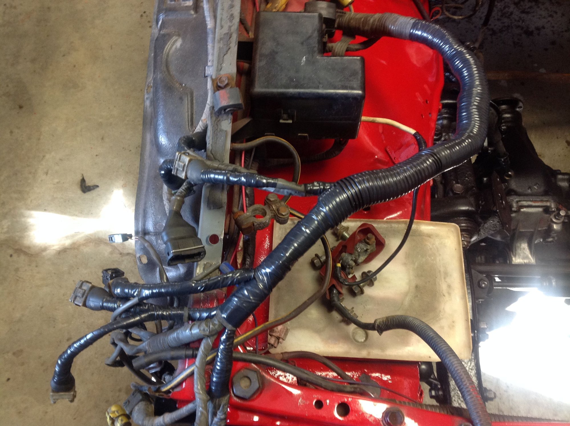

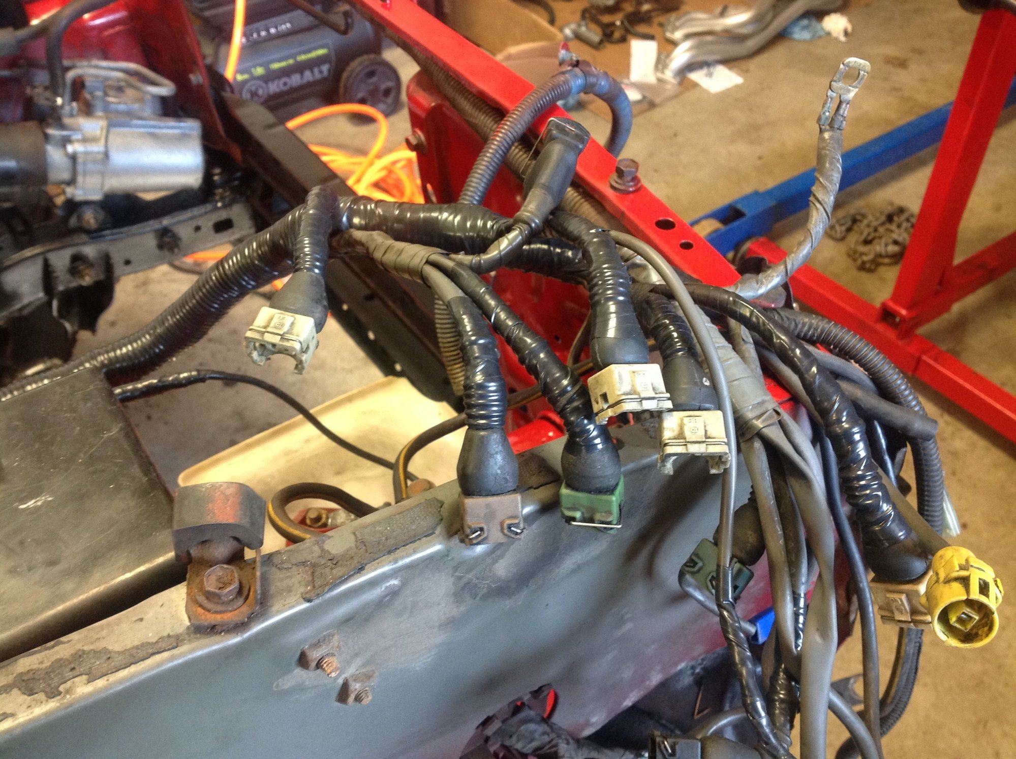

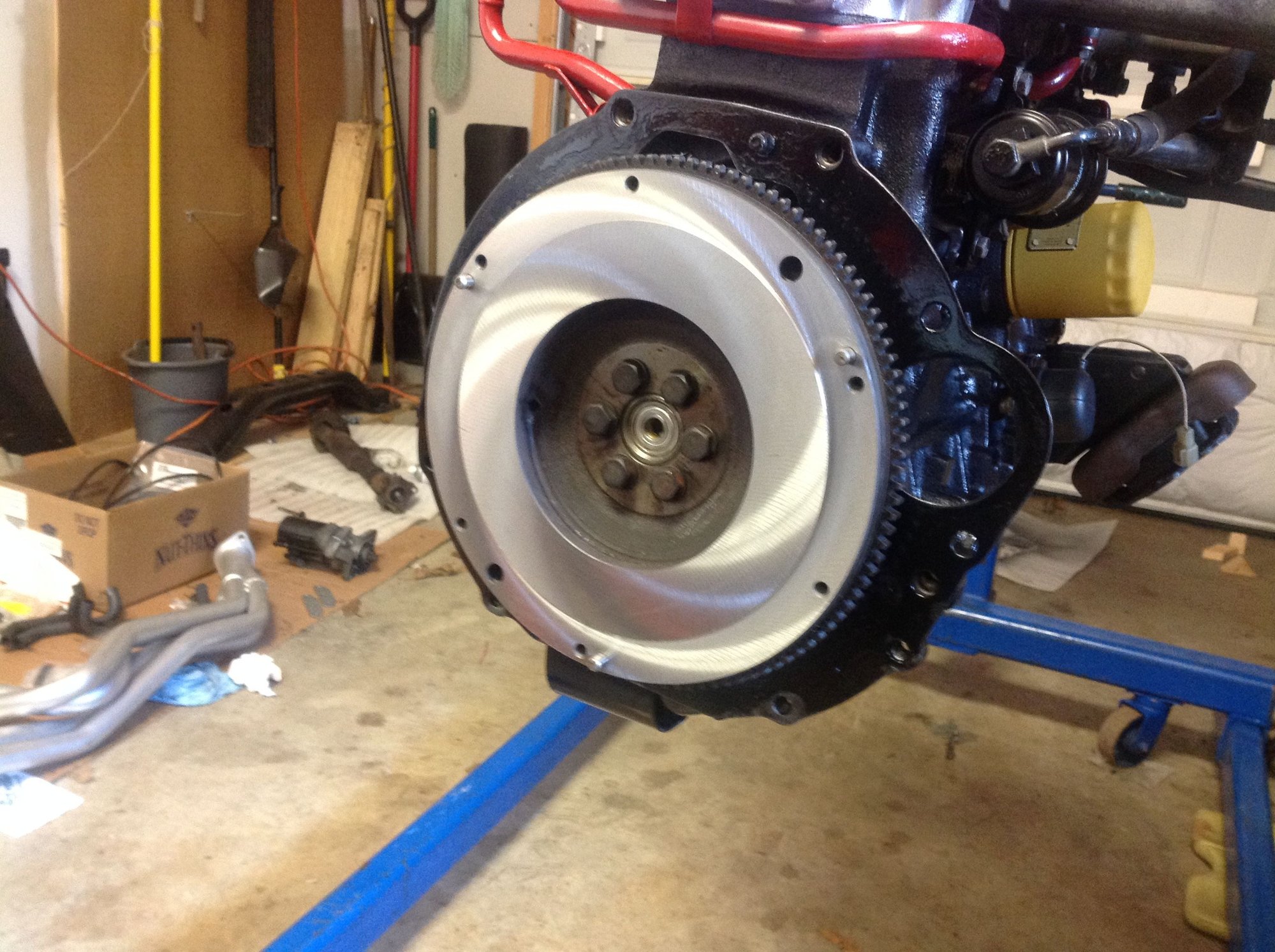

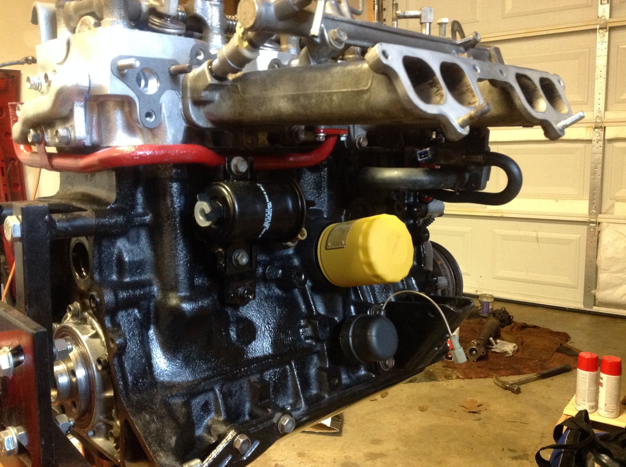

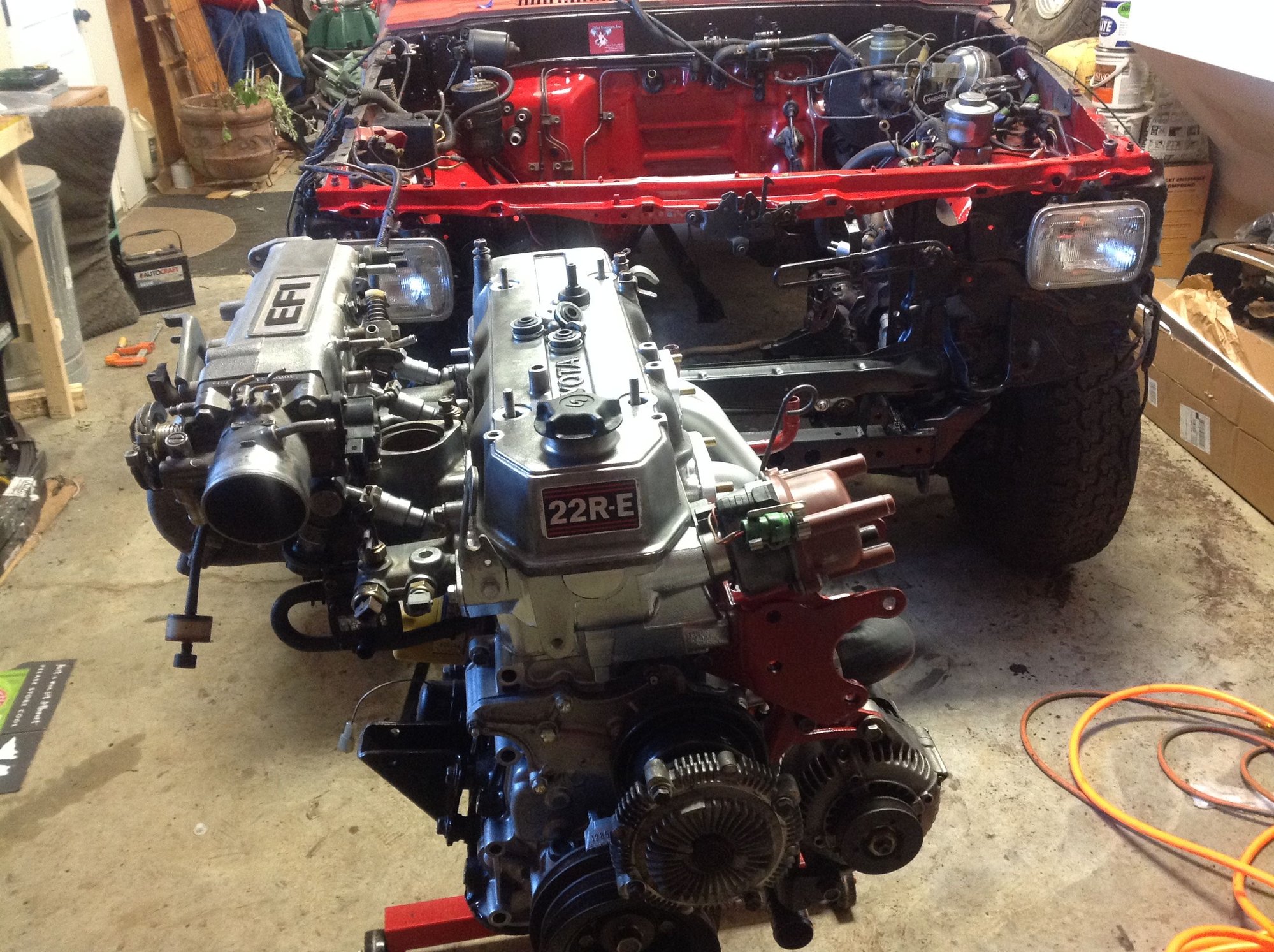

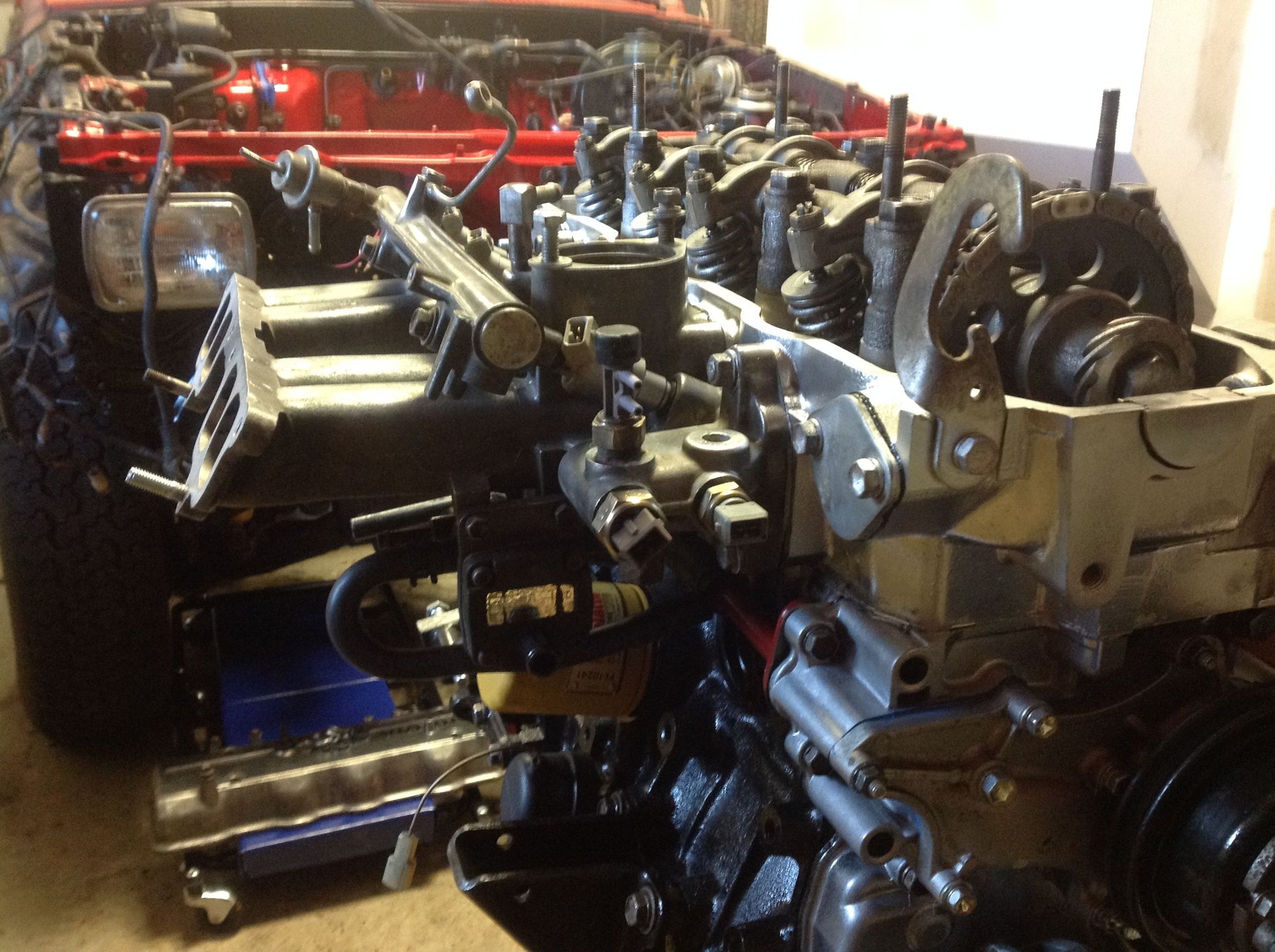

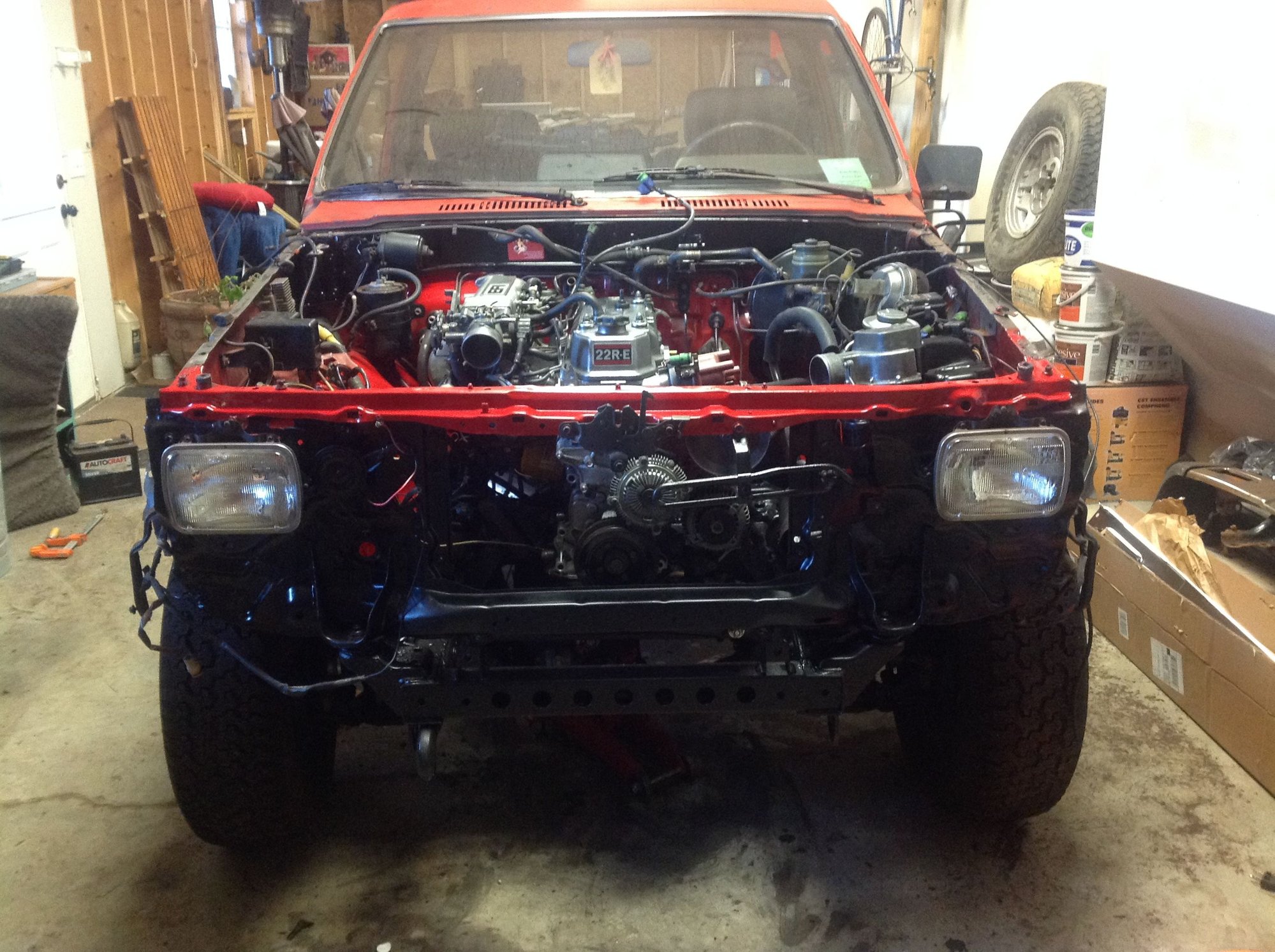

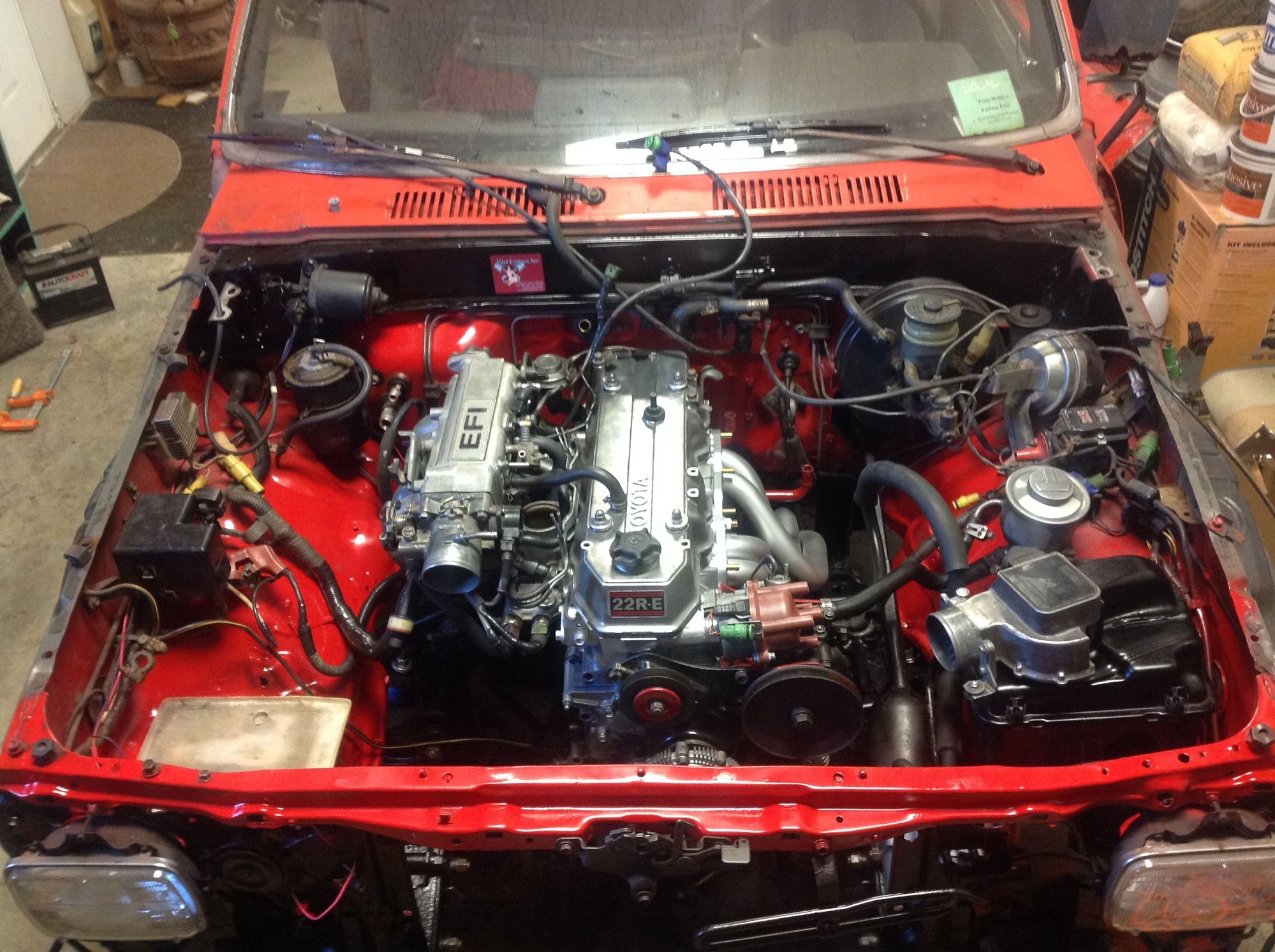

Thanks! I had your help today, too. Alexman Videos step by step clutch install; mostly part 2 of 3.
Started the day stopping by the rental shop to pick up a hoist and a 100,000 BTU kerosene heater:
What Arctic front?
I tackled the wiring harness first. Reconnected some of the cut wires (same way they were) with some wire nuts.
Some corrugated plastic and electrical tape:
And cleaned up the connectors a bit:
Freshly surfaced flywheel:
Loc-tite and 65 ft/lbs.
Then up:
And in!

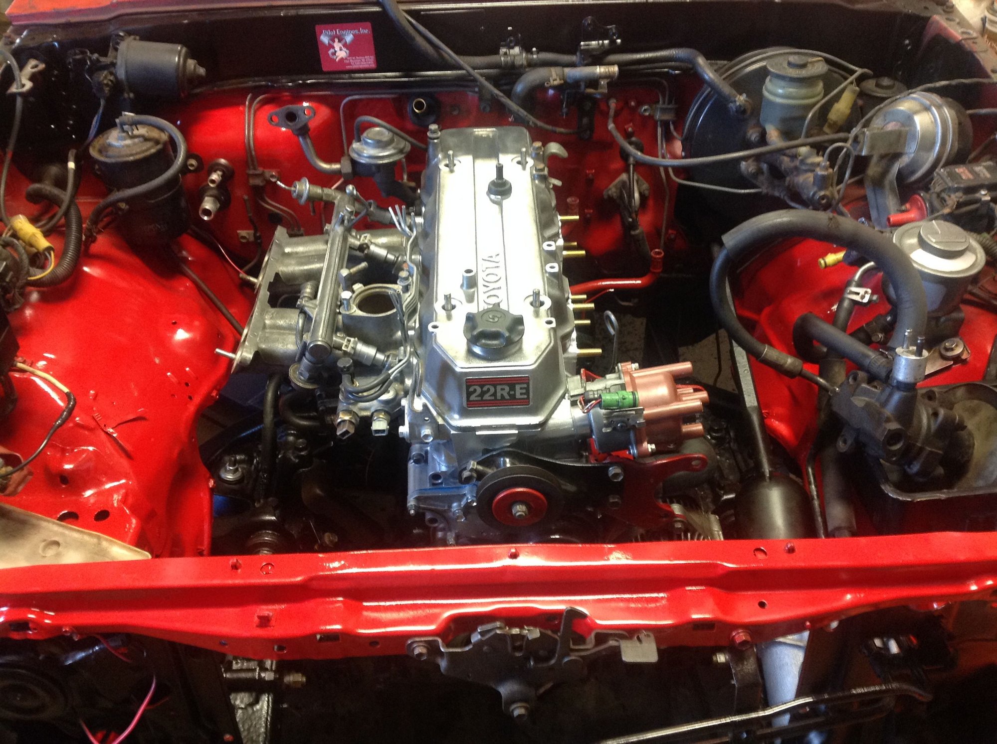

Got the fuel hooked up, started wiring in the harness:
The upper intake sealed and bolted up. Valve cover and all the water hoses, power steering pump, started on the vacuum lines:

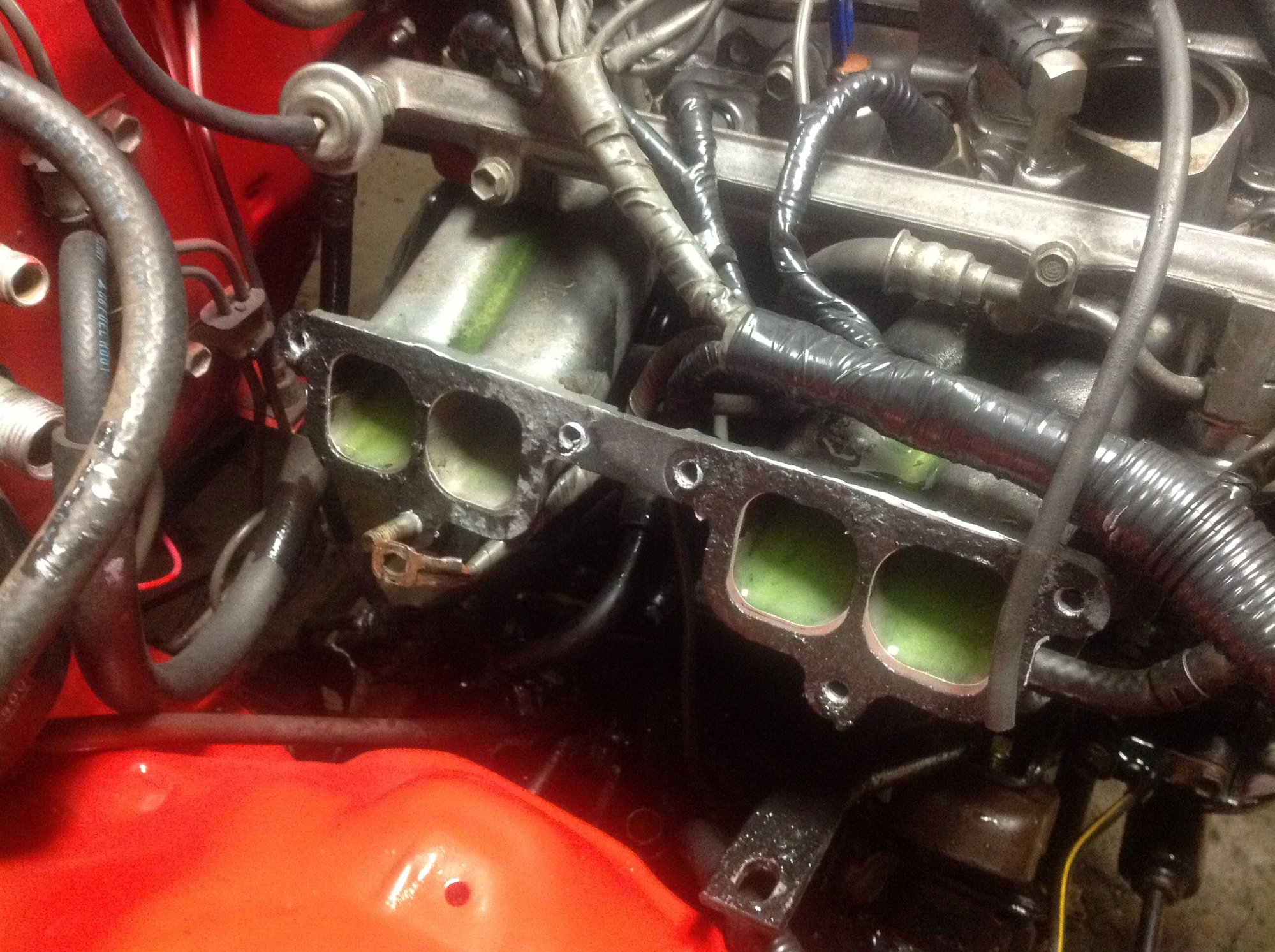

I'm going to throw up.
Not what you want to see.
Here's how I got here:
https://www.yotatech.com/forums/f116.../#post52309814
Mixed up a couple of lines and pumped coolant into my intake. Coolant pouring out the #3 cylinder when I removed the spark plug.
What do I do? Pull the motor back out? Will the cylinder rust after having water in there? Am I screwed? Ugh, like I said- I think I'm going to throw up.
Old Feb 17, 2016 | 03:01 PM
  #132
ladybugRC's Avatar
Joined: Feb 2012
Posts: 323
Likes: 20
From: Boone, North Carolina
Motor has to come back out. Clean the intake really well. Pull the oil pan and clean it out. What I'm worried about is my cylinder walls getting rust. What can I do? Right now I am not feeling confident enough to pull the head off the motor and all that- what good would that do anyway? Just let me see if there is rust?
Remember that comment I made about there being no substitute for experience? Well, this is what happens when you do this for the first time I guess.
Feeling very discouraged right now.
Old Feb 17, 2016 | 03:20 PM
  #133
92ehatch's Avatar
Joined: Jan 2015
Posts: 652
From: Hendersonville NC
I responded to your tech thread.
Get the coolant out with compressed air or a vacuum.
Clean intake and change oil.
Pull spark plugs and pour a little oil in and rotate engine by hand. Shouldn't rust. Do you plan to start the engine soon?
Antifreeze is a rust protector anyways
Old Feb 17, 2016 | 03:28 PM
  #134
SwVa_1stGen's Avatar
Joined: Jan 2016
Posts: 76
From: SWVA
Pull the plugs pour a little oil in each cylinder after cleaning the intake as best as you can, spray intake out with WD , stand back crank it over.
Put a little more in each cylinder repeat.
Shouldn't have to pull the engine back out
Old Feb 17, 2016 | 03:41 PM
  #135
arlindsay1992's Avatar
iTrader: (8)
Joined: May 2011
Posts: 1,517
Likes: 354
From: Southeast Virginia
Don't worry about rust. Coolant runs through the inside of the block and the inside of the block is just bare cast iron.
Just do what everyone else has already suggested. Drain the oil and pull the plugs. Spin the motor over to blast as much coolant out as you can. Blow compressed air through the plug holes and the intake ports, then spray WD40 in the cylinders. Put in some fresh oil and start her up. A few drops of coolant leftover in weird places won't do any harm. You might notice some steam right at startup but it's nothing to worry about.
Old Feb 17, 2016 | 04:00 PM
  #136
ladybugRC's Avatar
Joined: Feb 2012
Posts: 323
Likes: 20
Y'all are great, thanks. I'm home now, had a couple beers and some dinner and found a better outlook. I'm relieved to know this may not be as bad as I feared. Luckily, I hadn't put any oil in it yet.
My nice clean, new motor got its first antifreeze bath.
I pulled the plugs and blew quite a bit out before I left for the night. Got the upper intake off.
So I'll plan to really blow out each chamber with the air compressor, add a bit of oil to each one, turn the motor by hand a few times and hope to get this thing cranking over by the weekend. The shop still has my transmission- the only real wildcard in this situation. He says I should be able to get it Friday, but no promises.
I'll still clean out everything best I can. You guys don't think it'll harm it to sit for a few more days?
I made sure to correct the mistake that got me here.
If had been thinking more about the functions of the different systems as I was putting things back together, I would have caught this.

Which coolant line did you put on the intake

Old Feb 18, 2016 | 12:00 PM
  #140
ladybugRC's Avatar
Joined: Feb 2012
Posts: 323
Likes: 20

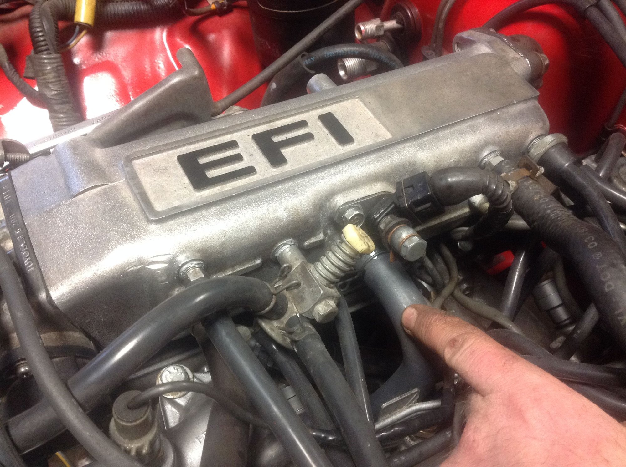

The line I'm pointing to here:
Was hooked to the elbow fitting that pops out of the bottom of the intake, just behind the coolant temp sensors.
The two fittings are right next to each other. As I said, if I'd been paying more attention to how the systems work instead of just getting the dang hoses on, I would have caught this. I'm feeling better about things today. I sure do appreciate everyone's encouragement.
