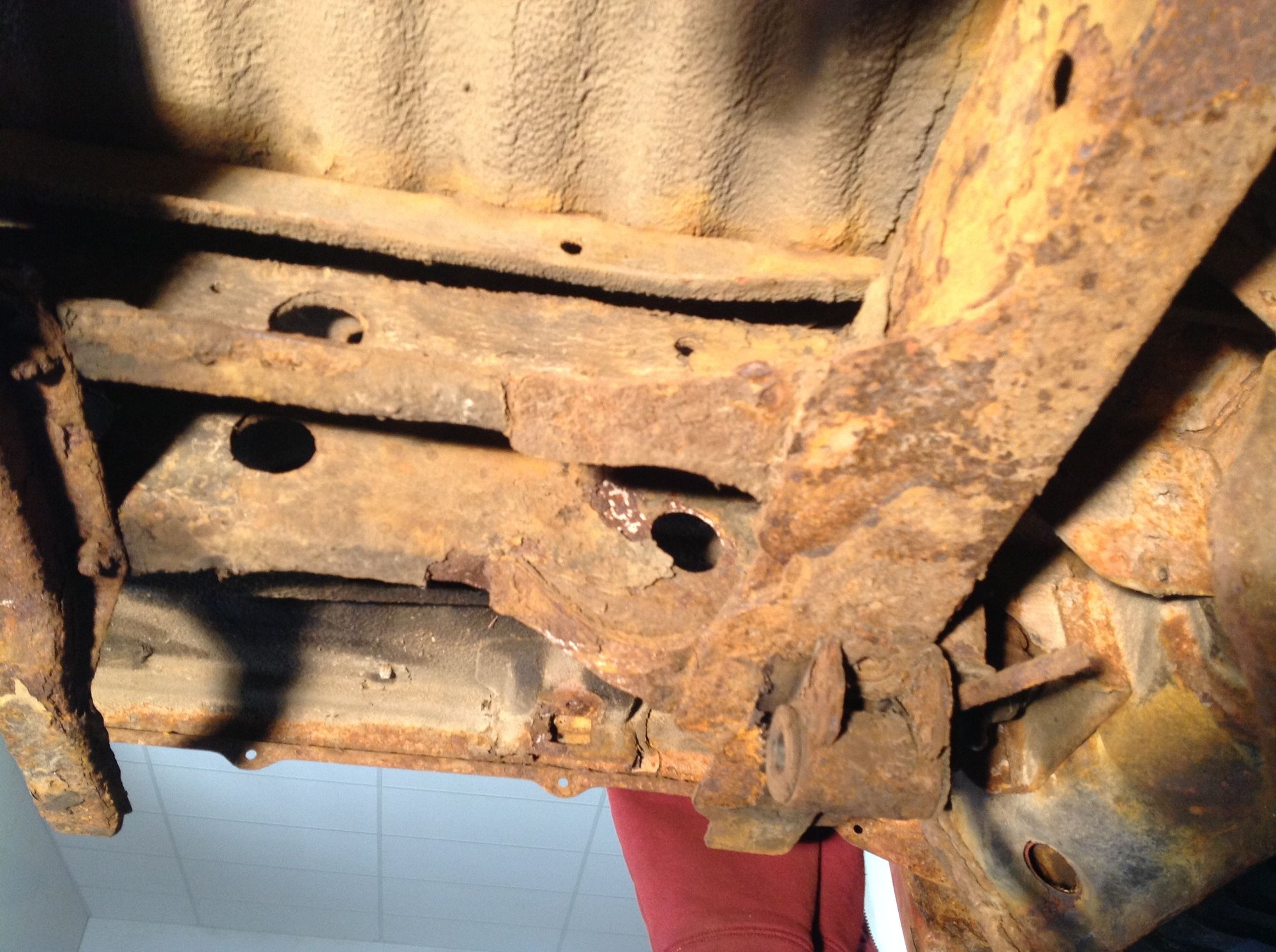

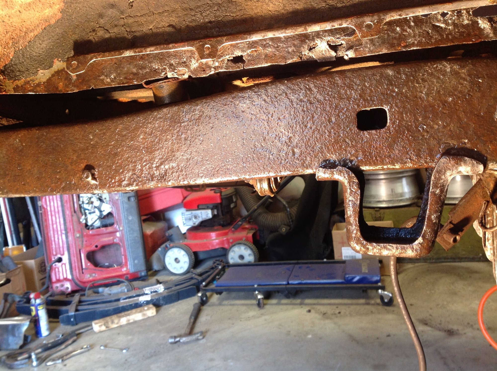

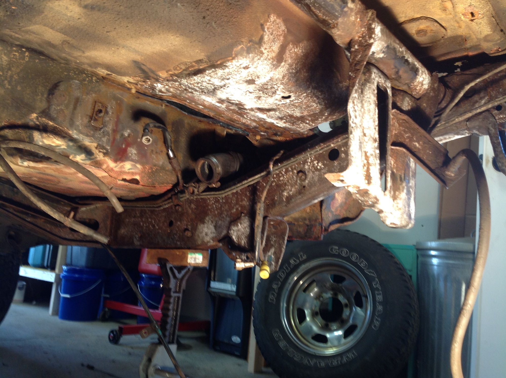

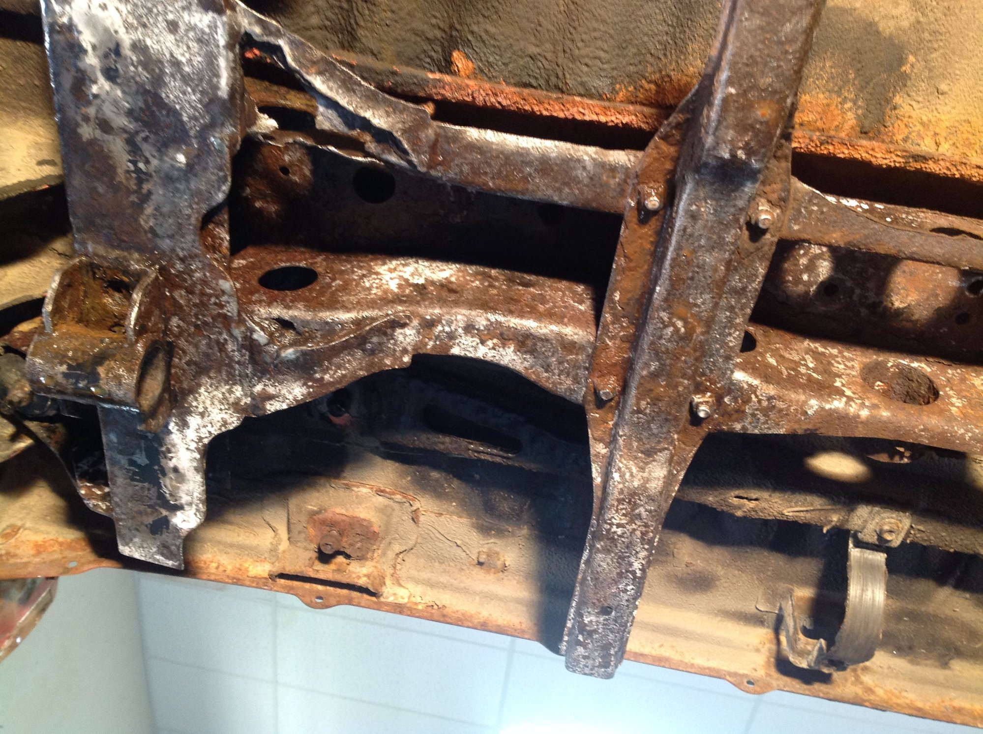

I got to do some more cleaning today. I also started applying the phosphoric acid- it's cleaning up pretty well:
It leaves that white residue as it dries and before painting with the POR I'll blast it all with the air compressor.
Here is a before and after- first picture is passenger side cleaned and treated with the phosphoric acid and the second picture is the driver side before I did any cleaning or rust removal:
A buddy of mine told me that rust on the driver side is always worse than the passenger side because it gets more salt. I asked how he figured and he said think about it- the salt truck goes down one side of the road and then comes back on the other, salting the middle of the road twice. Based on the rust under my truck he was absolutely right.
I also read about a trick to test if the rust has eaten all the way through the metal. Using a ball-peen hammer I tapped on the frame watching for give- if the small hammer can easily dent the metal its rotten through. I used this method to check the frame and all seems good. I was able to get to good metal with the heavy wire wheel on my angle grinder.
I guess what I'm getting at is this: I was really concerned about the structural integrity of the frame and after a few days working on it I feel much better. Now, there is plenty of rust to deal with, no doubt. The body has little spots all over the place but luckily most of it is very superficial and I'm not worried about the task of cleaning and painting it. Where needed I'll cut it out and patch.
As you all said, lots of work but I can handle it!

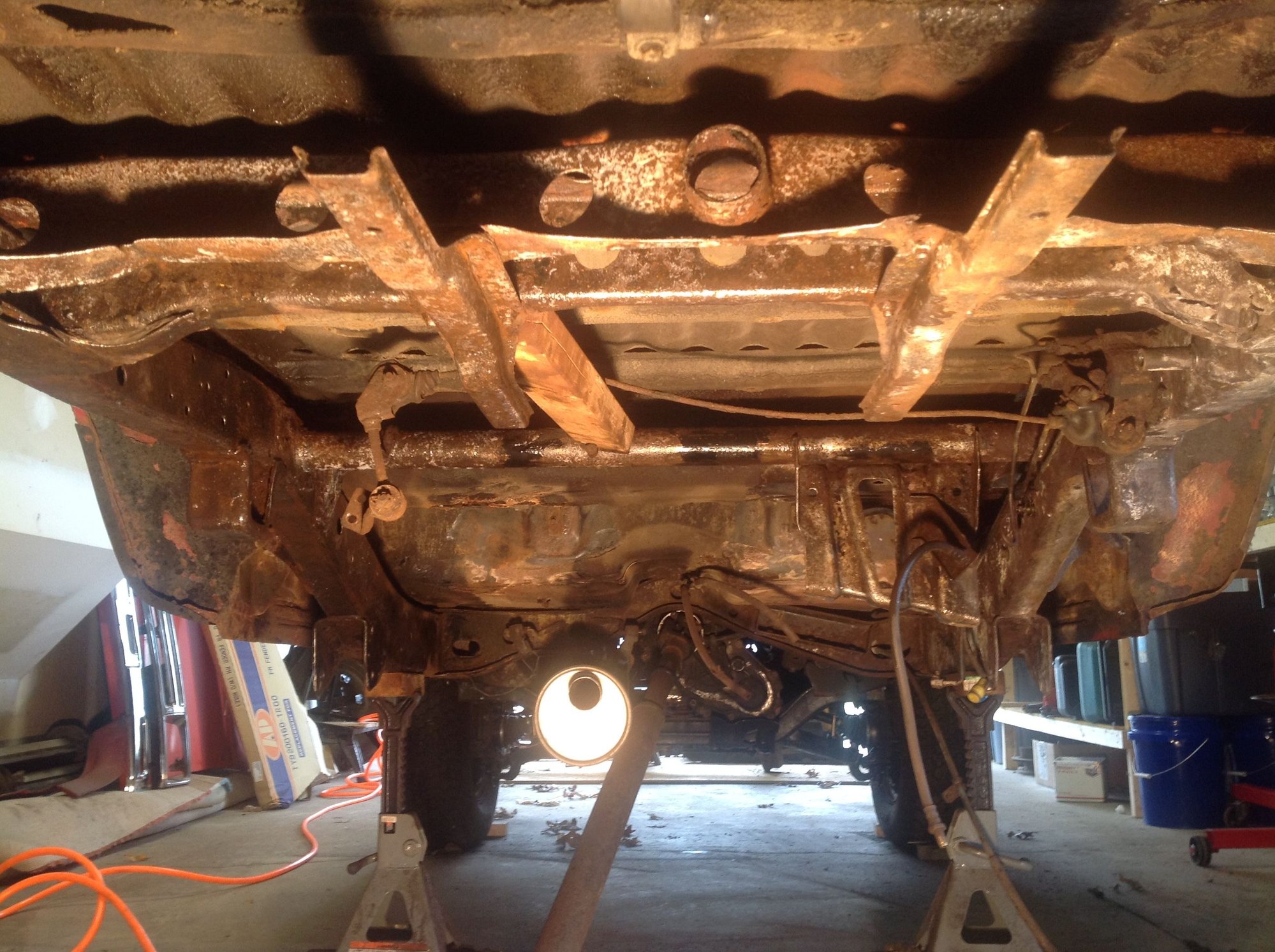

It's been a busy couple of weeks, not much time for the 4runner. But, I'm almost ready to POR the frame!

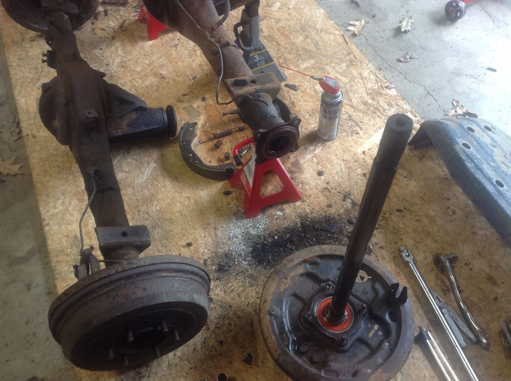

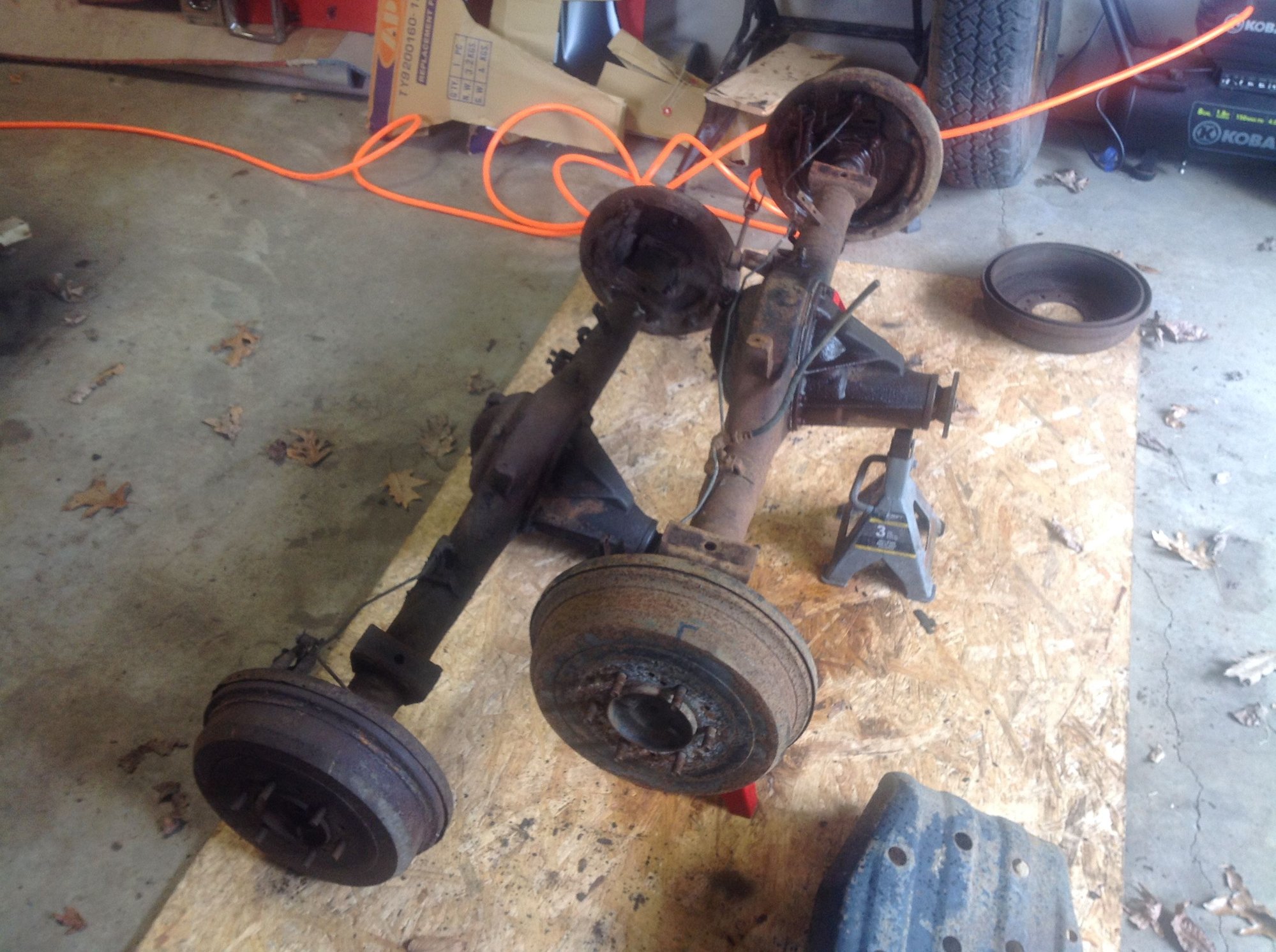

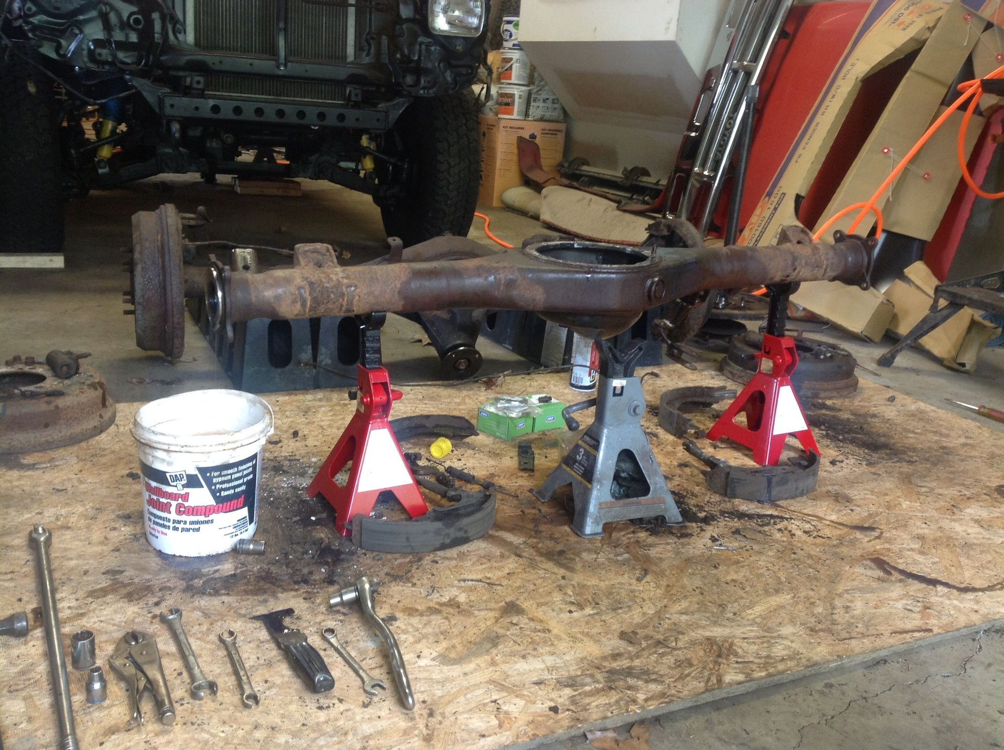

Last week I started assessing the needs of my rear end. Needless to say it is in bad shape- rust, wear, siezed up e-brake mechanism, not pretty.
So I found another rear end on Craigslist:
It is in MUCH better shape than mine. Today I started to tear it down. The bearings feel tight so I'm planning to just replace the seals, swap over all the brake hardware (which is pretty new on my old one), clean it up, paint it and it'll be ready to rock!

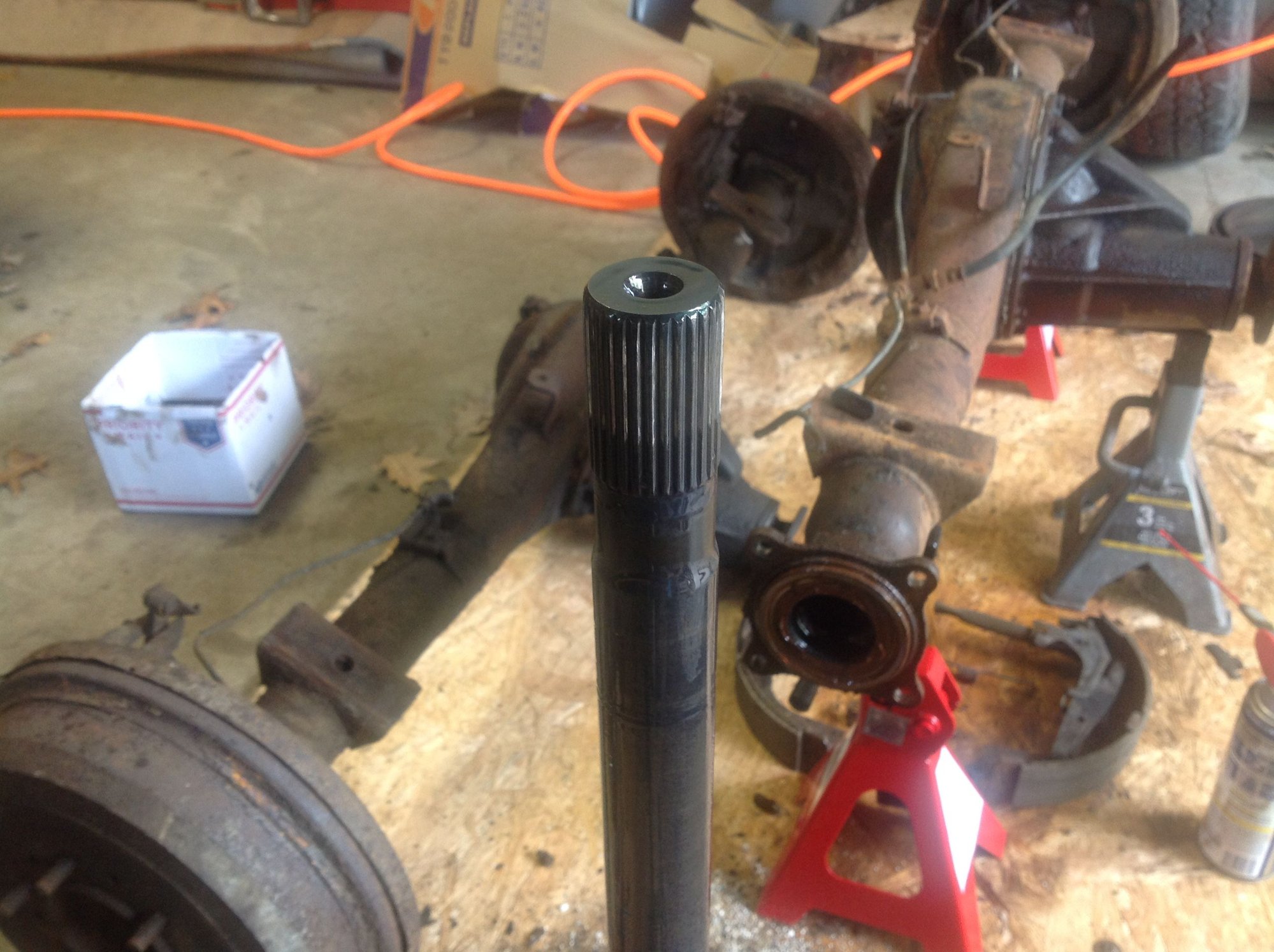

The axle looks to be in good shape:
Just have to keep at it...

Joe - I don't want to spend your money, but I would change those axle bearings while I had it all apart. That's my opinion, I understand if you don't do it and of course you can always come back to it later. If you want to do it yourself and if you have access to a press, I will loan you my tool to do the removal, but I'd have to ship it. And I know that ZUK would encourage you to pull that 3rd member and crank up the carrier bearing preload.
Soapbox off, still love watching and following along. You've undertaken a huge job and you've marched right along through it so far.

As always, thanks for your input Cory. And thank you very much for your kind offer to loan me tools. I keep going back and forth on whether or not to do the bearings. Other than cost, I don't have any reason not to do them. I think I'm working against my own impatience right now. The weather is nice and I want to be driving this thing so I am having to watch myself that I don't take any shortcuts. The 4x4 wire write up on bearings and seals (here) is really good and part of me figures I can always come back to it. Then again, I have it all pulled apart- wouldn't it feel good to just do it and know I'm riding with new bearings all the way around!?
Do you know off the top of your head what the carrier bearing preload should be? Is it recommended to increase the preload beyond factory specs or does it just loosen up over the years?
Thanks again for your encouragement- we will just have to see about the bearings...

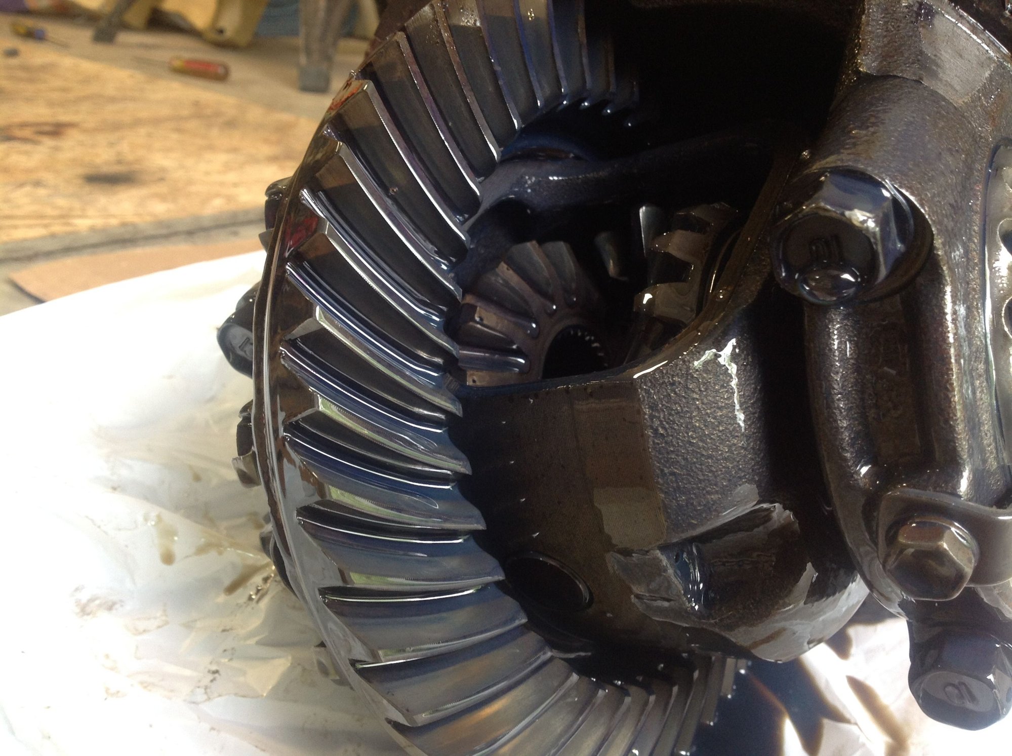

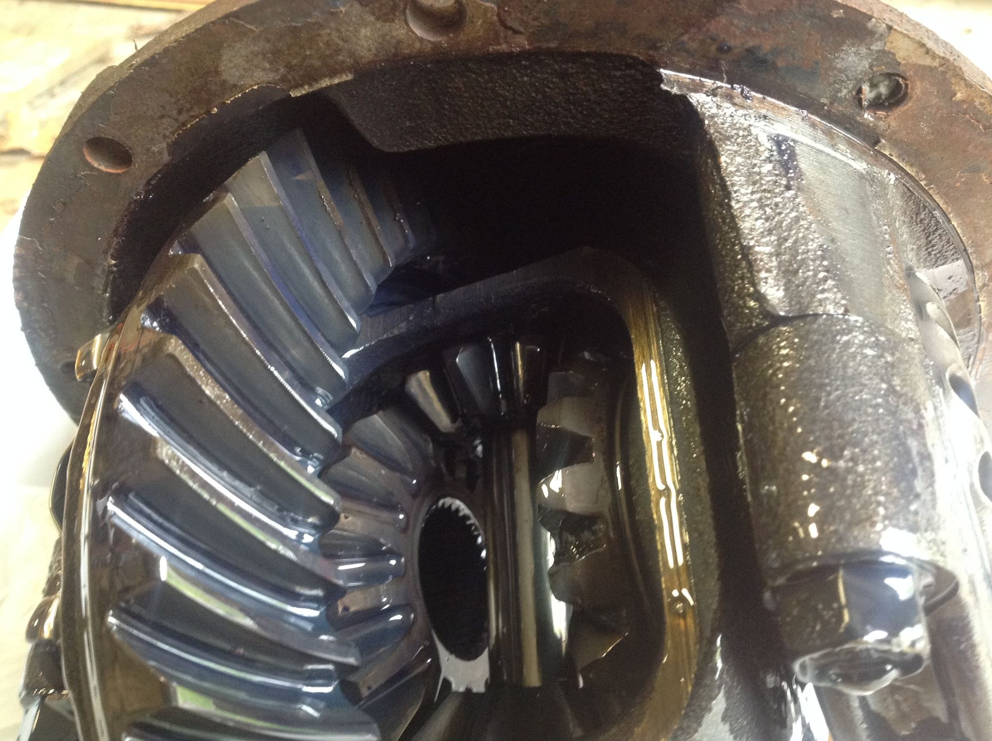

I sure do appreciate everyone's input. Thank you. At least one of my questions has solved itself: it'll get new bearings. I got the drivers side pulled apart this afternoon and the bearing is totally shot. So that's that.
Then I kept breaking it down:
This is the first time I've removed a third member. I spent a good deal of time looking at photos and reading on Zuk's website (thanks for the link, Cory) and from what I can tell my gears look to be in good shape. I don't see any signs of wear. What do you guys think?
May be hard to tell in photos. It feels tight, none of the gears wobble or feel loose.
So now I will read and study and try to make an informed decision.

Joe - If you have a dial indicator you can check the backlash pretty easy and adjust if necessary without doing any teardown or anything. Also, as ZUK suggests, if you are happy with the backlash you can then turn each adjuster the same amount to crank up the carrier bearing preload. Without tearing things apart, I think that's pretty much all you can do. I guess you can make sure the pinion has no in/out play as well. You can make a axle bearing removal tool with your old axle tube if you cut it. Might be different where you live, but a lot of shops here did not have the right tool to press off the axle bearings, so I ended up buying the tool on eBay. One shop said they had the tool, but they wanted too much money to do the job, more than the cost of the tool.
