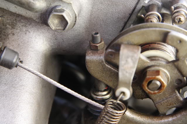

I'm thinking your sticking idle may be caused by the dashpot. Pretty common on the 22re. Simplest way to find out is to just adjust it out until the throttle linkage stop plate doesn't depress the sprung pin.

Yesterday afternoon I finally got time to look into it again- and you're right! The dashpot is functioning correctly, but it was set too high and preventing the throttle linkage from returning all the way. When I set the TPS the throttle body was off the motor so the dashpot was not a factor. Yesterday I wasn't getting the right reading on the TPS at idle and when I went to put the feeler gauge on the stop plate I realized that it was open about 1/8". I set the stop on the dashpot so that it still engages but will let the throttle linkage fully close and BAM! Had to back the idle set screw way out to get it to idle down. Set the idle to about 750 and next I would like to time the motor again with the TPS actually reading idle. Look for the simplest solution first, right!?

My idle was intermittently stuck high for years because of that dashpot. I understand it serves a purpose (prevents sudden air cut if you let off the throttle too quick), but I haven't noticed much difference without it.
