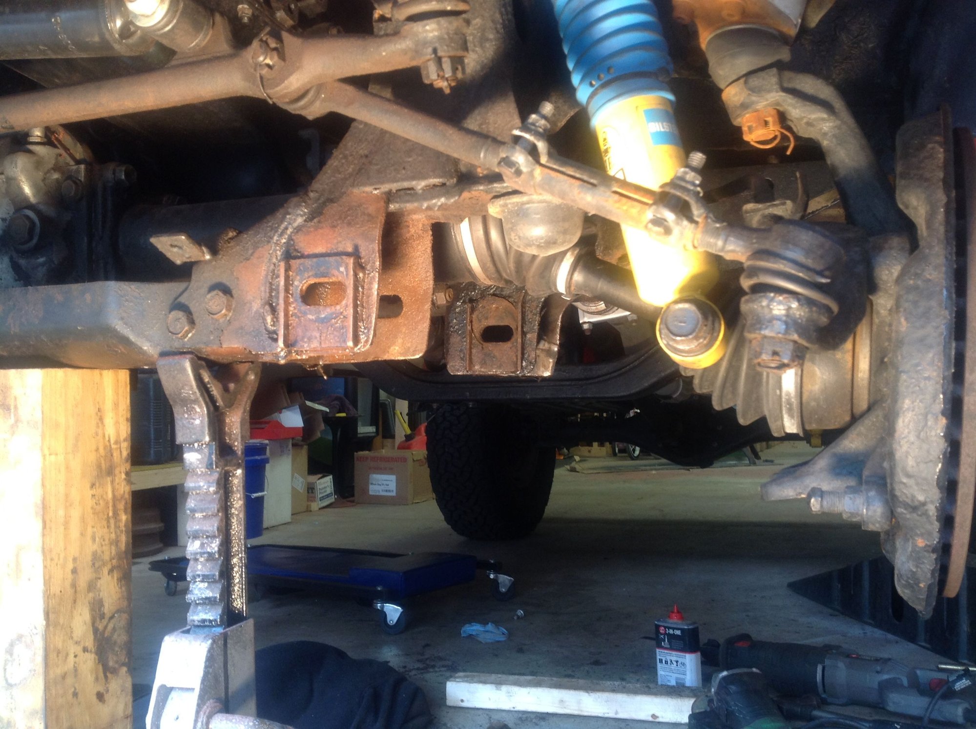

Picked up where I left off the other day, giving up on trying to turn those cam bolts and set to cutting them out. First the sway bar linkage, lower ball joint and shock were all unbolted:
The control arm then just swung down (with some effort) and I was able to get the saws all blade in there. If anyone reading this is getting ready to do this do yourself a favor and buy some good quality blades. In total I used five Lenox carbide blades to cut two bolts out. It wasn't too bad sitting and cutting. Use lots of oil and try to get the blade between the frame and the bushing- less to cut.
That got me here:

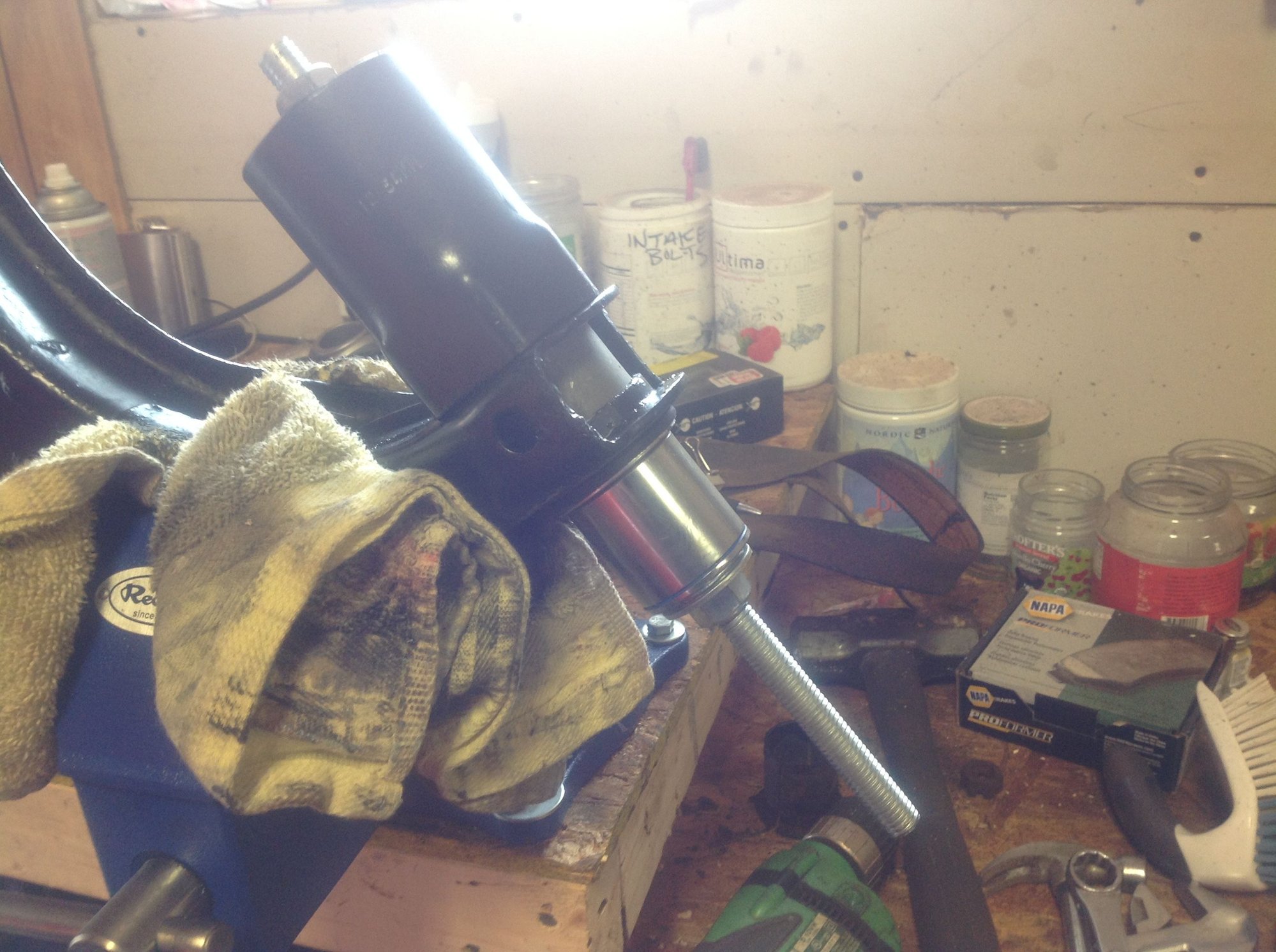

I knew I was going to have a hard time getting the outer bushing sleeves out of the control arms I bought. I used the saws all to cut relief cuts in the sleeve:
I found a thread here on Yotatech showing a homemade press for just this purpose. I picked up some 1/2" threaded stock and some nuts and washers and voila!
With some 3 in 1 and a second use for that 54mm socket I bought it popped the old ones out and the new ones in!

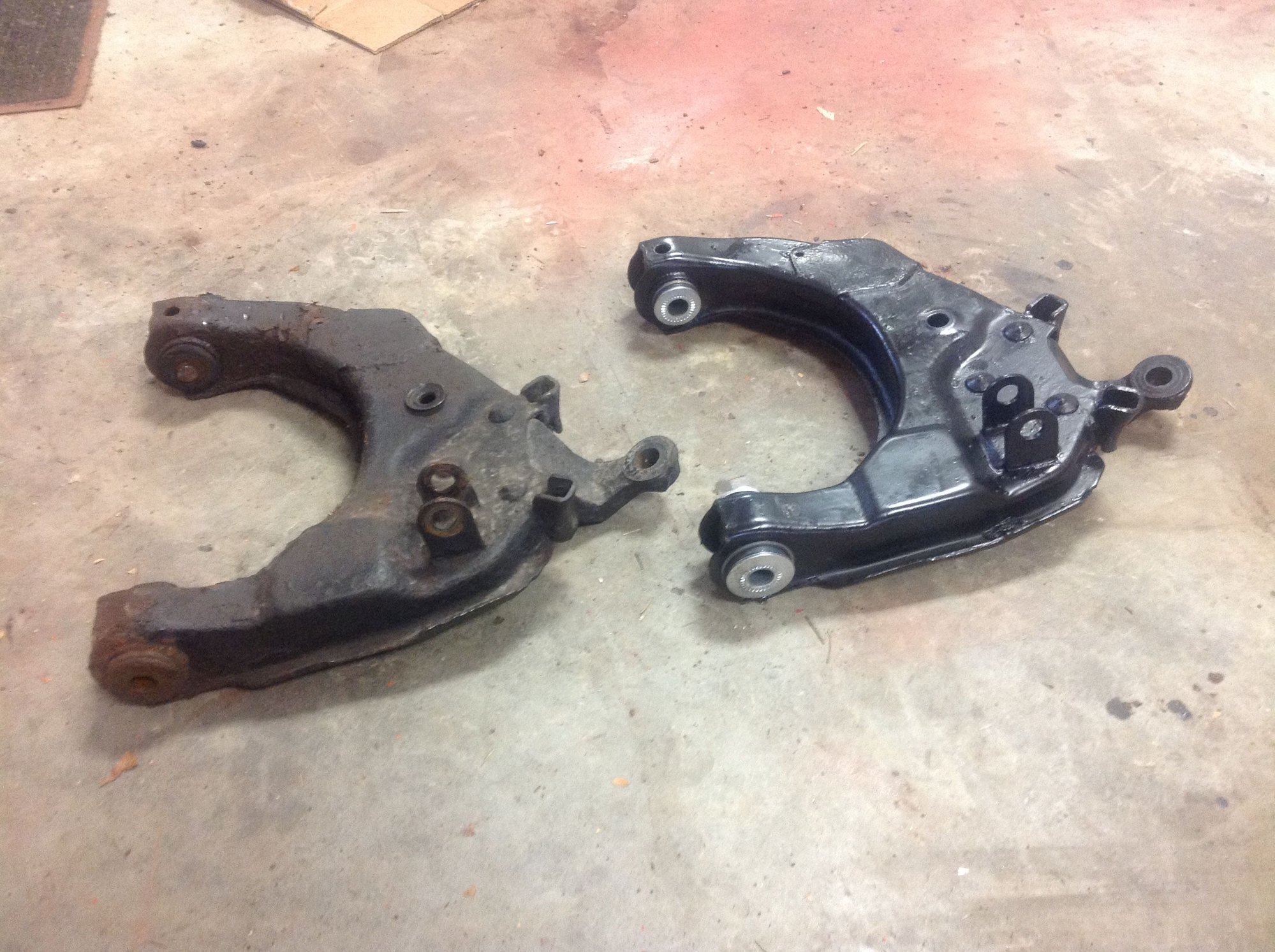

Here's a new and old lower control arm picture:
