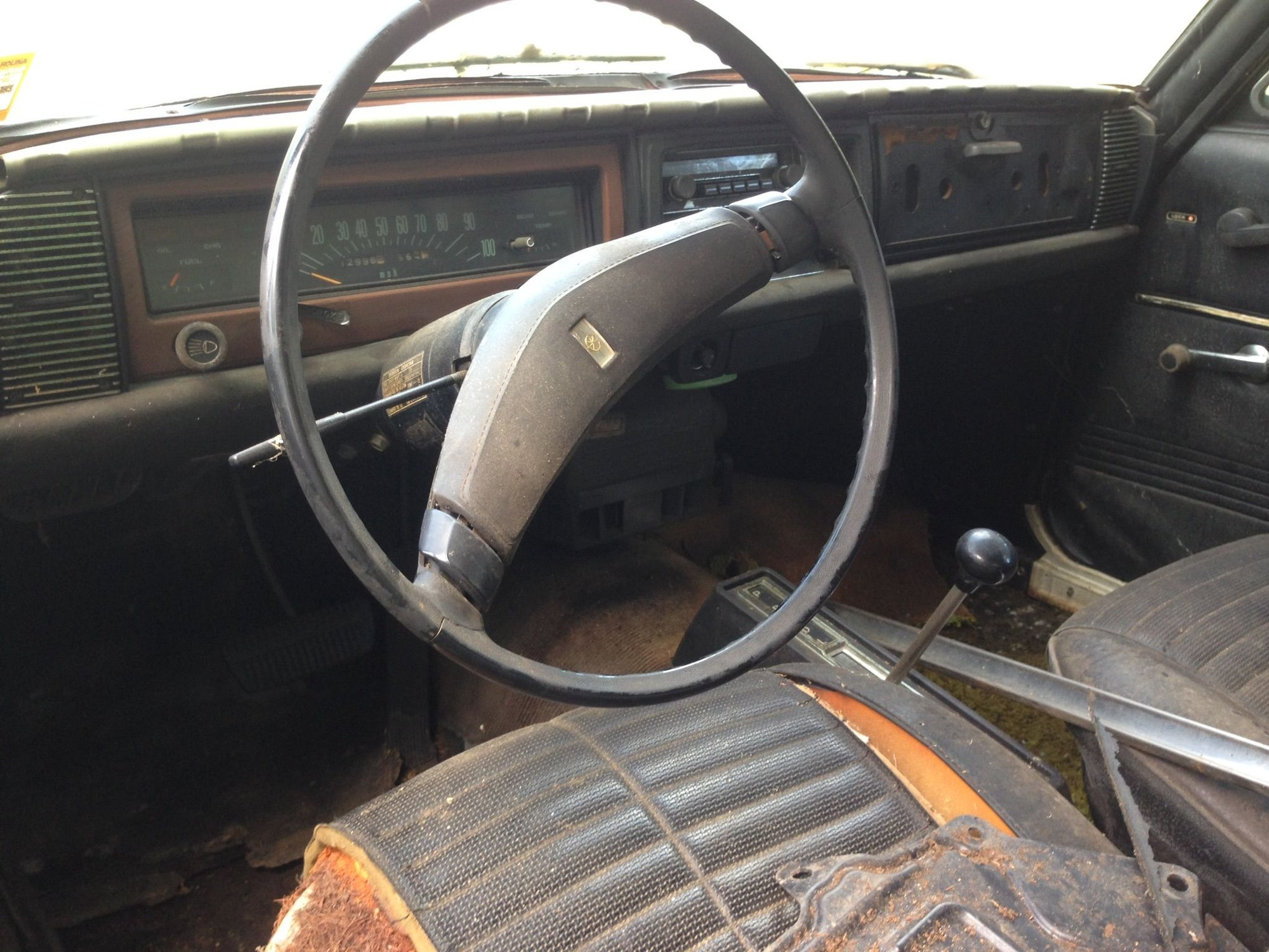

I have another project...
Even before I got the 4Runner back on the road I found myself trolling Craigslist for old Toyotas. When I was a kid I loved the early Toyota models and last week I got one:
One day back in 1987, the same year my beloved 4Runner was manufactured, someone parked a 1969 Corona in a barn just outside of Greenville, South Carolina and there it sat until this summer. After 30 years of sitting I took it back on the road (on a trailer of course) and brought it to its new home in Boone.
It is a 1969 Toyota Corona RT-52 two-door coupe with the 4 cylinder 3R-C motor, Autoglide automatic transmission and either 212K or 112K miles on the clock, likely the former. It has a good deal of body rust but the undercarriage is oh-so clean! It is complete! Every badge, every piece of trim, all the glass, everything is there. It will need to be brought back from the dead, for sure, but after tackling the 4Runner I am feeling up to the challenge.
Here are some pictures:
And the engine:
