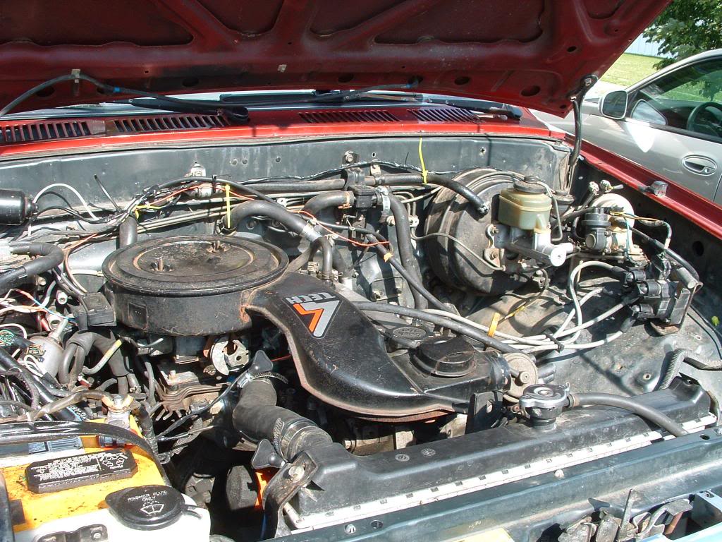

i found an 86 22r with 107000 miles on it that had even compression across all cylinders and ran decent when gas was pored thru the carb (my pick a part drains all gas from the tanks and separates them)
new radiator to the driveshaft and everything in between $322 at the pick a part (4/27/12)

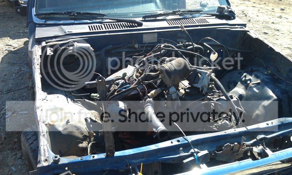

she was tired.. 210k on the odometer running 60 psi in 2 cylinders (7/12/12)
of course the empty bay shot no build is complete without one.. dont forget to take out the auto shifter horse shoe looking thing it will hang you up and cause some unneeded cursing

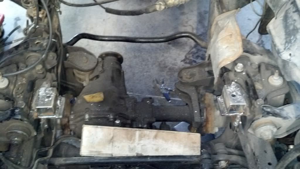

first fitting of the 22r and w46.. i read many times that the mounts didnt line up but couldnt get a clear answer as to why or how so here it is FWIW i had to move mine about 2 inches forward and 1 inch down this allowed my transmission shifter to line up, the engine to clear the firewall (albeit about a half inch back from stock from the looks of it) and the factory shortbed driveshaft to fit and bolt up to my rear end.
here is how i made my engine mount adapter plates. its 3/16 plate tacked on, drivetrain sat in and positioned then traced around the mounts with a sharpie simple and effective .. now before you say it i realize this might not work with 4wd but i dont have that to work with yet. this is just what worked for me.
they are painted now but you get the point.. not pretty but they work great.

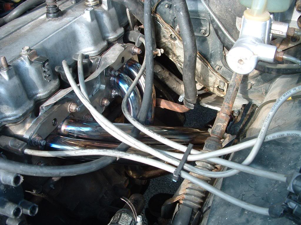

this is my super cheap header that i had to send back once because the flange was warped and the whole thing was scratched up

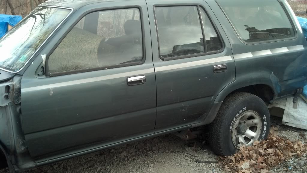

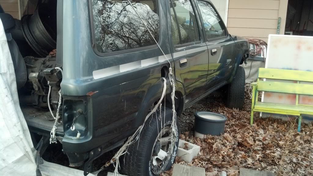

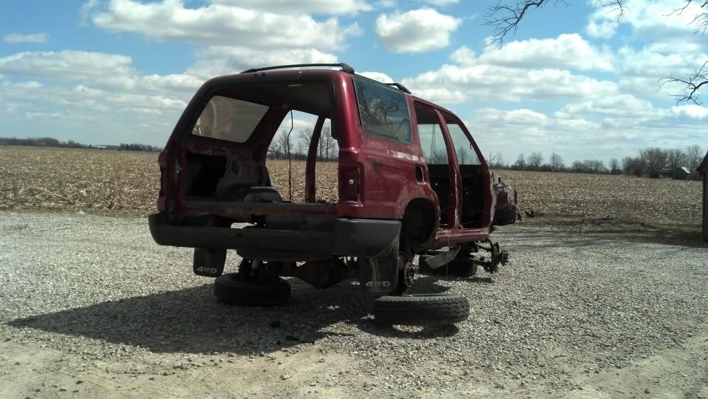

it was pretty much gutted but was from california and had never seen an ohio winter road.

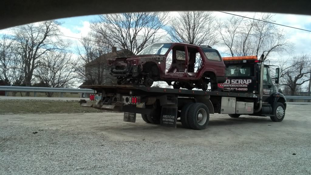

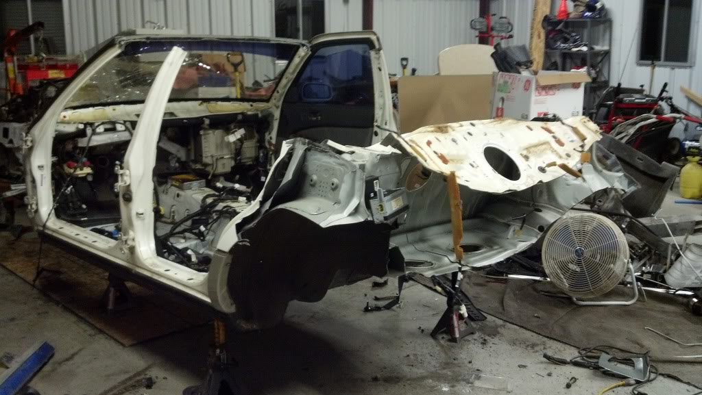

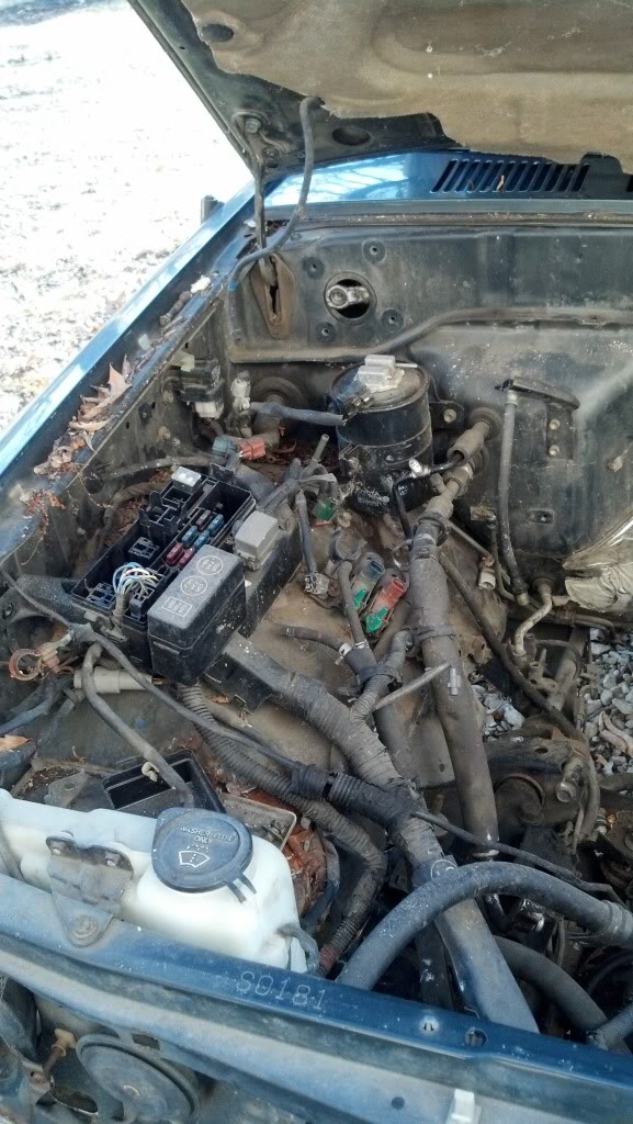

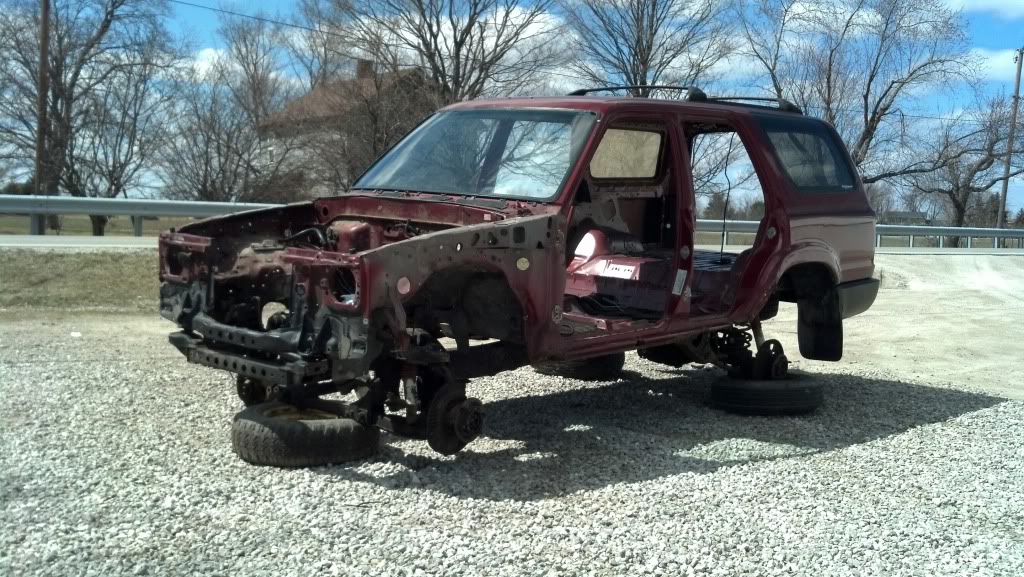

i love my truck and after swapping, rebuilding, and r&r my motor and trans a few 5 times it was a welcome project. the deal included the rebuilt r150 that was originally in it, a w56 with case, a 22re 2 sets of rims and tires and various other parts for $700 plus tow.
now to all you people from out west this seams ridiculous but here it is a cherry find.
so in 7 days i completely gutted all usable items from my 4runner and scrapped it..

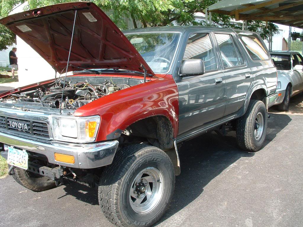

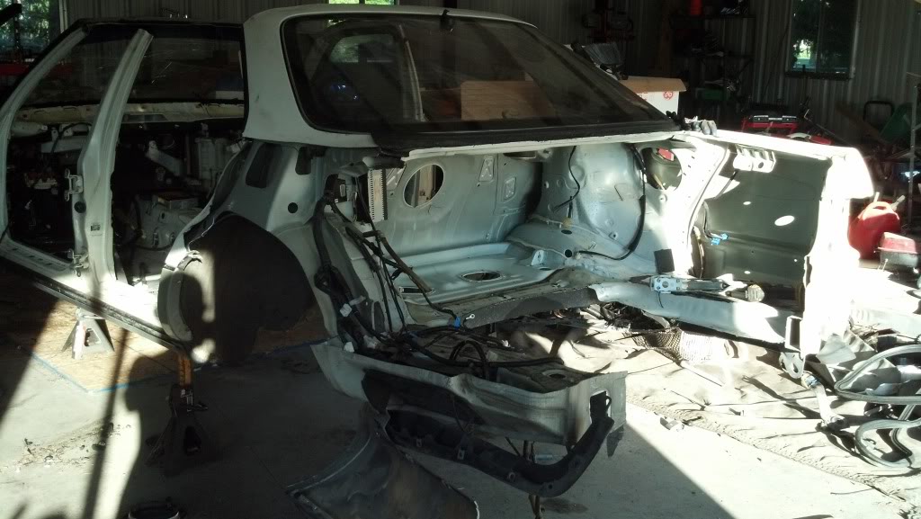

here she is before the body lift
less than a year dealing with the anemic power of the 22r even with a 270 cam, header, and megasquirt... it was time to move on.
after reading every swap and build on several forums here and abroad i came across this (again on craigslist)

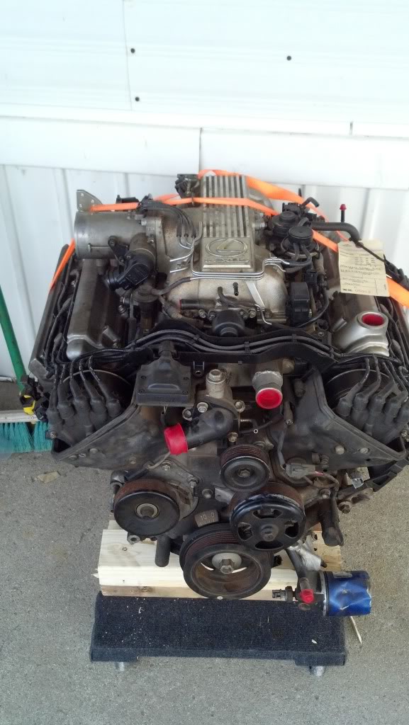

now in retrospect i know this is an engine from a 93 sc400 not the ls400 that i needed although i was told it was a 96 ls400 (do your research before buying!!)
after much research on needed accessories, harness,ecu, and transmission options i found this motor to me a bit of a money pit.
this than led me to this:

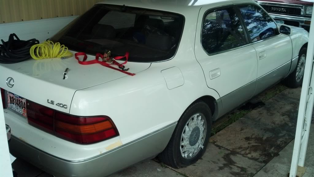

Yes craigslist again lol!!
$500 for a whole running driving lexus ls400... as usual some people made a point to show their concern for tearing apart 2 perfectly fine running vehicles

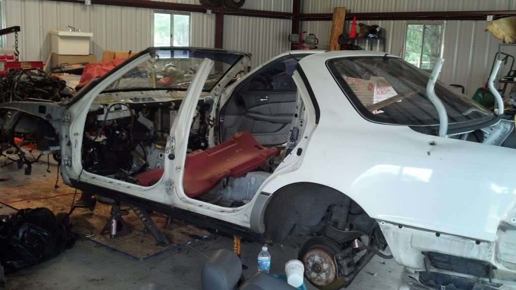

not much to say about tearing down the lex but here is some pics

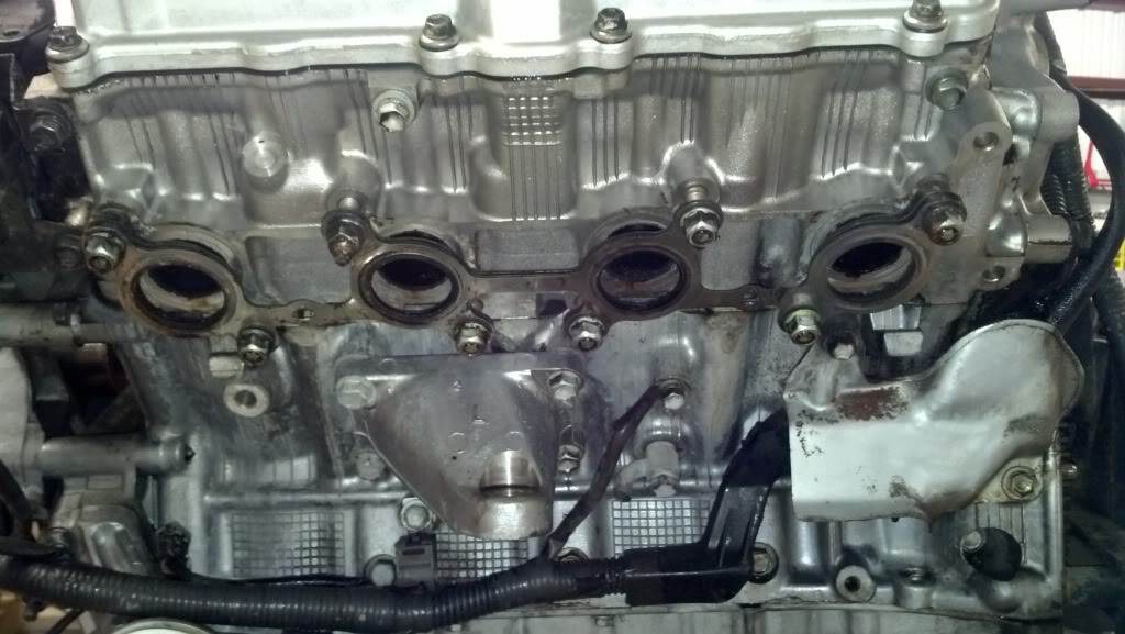

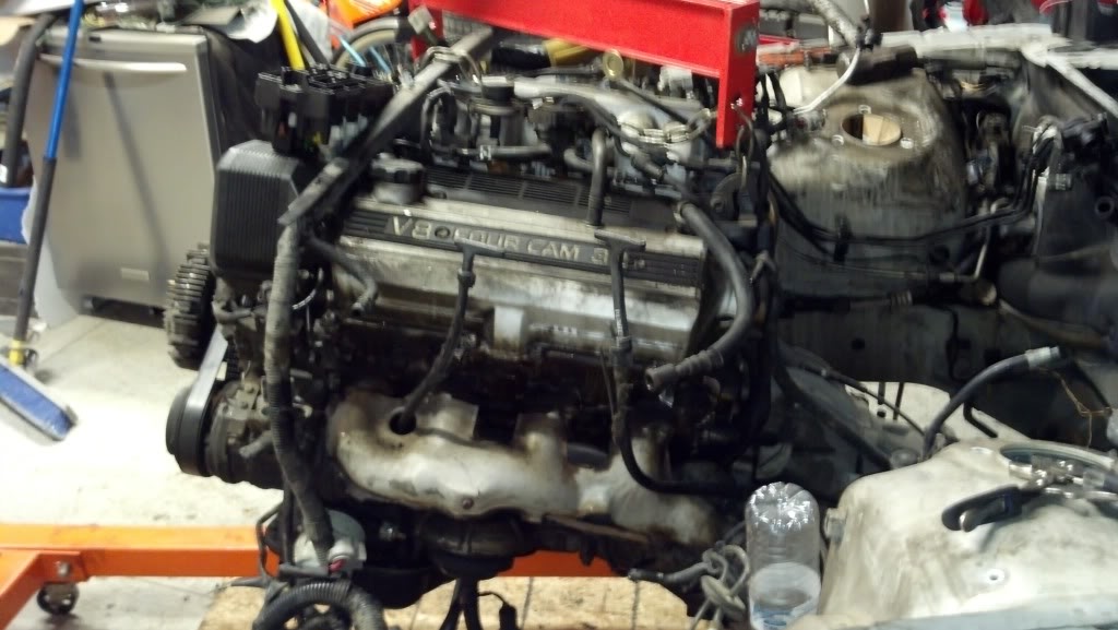

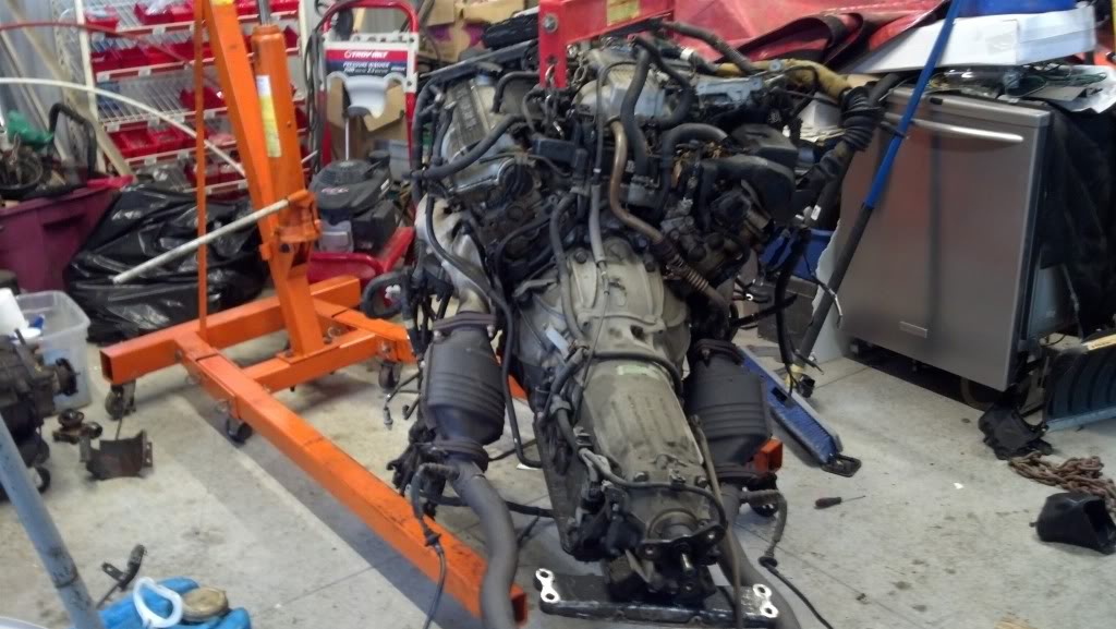

hear is the oily pig coming out

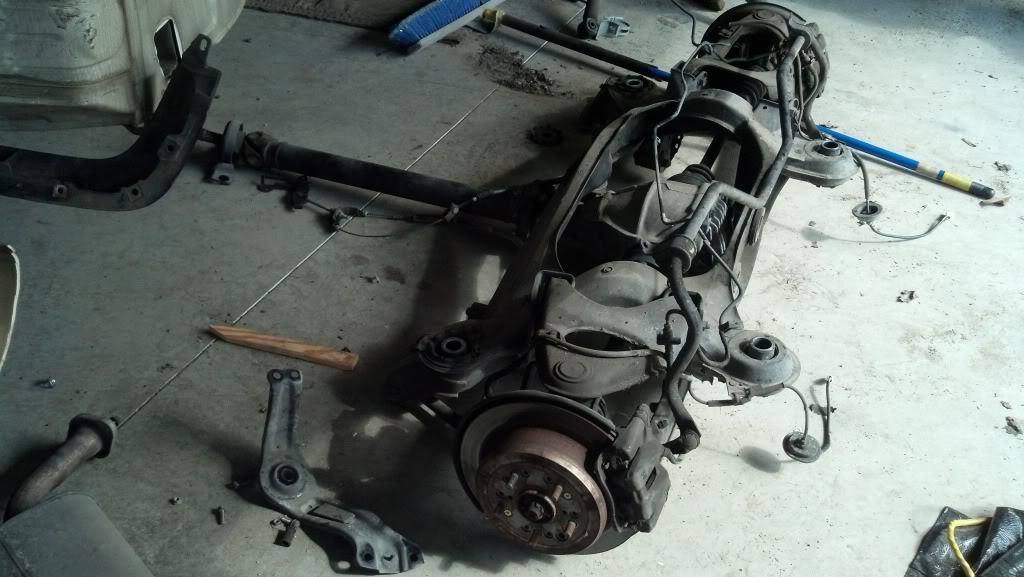

the rear end ..
i wanted to make sure i had everything worth anything and all needed accessories/wiring/modules/relays off this thing before scrapping it this time i took it in. this is your best bet if you have the time
selling various items and scrapping the rest i have pretty much got everything needed from this car for free...

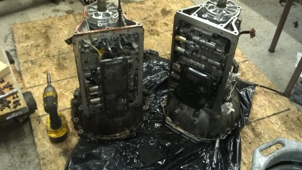

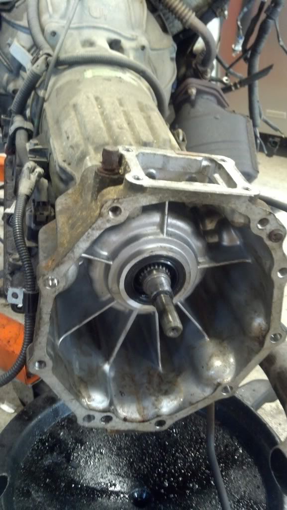

here is a few pics of the transmission comparison i was putting in my uz trans options post

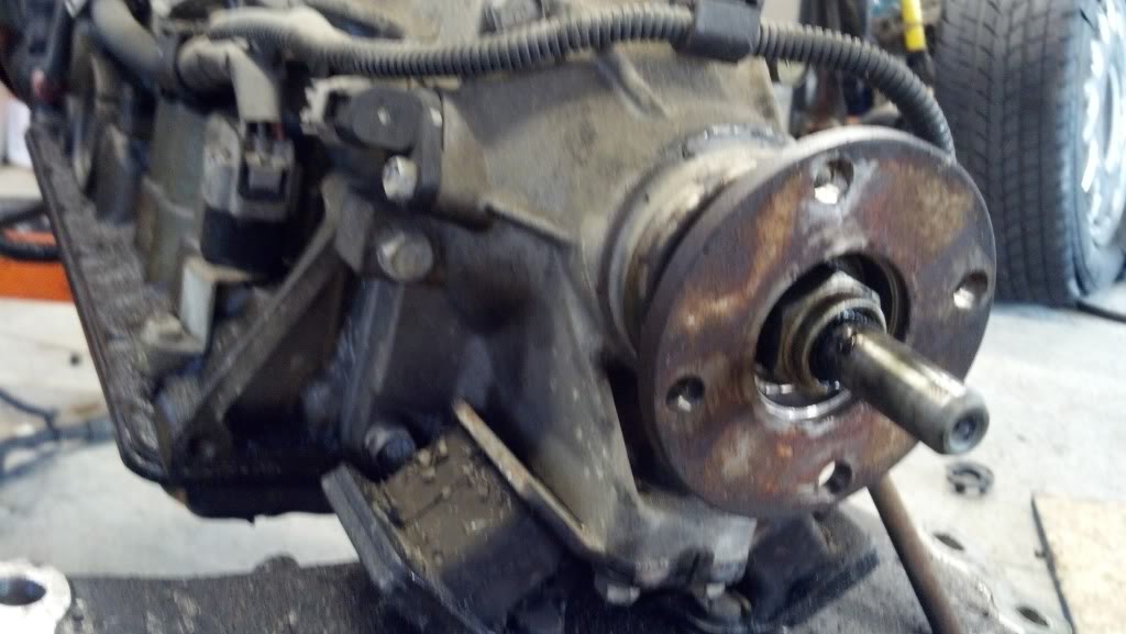

a341 sporting the 340h 4bolt flange allowing use of 4wd dshafts on the 341 trans
here is the 340f transfer case adapter bolted to the 341 before cutting the tailshaft to fit

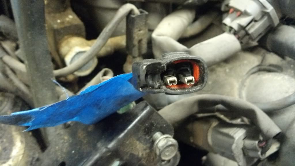

found the connectors are pretty brittle this one was broke from the last rebuild in 2006.

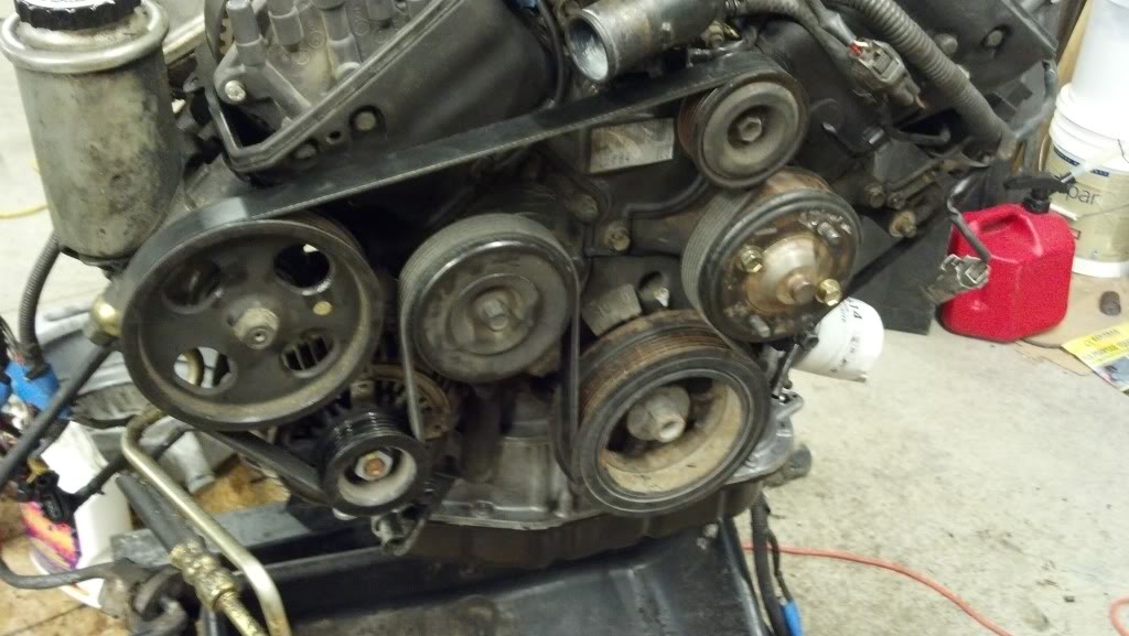

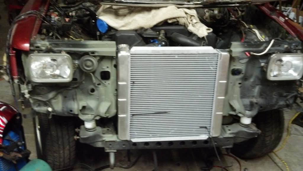

as this is a budget build all work is being done by me using quite a bit of materials that are recycled from other projects and collected parts.

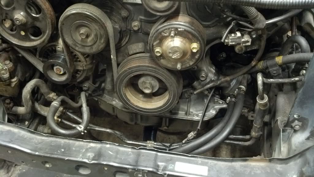

here is the front cover minus the a/c with the new smaller belt

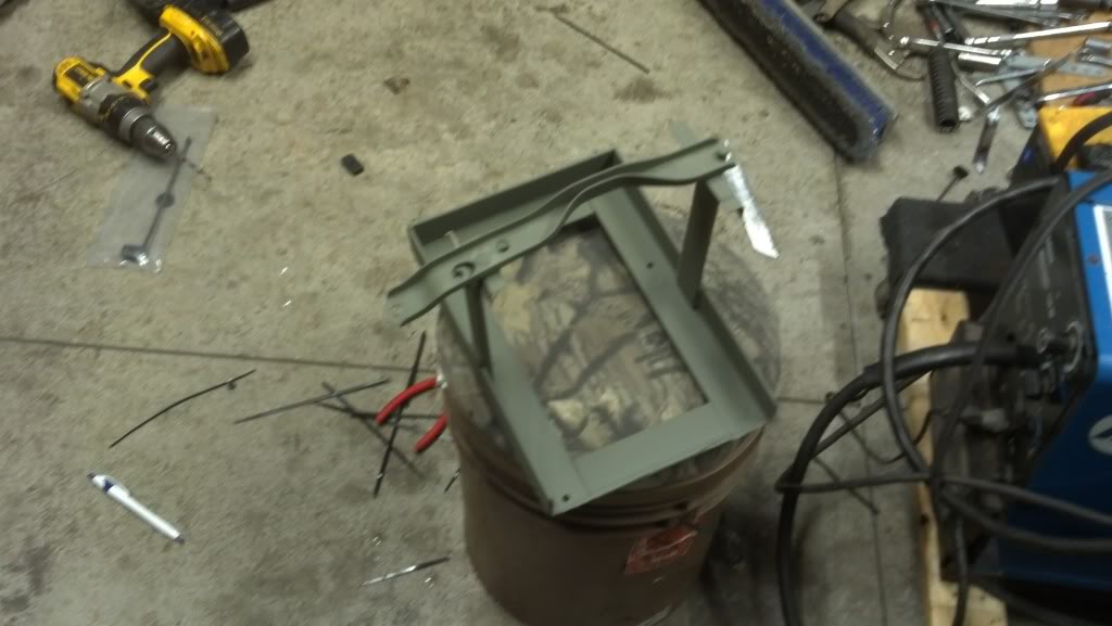

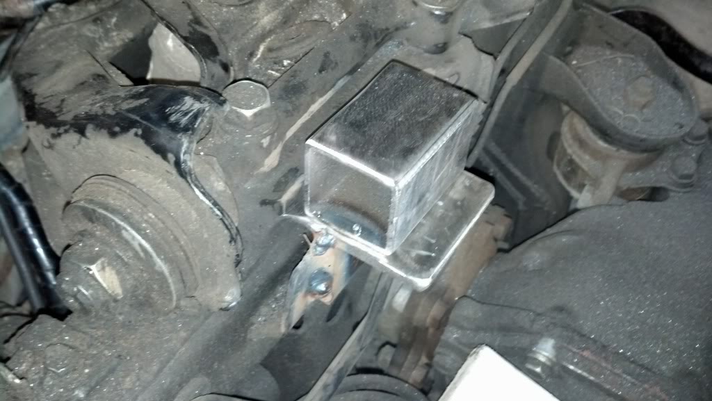

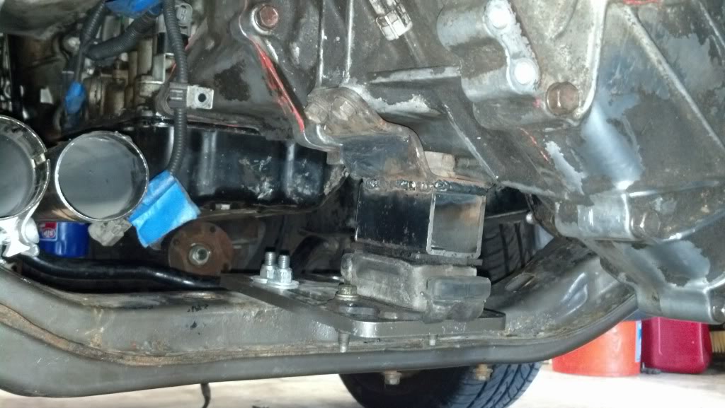

transmission mount made from the w56 mount that was cut up, widened, rubber removed, welded to a piece of square tubing, mounted to the 22r mount, than mounted to a mount adapter purchased from

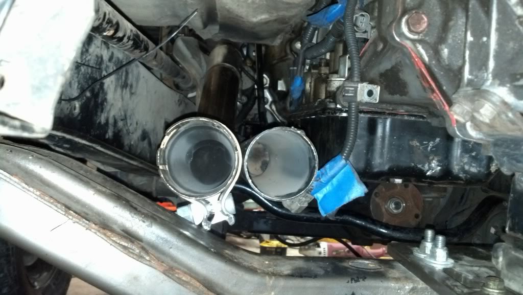

dual 2 and 1/2s

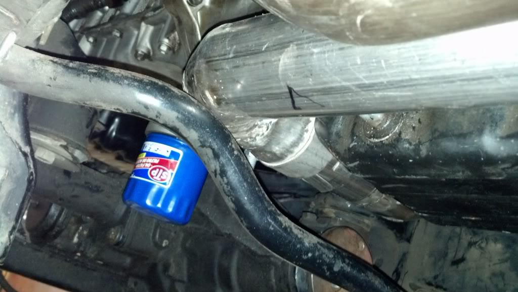

here is my remote oil filter adapter (top and bottom of picture).I dont have the hose hooked up yet i am putting a cooler up front if i can make it fit..

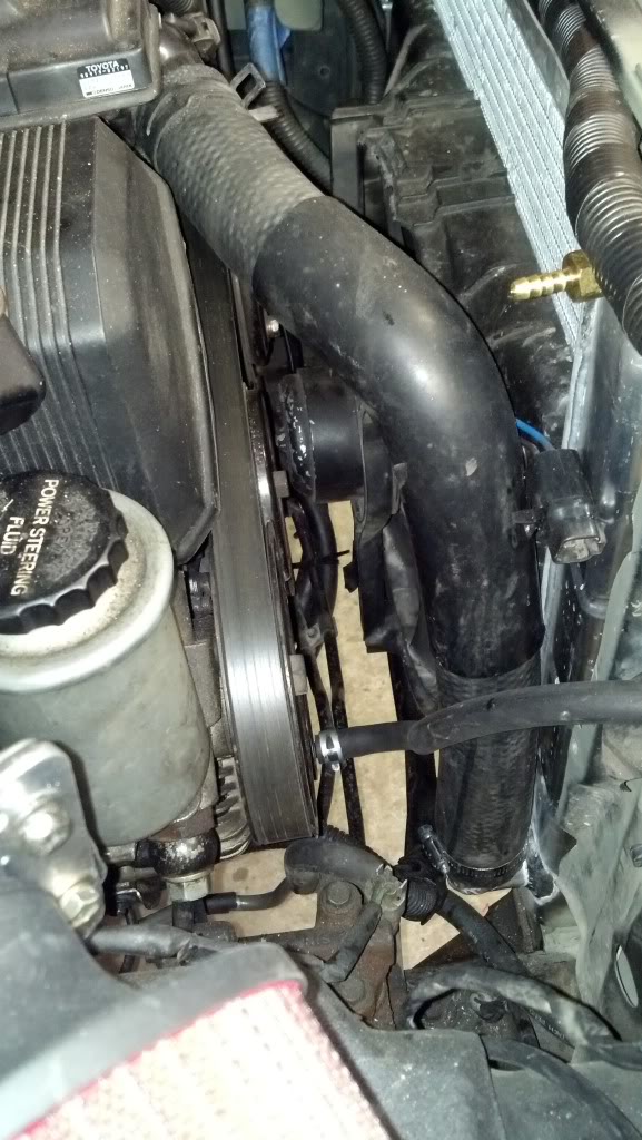

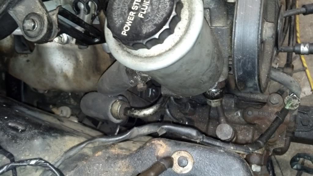

22r power steering line installed from lexus pump to 4runner distribution system/abs thing looks factory almost to good..

remote mount oil lines installed with new ph8a bosch filter(proper number i cant remember right now)
and oil filled

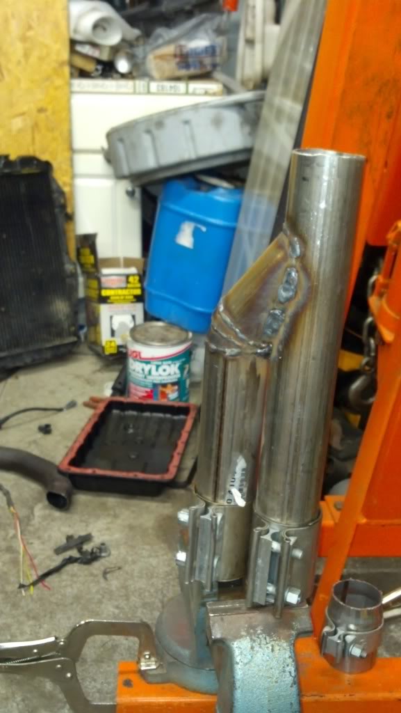

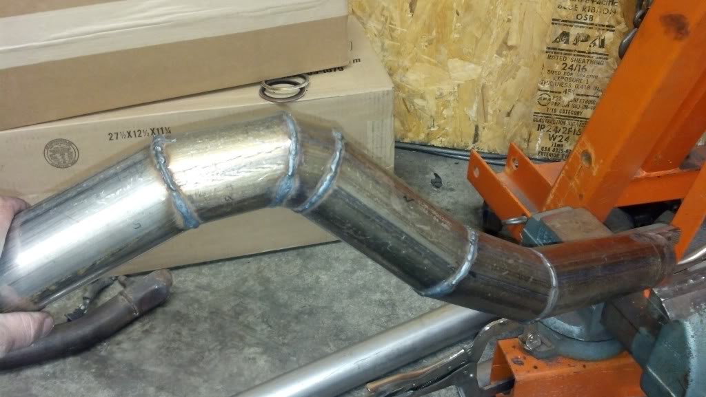

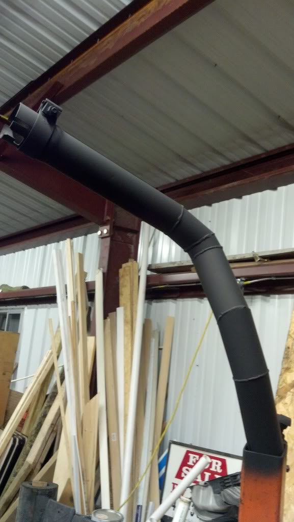

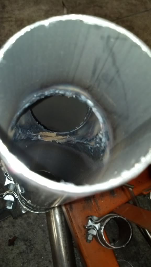

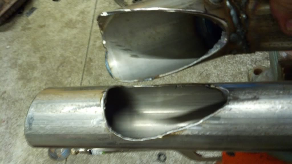

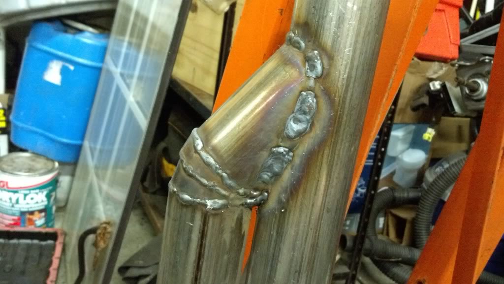

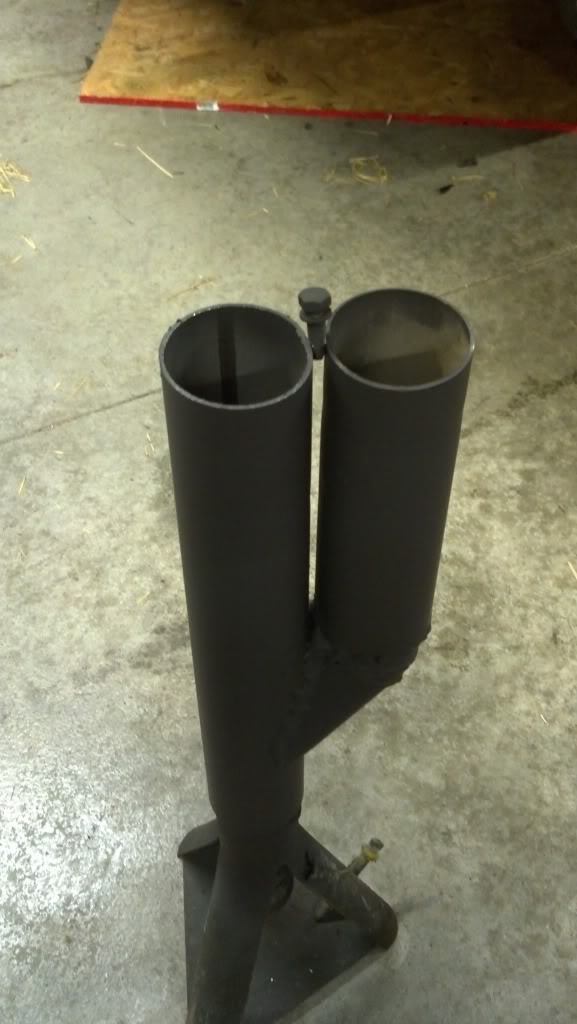

made my fancy off set y pipe hopefully i get some scavenging going on here..
still not beautiful but much better (above picture shows those fantastic clamps i got in the deal,i wish i had more than i do)

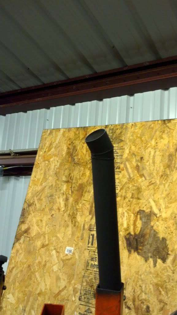

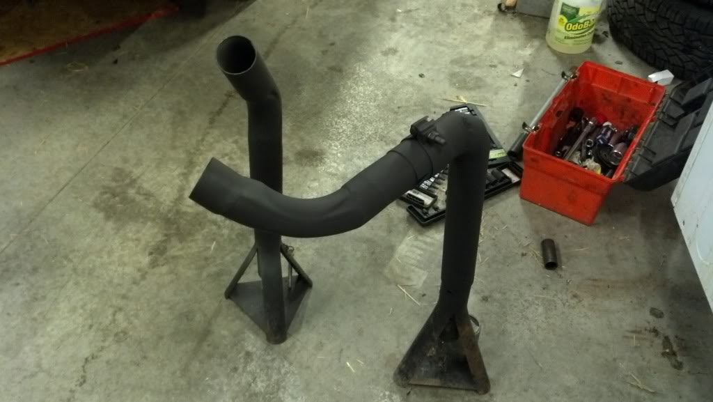

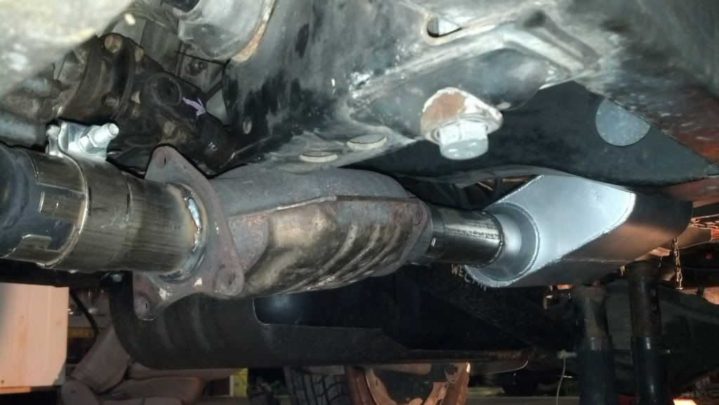

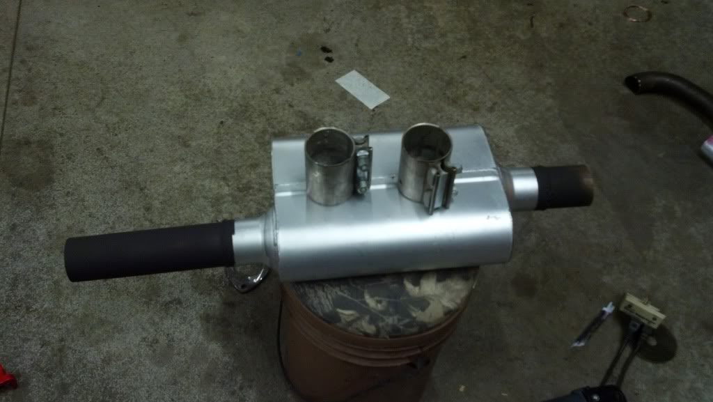

all painted up..some might ask why go dual 2 1/2 to single, the way i look at it %99 of the time i will not be "balls out" so will not need the extra flow that duals could give me. all in all velocity and scavenging will do me and most others fine.. remember its still only a 4 litre

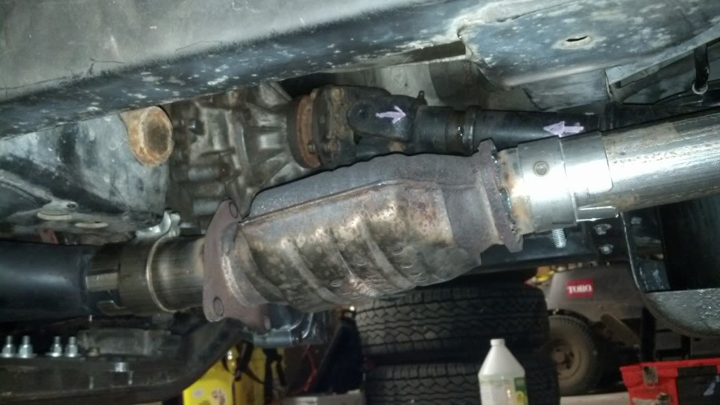

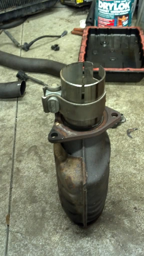

why not throw a catalytic converter in there too.. its not welded up yet but im down for some polution control

I hooked up the fuel supply line. i had to install a new line when i got the truck so i just bent it over to the drivers side at the h part of the frame, than brought it up to the front with a section of the ls400 fuel line and and original filter.. easy peasy
also connected the alternator wiring from the ls400 into the 4runner harness, with this i ran the wiring for my inverter and am using the in line fuse as my main battery fuse to the under hood box....

its been a busy couple of weeks..

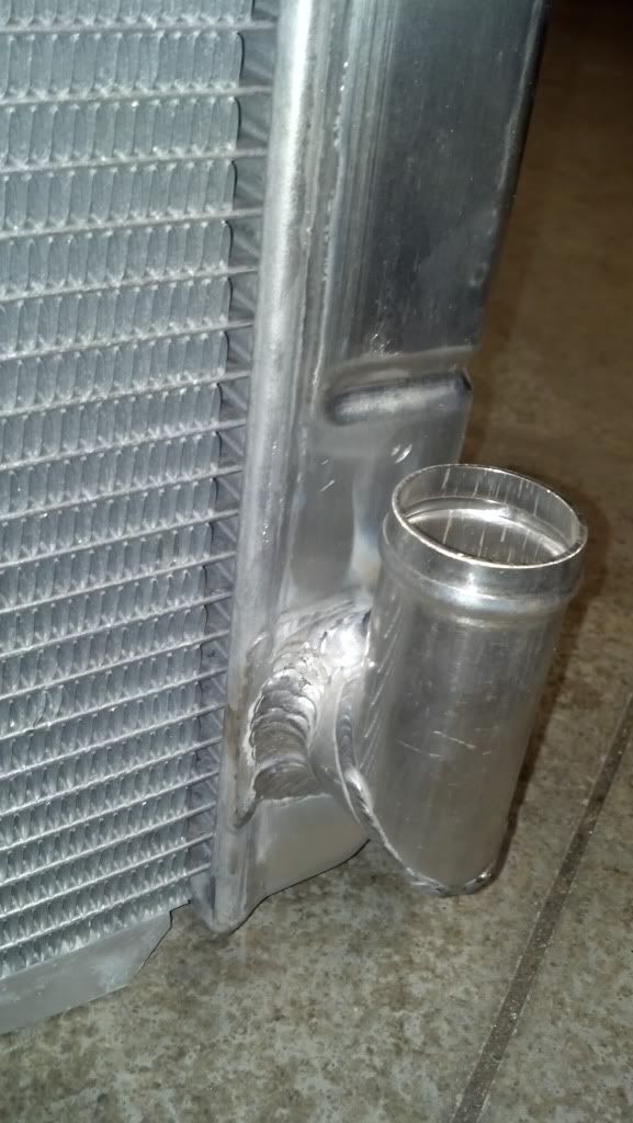

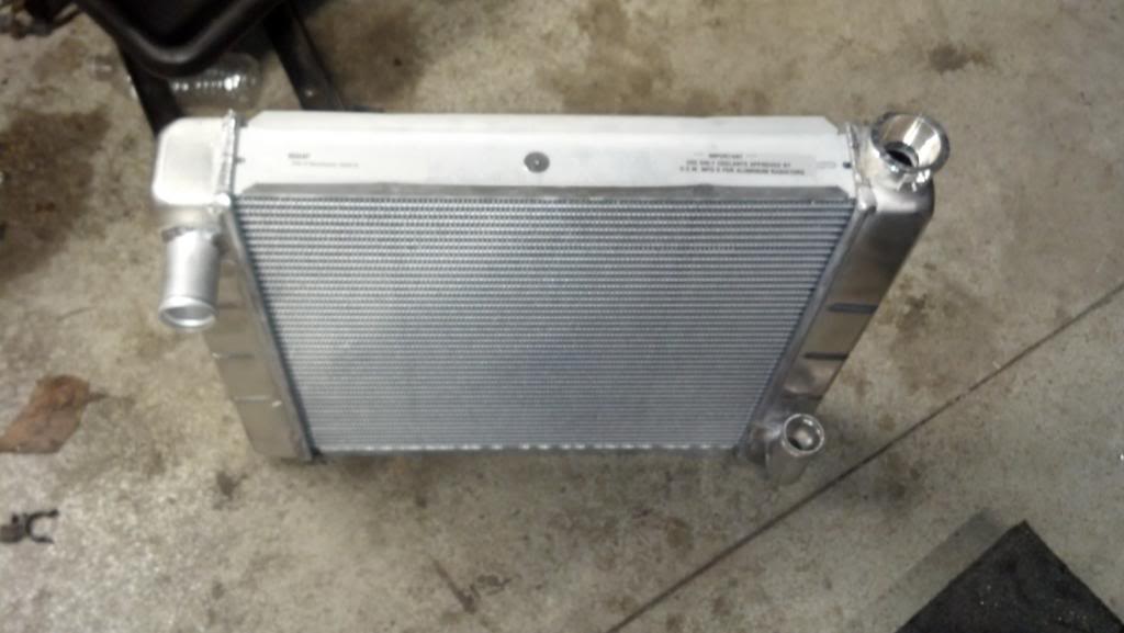

i decided why bother trying to make a 4 cyl radiator work when i can order new 3 core from summit...
http://www.summitracing.com/parts/sum-380324/overview/
this is about the best you can find to fit in that area but there was still alot of cutting to get it in there.
i had 1 stop speed shop https://www.facebook.com/1stopSpeedShop cut off the lower inlet and replace it with a 90 degree 1.5 inch bend (the radiator comes with 1.75 inlet)
a great job for a great price $50 out the door..

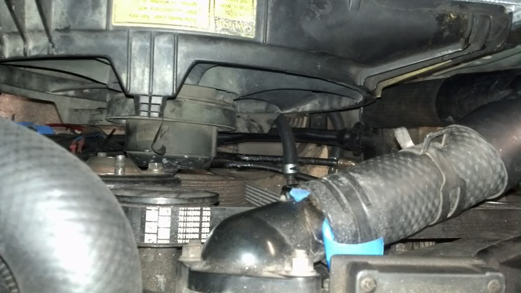

with the in/outlets located where they are i was able to use the newer ls400 radiator hoses with minor trimming
i also finished up my exhaust minus 1 hanger in the back.
factory lexus catalytic converter in/out size ~2.7 inches. why use flanges when you have slip fittings:
muffler:
together:
pie slicing:

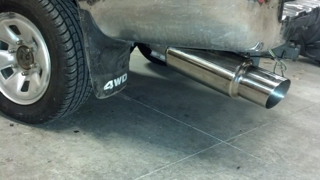

and last but not least the fart can
also notice the factory rubber from the lexus. the tires were in really good shape it would have been a shame to part with them for the $50 i was offered rims and all. i scrapped the rims alone for $60

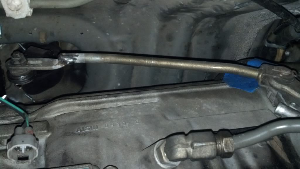

here also is my shifter linkage around 8 inches
so after all of this i put fluids in it hooked up my battery in my quickly fabbed battery retainer
after a quick dead run for oil pressure i got this
just the y pipe and cat but still not to loud.
now you can look at my fab/install work and say why not go that extra mile.. it comes down to this: in this area we are known as the rust belt eg; everything auto wise goes to ˟˟˟˟ in 5-10 years. im not going for show quality because the truck will be rusted out in 5-10 it is my "winter beater".
i figure i probably have close to 2 grand into this maybe less but it is all worth it as i maintain not having a car payment.
tomorrow i will button everything up i still have to add a pickup to my drive shaft bolts as it does not want to shift to second due to no speed pickup i guess....

as usual with most if not every build things do not always go as planned..
while fitting my speed sensor pickup to read the bolts of the driveshaft,
i found that the transfer case i drove 100 miles to get 4 months ago has a bent output shaft
not saying i didnt possibly do it myself test driving the truck with a pretty snug driveshaft but i figured the half inch i had left in the slip would be fine... not sure but,
thats $300 dollars down the drain
so after calling the local yards and checking a few places on car-part i thought it would be a good idea to look at the other t-cases i have..
low and behold the case behind and r150 is almost the same besides having a beefier input coupler, and top shift instead of forward like the 340f, and quite possibly a bit longer overall.
it bolts up and appears to be fully functional but now i for sure need to shorten my rear drive shaft.
so here is the wrap up for drive shaft mods: minus 5 in the rear plus 5 in the front.
despite all that fun stuff i still could not get the truck to shift to second gear. even after fitting the different t-case.
i did however finally get my check engine light to come on. it appears you have to hook up both black/orange pins to switched ignition (IL1 pin 2 and 12)
i can only assume that other functions of the ecu are also activated when this pin 12 wire is connected but i have not tried to get the trans to shift after that though so maybe that will do it
