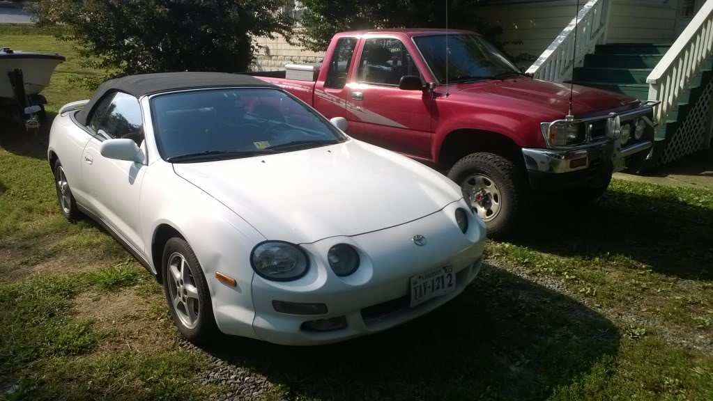

now i can pick up all the hot babes

Nice! Very solid car, too!

Sweet! Chicks love convertibles!

I like the Celica. A friend of my son's mom drives one of same/similar year as her mom car. Did Toyota actually make them as a convertible or were they farmed out? Does it have the 22RE also? It's amazing that 15 year old cars still look and run great. I daily drive an '00.

it has a 5s-fe, and yes, it's a factory convertible. the thing needs a new clutch (badly) and it could use a motor for the roof, but it's all there, runs and drives great (except the clutch). i got a smokin' deal on it, too, from a family friend.
