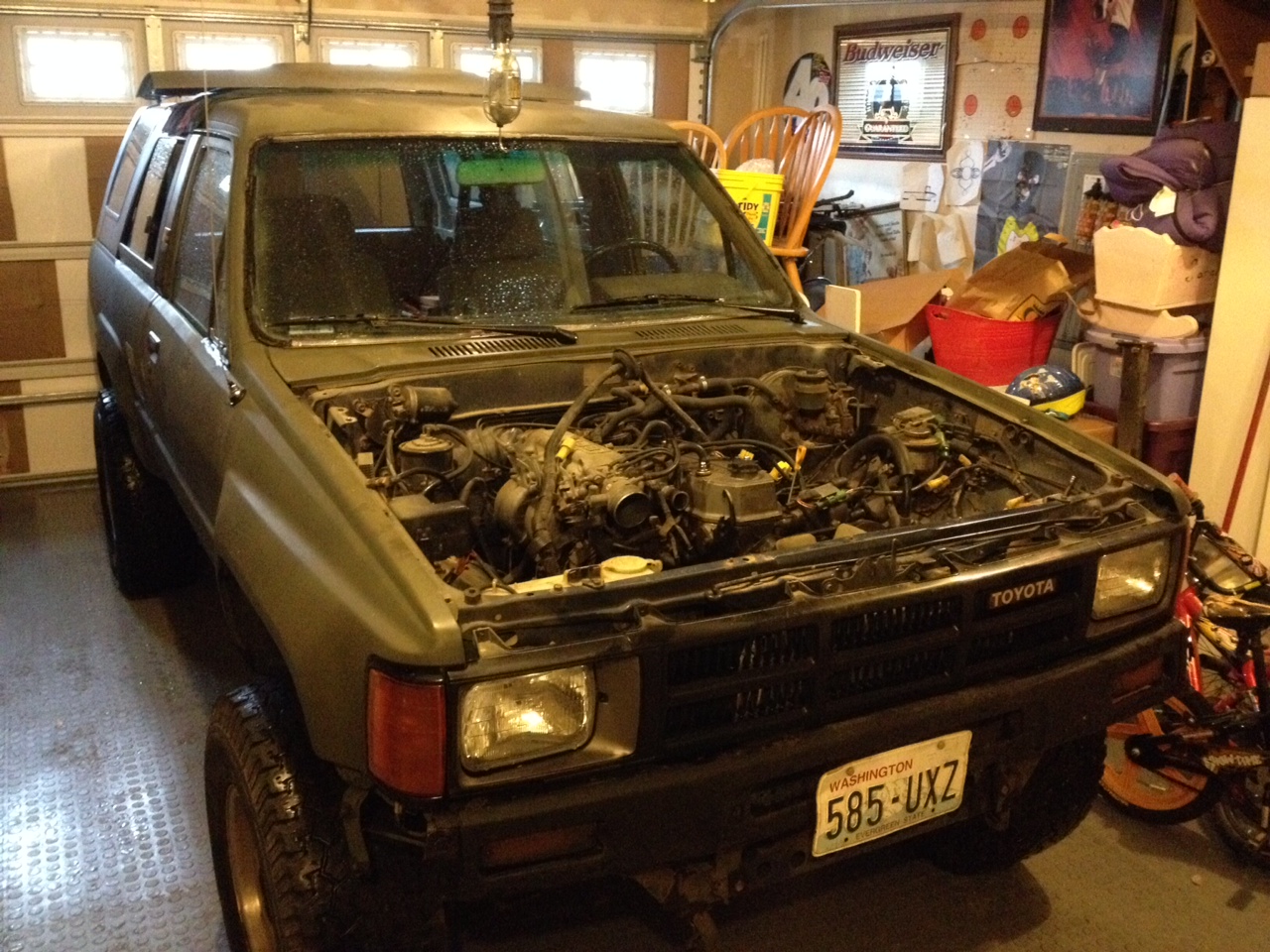

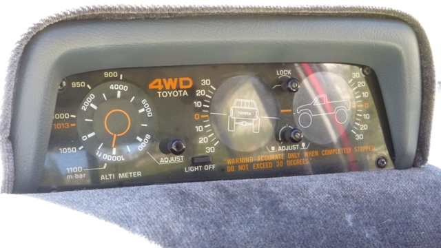

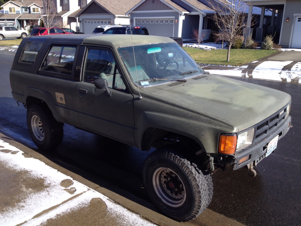

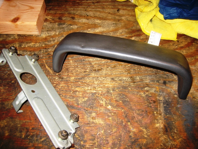

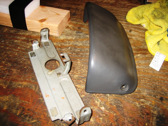

The pics are 1. when I brought it home. 2. in the garage starting the engine removal. 3. The inclinometer that my Father-in-law found in the woods, and the box I am in the process of making.

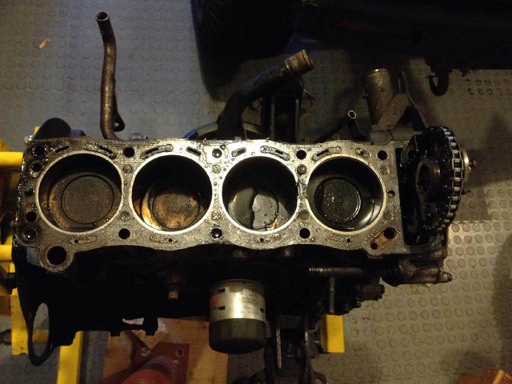

Yesterday was a productive day. With the help of an experienced friend, we pulled the motor, and checked to make sure the timing was correct, and checked the valves. The Clutch on this is nearly new, and the PO said it was a marlin crawler. But upon inspecting it, I found out it was an AISIN. Oh and there is one bolt broken on the flywheel, so I'll have to fix that, and get a new set of clutch bolts. So maybe Marlin is just rebadging Toyota Clutches? Anyway, the plan for today is to pull the head, and check the head gasket. I really hope I can get this back together in a relatively short amount of time. I'd really like to drive this thing!

I now have a photobucket account, so no more attached pictures. Anyway, found the problem! I guess it's head gasket time. I'm trying this from my phone, so I hope this works! Name:  7AB27FFD-A321-41FF-9F11-A7E4BCB78139_zpsvl7lj1ut.jpg

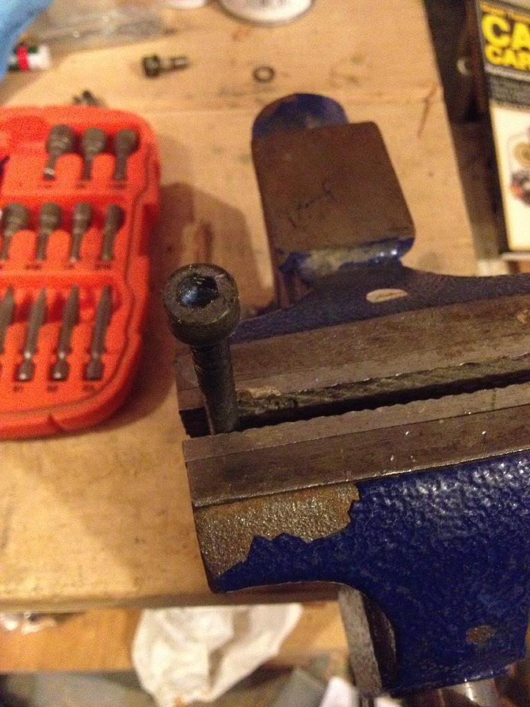

I'm trying to remove the intake from the head. The one hidden hex key bolt is stripped. Time for a 22re head search!

Was the clutch cover or disc an Aisin? I believe Marlin uses an Aisin clutch cover and a Secco disc, someone who actually bought one from them may be able to chime in and confirm or deny. Or you can go to the website and check. Either way Aisin is OEM, so keep it unless you're building a rock crawling rig, you won't get any better than that in my opinion.

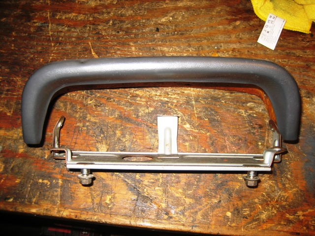

I came on here to let you know I have an extra inclinometer cover and mount. I totally forgot I had it in a box until I saw your post! otherwise I would have given it away to someone else not long ago. I'm not sure what years the cover and mount came from, they both came from the yard off of different 1st Gen 4runners though. They are yours if you want them, just pay the shipping, I'm in Cali. I have no use for them anymore and it appears you may. I'm almost positive that the shape of the covers are slightly different dependent on years, if you search the forum you'll find the posts I remember reading about. So i can't guarantee it will be a perfect fit for you, it may or may not need some modifications. But it's free except for shipping, just let me know.
You and I both have what appears to be a scarce inclino model in that it has "4WD Toyota" labeled on the face, not all of them have it. The majority I've seen don't have it, and I believe they came in the 85' model year.

This mine mounted in my 3rd Gen pickup...i changed the images to a picku-up because that's what I have.

Changing it to a pickup is awesome! Is it in your build thread on how you did it? I was wondering if there was a way to refinish it. Who knows how long it sat in the woods till my father in law stumbled upon it.

It was on another forum...I think I mentioned it on my build thread or in the open forum. I can't for the life of me think of it right now. If your clear lense is all scratched up, you just have to do it the old fashion way. Wet sand and plastic polish. Or you can buy a 3m headlight lense restorer kit, everything you need is in it. 4crawler website has a how-to take it apart on the inclinometer if you need to fix it.

The allen head that you are mentioning, I have never gotten it out without having to use a set of vise grips on it. I get a good firm grip with the vise grips, but not so hard that it distorts the head and break it loose first. Then I use the allen wrench to remove it the rest of the way.
I did the same thing the first time I removed that bolt. It will strip every time, from my experience.

Grego- I was actually referring to the back portion of the cover. The paint is coming off, and was wondering if there was a new sticker, or whatever to replace it.
Oh, no, I don't think so. It's paint so you would have to paint it again. Probably would need a paint artist or something to do it to replace the lettering and detailed stuff.

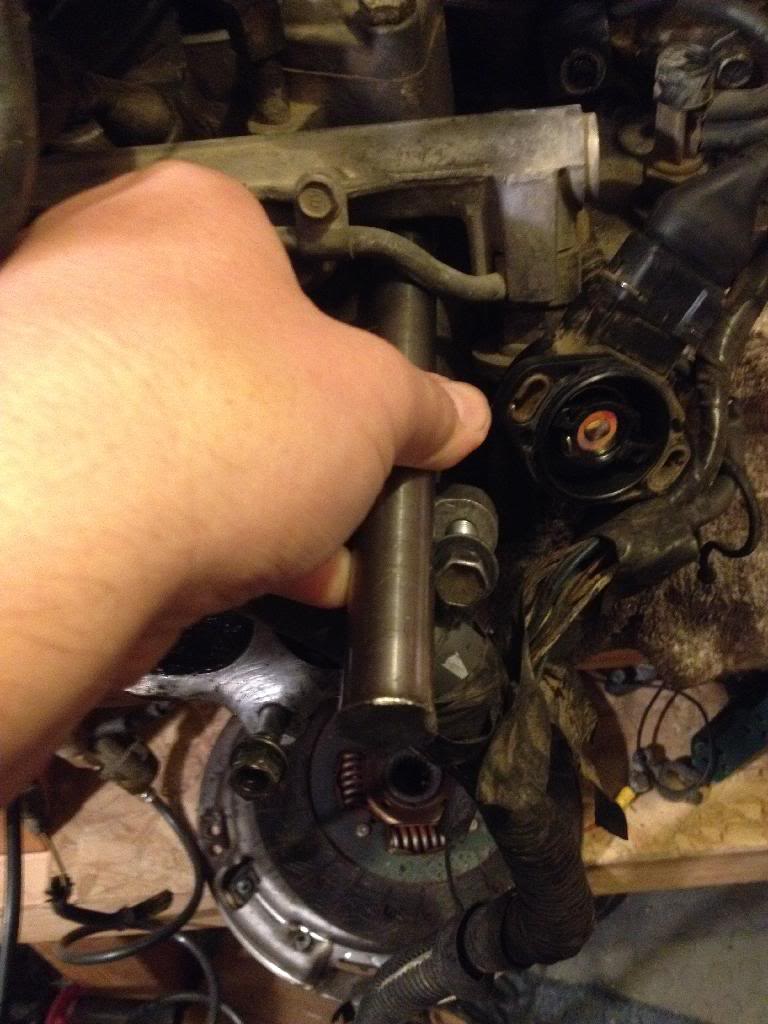

I am so stoked! A master tech at my work told me the secret to the intake hex bolt. All you need us a punch, big hammer, 6mm hex socket, and extension.
Simply place the punch on the hex bolt and hit it several times to reshrink the metal.
Then insert the socket, with extension and twist. Easy peasy! Worked the very first time. Thank you Rick!
On a side note, I tried uploading pics from photobucket, but they didn't load. Just the address was in here. That's why the edit. I'll try again.

The tools you will need.
Here is the hex bolt after it's beating.
The punch on the hex bolt, and my left hand.

Good job on the tear down. That hidden bolt can be a pain for sure. I removed my last one exactly how you did.
