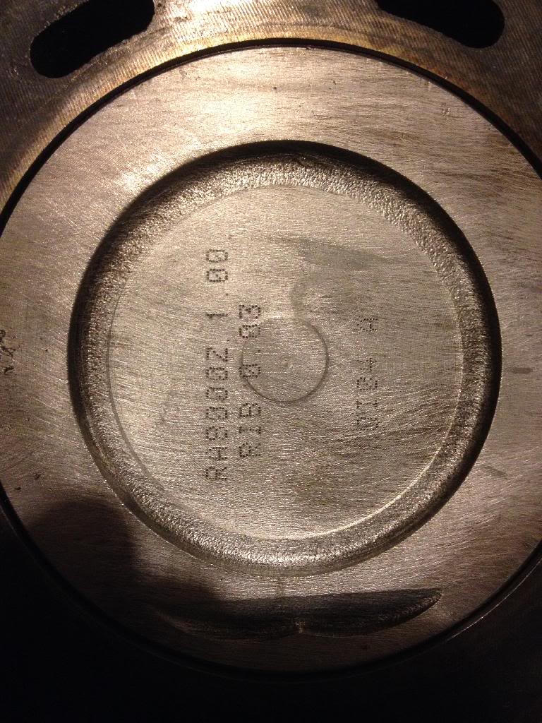

Here is a pic of the piston. Name:  03589C06-E627-4004-99F8-7107C3E3C536_zps0u391nco.jpg

With the head being shaved and needing a thicker gasket to make up the difference and a .040 bore, I would just replace the motor. I have gotten motors from http://www.unitedengine.com/ for around $1100-1300 (depending if they want a core) shipped to my local parts store. Have done great with them on 2 of my motors and 2 other motors that I know of.
With that much work needed, besides cost, you are really pushing the limits on it. Around here they want almost as much for a low mileage motor ($800) and 600 for a high mileage motor. You can find one on Craigslist, but you never know what you are getting. Some good deas and some bad ones.

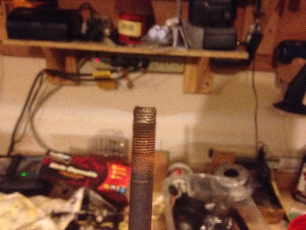

So far the only problem with the new motor. A head bolt with some stripped threads. I have been able to run a different head bolt down the entire length of the hole, but there is some damage to the block threads towards the bottom. Here's a pic of the damaged head bolt. Name:  1D07952D-76D2-4843-8875-BC795E442918_zpsssydsrvh.jpg

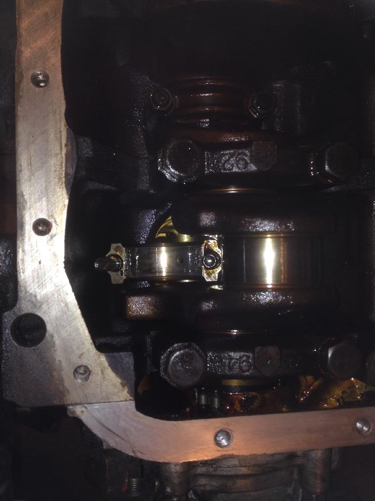

The #1 rod bearing looks great. I think in going to put this thing back together, and run it! I am excited to get this on the road. Name:  014A3ECB-03BC-426A-BC1B-0A804F49784C_zps1hdhuanq.jpg

I don't know what to do with that head bolt hole except maybe to tap it to get the threads back in line?
The bearing does look good, but personally I would rebuild it since everything is out already. Looks like you have enough varnish and build up on the bottom end to warrant a good bath. Of course it depends on budget and time available, so only you can make that decision.

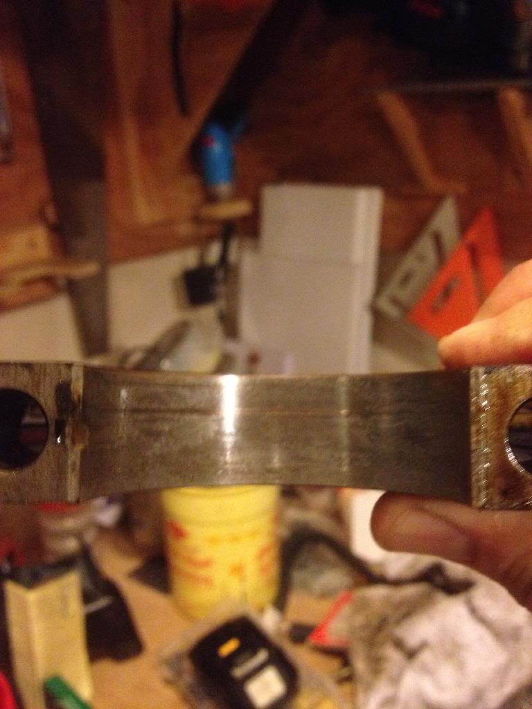

I checked all the rod bearings tonite, and the all look like the one I posted earlier. Then I moved onto the main bearings. #1 looked good, #2 concerns me. I stopped at the second one. Like I said earlier, this is my first tear down, and funds are limited. But I think it's time for new main bearings, and while I am at it new rod bearings too.
Here is a pic of the #2 main bearing. Name:  1894A8CB-6BC2-4ABE-8D3F-7BC15D23CCC3_zpsnage4w9g.jpg

Yeah, looks like a little scoring on that bearing. Probably want to have the crank taken a look at, hopefully just needs a polishing of the journals.

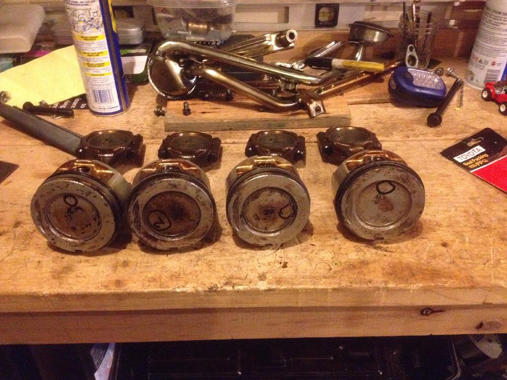

Pulled all the pistons and marked which cylinder they came out of. Going to order a set of main and rid bearings along with some rings. Also a timing kit, because one of the chain guides is broken. Probably going to be a bit longer till u have it up and running.
Here's the pistons I pulled out of the motor. Name:  AD35CD28-28B6-4350-9518-EA4A1DAF9D04_zps7yl4xoxd.jpg

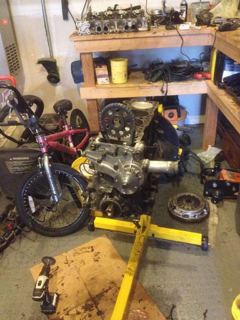

Here is the progress for the week.

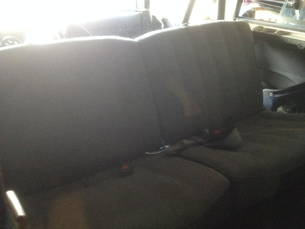

1. Got the factory seats, with retracting seatbelts cleaned and installed.
2. Received the parts I ordered. Main and rod bearings, new rings, and a timing kit with metal guides.
3. Installed all those parts, and started reassembly. The last thing I did tonite was torque down the head.
Progress is coming along, and I hope to be able to put the motor back in by next Friday.
Rear seats installed. Name:  6C18B5CB-6EC4-418C-860C-BC2BDB163436_zps3pf5wdip.jpg

Timing kit and cover installed. Name:  D1948AD3-16CB-42CD-8760-8CE4A9797783_zpsm9zxojos.jpg
And finally the head. Name:  55BA66CE-9D8F-4E88-A642-0D18348CD63F_zpsfte9lsfa.jpg

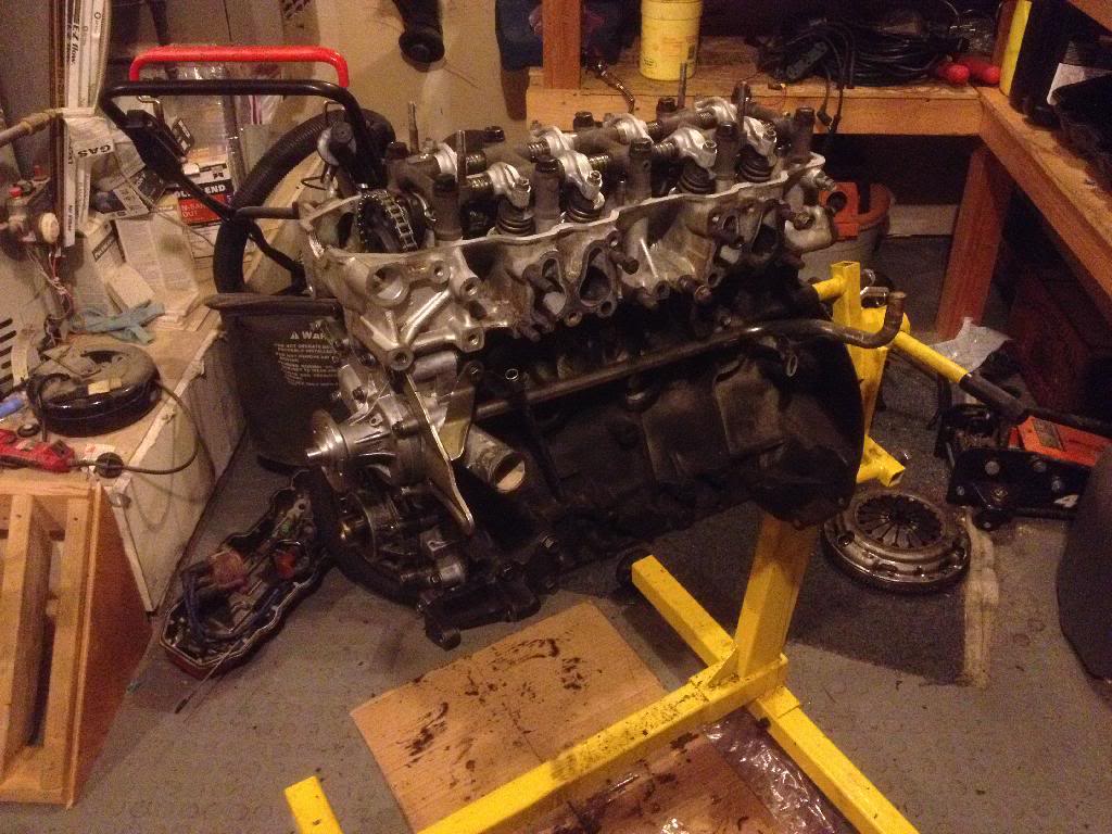

The motor is in! Now to figure out/ remember where everything goes. I still have the lower bell housing bolts, starter, and coolant hoses to do. But with a little luck, I hope to fire it up tomorrow! Then off with the top, and put the softy on. I also need to figure out the stereo. The PO spliced some wires, and I've got no power. But I am excited to be close to having it up and running. Pics tomorrow.

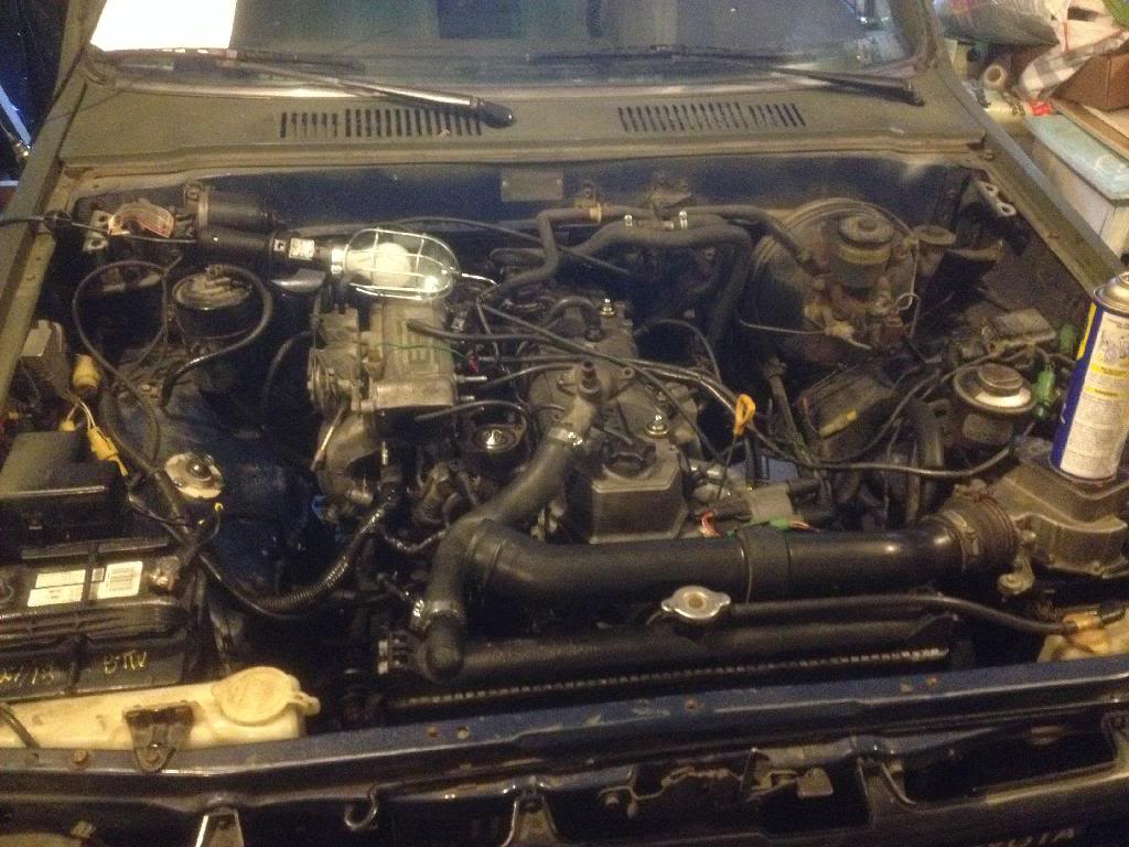

Here is a pic with the motor in. Name:  37F94AB6-B81D-4B5A-8168-579451F15ECD_zpsaodvk2k4.jpg

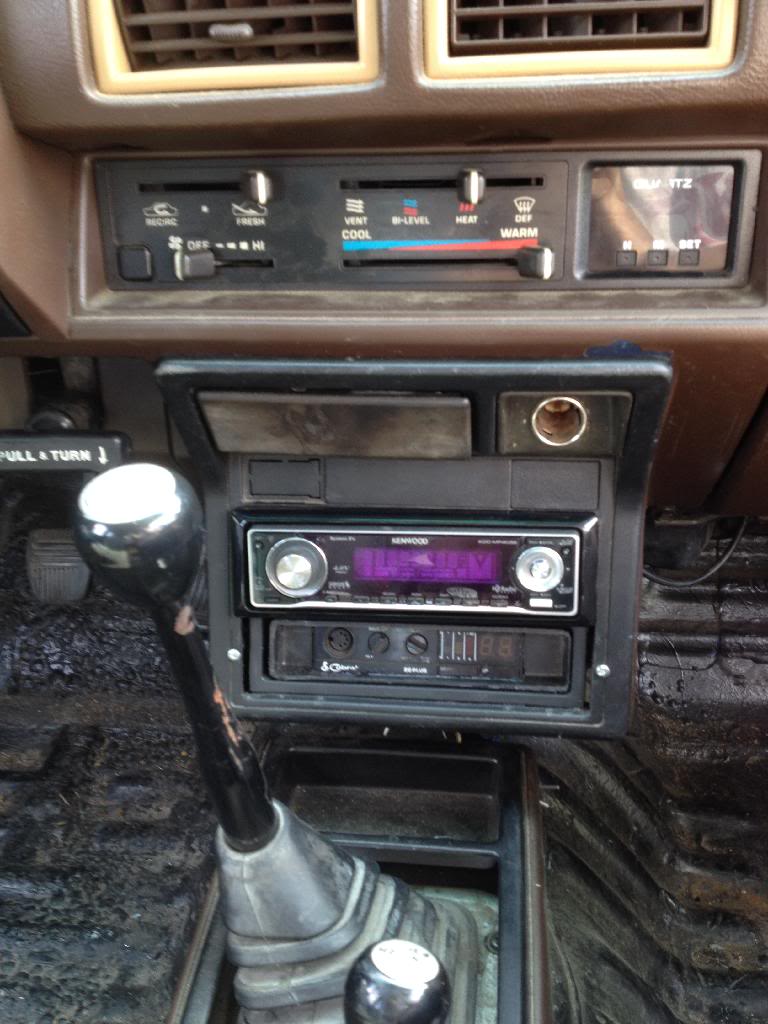

And here is a pic of a mock up for the stereo and CB. This is of course a work in progress. Name:  6CBEBC9E-3979-488D-BA9D-5C5A6ED6BB7B_zpsf90x4h8p.jpg

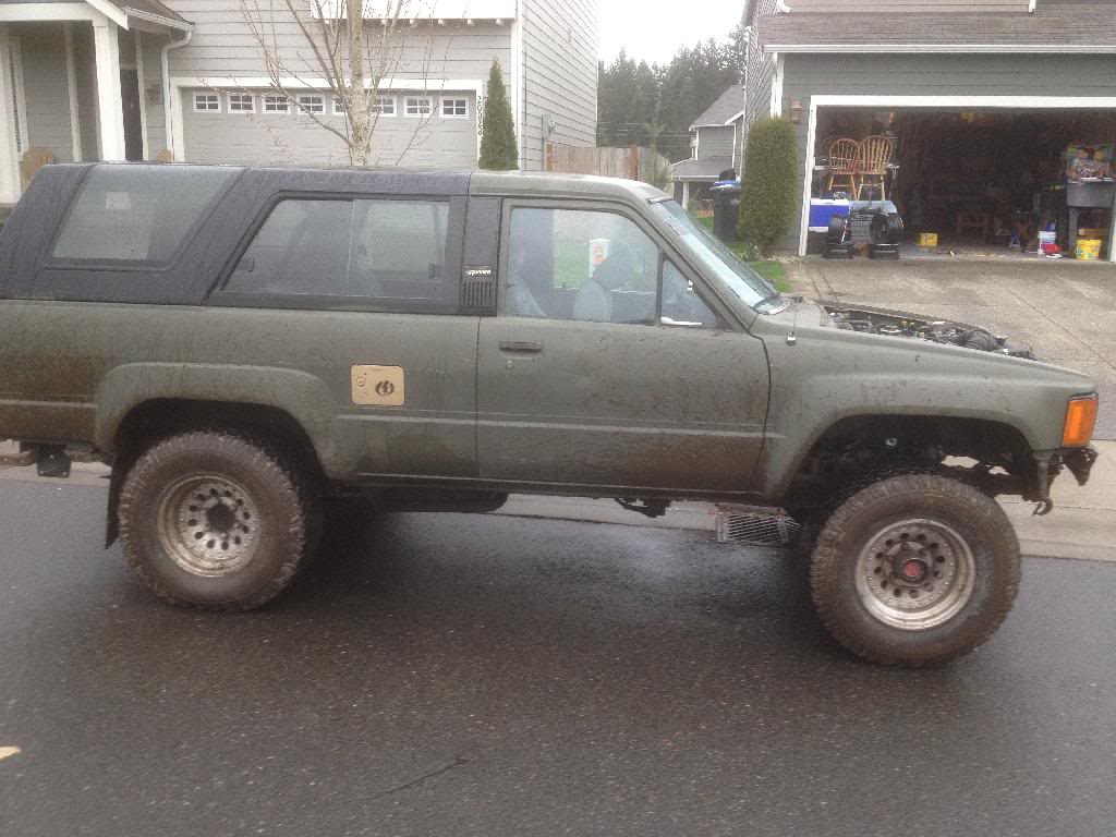

So here are a couple picks of its maiden voyage. The gas station, and a quick trip through a mud hole here by the house. It performed very well!

Now that I have put a few miles on the 4Runner, I have noticed a few things. I know the 22re does not produce a lot of power, but this struggles to get to 50mph. I had one of the techs at work listen to it, and he thinks I have a compression issue, due to a stuck valve. So tomorrow I'll be working on that. From what I've read, the intake needs to be at 0.008, and the exhaust at 0.012. And the engine needs to be warmed up.

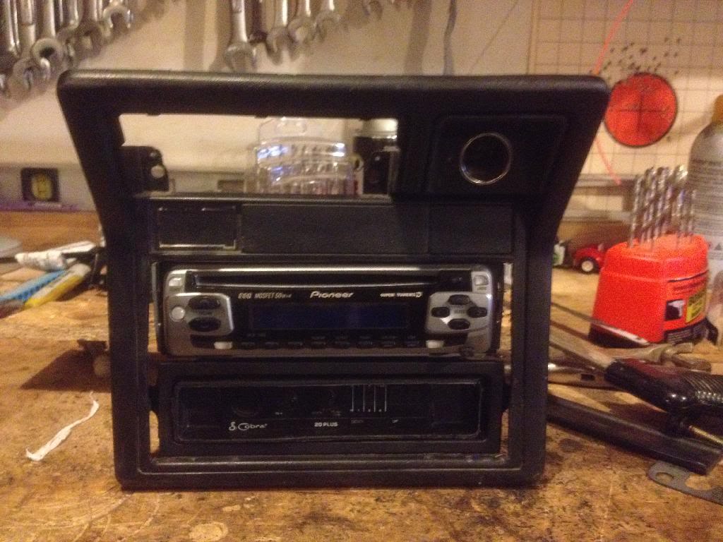

Tonite I was working on the CB and radio, and I am closer to a final product. Here is the latest mock up. Name:  8BDE50BC-45BB-4105-B346-A11F2F59DD79_zpsugcwzw2v.jpg
